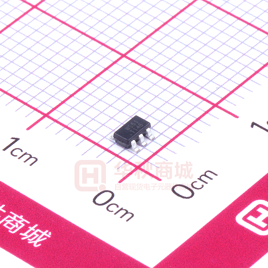

WS3202E WS3202E Over voltage and over current protection IC Http//:www.sh-willsemi.com Descriptions The WS3202E is an Over-Voltage-Protection (OVP) and Over-Current-Protection (OCP) device. The device will switch off internal MOSFET to disconnect IN to OUT to protect load when any of input voltage, input current over the threshold. The Over temperature SOT-23-6L protection (OTP) function monitors chip temperature to protect the device. The WS3202E is available in SOT-23-6L package. GND GND OUT 6 5 4 Standard products are Pb-free and Halogen-free. Features  High voltage technology  Maximum input voltage : 25V  Output power ON time : 8ms (Typ.)  OVP threshold : 6.1V (Typ.)  OVP response time : 5V to output ON OVP threshold VOVP OVP hysteresis VHYS-OVP OVP active time TOVP Output power-on time Ω 500 2.8 V 250 300 mV 6 8 10 ms VIN increasing from 5~7V 5.8 6.1 6.4 V VIN decreasing from 7~5V 200 300 400 mV 1 us 10 ms Input Over-Voltage-Protection (OVP) OVP recovery time TON(OVP) VIN = 5 -> 10V VIN = 10 -> 5V to output ON 6 8 Input Over-Current-Protection (OCP) OCP threshold IOCP 2.0 A Over-Temperature-Protection (OTP) OTP threshold OTP hysteresis 165 o C 40 o C *3: Single Pulse, Pulse width=10ms Will Semiconductor Ltd. 4 J ul, 2016 - Rev. 1.5 WS3202E o Typical Characteristics (Ta=25 C, unless otherwise noted) 2.8 2.7 VIN Increasing 6.1 OCP Threshold, IOCP (A) OVP Threshold, V OVP (V) 6.2 6.0 5.9 VIN Decreasing 5.8 5.8 5.7 -50 -25 0 25 50 75 100 2.6 2.5 2.4 2.3 2.2 2.1 2.0 -50 125 -25 0 o 2.7 0.28 2.6 VIN Increasing 2.4 VIN Decreasing 2.2 2.1 0 25 50 75 100 0.24 0.22 0.20 0.18 0.16 0.14 IOUT = 0.7ADC 0.12 0.10 -50 125 -25 0 25 50 75 100 125 o o Temperature, TA ( C) Temperature, TA ( C) UVLO threshold vs. Temperature IN-to-OUT ON resistance vs. Temperature 6.0 0.34 0.32 VIN=5V IOUT=DC Current 5.0 O TA=-40 C 4.5 O TA=25 C 4.0 VIN=5V IOUT=DC Current 0.30 O TA=85 C 3.5 ON Resistance, RON () 5.5 Output Voltage, VOUT (V) 125 0.26 ON Resistance, RON () UVLO Threshold, VUVLO (V) 0.30 -25 100 OCP threshold vs. Temperature 2.8 2.0 -50 75 Temperature, TA ( C) OVP threshold vs. Temperature 2.3 50 o Temperature, TA ( C) 2.5 25 O TA=85 C 0.28 0.26 0.24 O 0.22 TA=25 C 0.20 0.18 O TA=-40 C 0.16 0.14 3.0 0 500 1000 1500 2000 2500 0.12 Load Current, IOUT (mA) 500 1000 1500 2000 2500 Load Current, IOUT (mA) Output voltage vs. Output current Will Semiconductor Ltd. 0 ON resistance vs. Output current 5 J ul, 2016 - Rev. 1.5 WS3202E Normally Power ON Power ON with Input Overvoltage OVP Active Time OVP Recovery Time Normally Power OFF Will Semiconductor Ltd. 6 J ul, 2016 - Rev. 1.5 WS3202E Package outline dimensions SOT-23-6L Symbol Dimensions In Millimeters Min. Typ. Max. A 1.050 - 1.250 A1 0.000 - 0.100 A2 1.050 - 1.150 b 0.300 0.400 0.500 c 0.100 - 0.200 D 2.820 2.900 3.020 E 1.500 1.600 1.700 E1 2.650 2.800 2.950 e 0.950 Typ. e1 1.800 1.900 2.000 L 0.300 - 0.600 - 8 θ Will Semiconductor Ltd. o 0 7 o J ul, 2016 - Rev. 1.5
