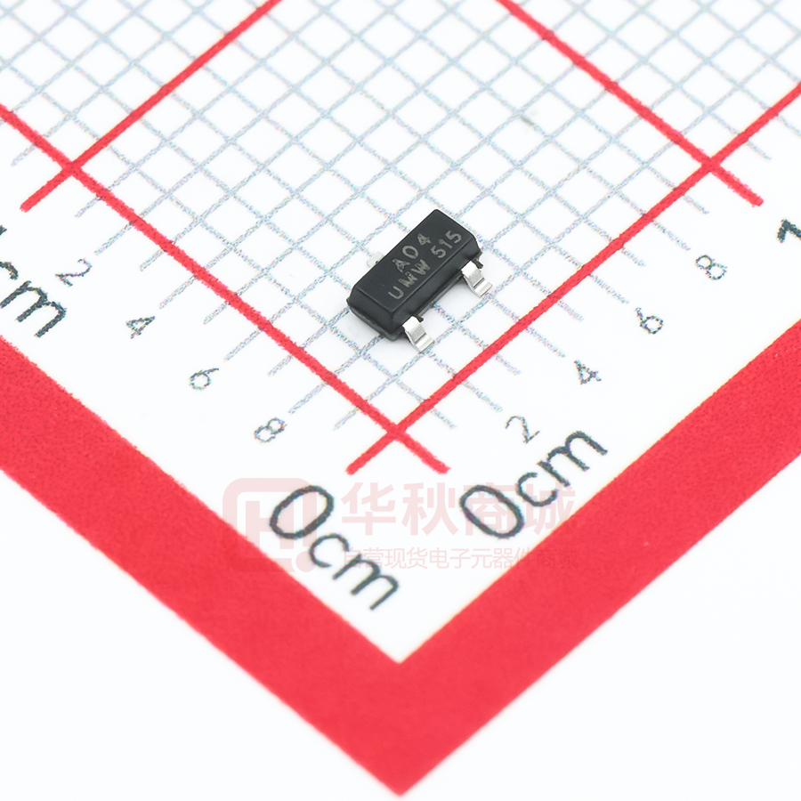

UMW SI2304A
N-Channel 30-V (D-S) MOSFET
■ Features
SOT–23
● VDS (V) = 30V
● RDS(ON) < 57mΩ (VGS =-10V)
● RDS(ON) < 94 mΩ (VGS =-4.5V)
1. GATE
2. SOURCE
3. DRAIN
Equivalent Circuit
D
G
S
