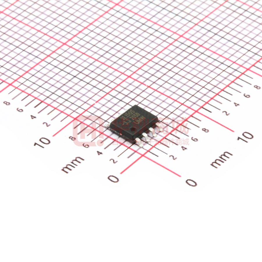

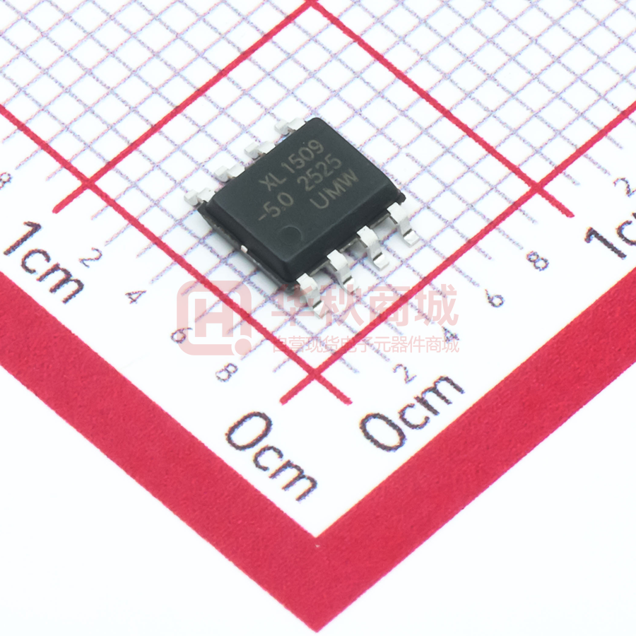

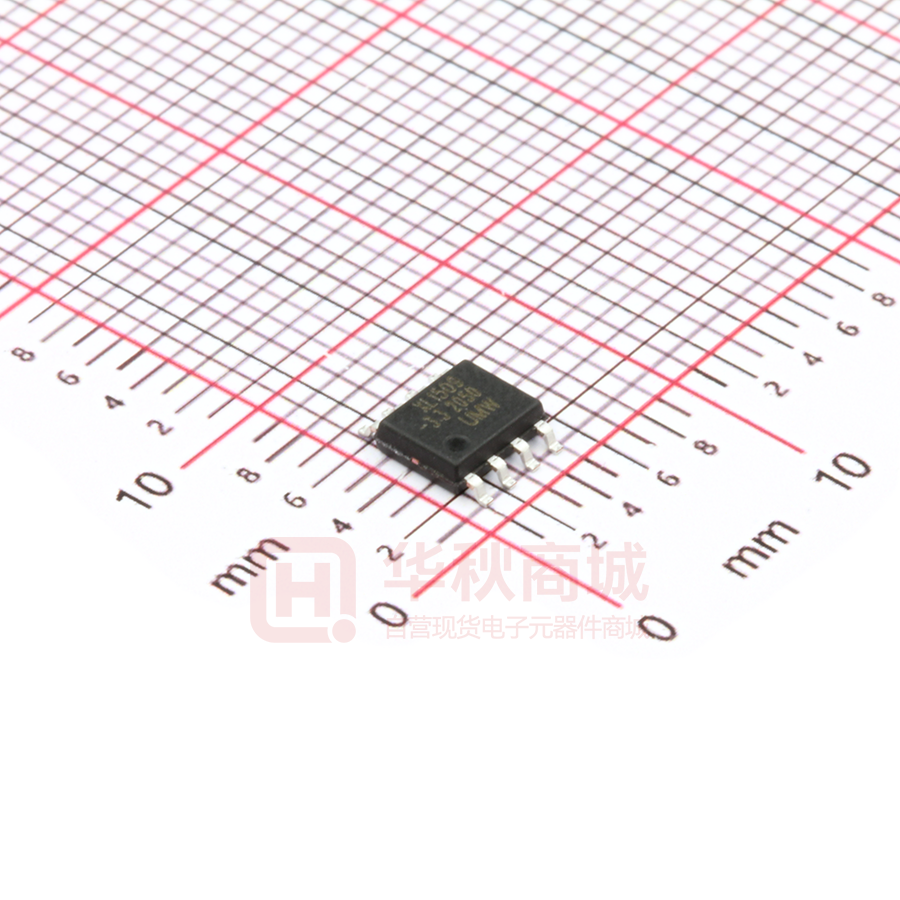

Pin Configurations
VIN
1
8
GND
OUTPUT
2
7
GND
FEEDBACK
3
6
GND
ON/OFF
4
5
GND
XL1509
Figure2. Pin Configuration of XL1509 (Top View)
