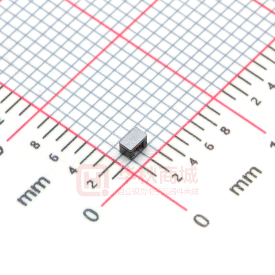

    共模滤波器 SMD-4P,2x1.2mm 90Ω@100MHz - 400mA 300mΩ
WCM2012F2SF-900T04 数据手册
TAI-TECH P2 Wire Wound Type Common Mode Filter WCM2012F2SF-SERIES 1. Features 1. High common mode impedance at high frequency cause excellent noise suppression performance. Halogen 2. WCM2012F2SF series realizes small size and low profile. 2.0x1.2x1.2 mm. Halogen-free 3. 100% Lead(Pb) & Halogen-Free and RoHS compliant. 4. Operating temperature -40~+125℃ (Including self - temperature rise) 2. Dimension E C A B A(mm) B(mm) C(mm) D1(mm) D2(mm) E(mm) 2012F2SF 2.0±0.2 1.2±0.2 1.2±0.2 0.50±0.1 0.51±0.1 0.15±0.1 D D Series 3. Part Numbering WCM 2012 A B F 2 S F C D E F - 900 T 04 G H I A: Series B: Dimension C: Material Ferrite Core D: Number of Lines 2=2 lines E: Type S=Shielded , N=Unshielded F: Lead free G: Impedance 900=90Ω H: Packaging I: Rated Current T=Taping and Reel 04=400mA WCM 2012 A B F 2 S F C D E F - 801 G A: Series B: Dimension C: Material Ferrite Core D: Number of Lines 2=2 lines E: Type S=Shielded , N=Unshielded F: Lead free G: Impedance 801=800Ω H: Category Code N=DR-N45 材&SP-N45 材 www.tai-tech.com.tw - N H TAI-TECH P3 4. Specification DC Common mode Test Frequency Impedance Resistance (MHz) (Ω) (Ω) max. TAI-TECH Part Number Withstand Rated Volt. IR Volt. (Vdc) (Ω) min. (Vdc)max. max. Rated Current (mA)max. WCM2012F2SF-670T04 67±25% 100 0.25 400 50 125 10M WCM2012F2SF-900T04 90±25% 100 0.30 400 50 125 10M WCM2012F2SF-121T04 120±25% 100 0.30 400 50 125 10M WCM2012F2SF-161T03 160±25% 100 0.35 350 50 125 10M WCM2012F2SF-181T03 180±25% 100 0.35 350 50 125 10M WCM2012F2SF-201T03 200±25% 100 0.40 300 50 125 10M WCM2012F2SF-221T03 220±25% 100 0.40 300 50 125 10M WCM2012F2SF-261T03 260±25% 100 0.40 300 50 125 10M WCM2012F2SF-361T03 360±25% 100 0.50 300 50 125 10M WCM2012F2SF-601T03 600±25% 100 0.88 300 50 125 10M WCM2012F2SF-102T01 1000±25% 100 1.30 100 50 125 10M DC Common mode Test Frequency Resistance Impedance (Ω) (MHz) (Ω) max. TAI-TECH Part Number WCM2012F2SF-801-N 800±25% 100 Withstand Rated Volt. IR Volt. (Vdc) (Ω) min. (Vdc)max. max. Rated Current (mA)max. 0.88 300 50 125 10M Typical Impedance v.s. Frequency Curve WCM2012F2SF-670 1000 WCM2012F2SF-900 1000 100 IMPEDANCE(Ohm) IMPEDANCE(Ohm) Common Mode 10 1 100 Common Mode 10 Normal Mode 1 Normal Mode 0.1 1 10 100 1000 0.1 10000 1 10 FREQUENCY(MHz) WCM2012F2SF-121 10 Normal Mode 1 0.1 1 10 10000 Common Mode Common Mode 100 1000 WCM2012F2SF-161 1000 IMPEDANCE(Ohm) IMPEDANCE(Ohm) 1000 100 FREQUENCY(MHz) 100 1000 10000 100 10 Normal Mode 1 0.1 1 FREQUENCY(MHz) 10 100 FREQUENCY(MHz) www.tai-tech.com.tw 1000 10000 TAI-TECH P4 WCM2012F2SF-181 1000 WCM2012F2SF-201 1000 Common Mode Common Mode IMPEDANCE(Ohm) IMPEDANCE(Ohm) 100 10 Normal Mode 1 100 10 Normal Mode 1 0.1 0.1 1 10 100 1000 1 10000 10 WCM2012F2SF-221 1000 Common Mode IMPEDANCE(Ohm) IMPEDANCE(Ohm) 10000 Common Mode 10 Normal Mode 1 0.1 10 100 1000 100 10 Normal Mode 1 0.1 10000 1 10 FREQUENCY(MHz) 100 1000 10000 FREQUENCY(MHz) WCM2012F2SF-361 1000 1000 WCM2012F2SF-261 1000 100 1 100 FREQUENCY(MHz) FREQUENCY(MHz) WCM2012F2SF-601 10000 100 IMPEDANCE(Ohm) IMPEDANCE(Ohm) Common Mode 10 Normal Mode 1 Common Mode 1000 100 Normal Mode 10 1 0.1 1 10 100 1000 10000 1 WCM2012F2SF-102 10000 IMPEDANCE(Ohm) Common Mode 1000 100 10 Normal Mode 1 1 10 100 10 100 FREQUENCY(MHz) FREQUENCY(MHz) 1000 10000 FREQUENCY(MHz) www.tai-tech.com.tw 1000 10000 TAI-TECH WCM2012F2SF-801-N 10000 Common Mode 1000 IMPEDANCE(Ohm) P5 100 10 Normal Mode 1 0.1 1 10 100 1000 10000 FREQUENCY(MHz) 5. Schematic Diagram www.tai-tech.com.tw
