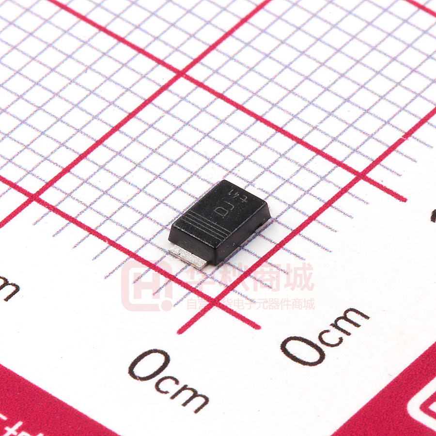

PMEG10030ELP 100 V, 3 A low leakage current Schottky barrier rectifier 12 December 2018 Product data sheet 1. General description Planar Maximum Efficiency General Application (MEGA) Schottky barrier rectifier with an integrated guard ring for stress protection, encapsulated in a SOD128 small and flat lead Surface-Mounted Device (SMD) plastic package. 2. Features and benefits • • • • • • • • Extremely low leakage current IR = 110 nA Reverse voltage: VR ≤ 100 V Average forward current: IF(AV) ≤ 3 A High power capability due to clip-bonding technology High temperature Tj ≤ 175 °C Small and flat lead SMD plastic package AEC-Q101 qualified Capable for reflow and wave soldering 3. Applications • • • • • Low voltage rectification High efficiency DC-to-DC conversion Switch mode power supply Reverse polarity protection Low power consumption applications 4. Quick reference data Table 1. Quick reference data Symbol Parameter Conditions Min Typ Max Unit IF(AV) average forward current δ = 0.5; f = 20 kHz; Tsp ≤ 160 °C; square wave - - 3 A VR reverse voltage Tj = 25 °C - - 100 V VF forward voltage IF = 3 A; tp ≤ 300 µs; δ ≤ 0.02; Tj = 25 °C - 710 770 mV IR reverse current VR = 100 V; tp ≤ 300 µs; δ ≤ 0.02; Tj = 25 °C - 110 450 nA PMEG10030ELP Nexperia 100 V, 3 A low leakage current Schottky barrier rectifier 5. Pinning information Table 2. Pinning information Pin Symbol Description 1 K cathode[1] 2 A anode Simplified outline 1 Graphic symbol 2 K A sym001 CFP5 (SOD128) [1] The marking bar indicates the cathode. 6. Ordering information Table 3. Ordering information Type number Package PMEG10030ELP Name Description Version CFP5 plastic, surface mounted package; 2 terminals; 4 mm pitch; 3.8 mm x 2.6 mm x 1 mm body SOD128 7. Marking Table 4. Marking codes Type number Marking code PMEG10030ELP DJ PMEG10030ELP Product data sheet All information provided in this document is subject to legal disclaimers. 12 December 2018 © Nexperia B.V. 2018. All rights reserved 2 / 14 PMEG10030ELP Nexperia 100 V, 3 A low leakage current Schottky barrier rectifier 8. Limiting values Table 5. Limiting values In accordance with the Absolute Maximum Rating System (IEC 60134). Symbol Parameter Conditions Min Max Unit VR reverse voltage Tj = 25 °C - 100 V IF forward current δ = 1; Tsp = 155 °C - 4.2 A IF(AV) average forward current δ = 0.5; f = 20 kHz; Tamb ≤ 55 °C; square wave - 3 A δ = 0.5; f = 20 kHz; Tsp ≤ 160 °C; square wave - 3 A - 70 A [2] - 750 mW [3] - 1250 mW [1] - 2500 mW IFSM non-repetitive peak forward current tp = 8 ms; square wave; Tj(init) = 25 °C Ptot total power dissipation Tamb ≤ 25 °C [1] Tj junction temperature - 175 °C Tamb ambient temperature -55 175 °C Tstg storage temperature -65 175 °C [1] [2] [3] Device mounted on a ceramic Printed-Circuit Board (PCB), Al2O3, standard footprint. Device mounted on an FR4 PCB, single-sided copper, tin-plated and standard footprint. 2 Device mounted on an FR4 PCB, single-sided copper, tin-plated, mounting pad for cathode 1 cm . 9. Thermal characteristics Table 6. Thermal characteristics Symbol Parameter Rth(j-a) Rth(j-sp) [1] [2] [3] [4] [5] Conditions thermal resistance from in free air junction to ambient thermal resistance from junction to solder point Min Typ Max Unit [1] [2] - - 200 K/W [1] [3] - - 120 K/W [1] [4] - - 60 K/W [5] - - 12 K/W For Schottky barrier diodes thermal runaway has to be considered, as in some applications the reverse power losses PR are a significant part of the total power losses. Device mounted on an FR4 PCB, single-sided copper, tin-plated and standard footprint. 2 Device mounted on an FR4 PCB, single-sided copper, tin-plated, mounting pad for cathode 1 cm . Device mounted on a ceramic PCB, Al2O3, standard footprint. Soldering point of cathode tab. PMEG10030ELP Product data sheet All information provided in this document is subject to legal disclaimers. 12 December 2018 © Nexperia B.V. 2018. All rights reserved 3 / 14 PMEG10030ELP Nexperia 100 V, 3 A low leakage current Schottky barrier rectifier aaa-016490 103 Zth(j-a) (K/W) 102 duty cycle = 1 0.75 0.5 0.33 0.2 0.1 10 0.25 0.05 0.02 0.01 1 0 10-1 10-3 10-2 10-1 1 10 102 tp (s) 102 FR4 PCB, standard footprint Fig. 1. Transient thermal impedance from junction to ambient as a function of pulse duration; typical values aaa-016491 103 Zth(j-a) (K/W) 102 duty cycle = 1 0.75 0.33 0.2 10 0.05 0.5 0.25 0.1 0.02 0.01 1 0 10-1 10-3 10-2 10-1 FR4 PCB, mounting pad for cathode 1 cm Fig. 2. 1 10 102 tp (s) 2 103 Transient thermal impedance from junction to ambient as a function of pulse duration; typical values 102 aaa-016492 duty cycle = 1 0.75 Zth(j-a) (K/W) 0.33 10 0.2 0.5 0.25 0.1 0.05 1 0.02 0.01 0 10-1 10-3 10-2 10-1 1 10 102 tp (s) 103 Ceramic PCB, Al2O3, standard footprint Fig. 3. Transient thermal impedance from junction to ambient as a function of pulse duration; typical values PMEG10030ELP Product data sheet All information provided in this document is subject to legal disclaimers. 12 December 2018 © Nexperia B.V. 2018. All rights reserved 4 / 14 PMEG10030ELP Nexperia 100 V, 3 A low leakage current Schottky barrier rectifier 10. Characteristics Table 7. Characteristics Symbol Parameter Conditions Min Typ Max Unit V(BR)R reverse breakdown voltage IR = 1 mA; tp = 300 µs; δ = 0.02; Tj = 25 °C 100 - - V VF forward voltage IF = 0.1 A; tp ≤ 300 µs; δ ≤ 0.02; Tj = 25 °C - 455 510 mV IF = 0.5 A; tp ≤ 300 µs; δ ≤ 0.02; Tj = 25 °C - 535 605 mV IF = 0.7 A; tp ≤ 300 µs; δ ≤ 0.02; Tj = 25 °C - 565 640 mV IF = 1 A; tp ≤ 300 µs; δ ≤ 0.02; Tj = 25 °C - 600 670 mV IF = 1.6 A; tp ≤ 300 µs; δ ≤ 0.02; Tj = 25 °C - 645 720 mV IF = 2 A; tp ≤ 300 µs; δ ≤ 0.02; Tj = 25 °C - 670 740 mV IF = 3 A; tp ≤ 300 µs; δ ≤ 0.02; Tj = 25 °C - 710 770 mV IF = 3 A; tp ≤ 300 µs; δ ≤ 0.02; Tj = 125 °C - 575 680 mV VR = 10 V; tp ≤ 300 µs; δ ≤ 0.02; Tj = 25 °C - 15 - nA VR = 60 V; tp ≤ 300 µs; δ ≤ 0.02; Tj = 25 °C - 35 - nA VR = 100 V; tp ≤ 300 µs; δ ≤ 0.02; Tj = 25 °C - 110 450 nA VR = 100 V; tp ≤ 300 µs; δ ≤ 0.02; Tj = 125 °C - 220 1500 µA VR = 1 V; f = 1 MHz; Tj = 25 °C - 200 - pF VR = 4 V; f = 1 MHz; Tj = 25 °C - 120 - pF VR = 10 V; f = 1 MHz; Tj = 25 °C - 78 - pF IR Cd reverse current diode capacitance trr reverse recovery time IF = 0.5 A; IR = 0.5 A; IR(meas) = 0.1 A; Tj = 25 °C - 8 - ns VFRM peak forward recovery voltage IF = 0.5 A; dIF/dt = 20 A/µs; Tj = 25 °C - 580 - mV PMEG10030ELP Product data sheet All information provided in this document is subject to legal disclaimers. 12 December 2018 © Nexperia B.V. 2018. All rights reserved 5 / 14 PMEG10030ELP Nexperia 100 V, 3 A low leakage current Schottky barrier rectifier aaa-017201 10 IF (A) IR (A) (1) 1 10-1 aaa-017202 10-2 (1) 10-3 (2) 10-4 (3) 10-5 (2) (3) (4) 10-6 10-7 10-2 (5) 10-8 (4) 10-3 (5) (6) 10-9 (6) 10-10 10-4 0.0 0.2 0.4 0.6 0.8 VF (V) 10-11 1.0 (1) Tj = 175 °C (2) Tj = 150 °C (3) Tj = 125 °C (4) Tj = 85 °C (5) Tj = 25 °C (6) Tj = −40 °C Fig. 4. 0 20 40 60 80 VR (V) 100 (1) Tj = 175 °C (2) Tj = 150 °C (3) Tj = 125 °C (4) Tj = 85 °C (5) Tj = 25 °C (6) Tj = −40 °C Forward current as a function of forward voltage; typical values Fig. 5. aaa-017203 350 Cd (pF) 300 Reverse current as a function of reverse voltage; typical values aaa-017204 2.4 (4) PF(AV) (W) (3) 1.8 250 200 (2) 1.2 (1) 150 100 0.6 50 0 0 20 40 60 80 VR (V) 0.0 0.0 100 f = 1 MHz; Tamb = 25 °C Fig. 6. Fig. 7. Product data sheet 3.0 IF(AV) (A) 4.5 Tj = 175 °C (1) δ = 0.1 (2) δ = 0.2 (3) δ = 0.5 (4) δ = 1 Diode capacitance as a function of reverse voltage; typical values PMEG10030ELP 1.5 Average forward power dissipation as a function of average forward current; typical values All information provided in this document is subject to legal disclaimers. 12 December 2018 © Nexperia B.V. 2018. All rights reserved 6 / 14 PMEG10030ELP Nexperia 100 V, 3 A low leakage current Schottky barrier rectifier aaa-017205 100 aaa-017206 2.5 PR(AV) (mW) IF(AV) (A) 80 (1) 2.0 (2) (1) (3) 60 1.5 (4) 40 1.0 (2) 20 0.5 (3) (4) 0 0 20 40 60 80 VR (V) 0.0 100 Tj = 150 °C (1) δ = 1 (DC) (2) δ = 0.5; f = 20 kHz (3) δ = 0.2; f = 20 kHz (4) δ = 0.1; f = 20 kHz Fig. 8. Average reverse power dissipation as a function of reverse voltage; typical values aaa-017207 4 IF(AV) (A) 0 3 Fig. 9. aaa-017208 4.5 (1) (2) (3) 2 (3) (4) 1.5 (4) 1 0 150 200 Tamb (°C) Average forward current as a function of ambient temperature; typical values 3.0 (2) 100 FR4 PCB, standard footprint Tj = 175 °C (1) δ = 1; DC (2) δ = 0.5; f = 20 kHz (3) δ = 0.2; f = 20 kHz (4) δ = 0.1; f = 20 kHz IF(AV) (A) (1) 50 0 50 100 150 200 Tamb (°C) 2 0.0 FR4 PCB, mounting pad for cathode 1 cm Tj = 175 °C (1) δ = 1; DC (2) δ = 0.5; f = 20 kHz (3) δ = 0.2; f = 20 kHz (4) δ = 0.1; f = 20 kHz Fig. 10. Average forward current as a function of ambient temperature; typical values PMEG10030ELP Product data sheet 0 50 100 150 200 Tamb (°C) Ceramic PCB, Al2O3, standard footprint Tj = 175 °C (1) δ = 1; DC (2) δ = 0.5; f = 20 kHz (3) δ = 0.2; f = 20 kHz (4) δ = 0.1; f = 20 kHz Fig. 11. Average forward current as a function of ambient temperature; typical values All information provided in this document is subject to legal disclaimers. 12 December 2018 © Nexperia B.V. 2018. All rights reserved 7 / 14 PMEG10030ELP Nexperia 100 V, 3 A low leakage current Schottky barrier rectifier aaa-017209 4.5 (1) IF(AV) (A) (2) 3.0 (3) 1.5 (4) 0.0 0 50 100 150 Tsp (°C) 200 Tj = 175 °C (1) δ = 1; DC (2) δ = 0.5; f = 20 kHz (3) δ = 0.2; f = 20 kHz (4) δ = 0.1; f = 20 kHz Fig. 12. Average forward current as a function of solder point temperature; typical values PMEG10030ELP Product data sheet All information provided in this document is subject to legal disclaimers. 12 December 2018 © Nexperia B.V. 2018. All rights reserved 8 / 14 PMEG10030ELP Nexperia 100 V, 3 A low leakage current Schottky barrier rectifier 11. Test information IF IR(meas) time IR trr 006aad022 Fig. 13. Reverse recovery definition IF time VF VFRM VF time 001aab912 Fig. 14. Forward recovery definition P tcy duty cycle δ = tp tcy tp t 006aac658 Fig. 15. Duty cycle definition The current ratings for the typical waveforms are calculated according to the equations: IF(AV) = IM × δ with IM defined as peak current, IRMS = IF(AV) at DC, and IRMS = IM × √δ with IRMS defined as RMS current. Quality information This product has been qualified in accordance with the Automotive Electronics Council (AEC) standard Q101 - Stress test qualification for discrete semiconductors, and is suitable for use in automotive applications. PMEG10030ELP Product data sheet All information provided in this document is subject to legal disclaimers. 12 December 2018 © Nexperia B.V. 2018. All rights reserved 9 / 14 PMEG10030ELP Nexperia 100 V, 3 A low leakage current Schottky barrier rectifier 12. Package outline Plastic surface-mounted package; 2 leads SOD128 D E A A c HE 1 0 2 DIMENSIONS (mm are the original dimensions) w (1) M A Lp UNIT A bp c D E HE Lp w mm 1.1 0.9 1.9 1.6 0.22 0.10 4.0 3.6 2.7 2.3 5.0 4.4 0.6 0.3 0.13 Note 1. The marking bar indicates the cathode REFERENCES OUTLINE VERSION IEC 5 mm scale bp Lp 2.5 JEDEC EUROPEAN PROJECTION JEITA ISSUE DATE 06-03-03 07-09-12 SOD128 Fig. 16. Package outline CFP5 (SOD128) 13. Soldering 6.2 4.4 4.2 solder lands 1.9 2.1 (2×) (2×) 3.4 2.5 solder resist solder paste occupied area Dimensions in mm 1.2 (2×) 1.4 (2×) sod128_fr Fig. 17. Reflow soldering footprint for CFP5 (SOD128) PMEG10030ELP Product data sheet All information provided in this document is subject to legal disclaimers. 12 December 2018 © Nexperia B.V. 2018. All rights reserved 10 / 14 PMEG10030ELP Nexperia 100 V, 3 A low leakage current Schottky barrier rectifier Wave soldering footprint information SOD128 10.2 5.8 2.3 5.7 4.2 (2×) 4.35 (2×) 3.5 (2×) 3.65 (2×) occupied area solder resist solder lands dummy track (solder resist and Cu free) Dimensions in mm Issue date 17-06-06 17-06-07 sod128_fw Fig. 18. Wave soldering footprint for CFP5 (SOD128) PMEG10030ELP Product data sheet All information provided in this document is subject to legal disclaimers. 12 December 2018 © Nexperia B.V. 2018. All rights reserved 11 / 14 PMEG10030ELP Nexperia 100 V, 3 A low leakage current Schottky barrier rectifier 14. Revision history Table 8. Revision history Data sheet ID Release date Data sheet status Change notice Supersedes PMEG10030ELP v.3 20181212 Product data sheet - PMEG10030ELP v.2 Modifications: • • PMEG10030ELP v.2 20150507 Product data sheet - PMEG10030ELP v.1 PMEG10030ELP v.1 20150323 Preliminary data sheet - - PMEG10030ELP Product data sheet Features and benefits: Capable for reflow and wave soldering added Soldering: Wave soldering footprint added All information provided in this document is subject to legal disclaimers. 12 December 2018 © Nexperia B.V. 2018. All rights reserved 12 / 14 PMEG10030ELP Nexperia 100 V, 3 A low leakage current Schottky barrier rectifier equipment, nor in applications where failure or malfunction of an Nexperia product can reasonably be expected to result in personal injury, death or severe property or environmental damage. Nexperia and its suppliers accept no liability for inclusion and/or use of Nexperia products in such equipment or applications and therefore such inclusion and/or use is at the customer's own risk. 15. Legal information Data sheet status Document status [1][2] Product status [3] Definition Quick reference data — The Quick reference data is an extract of the product data given in the Limiting values and Characteristics sections of this document, and as such is not complete, exhaustive or legally binding. Objective [short] data sheet Development This document contains data from the objective specification for product development. Preliminary [short] data sheet Qualification This document contains data from the preliminary specification. Applications — Applications that are described herein for any of these products are for illustrative purposes only. Nexperia makes no representation or warranty that such applications will be suitable for the specified use without further testing or modification. Product [short] data sheet Production This document contains the product specification. [1] [2] [3] Please consult the most recently issued document before initiating or completing a design. The term 'short data sheet' is explained in section "Definitions". The product status of device(s) described in this document may have changed since this document was published and may differ in case of multiple devices. The latest product status information is available on the internet at https://www.nexperia.com. Definitions Draft — The document is a draft version only. The content is still under internal review and subject to formal approval, which may result in modifications or additions. Nexperia does not give any representations or warranties as to the accuracy or completeness of information included herein and shall have no liability for the consequences of use of such information. Short data sheet — A short data sheet is an extract from a full data sheet with the same product type number(s) and title. A short data sheet is intended for quick reference only and should not be relied upon to contain detailed and full information. For detailed and full information see the relevant full data sheet, which is available on request via the local Nexperia sales office. In case of any inconsistency or conflict with the short data sheet, the full data sheet shall prevail. Product specification — The information and data provided in a Product data sheet shall define the specification of the product as agreed between Nexperia and its customer, unless Nexperia and customer have explicitly agreed otherwise in writing. In no event however, shall an agreement be valid in which the Nexperia product is deemed to offer functions and qualities beyond those described in the Product data sheet. Disclaimers Limited warranty and liability — Information in this document is believed to be accurate and reliable. However, Nexperia does not give any representations or warranties, expressed or implied, as to the accuracy or completeness of such information and shall have no liability for the consequences of use of such information. Nexperia takes no responsibility for the content in this document if provided by an information source outside of Nexperia. In no event shall Nexperia be liable for any indirect, incidental, punitive, special or consequential damages (including - without limitation - lost profits, lost savings, business interruption, costs related to the removal or replacement of any products or rework charges) whether or not such damages are based on tort (including negligence), warranty, breach of contract or any other legal theory. Customers are responsible for the design and operation of their applications and products using Nexperia products, and Nexperia accepts no liability for any assistance with applications or customer product design. It is customer’s sole responsibility to determine whether the Nexperia product is suitable and fit for the customer’s applications and products planned, as well as for the planned application and use of customer’s third party customer(s). Customers should provide appropriate design and operating safeguards to minimize the risks associated with their applications and products. Nexperia does not accept any liability related to any default, damage, costs or problem which is based on any weakness or default in the customer’s applications or products, or the application or use by customer’s third party customer(s). Customer is responsible for doing all necessary testing for the customer’s applications and products using Nexperia products in order to avoid a default of the applications and the products or of the application or use by customer’s third party customer(s). Nexperia does not accept any liability in this respect. Limiting values — Stress above one or more limiting values (as defined in the Absolute Maximum Ratings System of IEC 60134) will cause permanent damage to the device. Limiting values are stress ratings only and (proper) operation of the device at these or any other conditions above those given in the Recommended operating conditions section (if present) or the Characteristics sections of this document is not warranted. Constant or repeated exposure to limiting values will permanently and irreversibly affect the quality and reliability of the device. Terms and conditions of commercial sale — Nexperia products are sold subject to the general terms and conditions of commercial sale, as published at http://www.nexperia.com/profile/terms, unless otherwise agreed in a valid written individual agreement. In case an individual agreement is concluded only the terms and conditions of the respective agreement shall apply. Nexperia hereby expressly objects to applying the customer’s general terms and conditions with regard to the purchase of Nexperia products by customer. No offer to sell or license — Nothing in this document may be interpreted or construed as an offer to sell products that is open for acceptance or the grant, conveyance or implication of any license under any copyrights, patents or other industrial or intellectual property rights. Export control — This document as well as the item(s) described herein may be subject to export control regulations. Export might require a prior authorization from competent authorities. Translations — A non-English (translated) version of a document is for reference only. The English version shall prevail in case of any discrepancy between the translated and English versions. Trademarks Notice: All referenced brands, product names, service names and trademarks are the property of their respective owners. Notwithstanding any damages that customer might incur for any reason whatsoever, Nexperia’s aggregate and cumulative liability towards customer for the products described herein shall be limited in accordance with the Terms and conditions of commercial sale of Nexperia. Right to make changes — Nexperia reserves the right to make changes to information published in this document, including without limitation specifications and product descriptions, at any time and without notice. This document supersedes and replaces all information supplied prior to the publication hereof. Suitability for use in automotive applications — This Nexperia product has been qualified for use in automotive applications. Unless otherwise agreed in writing, the product is not designed, authorized or warranted to be suitable for use in life support, life-critical or safety-critical systems or PMEG10030ELP Product data sheet All information provided in this document is subject to legal disclaimers. 12 December 2018 © Nexperia B.V. 2018. All rights reserved 13 / 14 PMEG10030ELP Nexperia 100 V, 3 A low leakage current Schottky barrier rectifier Contents 1. General description...................................................... 1 2. Features and benefits.................................................. 1 3. Applications.................................................................. 1 4. Quick reference data....................................................1 5. Pinning information......................................................2 6. Ordering information....................................................2 7. Marking.......................................................................... 2 8. Limiting values............................................................. 3 9. Thermal characteristics............................................... 3 10. Characteristics............................................................ 5 11. Test information.......................................................... 9 12. Package outline........................................................ 10 13. Soldering................................................................... 10 14. Revision history........................................................12 15. Legal information......................................................13 © Nexperia B.V. 2018. All rights reserved For more information, please visit: http://www.nexperia.com For sales office addresses, please send an email to: salesaddresses@nexperia.com Date of release: 12 December 2018 PMEG10030ELP Product data sheet All information provided in this document is subject to legal disclaimers. 12 December 2018 © Nexperia B.V. 2018. All rights reserved 14 / 14
PMEG10030ELPX
物料型号:PMEG10030ELP
器件简介:100 V, 3 A低漏电流肖特基势垒整流器,具有集成的防护环以提供应力保护,封装在SOD128小型和扁平的表面贴装设备(SMD)塑料封装中。
引脚分配:1号引脚为阴极(K),2号引脚为阳极(A)。标记条表示阴极。
参数特性: - 平均正向电流(IF(AV)):小于或等于3 A - 反向电压(VR):小于或等于100 V - 正向电压(VF):在特定条件下的典型值为710到770毫伏 - 反向电流(IR):在特定条件下的典型值为110到450纳安 - 工作结温(Tj):小于或等于175 °C
功能详解: - 极低的漏电流 - 高功率能力,由于使用了夹结键合技术 - 符合AEC-Q101标准,适用于回流焊和波峰焊 - 适用于低电压整流、高效率DC-DC转换、开关电源、反极性保护和低功耗应用
应用信息:适用于低电压整流、高效率DC-DC转换、开关电源、反极性保护和低功耗应用。
封装信息:SOD128塑料表面贴装封装,2个引脚,4毫米间距,3.8毫米×2.6毫米×1毫米的封装体。
