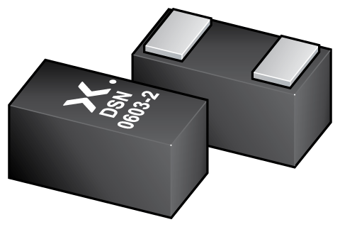

    30 V, 0.2 A low VF MEGA Schottky barrier rectifier
PMEG3002ESFYL 数据手册
PMEG3002ESF 30 V, 0.2 A low VF MEGA Schottky barrier rectifier 17 February 2015 Product data sheet 1. General description Planar Maximum Efficiency General Application (MEGA) Schottky barrier rectifier with an integrated guard ring for stress protection in a DSN0603-2 (SOD962-2) leadless ultra small Chip-Scale Package (CSP). 2. Features and benefits • • • • • Average forward current IF(AV) ≤ 0.2 A Reverse voltage VR ≤ 30 V Low forward voltage typ. VF = 310 mV Low reverse current typ. IR = 0.33 µA Package height typ. 0.3mm 3. Applications • • • • • Low voltage rectification High efficiency DC-to-DC conversion Switch mode power supply Ultra high speed switching LED backlight for mobile application 4. Quick reference data Table 1. Quick reference data Symbol Parameter Conditions IF(AV) average forward current δ = 0.5; f = 20 kHz; Tamb ≤ 140 °C; [1] Min Typ Max Unit - - 0.2 A - - 0.2 A square wave δ = 0.5; f = 20 kHz; Tsp ≤ 148 °C; square wave VR reverse voltage Tj = 25 °C - - 30 V VF forward voltage IF = 10 mA; tp ≤ 300 µs; δ ≤ 0.02; - 310 390 mV Tj = 25 °C IR reverse current VR = 10 V; Tj = 25 °C; pulsed - 0.33 2 µA trr reverse recovery time IF = 500 mA; IR = 500 mA; - 1.42 - ns IR(meas) = 100 mA; Tj = 25 °C [1] Device mounted on a ceramic Printed-Circuit Board (PCB), Al2O3, standard footprint. PMEG3002ESF Nexperia 30 V, 0.2 A low VF MEGA Schottky barrier rectifier 5. Pinning information Table 2. Pinning information Pin Symbol Description 1 K cathode[1] 2 A anode Simplified outline Graphic symbol 1 1 2 2 sym001 Transparent top view DSN0603-2 (SOD962-2) [1] The marking bar indicates the cathode. 6. Ordering information Table 3. Ordering information Type number PMEG3002ESF Package Name Description Version DSN0603-2 Leadless ultra small package; 2 terminals; body 0.6 x 0.3 x 0.3 mm SOD962-2 7. Marking Table 4. Marking codes Type number Marking code PMEG3002ESF K PMEG3002ESF Product data sheet All information provided in this document is subject to legal disclaimers. 17 February 2015 © Nexperia B.V. 2017. All rights reserved 2 / 14 PMEG3002ESF Nexperia 30 V, 0.2 A low VF MEGA Schottky barrier rectifier 8. Limiting values Table 5. Limiting values In accordance with the Absolute Maximum Rating System (IEC 60134). Symbol Parameter Conditions Min Max Unit VR reverse voltage Tj = 25 °C - 30 V IF forward current Tsp ≤ 145 °C; δ = 1 - 0.28 A IF(AV) average forward current δ = 0.5; f = 20 kHz; Tamb ≤ 140 °C; - 0.2 A - 0.2 A [1] square wave δ = 0.5; f = 20 kHz; Tsp ≤ 148 °C; square wave IFRM repetitive peak forward current tp = 1 ms; δ ≤ 0.25 - 1.5 A IFSM non-repetitive peak forward current tp = 8 ms; Tj(init) = 25 °C; square wave - 3.5 A Ptot total power dissipation Tamb ≤ 25 °C [2] - 405 mW [3] - 660 mW [1] - 1200 mW Tj junction temperature - 150 °C Tamb ambient temperature -55 150 °C Tstg storage temperature -65 150 °C [1] [2] [3] Device mounted on a ceramic Printed-Circuit Board (PCB), Al2O3, standard footprint. Device mounted on an FR4 PCB, single-sided copper, tin-plated and standard footprint. Device mounted on an FR4 PCB, single-sided copper, tin-plated, mounting pad for anode and cathode 2 1 cm each. 9. Thermal characteristics Table 6. Thermal characteristics Symbol Parameter Conditions Rth(j-a) thermal resistance from junction to ambient in free air Rth(j-sp) thermal resistance from junction to solder point [1] PMEG3002ESF Product data sheet Min Typ Max Unit [1][2] - - 310 K/W [1][3] - - 190 K/W [1][4] - - 105 K/W [5] - - 40 K/W [2] [3] For Schottky barrier diodes thermal runaway has to be considered, as in some applications the reverse power losses PR are a significant part of the total power losses. Device mounted on an FR4 PCB, single-sided copper, tin-plated and standard footprint. Device mounted on an FR4 PCB, single-sided copper, tin-plated, mounting pad for anode and cathode [4] [5] 1 cm each. Device mounted on a ceramic PCB, Al2O3, standard footprint. Soldering point of anode tab. 2 All information provided in this document is subject to legal disclaimers. 17 February 2015 © Nexperia B.V. 2017. All rights reserved 3 / 14 PMEG3002ESF Nexperia 30 V, 0.2 A low VF MEGA Schottky barrier rectifier aaa-006823 103 duty cycle = Zth(j-a) (K/W) 1 0.75 102 0.5 0.33 0.25 0.1 0.2 0.05 0.02 0.01 0 10 10-3 10-2 10-1 1 10 102 tp (s) 103 FR4 PCB, standard footprint Fig. 1. Transient thermal impedance from junction to ambient as a function of pulse duration; typical values aaa-006824 103 Zth(j-a) (K/W) duty cycle = 102 0.75 0.33 0.2 0.05 10 10-3 1 0.5 0.25 0.1 0.02 0.01 0 10-2 10-1 1 10 102 tp (s) 103 2 FR4 PCB, mounting pad for anode and cathode 1 cm each Fig. 2. Transient thermal impedance from junction to ambient as a function of pulse duration; typical values PMEG3002ESF Product data sheet All information provided in this document is subject to legal disclaimers. 17 February 2015 © Nexperia B.V. 2017. All rights reserved 4 / 14 PMEG3002ESF Nexperia 30 V, 0.2 A low VF MEGA Schottky barrier rectifier 102 aaa-006825 duty cycle = 1 0.75 Zth(j-a) (K/W) 0.5 0.33 0.2 0.25 0.1 0.05 0.02 0.01 0 10 10-3 10-2 10-1 1 10 102 tp (s) 103 Ceramic PCB, Al2O3, standard footprint Fig. 3. Transient thermal impedance from junction to ambient as a function of pulse duration; typical values PMEG3002ESF Product data sheet All information provided in this document is subject to legal disclaimers. 17 February 2015 © Nexperia B.V. 2017. All rights reserved 5 / 14 PMEG3002ESF Nexperia 30 V, 0.2 A low VF MEGA Schottky barrier rectifier 10. Characteristics Table 7. Characteristics Symbol Parameter Conditions Min Typ Max Unit V(BR)R reverse breakdown voltage IR = 100 µA; tp = 300 µs; δ = 0.02; 30 - - V Tj = 25 °C forward voltage IF = 0.1 mA; tp ≤ 300 µs; δ ≤ 0.02; - 185 255 mV - 245 320 mV - 310 390 mV - 405 480 mV - 460 535 mV VR = 10 V; Tj = 25 °C; pulsed - 0.33 2 µA VR = 30 V; Tj = 25 °C; pulsed - 1.8 9 µA VR = 1 V; f = 1 MHz; Tj = 25 °C - 21 - pF VR = 10 V; f = 1 MHz; Tj = 25 °C - 8 - pF IF = 500 mA; IR = 500 mA; - 1.42 - ns VF Tj = 25 °C IF = 1 mA; tp ≤ 300 µs; δ ≤ 0.02; Tj = 25 °C IF = 10 mA; tp ≤ 300 µs; δ ≤ 0.02; Tj = 25 °C IF = 100 mA; tp ≤ 300 µs; δ ≤ 0.02; Tj = 25 °C IF = 200 mA; tp ≤ 300 µs; δ ≤ 0.02; Tj = 25 °C IR Cd trr reverse current diode capacitance reverse recovery time IR(meas) = 100 mA; Tj = 25 °C PMEG3002ESF Product data sheet All information provided in this document is subject to legal disclaimers. 17 February 2015 © Nexperia B.V. 2017. All rights reserved 6 / 14 PMEG3002ESF Nexperia 30 V, 0.2 A low VF MEGA Schottky barrier rectifier aaa-011861 1 IF (A) IR (A) (1) 10-1 (2) aaa-011862 10-2 (1) 10-3 10-4 (2) 10-5 (3) 10-6 10-2 (4) 10-7 10-8 10-3 10-9 (3) 10-4 Fig. 4. 0 (4) 0.2 (5) 10-10 (5) 0.4 VF (V) 10-11 0.6 0 10 pulsed condition (1) Tj = 150 °C pulsed condition (1) Tj = 150 °C (2) Tj = 125 °C (2) Tj = 125 °C (3) Tj = 85 °C (3) Tj = 85 °C (4) Tj = 25 °C (4) Tj = 25 °C (5) Tj = −40 °C (5) Tj = −40 °C Forward current as a function of forward voltage; typical values Fig. 5. aaa-011863 40 20 Reverse current as a function of reverse voltage; typical values aaa-012791 0.12 CD (PF) (4) (3) PF(AV) (W) 30 30 VR (V) (2) 0.08 (1) 20 0.04 10 0 Fig. 6. 0 10 20 30 VR (V) 0 40 0 f = 1 MHz; Tamb = 25 °C Tj = 150 °C Diode capacitance as a function of reverse voltage; typical values (1) δ = 0.1 (2) δ = 0.2 (3) δ = 0.5 (4) δ = 1 Fig. 7. PMEG3002ESF Product data sheet 0.2 IF(AV) (A) 0.3 Average forward power dissipation as a function of average forward current; typical values All information provided in this document is subject to legal disclaimers. 17 February 2015 0.1 © Nexperia B.V. 2017. All rights reserved 7 / 14 PMEG3002ESF Nexperia 30 V, 0.2 A low VF MEGA Schottky barrier rectifier aaa-012792 0.025 PR(AV) (W) (1) IF(AV) (A) (2) 0.020 aaa-012793 0.3 (1) (3) 0.2 (4) (2) 0.015 0.010 (3) 0.1 (4) 0.005 0 0 10 20 VR (V) 0 30 Tj = 125 °C 25 50 75 Average reverse power dissipation as a function of reverse voltage; typical values aaa-012794 0.3 0.2 Fig. 9. Average forward current as a function of ambient temperature; typical values aaa-012795 (1) 0.2 (3) 0.1 (2) (3) 0.1 (4) 25 50 75 (4) 100 125 0 150 175 Tamb (°C) FR4 PCB, mounting pad for anode and cathode 1 25 50 75 100 125 150 175 Tamb (°C) Tj = 150 °C cm each Tj = 150 °C (1) δ = 1; DC (2) δ = 0.5; f = 20 kHz (3) δ = 0.2; f = 20 kHz (4) δ = 0.1; f = 20 kHz (1) δ = 1; DC (2) δ = 0.5; f = 20 kHz (3) δ = 0.2; f = 20 kHz (4) δ = 0.1; f = 20 kHz Fig. 10. Average forward current as a function of ambient temperature; typical values Product data sheet 0 Ceramic PCB, Al2O3, standard footprint 2 PMEG3002ESF 150 175 Tamb (°C) (1) δ = 1; DC (2) δ = 0.5; f = 20 kHz (3) δ = 0.2; f = 20 kHz (4) δ = 0.1; f = 20 kHz IF(AV) (A) (2) 0 125 0.3 (1) IF(AV) (A) 0 100 FR4 PCB, standard footprint Tj = 150 °C (1) δ = 1 (2) δ = 0.9 (3) δ = 0.8 (4) δ = 0.5 Fig. 8. 0 Fig. 11. Average forward current as a function of ambient temperature; typical values All information provided in this document is subject to legal disclaimers. 17 February 2015 © Nexperia B.V. 2017. All rights reserved 8 / 14 PMEG3002ESF Nexperia 30 V, 0.2 A low VF MEGA Schottky barrier rectifier aaa-012796 0.3 (1) IF(AV) (A) 0.2 (2) (3) 0.1 (4) 0 0 25 50 75 100 125 150 175 Tsp (°C) Tj = 150 °C (1) δ = 1; DC (2) δ = 0.5; f = 20 kHz (3) δ = 0.2; f = 20 kHz (4) δ = 0.1; f = 20 kHz Fig. 12. Average forward current as a function of solder point temperature; typical values 11. Test information IF IR(meas) time IR trr 006aad022 Fig. 13. Reverse recovery definition P tcy duty cycle δ = tp tcy tp t 006aac658 Fig. 14. Duty cycle definition PMEG3002ESF Product data sheet All information provided in this document is subject to legal disclaimers. 17 February 2015 © Nexperia B.V. 2017. All rights reserved 9 / 14 PMEG3002ESF Nexperia 30 V, 0.2 A low VF MEGA Schottky barrier rectifier The current ratings for the typical waveforms are calculated according to the equations: IF(AV) = IM × δ with IM defined as peak current, IRMS = IF(AV) at DC, and IRMS = IM × √δ with IRMS defined as RMS current. 12. Package outline 0.325 0.275 0.32 0.28 1 0.03 max 0.15 0.13 0.4 0.625 0.575 2 Dimensions in mm 0.25 0.23 14-12-03 Fig. 15. Package outline DSN0603-2 (SOD962-2) 13. Soldering Footprint information for reflow soldering of leadless ultra small package; 2 terminals SOD962-2 0.85 0.4 0.4 R0.025 (8×) 0.24 (2×) 0.14 (2×) 0.2 (2×) solder land solder land plus solder paste solder paste deposit solder resist Dimensions in mm sod962-2_fr Fig. 16. Reflow soldering footprint for DSN0603-2 (SOD962-2) PMEG3002ESF Product data sheet All information provided in this document is subject to legal disclaimers. 17 February 2015 © Nexperia B.V. 2017. All rights reserved 10 / 14 PMEG3002ESF Nexperia 30 V, 0.2 A low VF MEGA Schottky barrier rectifier 14. Revision history Table 8. Revision history Data sheet ID Release date Data sheet status Change notice Supersedes PMEG3002ESF v.2 20150217 Product data sheet - PMEG3002ESF v.1 Modifications: • PMEG3002ESF v.1 20140415 - - PMEG3002ESF Product data sheet Product status changed Preliminary data sheet All information provided in this document is subject to legal disclaimers. 17 February 2015 © Nexperia B.V. 2017. All rights reserved 11 / 14 PMEG3002ESF Nexperia 30 V, 0.2 A low VF MEGA Schottky barrier rectifier In no event shall Nexperia be liable for any indirect, incidental, punitive, special or consequential damages (including - without limitation lost profits, lost savings, business interruption, costs related to the removal or replacement of any products or rework charges) whether or not such damages are based on tort (including negligence), warranty, breach of contract or any other legal theory. 15. Legal information 15.1 Data sheet status Notwithstanding any damages that customer might incur for any reason whatsoever, Nexperia’s aggregate and cumulative liability towards customer for the products described herein shall be limited in accordance with the Terms and conditions of commercial sale of Nexperia. Document status [1][2] Product status [3] Objective [short] data sheet Development This document contains data from the objective specification for product development. Preliminary [short] data sheet Qualification This document contains data from the preliminary specification. Product [short] data sheet Production This document contains the product specification. [1] [2] [3] Definition Please consult the most recently issued document before initiating or completing a design. The term 'short data sheet' is explained in section "Definitions". The product status of device(s) described in this document may have changed since this document was published and may differ in case of multiple devices. The latest product status information is available on the Internet at URL http://www.nexperia.com. 15.2 Definitions Preview — The document is a preview version only. The document is still subject to formal approval, which may result in modifications or additions. Nexperia does not give any representations or warranties as to the accuracy or completeness of information included herein and shall have no liability for the consequences of use of such information. Draft — The document is a draft version only. The content is still under internal review and subject to formal approval, which may result in modifications or additions. Nexperia does not give any representations or warranties as to the accuracy or completeness of information included herein and shall have no liability for the consequences of use of such information. Short data sheet — A short data sheet is an extract from a full data sheet with the same product type number(s) and title. A short data sheet is intended for quick reference only and should not be relied upon to contain detailed and full information. For detailed and full information see the relevant full data sheet, which is available on request via the local Nexperia sales office. In case of any inconsistency or conflict with the short data sheet, the full data sheet shall prevail. Product specification — The information and data provided in a Product data sheet shall define the specification of the product as agreed between Nexperia and its customer, unless Nexperia and customer have explicitly agreed otherwise in writing. In no event however, shall an agreement be valid in which the Nexperia product is deemed to offer functions and qualities beyond those described in the Product data sheet. 15.3 Disclaimers Limited warranty and liability — Information in this document is believed to be accurate and reliable. However, Nexperia does not give any representations or warranties, expressed or implied, as to the accuracy or completeness of such information and shall have no liability for the consequences of use of such information. Nexperia takes no responsibility for the content in this document if provided by an information source outside of Nexperia. PMEG3002ESF Product data sheet Right to make changes — Nexperia reserves the right to make changes to information published in this document, including without limitation specifications and product descriptions, at any time and without notice. This document supersedes and replaces all information supplied prior to the publication hereof. Suitability for use — Nexperia products are not designed, authorized or warranted to be suitable for use in life support, life-critical or safety-critical systems or equipment, nor in applications where failure or malfunction of a Nexperia product can reasonably be expected to result in personal injury, death or severe property or environmental damage. Nexperia and its suppliers accept no liability for inclusion and/or use of Nexperia products in such equipment or applications and therefore such inclusion and/or use is at the customer’s own risk. Quick reference data — The Quick reference data is an extract of the product data given in the Limiting values and Characteristics sections of this document, and as such is not complete, exhaustive or legally binding. Applications — Applications that are described herein for any of these products are for illustrative purposes only. Nexperia makes no representation or warranty that such applications will be suitable for the specified use without further testing or modification. Customers are responsible for the design and operation of their applications and products using Nexperia products, and Nexperia accepts no liability for any assistance with applications or customer product design. It is customer’s sole responsibility to determine whether the Nexperia product is suitable and fit for the customer’s applications and products planned, as well as for the planned application and use of customer’s third party customer(s). Customers should provide appropriate design and operating safeguards to minimize the risks associated with their applications and products. Nexperia does not accept any liability related to any default, damage, costs or problem which is based on any weakness or default in the customer’s applications or products, or the application or use by customer’s third party customer(s). Customer is responsible for doing all necessary testing for the customer’s applications and products using Nexperia products in order to avoid a default of the applications and the products or of the application or use by customer’s third party customer(s). Nexperia does not accept any liability in this respect. Limiting values — Stress above one or more limiting values (as defined in the Absolute Maximum Ratings System of IEC 60134) will cause permanent damage to the device. Limiting values are stress ratings only and (proper) operation of the device at these or any other conditions above those given in the Recommended operating conditions section (if present) or the Characteristics sections of this document is not warranted. Constant or repeated exposure to limiting values will permanently and irreversibly affect the quality and reliability of the device. Terms and conditions of commercial sale — Nexperia products are sold subject to the general terms and conditions of commercial sale, as published at http://www.nexperia.com/profile/terms, unless otherwise agreed in a valid written individual agreement. In case an individual agreement is concluded only the terms and conditions of the respective agreement shall apply. Nexperia hereby expressly objects to applying the customer’s general terms and conditions with regard to the purchase of Nexperia products by customer. No offer to sell or license — Nothing in this document may be interpreted or construed as an offer to sell products that is open for acceptance or the All information provided in this document is subject to legal disclaimers. 17 February 2015 © Nexperia B.V. 2017. All rights reserved 12 / 14 PMEG3002ESF Nexperia 30 V, 0.2 A low VF MEGA Schottky barrier rectifier grant, conveyance or implication of any license under any copyrights, patents or other industrial or intellectual property rights. Export control — This document as well as the item(s) described herein may be subject to export control regulations. Export might require a prior authorization from competent authorities. Non-automotive qualified products — Unless this data sheet expressly states that this specific Nexperia product is automotive qualified, the product is not suitable for automotive use. It is neither qualified nor tested in accordance with automotive testing or application requirements. Nexperia accepts no liability for inclusion and/or use of nonautomotive qualified products in automotive equipment or applications. In the event that customer uses the product for design-in and use in automotive applications to automotive specifications and standards, customer (a) shall use the product without Nexperia’s warranty of the product for such automotive applications, use and specifications, and (b) whenever customer uses the product for automotive applications beyond Nexperia’s specifications such use shall be solely at customer’s own risk, and (c) customer fully indemnifies Nexperia for any liability, damages or failed product claims resulting from customer design and use of the product for automotive applications beyond Nexperia’s standard warranty and Nexperia’s product specifications. Translations — A non-English (translated) version of a document is for reference only. The English version shall prevail in case of any discrepancy between the translated and English versions. 15.4 Trademarks Notice: All referenced brands, product names, service names and trademarks are the property of their respective owners. PMEG3002ESF Product data sheet All information provided in this document is subject to legal disclaimers. 17 February 2015 © Nexperia B.V. 2017. All rights reserved 13 / 14 PMEG3002ESF Nexperia 30 V, 0.2 A low VF MEGA Schottky barrier rectifier 16. Contents 1 General description ............................................... 1 2 Features and benefits ............................................1 3 Applications ........................................................... 1 4 Quick reference data ............................................. 1 5 Pinning information ............................................... 2 6 Ordering information ............................................. 2 7 Marking ................................................................... 2 8 Limiting values .......................................................3 9 Thermal characteristics .........................................3 10 Characteristics ....................................................... 6 11 Test information ..................................................... 9 12 Package outline ................................................... 10 13 Soldering .............................................................. 10 14 Revision history ................................................... 11 15 15.1 15.2 15.3 15.4 Legal information .................................................12 Data sheet status ............................................... 12 Definitions ...........................................................12 Disclaimers .........................................................12 Trademarks ........................................................ 13 © Nexperia B.V. 2017. All rights reserved For more information, please visit: http://www.nexperia.com For sales office addresses, please send an email to: salesaddresses@nexperia.com Date of release: 17 February 2015 PMEG3002ESF Product data sheet All information provided in this document is subject to legal disclaimers. 17 February 2015 © Nexperia B.V. 2017. All rights reserved 14 / 14
