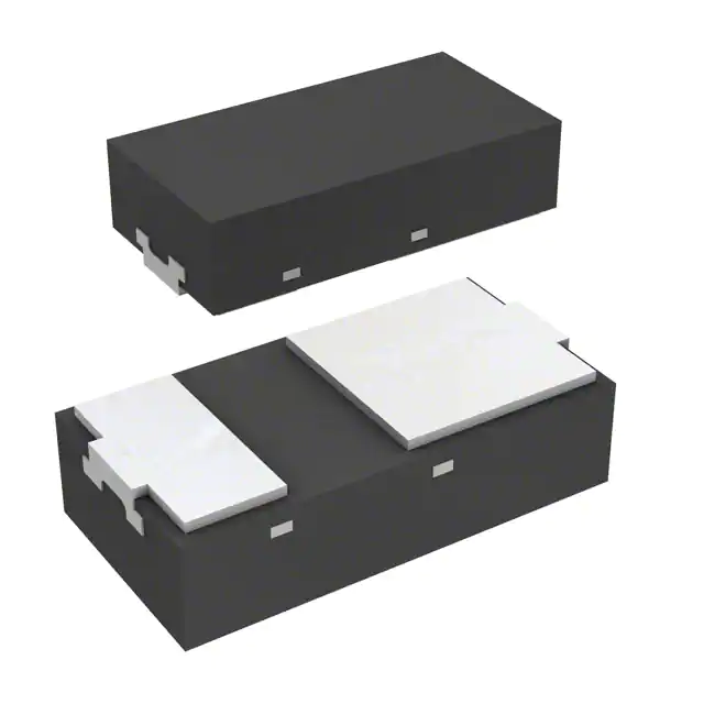

    直流反向耐压(Vr):40V 平均整流电流(Io):500mA 正向压降(Vf):590mV@500mA
PMEG4005EPK,315 数据手册
PMEG4005EPK 40 V, 0.5 A low VF MEGA Schottky barrier rectifier 30 April 2020 Product data sheet 1. General description Planar Maximum Efficiency General Application (MEGA) Schottky barrier rectifier with an integrated guard ring for stress protection, encapsulated in a leadless ultra small SOD1608 (DFN1608D-2) Surface-Mounted Device (SMD) plastic package with visible and solderable side pads. 2. Features and benefits • • • • • • • • Average forward current: IF(AV) ≤ 0.5 A Reverse voltage: VR ≤ 40 V Low forward voltage VF ≤ 590 mV Low reverse current Solderable side pads Package height typ. 0.37 mm Ultra small and leadless SMD plastic package AEC-Q101 qualified 3. Applications • • • • • • • Low voltage rectification High efficiency DC-to-DC conversion Switch mode power supply LED backlight for mobile application Low power consumption applications Ultra high-speed switching Reverse polarity protection 4. Quick reference data Table 1. Quick reference data Symbol Parameter IF(AV) average forward current Conditions Min Typ Max Unit δ = 0.5; square wave; f = 20 kHz; Tamb ≤ [1] 115 °C - - 0.5 A δ = 0.5; square wave; f = 20 kHz; Tsp ≤ 140 °C - - 0.5 A VR reverse voltage Tj = 25 °C - - 40 V VF forward voltage IF = 500 mA; tp ≤ 300 µs; δ ≤ 0.02; pulsed; Tj = 25 °C - 530 590 mV IR reverse current VR = 10 V; Tj = 25 °C - 0.4 2 µA trr reverse recovery time IF = 0.5 A; IR = 0.5 A; IR(meas) = 0.1 A; Tj = 25 °C - 2 - ns [1] Device mounted on a ceramic Printed-Circuit Board (PCB), Al2O3, standard footprint. PMEG4005EPK Nexperia 40 V, 0.5 A low VF MEGA Schottky barrier rectifier 5. Pinning information Table 2. Pinning information Pin Symbol Description 1 K cathode[1] 2 A anode Simplified outline Graphic symbol K 1 2 A sym001 Transparent top view DFN1608D-2 (SOD1608) [1] The marking bar indicates the cathode. 6. Ordering information Table 3. Ordering information Type number Package PMEG4005EPK Name Description Version DFN1608D-2 plastic, leadless ultra small plastic package with side-wettable flanks (SWF); 2 terminals; 0.94 mm pitch; 1.6 mm x 0.8 mm x 0.37 mm body SOD1608 7. Marking Table 4. Marking codes Type number Marking code PMEG4005EPK 0010 0000 VENDOR CODE CATHODE BAR READING DIRECTION READING EXAMPLE: 0111 1011 MARKING CODE (EXAMPLE) READING DIRECTION 006aac909 Fig. 1. SOD1608 binary marking code description PMEG4005EPK Product data sheet All information provided in this document is subject to legal disclaimers. 30 April 2020 © Nexperia B.V. 2020. All rights reserved 2 / 12 PMEG4005EPK Nexperia 40 V, 0.5 A low VF MEGA Schottky barrier rectifier 8. Limiting values Table 5. Limiting values In accordance with the Absolute Maximum Rating System (IEC 60134). Symbol Parameter Conditions Min Max Unit VR reverse voltage Tj = 25 °C - 40 V IF forward current Tsp ≤ 135 °C - 0.7 A IF(AV) average forward current δ = 0.5; square wave; f = 20 kHz; Tamb ≤ 115 °C - 0.5 A δ = 0.5; square wave; f = 20 kHz; Tsp ≤ 140 °C - 0.5 A [1] IFRM repetitive peak forward current tp ≤ 1 ms; δ ≤ 0.25 - 2 A IFSM non-repetitive peak forward current tp = 8 ms; square wave; Tj(init) = 25 °C - 3 A Ptot total power dissipation Tamb ≤ 25 °C [2] [3] - 390 mW [4] [3] - 830 mW [1] [3] - 1470 mW Tj junction temperature - 150 °C Tamb ambient temperature -55 150 °C Tstg storage temperature -65 150 °C [1] [2] [3] [4] Device mounted on a ceramic Printed-Circuit Board (PCB), Al2O3, standard footprint. Device mounted on an FR4 PCB, single-sided copper, tin-plated and standard footprint. Reflow soldering is the only recommended soldering method. 2 Device mounted on an FR4 PCB, single-sided copper, tin-plated, mounting pad for cathode 1 cm . 9. Thermal characteristics Table 6. Thermal characteristics Symbol Parameter Rth(j-a) Rth(j-sp) [1] [2] [3] [4] [5] [6] Conditions thermal resistance from in free air junction to ambient thermal resistance from junction to solder point Min Typ Max Unit [1] [2] [3] - - 320 K/W [1] [4] [3] - - 150 K/W [1] [5] [3] - - 85 K/W [6] - - 20 K/W For Schottky barrier diodes thermal runaway has to be considered, as in some applications the reverse power losses PR are a significant part of the total power losses. Device mounted on an FR4 PCB, single-sided copper, tin-plated and standard footprint. Reflow soldering is the only recommended soldering method. 2 Device mounted on an FR4 PCB, single-sided copper, tin-plated, mounting pad for cathode 1 cm . Device mounted on a ceramic PCB, Al2O3, standard footprint. Soldering point of cathode tab. PMEG4005EPK Product data sheet All information provided in this document is subject to legal disclaimers. 30 April 2020 © Nexperia B.V. 2020. All rights reserved 3 / 12 PMEG4005EPK Nexperia 40 V, 0.5 A low VF MEGA Schottky barrier rectifier 006aad010 103 duty cycle = Zth(j-a) (K/W) 1 0.75 0.5 102 0.33 0.25 0.2 0.1 0.05 0 0.02 0.01 10 10-3 10-2 10-1 1 10 102 tp (s) 103 FR4 PCB, standard footprint Fig. 2. Transient thermal impedance from junction to ambient as a function of pulse duration; typical values 006aad011 103 Zth(j-a) (K/W) duty cycle = 102 0.75 0.33 0.2 1 0.5 0.25 0.1 0.05 0 10 10-3 0.02 0.01 10-2 10-1 FR4 PCB, mounting pad for cathode 1 cm Fig. 3. 1 10 102 tp (s) 2 103 Transient thermal impedance from junction to ambient as a function of pulse duration; typical values 102 006aad012 duty cycle = 1 0.75 Zth(j-a) (K/W) 0.5 0.33 0.25 0.2 0.1 0 0.05 0.02 0.01 10 10-3 10-2 10-1 1 10 102 tp (s) 103 Ceramic PCB, Al2O3, standard footprint Fig. 4. Transient thermal impedance from junction to ambient as a function of pulse duration; typical values PMEG4005EPK Product data sheet All information provided in this document is subject to legal disclaimers. 30 April 2020 © Nexperia B.V. 2020. All rights reserved 4 / 12 PMEG4005EPK Nexperia 40 V, 0.5 A low VF MEGA Schottky barrier rectifier 10. Characteristics Table 7. Characteristics Symbol Parameter VF forward voltage IR reverse current Conditions Min Typ Max Unit IF = 100 mA; tp ≤ 300 µs; δ ≤ 0.02; pulsed; Tj = 25 °C - 380 420 mV IF = 500 mA; tp ≤ 300 µs; δ ≤ 0.02; pulsed; Tj = 25 °C - 530 590 mV VR = 10 V; Tj = 25 °C - 0.4 2 µA VR = 40 V; Tj = 25 °C - 2 10 µA VR = 1 V; f = 1 MHz; Tj = 25 °C - 30 35 pF Cd diode capacitance VR = 10 V; f = 1 MHz; Tj = 25 °C - 10 15 pF trr reverse recovery time IF = 0.5 A; IR = 0.5 A; IR(meas) = 0.1 A; Tj = 25 °C - 2 - ns VFRM peak forward recovery voltage IF = 0.5 A; dIF/dt = 20 A/µs; Tj = 25 °C - 545 - mV 006aad013 10 IR (A) IF (A) 1 006aad014 10-3 (1) 10-4 (2) 10-5 (1) 10-1 10-6 (2) (3) 10-7 (3) (4) (5) 10-2 10-8 (4) 10-9 10-3 10-10 10-4 0.0 0.4 0.8 VF (V) 1.2 (1) Tj = 150 °C (2) Tj = 125 °C (3) Tj = 85 °C (4) Tj = 25 °C (5) Tj = −40 °C Fig. 5. Product data sheet 0 10 20 30 VR (V) 40 (1) Tj = 125 °C (2) Tj = 85 °C (3) Tj = 25 °C (4) Tj = −40 °C Forward current as a function of forward voltage; typical values PMEG4005EPK 10-11 Fig. 6. Reverse current as a function of reverse voltage; typical values All information provided in this document is subject to legal disclaimers. 30 April 2020 © Nexperia B.V. 2020. All rights reserved 5 / 12 PMEG4005EPK Nexperia 40 V, 0.5 A low VF MEGA Schottky barrier rectifier 006aad015 50 Cd (pF) 006aad016 0.4 PF(AV) (W) 40 (4) (3) 0.3 30 (2) 0.2 (1) 20 0.1 10 0 0 10 20 30 VR (V) 0.0 0.00 40 f = 1 MHz; Tamb = 25 °C Fig. 7. Fig. 8. 006aad017 PR(AV) (W) 0.75 006aad018 0.75 (1) (2) 0.50 (1) 0.03 IF(AV) (A) Average forward power dissipation as a function of average forward current; typical values IF(AV) (A) 0.04 0.50 Tj = 150 °C (1) δ = 0.1 (2) δ = 0.2 (3) δ = 0.5 (4) δ = 1 Diode capacitance as a function of reverse voltage; typical values 0.05 0.25 (2) (3) (3) 0.02 0.25 0.01 0.00 (4) (4) 0 10 20 30 VR (V) 0.00 40 Tj = 125 °C (1) δ = 1 (2) δ = 0.9 (3) δ = 0.8 (4) δ = 0.5 Fig. 9. Average reverse power dissipation as a function of reverse voltage; typical values PMEG4005EPK Product data sheet 0 25 50 75 100 125 150 175 Tamb (°C) FR4 PCB, standard footprint Tj = 150 °C (1) δ = 1 (DC) (2) δ = 0.5; f = 20 kHz (3) δ = 0.2; f = 20 kHz (4) δ = 0.1; f = 20 kHz Fig. 10. Average forward current as a function of ambient temperature; typical values All information provided in this document is subject to legal disclaimers. 30 April 2020 © Nexperia B.V. 2020. All rights reserved 6 / 12 PMEG4005EPK Nexperia 40 V, 0.5 A low VF MEGA Schottky barrier rectifier 006aad019 0.75 (1) IF(AV) (A) (1) IF(AV) (A) (2) 0.50 006aad020 0.75 (2) 0.50 (3) (3) 0.25 0.25 (4) 0.00 0 (4) 25 50 75 100 125 0.00 150 175 Tamb (°C) 2 FR4 PCB, mounting pad for cathode 1 cm Tj = 150 °C (1) δ = 1 (DC) (2) δ = 0.5; f = 20 kHz (3) δ = 0.2; f = 20 kHz (4) δ = 0.1; f = 20 kHz 0 25 50 75 100 125 150 175 Tamb (°C) Ceramic PCB, Al2O3, standard footprint Tj = 150 °C (1) δ = 1 (DC) (2) δ = 0.5; f = 20 kHz (3) δ = 0.2; f = 20 kHz (4) δ = 0.1; f = 20 kHz Fig. 11. Average forward current as a function of ambient temperature; typical values Fig. 12. Average forward current as a function of ambient temperature; typical values 006aad021 0.75 (1) IF(AV) (A) (2) 0.50 (3) 0.25 (4) 0.00 0 25 50 75 100 125 150 175 Tsp (°C) Tj = 150 °C (1) δ = 1 (DC) (2) δ = 0.5; f = 20 kHz (3) δ = 0.2; f = 20 kHz (4) δ = 0.1; f = 20 kHz Fig. 13. Average forward current as a function of solder point temperature; typical values PMEG4005EPK Product data sheet All information provided in this document is subject to legal disclaimers. 30 April 2020 © Nexperia B.V. 2020. All rights reserved 7 / 12 PMEG4005EPK Nexperia 40 V, 0.5 A low VF MEGA Schottky barrier rectifier 11. Test information IF IR(meas) time IR trr 006aad022 Fig. 14. Reverse recovery definition IF time VF VFRM VF time 001aab912 Fig. 15. Forward recovery definition P tcy duty cycle δ = tp tcy tp t 006aac658 Fig. 16. Duty cycle definition The current ratings for the typical waveforms are calculated according to the equations: IF(AV) = IM × δ with IM defined as peak current, IRMS = IF(AV) at DC, and IRMS = IM × √δ with IRMS defined as RMS current. Quality information This product has been qualified in accordance with the Automotive Electronics Council (AEC) standard Q101 - Stress test qualification for discrete semiconductors, and is suitable for use in automotive applications. PMEG4005EPK Product data sheet All information provided in this document is subject to legal disclaimers. 30 April 2020 © Nexperia B.V. 2020. All rights reserved 8 / 12 PMEG4005EPK Nexperia 40 V, 0.5 A low VF MEGA Schottky barrier rectifier 12. Package outline 0.85 0.75 1 0.40 0.34 0.80 0.72 1.65 1.55 0.40 0.32 2 0.75 0.67 0.04 Dimensions in mm 11-11-21 Fig. 17. Package outline DFN1608D-2 (SOD1608) 13. Soldering Footprint information for reflow soldering of DFN1608D-2 package SOD1608 1.15 0.75 1.05 0.65 0.95 0.55 0.9 0.8 0.7 0.7 0.8 0.9 1 2 0.1 1.8 0.2 1.9 2.0 solder land solder land plus solder paste solder paste deposit solder resist Dimensions in mm sod1608_fr Fig. 18. Reflow soldering footprint for DFN1608D-2 (SOD1608) PMEG4005EPK Product data sheet All information provided in this document is subject to legal disclaimers. 30 April 2020 © Nexperia B.V. 2020. All rights reserved 9 / 12 PMEG4005EPK Nexperia 40 V, 0.5 A low VF MEGA Schottky barrier rectifier 14. Revision history Table 8. Revision history Data sheet ID Release date Data sheet status Change notice Supersedes PMEG4005EPK v.3 20200430 Product data sheet - PMEG4005EPK v.2 Modifications: • • The format of this data sheet has been redesigned to comply with the identity guidelines of Nexperia. Legal texts have been adapted to the new company name where appropriate. PMEG4005EPK v.2 20120306 Product data sheet - PMEG4005EPK v.1 PMEG4005EPK v.1 20120306 Product data sheet - - PMEG4005EPK Product data sheet All information provided in this document is subject to legal disclaimers. 30 April 2020 © Nexperia B.V. 2020. All rights reserved 10 / 12 PMEG4005EPK Nexperia 40 V, 0.5 A low VF MEGA Schottky barrier rectifier equipment, nor in applications where failure or malfunction of an Nexperia product can reasonably be expected to result in personal injury, death or severe property or environmental damage. Nexperia and its suppliers accept no liability for inclusion and/or use of Nexperia products in such equipment or applications and therefore such inclusion and/or use is at the customer's own risk. 15. Legal information Data sheet status Document status [1][2] Product status [3] Definition Quick reference data — The Quick reference data is an extract of the product data given in the Limiting values and Characteristics sections of this document, and as such is not complete, exhaustive or legally binding. Objective [short] data sheet Development This document contains data from the objective specification for product development. Preliminary [short] data sheet Qualification This document contains data from the preliminary specification. Applications — Applications that are described herein for any of these products are for illustrative purposes only. Nexperia makes no representation or warranty that such applications will be suitable for the specified use without further testing or modification. Product [short] data sheet Production This document contains the product specification. [1] [2] [3] Please consult the most recently issued document before initiating or completing a design. The term 'short data sheet' is explained in section "Definitions". The product status of device(s) described in this document may have changed since this document was published and may differ in case of multiple devices. The latest product status information is available on the internet at https://www.nexperia.com. Definitions Draft — The document is a draft version only. The content is still under internal review and subject to formal approval, which may result in modifications or additions. Nexperia does not give any representations or warranties as to the accuracy or completeness of information included herein and shall have no liability for the consequences of use of such information. Short data sheet — A short data sheet is an extract from a full data sheet with the same product type number(s) and title. A short data sheet is intended for quick reference only and should not be relied upon to contain detailed and full information. For detailed and full information see the relevant full data sheet, which is available on request via the local Nexperia sales office. In case of any inconsistency or conflict with the short data sheet, the full data sheet shall prevail. Product specification — The information and data provided in a Product data sheet shall define the specification of the product as agreed between Nexperia and its customer, unless Nexperia and customer have explicitly agreed otherwise in writing. In no event however, shall an agreement be valid in which the Nexperia product is deemed to offer functions and qualities beyond those described in the Product data sheet. Disclaimers Limited warranty and liability — Information in this document is believed to be accurate and reliable. However, Nexperia does not give any representations or warranties, expressed or implied, as to the accuracy or completeness of such information and shall have no liability for the consequences of use of such information. Nexperia takes no responsibility for the content in this document if provided by an information source outside of Nexperia. In no event shall Nexperia be liable for any indirect, incidental, punitive, special or consequential damages (including - without limitation - lost profits, lost savings, business interruption, costs related to the removal or replacement of any products or rework charges) whether or not such damages are based on tort (including negligence), warranty, breach of contract or any other legal theory. Customers are responsible for the design and operation of their applications and products using Nexperia products, and Nexperia accepts no liability for any assistance with applications or customer product design. It is customer’s sole responsibility to determine whether the Nexperia product is suitable and fit for the customer’s applications and products planned, as well as for the planned application and use of customer’s third party customer(s). Customers should provide appropriate design and operating safeguards to minimize the risks associated with their applications and products. Nexperia does not accept any liability related to any default, damage, costs or problem which is based on any weakness or default in the customer’s applications or products, or the application or use by customer’s third party customer(s). Customer is responsible for doing all necessary testing for the customer’s applications and products using Nexperia products in order to avoid a default of the applications and the products or of the application or use by customer’s third party customer(s). Nexperia does not accept any liability in this respect. Limiting values — Stress above one or more limiting values (as defined in the Absolute Maximum Ratings System of IEC 60134) will cause permanent damage to the device. Limiting values are stress ratings only and (proper) operation of the device at these or any other conditions above those given in the Recommended operating conditions section (if present) or the Characteristics sections of this document is not warranted. Constant or repeated exposure to limiting values will permanently and irreversibly affect the quality and reliability of the device. Terms and conditions of commercial sale — Nexperia products are sold subject to the general terms and conditions of commercial sale, as published at http://www.nexperia.com/profile/terms, unless otherwise agreed in a valid written individual agreement. In case an individual agreement is concluded only the terms and conditions of the respective agreement shall apply. Nexperia hereby expressly objects to applying the customer’s general terms and conditions with regard to the purchase of Nexperia products by customer. No offer to sell or license — Nothing in this document may be interpreted or construed as an offer to sell products that is open for acceptance or the grant, conveyance or implication of any license under any copyrights, patents or other industrial or intellectual property rights. Export control — This document as well as the item(s) described herein may be subject to export control regulations. Export might require a prior authorization from competent authorities. Translations — A non-English (translated) version of a document is for reference only. The English version shall prevail in case of any discrepancy between the translated and English versions. Trademarks Notice: All referenced brands, product names, service names and trademarks are the property of their respective owners. Notwithstanding any damages that customer might incur for any reason whatsoever, Nexperia’s aggregate and cumulative liability towards customer for the products described herein shall be limited in accordance with the Terms and conditions of commercial sale of Nexperia. Right to make changes — Nexperia reserves the right to make changes to information published in this document, including without limitation specifications and product descriptions, at any time and without notice. This document supersedes and replaces all information supplied prior to the publication hereof. Suitability for use in automotive applications — This Nexperia product has been qualified for use in automotive applications. Unless otherwise agreed in writing, the product is not designed, authorized or warranted to be suitable for use in life support, life-critical or safety-critical systems or PMEG4005EPK Product data sheet All information provided in this document is subject to legal disclaimers. 30 April 2020 © Nexperia B.V. 2020. All rights reserved 11 / 12 PMEG4005EPK Nexperia 40 V, 0.5 A low VF MEGA Schottky barrier rectifier Contents 1. General description...................................................... 1 2. Features and benefits.................................................. 1 3. Applications.................................................................. 1 4. Quick reference data....................................................1 5. Pinning information......................................................2 6. Ordering information....................................................2 7. Marking.......................................................................... 2 8. Limiting values............................................................. 3 9. Thermal characteristics............................................... 3 10. Characteristics............................................................ 5 11. Test information.......................................................... 8 12. Package outline.......................................................... 9 13. Soldering..................................................................... 9 14. Revision history........................................................10 15. Legal information......................................................11 © Nexperia B.V. 2020. All rights reserved For more information, please visit: http://www.nexperia.com For sales office addresses, please send an email to: salesaddresses@nexperia.com Date of release: 30 April 2020 PMEG4005EPK Product data sheet All information provided in this document is subject to legal disclaimers. 30 April 2020 © Nexperia B.V. 2020. All rights reserved 12 / 12
