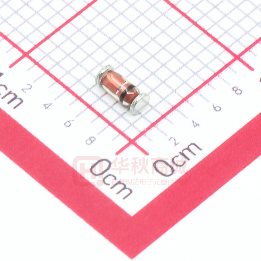

    开关二极管(小信号) 125V Φ1.60 x 3.70mm SMT SOD80C 250mA
BAS45AL,115 数据手册
BAS45AL Low-leakage diode Rev. 5 — 6 August 2010 Product data sheet 1. Product profile 1.1 General description Epitaxial medium-speed switching diode with a low leakage current, encapsulated in a small hermetically sealed glass SOD80C Surface-Mounted Device (SMD) package. 1.2 Features and benefits „ „ „ „ Continuous reverse voltage: max. 125 V Repetitive peak forward current: max. 625 mA Low reverse current: max. 1 nA Switching time: typ. 1.5 μs 1.3 Applications „ Low leakage current applications 1.4 Quick reference data Table 1. Quick reference data Symbol Parameter IF forward current VR reverse voltage VF forward voltage [1] Conditions [1] IF = 100 mA Min Typ Max Unit - - 250 mA - - 125 V - - 1000 mV Device mounted on an FR4 Printed-Circuit Board (PCB), single-sided copper, tin-plated and standard footprint. 2. Pinning information Table 2. Pin Pinning Description 1 cathode 2 anode Simplified outline Graphic symbol [1] k a 1 2 006aab040 [1] The marking band indicates the cathode. BAS45AL Nexperia Low-leakage diode 3. Ordering information Table 3. Ordering information Type number BAS45AL Package Name Description Version - hermetically sealed glass surface-mounted package; 2 connectors SOD80C 4. Marking Table 4. Marking codes Type number Marking code BAS45AL marking band 5. Limiting values Table 5. Limiting values In accordance with the Absolute Maximum Rating System (IEC 60134). Symbol Parameter VRRM repetitive peak reverse voltage Conditions VR reverse voltage IF forward current IFRM repetitive peak forward current IFSM non-repetitive peak forward current [1] Product data sheet Max Unit 125 V - 125 V - 250 mA - 625 mA tp = 1 μs - 4 A tp = 1 ms - 1 A - 0.5 A - 400 mW square wave [2] tp = 1 s BAS45AL Min - Tamb ≤ 25 °C [1] Ptot total power dissipation Tj junction temperature - 175 °C Tstg storage temperature −65 +175 °C [1] Device mounted on an FR4 PCB, single-sided copper, tin-plated and standard footprint. [2] Tj = 25 °C prior to surge. All information provided in this document is subject to legal disclaimers. Rev. 5 — 6 August 2010 © Nexperia B.V. 2010. All rights reserved. 2 of 11 BAS45AL Nexperia Low-leakage diode 6. Thermal characteristics Table 6. Thermal characteristics Symbol Parameter Rth(j-t) thermal resistance from junction to tie-point Rth(j-a) thermal resistance from junction to ambient [1] Conditions in free air [1] Min Typ Max Unit - - 300 K/W - - 375 K/W Device mounted on an FR4 PCB, single-sided copper, tin-plated and standard footprint. 7. Characteristics Table 7. Characteristics Tj = 25 °C unless otherwise specified. Symbol Parameter Conditions Min Typ Max Unit VF forward voltage IF = 1 mA - - 780 mV IF = 10 mA - - 860 mV IF = 100 mA - - 1000 mV VR = 125 V - - 1 nA VR = 30 V; Tj = 125 °C - - 300 nA VR = 125 V; Tj = 125 °C - - 500 nA VR = 125 V; Tj = 150 °C - - 2 μA - - 4 pF - 1.5 - μs IR Cd trr [1] BAS45AL Product data sheet reverse current diode capacitance Emax = 100 lx VR = 0 V; f = 1 MHz reverse recovery time [1] When switched from IF = 10 mA to IR = 10 mA; RL = 100 Ω; measured at IR = 1 mA. All information provided in this document is subject to legal disclaimers. Rev. 5 — 6 August 2010 © Nexperia B.V. 2010. All rights reserved. 3 of 11 BAS45AL Nexperia Low-leakage diode mbg522 300 mbg523 300 IF (mA) IF (mA) (1) 200 200 100 100 (2) (3) 0 0 0 100 Tamb (°C) 0 200 0.5 1.0 VF (V) 1.5 (1) Tj = 150 °C; typical values FR4 PCB, standard footprint (2) Tj = 25 °C; typical values (3) Tj = 25 °C; maximum values Fig 1. Forward current as a function of ambient temperature; derating curve Fig 2. Forward current as a function of forward voltage mbg704 102 IFSM (A) 10 1 10−1 1 10 102 103 104 tp (μs) Based on square wave currents. Tj = 25 °C prior to surge Fig 3. Non-repetitive peak forward current as a function of pulse duration; maximum values BAS45AL Product data sheet All information provided in this document is subject to legal disclaimers. Rev. 5 — 6 August 2010 © Nexperia B.V. 2010. All rights reserved. 4 of 11 BAS45AL Nexperia Low-leakage diode mbd456 104 mbg524 3 IR (nA) Cd (pF) 103 2 max 102 typ 10 1 1 10−1 0 50 100 Tj (°C) 0 150 0 10 15 VR (V) 20 f = 1 MHz; Tj = 25 °C VR = 125 V Fig 4. 5 Reverse current as a function of junction temperature Fig 5. Diode capacitance as a function of reverse voltage; typical values 8. Test information tr RS = 50 Ω V = VR + IF × RS tp t D.U.T. 10 % + IF IF SAMPLING OSCILLOSCOPE trr t Ri = 50 Ω VR (1) 90 % mga881 input signal Fig 6. output signal Reverse recovery time test circuit and waveforms BAS45AL Product data sheet All information provided in this document is subject to legal disclaimers. Rev. 5 — 6 August 2010 © Nexperia B.V. 2010. All rights reserved. 5 of 11 BAS45AL Nexperia Low-leakage diode 9. Package outline 0.3 0.3 1.60 1.45 3.7 3.3 Dimensions in mm Fig 7. 06-03-16 Package outline SOD80C 10. Packing information Please refer to packing information on www.nexperia.com. BAS45AL Product data sheet All information provided in this document is subject to legal disclaimers. Rev. 5 — 6 August 2010 © Nexperia B.V. 2010. All rights reserved. 6 of 11 BAS45AL Nexperia Low-leakage diode 11. Soldering 4.55 4.30 2.30 solder lands solder paste 2.25 1.70 1.60 solder resist occupied area Dimensions in mm 0.90 (2x) Fig 8. sod080c Reflow soldering footprint SOD80C 6.30 4.90 2.70 1.90 solder lands solder resist occupied area 2.90 1.70 tracks Dimensions in mm sod080c Fig 9. BAS45AL Product data sheet Wave soldering footprint SOD80C All information provided in this document is subject to legal disclaimers. Rev. 5 — 6 August 2010 © Nexperia B.V. 2010. All rights reserved. 7 of 11 BAS45AL Nexperia Low-leakage diode 12. Revision history Table 9. Revision history Document ID Release date Data sheet status Change notice Supersedes BAS45AL v.5 20100806 Product data sheet - BAS45AL_4 Modifications: • The format of this data sheet has been redesigned to comply with the new identity guidelines of NXP Semiconductors. • • • • • • • Legal texts have been adapted to the new company name where appropriate. Table 1 “Quick reference data”: added Section 4 “Marking”: added Figure 7: superseded by minimized package outline drawing Section 10 “Packing information”: added Section 11 “Soldering”: added Section 13 “Legal information”: updated BAS45AL_4 19990528 Product specification - BAS45AL_3 BAS45AL_3 19990504 Product specification - BAS45AL_2 BAS45AL_2 19960313 Product specification - BAS45AL_1 BAS45AL Product data sheet All information provided in this document is subject to legal disclaimers. Rev. 5 — 6 August 2010 © Nexperia B.V. 2010. All rights reserved. 8 of 11 BAS45AL Nexperia Low-leakage diode 13. Legal information 13.1 Data sheet status Document status[1][2] Product status[3] Definition Objective [short] data sheet Development This document contains data from the objective specification for product development. Preliminary [short] data sheet Qualification This document contains data from the preliminary specification. Product [short] data sheet Production This document contains the product specification. [1] Please consult the most recently issued document before initiating or completing a design. [2] The term ‘short data sheet’ is explained in section “Definitions”. [3] The product status of device(s) described in this document may have changed since this document was published and may differ in case of multiple devices. The latest product status information is available on the Internet at URL http://www.nexperia.com. 13.2 Definitions Draft — The document is a draft version only. The content is still under internal review and subject to formal approval, which may result in modifications or additions. Nexperia does not give any representations or warranties as to the accuracy or completeness of information included herein and shall have no liability for the consequences of use of such information. Short data sheet — A short data sheet is an extract from a full data sheet with the same product type number(s) and title. A short data sheet is intended for quick reference only and should not be relied upon to contain detailed and full information. For detailed and full information see the relevant full data sheet, which is available on request via the local Nexperia sales office. In case of any inconsistency or conflict with the short data sheet, the full data sheet shall prevail. Product specification — The information and data provided in a Product data sheet shall define the specification of the product as agreed between Nexperia and its customer, unless Nexperia and customer have explicitly agreed otherwise in writing. In no event however, shall an agreement be valid in which the Nexperia product is deemed to offer functions and qualities beyond those described in the Product data sheet. 13.3 Disclaimers Limited warranty and liability — Information in this document is believed to be accurate and reliable. However, Nexperia does not give any representations or warranties, expressed or implied, as to the accuracy or completeness of such information and shall have no liability for the consequences of use of such information. In no event shall Nexperia be liable for any indirect, incidental, punitive, special or consequential damages (including - without limitation - lost profits, lost savings, business interruption, costs related to the removal or replacement of any products or rework charges) whether or not such damages are based on tort (including negligence), warranty, breach of contract or any other legal theory. Notwithstanding any damages that customer might incur for any reason whatsoever, Nexperia's aggregate and cumulative liability towards customer for the products described herein shall be limited in accordance with the Terms and conditions of commercial sale of Nexperia. Right to make changes — Nexperia reserves the right to make changes to information published in this document, including without limitation specifications and product descriptions, at any time and without notice. This document supersedes and replaces all information supplied prior to the publication hereof. Suitability for use — Nexperia products are not designed, authorized or warranted to be suitable for use in life support, life-critical or safety-critical systems or equipment, nor in applications where failure or BAS45AL Product data sheet malfunction of an Nexperia product can reasonably be expected to result in personal injury, death or severe property or environmental damage. Nexperia accepts no liability for inclusion and/or use of Nexperia products in such equipment or applications and therefore such inclusion and/or use is at the customer’s own risk. Applications — Applications that are described herein for any of these products are for illustrative purposes only. Nexperia makes no representation or warranty that such applications will be suitable for the specified use without further testing or modification. Customers are responsible for the design and operation of their applications and products using Nexperia products, and Nexperia accepts no liability for any assistance with applications or customer product design. It is customer’s sole responsibility to determine whether the Nexperia product is suitable and fit for the customer’s applications and products planned, as well as for the planned application and use of customer’s third party customer(s). Customers should provide appropriate design and operating safeguards to minimize the risks associated with their applications and products. Nexperia does not accept any liability related to any default, damage, costs or problem which is based on any weakness or default in the customer’s applications or products, or the application or use by customer’s third party customer(s). Customer is responsible for doing all necessary testing for the customer’s applications and products using Nexperia products in order to avoid a default of the applications and the products or of the application or use by customer’s third party customer(s). Nexperia does not accept any liability in this respect. Limiting values — Stress above one or more limiting values (as defined in the Absolute Maximum Ratings System of IEC 60134) will cause permanent damage to the device. Limiting values are stress ratings only and (proper) operation of the device at these or any other conditions above those given in the Recommended operating conditions section (if present) or the Characteristics sections of this document is not warranted. Constant or repeated exposure to limiting values will permanently and irreversibly affect the quality and reliability of the device. Terms and conditions of commercial sale — Nexperia products are sold subject to the general terms and conditions of commercial sale, as published at http://www.nexperia.com/profile/terms, unless otherwise agreed in a valid written individual agreement. In case an individual agreement is concluded only the terms and conditions of the respective agreement shall apply. Nexperia hereby expressly objects to applying the customer’s general terms and conditions with regard to the purchase of Nexperia products by customer. No offer to sell or license — Nothing in this document may be interpreted or construed as an offer to sell products that is open for acceptance or the grant, conveyance or implication of any license under any copyrights, patents or other industrial or intellectual property rights. Export control — This document as well as the item(s) described herein may be subject to export control regulations. Export might require a prior authorization from national authorities. All information provided in this document is subject to legal disclaimers. Rev. 5 — 6 August 2010 © Nexperia B.V. 2010. All rights reserved. 9 of 11 BAS45AL Nexperia Low-leakage diode Quick reference data — The Quick reference data is an extract of the product data given in the Limiting values and Characteristics sections of this document, and as such is not complete, exhaustive or legally binding. Non-automotive qualified products — Unless this data sheet expressly states that this specific Nexperia product is automotive qualified, the product is not suitable for automotive use. It is neither qualified nor tested in accordance with automotive testing or application requirements. Nexperia accepts no liability for inclusion and/or use of non-automotive qualified products in automotive equipment or applications. In the event that customer uses the product for design-in and use in automotive applications to automotive specifications and standards, customer (a) shall use the product without Nexperia's warranty of the BAS45AL Product data sheet product for such automotive applications, use and specifications, and (b) whenever customer uses the product for automotive applications beyond Nexperia's specifications such use shall be solely at customer’s own risk, and (c) customer fully indemnifies Nexperia for any liability, damages or failed product claims resulting from customer design and use of the product for automotive applications beyond Nexperia's standard warranty and Nexperia's product specifications. 13.4 Trademarks Notice: All referenced brands, product names, service names and trademarks are the property of their respective owners. All information provided in this document is subject to legal disclaimers. Rev. 5 — 6 August 2010 © Nexperia B.V. 2010. All rights reserved. 10 of 11 BAS45AL Nexperia Low-leakage diode 14. Contents 1 1.1 1.2 1.3 1.4 2 3 4 5 6 7 8 9 10 11 12 13 13.1 13.2 13.3 13.4 Product profile . . . . . . . . . . . . . . . . . . . . . . . . . . 1 General description . . . . . . . . . . . . . . . . . . . . . 1 Features and benefits . . . . . . . . . . . . . . . . . . . . 1 Applications . . . . . . . . . . . . . . . . . . . . . . . . . . . 1 Quick reference data . . . . . . . . . . . . . . . . . . . . 1 Pinning information . . . . . . . . . . . . . . . . . . . . . . 1 Ordering information . . . . . . . . . . . . . . . . . . . . . 2 Marking . . . . . . . . . . . . . . . . . . . . . . . . . . . . . . . . 2 Limiting values. . . . . . . . . . . . . . . . . . . . . . . . . . 2 Thermal characteristics . . . . . . . . . . . . . . . . . . 3 Characteristics . . . . . . . . . . . . . . . . . . . . . . . . . . 3 Test information . . . . . . . . . . . . . . . . . . . . . . . . . 5 Package outline . . . . . . . . . . . . . . . . . . . . . . . . . 6 Packing information . . . . . . . . . . . . . . . . . . . . . 6 Soldering . . . . . . . . . . . . . . . . . . . . . . . . . . . . . . 7 Revision history . . . . . . . . . . . . . . . . . . . . . . . . . 8 Legal information. . . . . . . . . . . . . . . . . . . . . . . . 9 Data sheet status . . . . . . . . . . . . . . . . . . . . . . . 9 Definitions . . . . . . . . . . . . . . . . . . . . . . . . . . . . . 9 Disclaimers . . . . . . . . . . . . . . . . . . . . . . . . . . . . 9 Trademarks. . . . . . . . . . . . . . . . . . . . . . . . . . . 10 14 Contents . . . . . . . . . . . . . . . . . . . . . . . . . . . . . . 11 Please be aware that important notices concerning this document and the product(s) described herein, have been included in section ‘Legal information’. © Nexperia B.V. 2010. All rights reserved. For more information, please visit: http://www.nexperia.com For sales office addresses, please send an email to: salesaddresses@nexperia.com Date of release: 6 August 2010 Document identifier: BAS45AL
