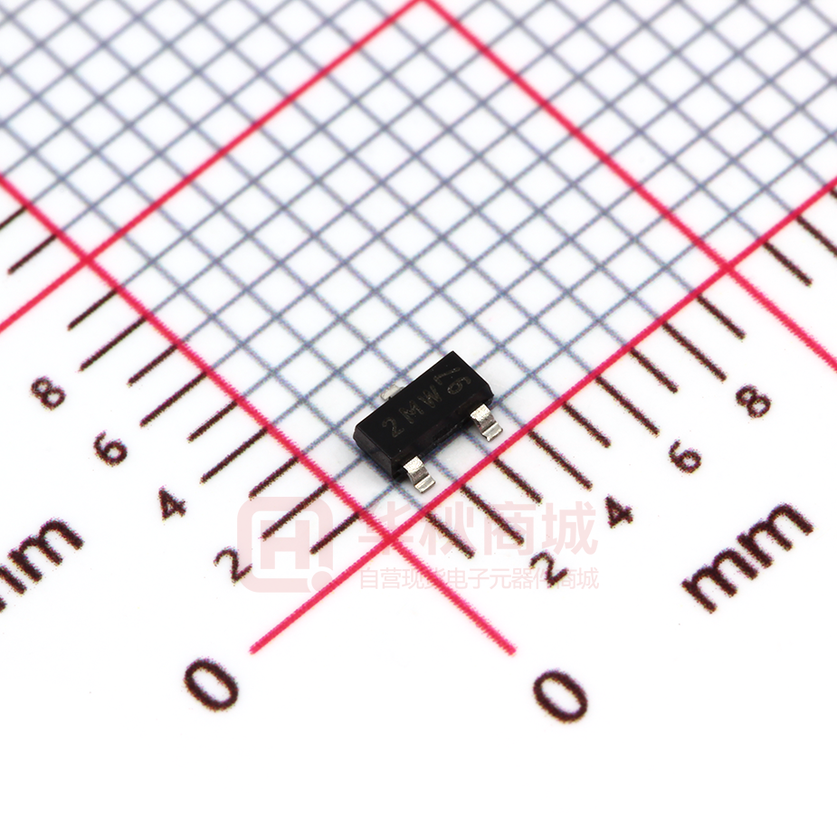

    SOT-23
    肖特基二极管 30V 3.00 x 1.40mm SMT SOT23 200mA
BAT754C,215 数据手册
BAT754 series Schottky barrier diodes Rev. 3 — 9 October 2012 Product data sheet 1. Product profile 1.1 General description Planar Schottky barrier diodes with an integrated guard ring for stress protection, encapsulated in a small SOT23 (TO-236AB) Surface-Mounted Device (SMD) plastic package. 1.2 Features and benefits  Low forward voltage  Low capacitance  AEC-Q101 qualified 1.3 Applications  Ultra high-speed switching  Line termination  Voltage clamping  Reverse polarity protection 1.4 Quick reference data Table 1. Quick reference data Tamb = 25 C unless otherwise specified. Symbol Parameter Conditions Min Typ Max Unit Per diode reverse voltage VR forward voltage VF reverse current IR [1] - - 30 V IF = 100 mA [1] - 600 - mV VR = 25 V [1] - - 2 A Pulse test: tp  300 s;   0.02. 2. Pinning information Table 2. Pin Pinning Description Simplified outline Graphic symbol BAT754 1 anode 2 not connected 3 cathode 3 3 1 1 2 2 n.c. 006aaa436 BAT754 series Nexperia Schottky barrier diodes Table 2. Pinning …continued Pin Description Simplified outline Graphic symbol BAT754A 1 cathode (diode 1) 2 cathode (diode 2) 3 common anode 3 3 1 1 2 2 006aaa439 BAT754C 1 anode (diode 1) 2 anode (diode 2) 3 common cathode 3 3 1 1 2 2 006aac984 BAT754S 1 anode (diode 1) 2 cathode (diode 2) 3 cathode (diode 1), anode (diode 2) 3 3 1 1 2 2 006aaa437 3. Ordering information Table 3. Ordering information Type number BAT754 series Package Name Description Version - plastic surface-mounted package; 3 leads SOT23 4. Marking Table 4. Type number Marking code[1] BAT754 2K* BAT754A 2L* BAT754C 2M* BAT754S 2N* [1] BAT754_SER Product data sheet Marking codes * = placeholder for manufacturing site code. All information provided in this document is subject to legal disclaimers. Rev. 3 — 9 October 2012 © Nexperia B.V. 2012. All rights reserved. 2 of 10 BAT754 series Nexperia Schottky barrier diodes 5. Limiting values Table 5. Limiting values In accordance with the Absolute Maximum Rating System (IEC 60134). Symbol Parameter Conditions Min Max Unit Per diode VR reverse voltage - 30 V IF forward current - 200 mA IFRM repetitive peak forward current tp  1 s;   0.5 300 mA IFSM non-repetitive peak forward current sine wave; tp < 8.3 ms - 600 mA [1] Per device; one diode loaded Tj junction temperature - 125 C Tamb ambient temperature 55 +125 C Tstg storage temperature 65 +150 C [1] Tj = 25 C before surge. 6. Thermal characteristics Table 6. Symbol Thermal characteristics Parameter Conditions Min Typ Max Unit - - 500 K/W Per device; one diode loaded Rth(j-a) [1] thermal resistance from junction to ambient in free air [1] Device mounted on an FR4 Printed-Circuit Board (PCB), single-sided copper, tin-plated and standard footprint. 7. Characteristics Table 7. Characteristics Tamb = 25 C unless otherwise specified. Symbol VF Product data sheet Conditions Min Typ Max Unit IF = 0.1 mA - - 200 mV IF = 1 mA - - 260 mV IF = 10 mA - - 340 mV [1] forward voltage IF = 30 mA - - 420 mV IF = 100 mA - 600 - mV - - 2 A - - 10 pF IR reverse current VR = 25 V Cd diode capacitance f = 1 MHz; VR = 1 V [1] BAT754_SER Parameter [1] Pulse test: tp  300 s;   0.02. All information provided in this document is subject to legal disclaimers. Rev. 3 — 9 October 2012 © Nexperia B.V. 2012. All rights reserved. 3 of 10 BAT754 series Nexperia Schottky barrier diodes 006aac830 103 IF (mA) (2) (1) ,5 —$ (3)  102  10  (1) (2) DDD   (3)   1 10-1 0.0 0.4 0.8  1.2 VF (V)   (1) Tamb = 125 C (1) Tamb = 125 C (2) Tamb = 85 C (2) Tamb = 85 C (3) Tamb = 25 C (3) Tamb = 25 C Fig 1. Forward current as a function of forward voltage; typical values Fig 2.  95 9  Reverse current as a function of reverse voltage; typical values msa891 15 Cd (pF) 10 5 0 0 10 20 VR (V) 30 f = 1 MHz; Tamb = 25 C Fig 3. Diode capacitance as a function of reverse voltage; typical values 8. Test information 8.1 Quality information This product has been qualified in accordance with the Automotive Electronics Council (AEC) standard Q101 - Stress test qualification for discrete semiconductors, and is suitable for use in automotive applications. BAT754_SER Product data sheet All information provided in this document is subject to legal disclaimers. Rev. 3 — 9 October 2012 © Nexperia B.V. 2012. All rights reserved. 4 of 10 BAT754 series Nexperia Schottky barrier diodes 9. Package outline 3.0 2.8 1.1 0.9 3 0.45 0.15 2.5 1.4 2.1 1.2 1 2 1.9 Dimensions in mm Fig 4. 0.48 0.38 0.15 0.09 04-11-04 Package outline SOT23 (TO-236AB) 10. Packing information Please refer to packing information on www.nexperia.com. BAT754_SER Product data sheet All information provided in this document is subject to legal disclaimers. Rev. 3 — 9 October 2012 © Nexperia B.V. 2012. All rights reserved. 5 of 10 BAT754 series Nexperia Schottky barrier diodes 11. Soldering 3.3 2.9 1.9 solder lands solder resist 3 2 1.7 solder paste 0.6 (3×) 0.7 (3×) occupied area Dimensions in mm 0.5 (3×) 0.6 (3×) 1 Fig 5. sot023_fr Reflow soldering footprint SOT23 (TO-236AB) 2.2 1.2 (2×) 1.4 (2×) solder lands 4.6 solder resist 2.6 occupied area Dimensions in mm 1.4 preferred transport direction during soldering 2.8 4.5 Fig 6. BAT754_SER Product data sheet sot023_fw Wave soldering footprint SOT23 (TO-236AB) All information provided in this document is subject to legal disclaimers. Rev. 3 — 9 October 2012 © Nexperia B.V. 2012. All rights reserved. 6 of 10 BAT754 series Nexperia Schottky barrier diodes 12. Revision history Table 9. Revision history Document ID Release date Data sheet status Change notice Supersedes BAT754_SER v.3 20121009 Product data sheet - BAT754_SERIES v.2 Modifications: • The format of this document has been redesigned to comply with the new identity guidelines of NXP Semiconductors. • • • • • • • • • • Legal texts have been adapted to the new company name where appropriate. Section 1: updated Section 4: updated Table 5: IFSM conditions updated; changed Tamb minimum value to comply with AEC-Q101 Figure 1 and 2: updated Section 8 “Test information”: added Figure 4: replaced by minimized package outline drawing Section 10 “Packing information”: added Section 11 “Soldering”: added Section 13 “Legal information”: updated BAT754_SERIES v.2 20030325 Product data sheet - BAT754_SERIES v.1 BAT754_SERIES v.1 19990805 Product specification - - BAT754_SER Product data sheet All information provided in this document is subject to legal disclaimers. Rev. 3 — 9 October 2012 © Nexperia B.V. 2012. All rights reserved. 7 of 10 BAT754 series Nexperia Schottky barrier diodes 13. Legal information 13.1 Data sheet status Document status[1][2] Product status[3] Definition Objective [short] data sheet Development This document contains data from the objective specification for product development. Preliminary [short] data sheet Qualification This document contains data from the preliminary specification. Product [short] data sheet Production This document contains the product specification. [1] Please consult the most recently issued document before initiating or completing a design. [2] The term ‘short data sheet’ is explained in section “Definitions”. [3] The product status of device(s) described in this document may have changed since this document was published and may differ in case of multiple devices. The latest product status information is available on the Internet at URL http://www.nexperia.com. 13.2 Definitions Draft — The document is a draft version only. The content is still under internal review and subject to formal approval, which may result in modifications or additions. Nexperia does not give any representations or warranties as to the accuracy or completeness of information included herein and shall have no liability for the consequences of use of such information. Short data sheet — A short data sheet is an extract from a full data sheet with the same product type number(s) and title. A short data sheet is intended for quick reference only and should not be relied upon to contain detailed and full information. For detailed and full information see the relevant full data sheet, which is available on request via the local Nexperia sales office. In case of any inconsistency or conflict with the short data sheet, the full data sheet shall prevail. Product specification — The information and data provided in a Product data sheet shall define the specification of the product as agreed between Nexperia and its customer, unless Nexperia and customer have explicitly agreed otherwise in writing. In no event however, shall an agreement be valid in which the Nexperia product is deemed to offer functions and qualities beyond those described in the Product data sheet. 13.3 Disclaimers Limited warranty and liability — Information in this document is believed to be accurate and reliable. However, Nexperia does not give any representations or warranties, expressed or implied, as to the accuracy or completeness of such information and shall have no liability for the consequences of use of such information. Nexperia takes no responsibility for the content in this document if provided by an information source outside of Nexperia. In no event shall Nexperia be liable for any indirect, incidental, punitive, special or consequential damages (including - without limitation - lost profits, lost savings, business interruption, costs related to the removal or replacement of any products or rework charges) whether or not such damages are based on tort (including negligence), warranty, breach of contract or any other legal theory. Notwithstanding any damages that customer might incur for any reason whatsoever, Nexperia' s aggregate and cumulative liability towards customer for the products described herein shall be limited in accordance with the Terms and conditions of commercial sale of Nexperia. Right to make changes — Nexperia reserves the right to make changes to information published in this document, including without limitation specifications and product descriptions, at any time and without notice. This document supersedes and replaces all information supplied prior to the publication hereof. BAT754_SER Product data sheet Suitability for use in automotive applications — This Nexperia product has been qualified for use in automotive applications. Unless otherwise agreed in writing, the product is not designed, authorized or warranted to be suitable for use in life support, life-critical or safety-critical systems or equipment, nor in applications where failure or malfunction of an Nexperia product can reasonably be expected to result in personal injury, death or severe property or environmental damage. Nexperia and its suppliers accept no liability for inclusion and/or use of Nexperia products in such equipment or applications and therefore such inclusion and/or use is at the customer's own risk. Applications — Applications that are described herein for any of these products are for illustrative purposes only. Nexperia makes no representation or warranty that such applications will be suitable for the specified use without further testing or modification. Customers are responsible for the design and operation of their applications and products using Nexperia products, and Nexperia accepts no liability for any assistance with applications or customer product design. It is customer’s sole responsibility to determine whether the Nexperia product is suitable and fit for the customer’s applications and products planned, as well as for the planned application and use of customer’s third party customer(s). Customers should provide appropriate design and operating safeguards to minimize the risks associated with their applications and products. Nexperia does not accept any liability related to any default, damage, costs or problem which is based on any weakness or default in the customer’s applications or products, or the application or use by customer’s third party customer(s). Customer is responsible for doing all necessary testing for the customer’s applications and products using Nexperia products in order to avoid a default of the applications and the products or of the application or use by customer’s third party customer(s). Nexperia does not accept any liability in this respect. Limiting values — Stress above one or more limiting values (as defined in the Absolute Maximum Ratings System of IEC 60134) will cause permanent damage to the device. Limiting values are stress ratings only and (proper) operation of the device at these or any other conditions above those given in the Recommended operating conditions section (if present) or the Characteristics sections of this document is not warranted. Constant or repeated exposure to limiting values will permanently and irreversibly affect the quality and reliability of the device. Terms and conditions of commercial sale — Nexperia products are sold subject to the general terms and conditions of commercial sale, as published at http://www.nexperia.com/profile/terms, unless otherwise agreed in a valid written individual agreement. In case an individual agreement is concluded only the terms and conditions of the respective agreement shall apply. Nexperia hereby expressly objects to applying the customer’s general terms and conditions with regard to the purchase of Nexperia products by customer. All information provided in this document is subject to legal disclaimers. Rev. 3 — 9 October 2012 © Nexperia B.V. 2012. All rights reserved. 8 of 10 BAT754 series Nexperia Schottky barrier diodes No offer to sell or license — Nothing in this document may be interpreted or construed as an offer to sell products that is open for acceptance or the grant, conveyance or implication of any license under any copyrights, patents or other industrial or intellectual property rights. Quick reference data — The Quick reference data is an extract of the product data given in the Limiting values and Characteristics sections of this document, and as such is not complete, exhaustive or legally binding. Export control — This document as well as the item(s) described herein may be subject to export control regulations. Export might require a prior authorization from competent authorities. 13.4 Trademarks BAT754_SER Product data sheet Notice: All referenced brands, product names, service names and trademarks are the property of their respective owners. All information provided in this document is subject to legal disclaimers. Rev. 3 — 9 October 2012 © Nexperia B.V. 2012. All rights reserved. 9 of 10 BAT754 series Nexperia Schottky barrier diodes 14. Contents 1 1.1 1.2 1.3 1.4 2 3 4 5 6 7 8 8.1 9 10 11 12 13 13.1 13.2 13.3 13.4 Product profile . . . . . . . . . . . . . . . . . . . . . . . . . . General description . . . . . . . . . . . . . . . . . . . . . Features and benefits . . . . . . . . . . . . . . . . . . . . Applications . . . . . . . . . . . . . . . . . . . . . . . . . . . Quick reference data . . . . . . . . . . . . . . . . . . . . Pinning information . . . . . . . . . . . . . . . . . . . . . . Ordering information . . . . . . . . . . . . . . . . . . . . . Marking . . . . . . . . . . . . . . . . . . . . . . . . . . . . . . . . Limiting values. . . . . . . . . . . . . . . . . . . . . . . . . . Thermal characteristics . . . . . . . . . . . . . . . . . . Characteristics . . . . . . . . . . . . . . . . . . . . . . . . . . Test information . . . . . . . . . . . . . . . . . . . . . . . . . Quality information . . . . . . . . . . . . . . . . . . . . . . Package outline . . . . . . . . . . . . . . . . . . . . . . . . . Packing information . . . . . . . . . . . . . . . . . . . . . Soldering . . . . . . . . . . . . . . . . . . . . . . . . . . . . . . Revision history . . . . . . . . . . . . . . . . . . . . . . . . . Legal information. . . . . . . . . . . . . . . . . . . . . . . . Data sheet status . . . . . . . . . . . . . . . . . . . . . . . Definitions . . . . . . . . . . . . . . . . . . . . . . . . . . . . . Disclaimers . . . . . . . . . . . . . . . . . . . . . . . . . . . . Trademarks. . . . . . . . . . . . . . . . . . . . . . . . . . . . 1 1 1 1 1 1 2 2 3 3 3 4 4 5 5 6 7 8 8 8 8 9 14 Contents . . . . . . . . . . . . . . . . . . . . . . . . . . . . . . 10 Please be aware that important notices concerning this document and the product(s) described herein, have been included in section ‘Legal information’. © Nexperia B.V. 2012. All rights reserved. For more information, please visit: http://www.nexperia.com For sales office addresses, please send an email to: salesaddresses@nexperia.com Date of release: 9 October 2012 Document identifier: BAT754_SER
