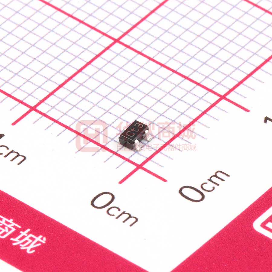

    开关二极管(小信号) 85V 2.20 x 1.35mm SMT SOT323 200mA
1PS302,115 数据手册
1PS302 Dual high-speed switching diode Rev. 6 — 23 July 2012 Product data sheet 1. Product profile 1.1 General description Dual high-speed switching diode, encapsulated in a very small SOT323 (SC-70) Surface-Mounted Device (SMD) plastic package. 1.2 Features and benefits  High switching speed: trr  4 ns  Repetitive peak reverse voltage: VRRM  85 V  Reverse voltage: VR  80 V  AEC-Q101 qualified  Low capacitance: Cd  1.5 pF  Repetitive peak forward current: IFRM  500 mA  Very small SMD plastic package 1.3 Applications  High-speed switching  General-purpose switching 1.4 Quick reference data Table 1. Symbol Quick reference data Parameter Conditions Min Typ Max Unit [2] - - 200 mA [3] - - 170 mA - - 0.5 A - - 80 V - - 4 ns Per diode IF [1] forward current IR reverse current VR reverse voltage trr reverse recovery time VR = 80 V [4] [1] Device mounted on an FR4 Printed-Circuit Board (PCB), single-sided copper, tin-plated and standard footprint. [2] Single diode loaded. [3] Double diode loaded. [4] When switched from IF = 10 mA to IR =10 mA; RL = 100 ; measured at IR = 1 mA. 1PS302 Nexperia Dual high-speed switching diode 2. Pinning information Table 2. Pinning Pin Description Simplified outline 1 anode 2 cathode 3 cathode (diode 1), anode (diode 2) Graphic symbol 3 1 3 2 1 2 006aaa763 3. Ordering information Table 3. Ordering information Type number 1PS302 Package Name Description Version SC-70 plastic surface-mounted package; 3 leads SOT323 4. Marking Table 4. Marking codes Type number Marking code[1] 1PS302 C*3 [1] * = placeholder for manufacturing site code 5. Limiting values Table 5. Limiting values In accordance with the Absolute Maximum Rating System (IEC 60134). Symbol Parameter Conditions Min Max Unit - 85 V - 80 V [2] - 200 mA [3] - 170 mA - 500 mA tp = 1 s - 4 A tp = 1 s - 0.5 A Per diode VRRM repetitive peak reverse voltage VR reverse voltage IF 1PS302 Product data sheet [1] forward current IFRM repetitive peak forward current tp  0.5 s;   0.25 IFSM non-repetitive peak forward current square wave All information provided in this document is subject to legal disclaimers. Rev. 6 — 23 July 2012 [4] © Nexperia B.V. 2012. All rights reserved. 2 of 11 1PS302 Nexperia Dual high-speed switching diode Table 5. Limiting values …continued In accordance with the Absolute Maximum Rating System (IEC 60134). Symbol Parameter Conditions Min Max Unit Ptot total power dissipation Tamb  25 C - 300 mW Tj Tamb junction temperature - 150 C ambient temperature 55 +150 C Tstg storage temperature 65 +150 C Per device [1] [1] Device mounted on an FR4 PCB, single-sided copper, tin-plated and standard footprint. [2] Single diode loaded. [3] Double diode loaded. [4] Tj = 25 C before surge. 6. Thermal characteristics Table 6. Symbol Thermal characteristics Parameter Conditions Rth(j-a) thermal resistance from junction to ambient in free air Rth(j-sp) thermal resistance from junction to solder point Min Typ Max Unit - - 415 K/W - - 200 K/W Per device [1] [1] Device mounted on an FR4 PCB, single-sided copper, tin-plated and standard footprint. 7. Characteristics Table 7. Characteristics Tamb = 25 C unless otherwise specified. Symbol Parameter Conditions Min Typ Max Unit forward voltage IF = 1 mA - 610 - mV IF = 10 mA - 740 - mV IF = 50 mA - - 1.0 V IF = 100 mA - - 1.2 V VR = 25 V - - 30 nA VR = 80 V - - 0.5 A Per diode VF IR Cd trr VFR 1PS302 Product data sheet reverse current diode capacitance VR =25 V; Tj = 150 C - - 30 A VR =80 V; Tj = 150 C - - 100 A f = 1 MHz; VR = 0 V - - 1.5 pF reverse recovery time [1] - - 4 ns forward recovery voltage [2] - - 1.75 V [1] When switched from IF = 10 mA to IR =10 mA; RL = 100 ; measured at IR = 1 mA. [2] When switched from IF =10 mA; tr = 20 ns. All information provided in this document is subject to legal disclaimers. Rev. 6 — 23 July 2012 © Nexperia B.V. 2012. All rights reserved. 3 of 11 1PS302 Nexperia Dual high-speed switching diode 006aac851 300 mbg380 102 IR (μA) IF (mA) 10 200 (1) (2) (3) (1) 1 (2) (3) 100 10−1 0 0.0 0.5 1.0 1.5 VF (V) 2.0 10−2 0 100 (1) Tj = 150 C; typical values (1) VR = 80 V; maximum values (2) Tj = 25 C; typical values (2) VR = 80 V; typical values (3) Tj = 25 C; maximum values (3) VR = 25 V; typical values Fig 1. Forward current as a function of forward voltage 006aac852 0.8 Fig 2. Tj (°C) Reverse current as a function of junction temperature mbg443 300 Cd (pF) 200 IF (mA) 0.6 200 (1) 0.4 (2) 100 0.2 0.0 0 4 8 12 VR (V) 0 16 0 f =1 MHz; Tamb = 25 C 100 Tamb (°C) 200 FR4 PCB, standard footprint (1) single diode loaded (2) double diode loaded Fig 3. Diode capacitance as a function of reverse voltage; typical values 1PS302 Product data sheet Fig 4. Forward current as a function of ambient temperature; derating curves All information provided in this document is subject to legal disclaimers. Rev. 6 — 23 July 2012 © Nexperia B.V. 2012. All rights reserved. 4 of 11 1PS302 Nexperia Dual high-speed switching diode 8. Test information tr tp t D.U.T. 10 % + IF IF RS = 50 Ω SAMPLING OSCILLOSCOPE trr t Ri = 50 Ω V = VR + IF × RS (1) 90 % VR mga881 input signal output signal (1) IR = 1 mA Input signal: reverse pulse rise time tr = 0.6 ns; reverse voltage pulse duration tp = 100 ns; duty cycle  = 0.05 Oscilloscope: rise time tr = 0.35 ns Fig 5. Reverse recovery time test circuit and waveforms I 1 kΩ RS = 50 Ω D.U.T. 450 Ω I V 90 % OSCILLOSCOPE VFR Ri = 50 Ω 10 % t tr t tp input signal output signal mga882 Input signal: forward pulse rise time tr = 20 ns; forward current pulse duration tp  100 ns; duty cycle   0.005 Fig 6. Forward recovery voltage test circuit and waveforms 8.1 Quality information This product has been qualified in accordance with the Automotive Electronics Council (AEC) standard Q101 - Stress test qualification for discrete semiconductors, and is suitable for use in automotive applications. 1PS302 Product data sheet All information provided in this document is subject to legal disclaimers. Rev. 6 — 23 July 2012 © Nexperia B.V. 2012. All rights reserved. 5 of 11 1PS302 Nexperia Dual high-speed switching diode 9. Package outline 2.2 1.8 1.1 0.8 0.45 0.15 3 2.2 1.35 2.0 1.15 1 2 0.4 0.3 0.25 0.10 1.3 Dimensions in mm Fig 7. 04-11-04 Package outline SOT323 (SC-70) 10. Packing information Please refer to packing information on www.nexperia.com. 1PS302 Product data sheet All information provided in this document is subject to legal disclaimers. Rev. 6 — 23 July 2012 © Nexperia B.V. 2012. All rights reserved. 6 of 11 1PS302 Nexperia Dual high-speed switching diode 11. Soldering 2.65 1.85 1.325 solder lands solder resist 2 2.35 0.6 (3×) 3 solder paste 1.3 1 occupied area 0.5 (3×) Dimensions in mm 0.55 (3×) Fig 8. sot323_fr Reflow soldering footprint SOT323 (SC-70) 4.6 2.575 1.425 (3×) solder lands solder resist occupied area 1.8 3.65 2.1 09 (2×) Dimensions in mm preferred transport direction during soldering sot323_fw Fig 9. 1PS302 Product data sheet Wave soldering footprint SOT323 (SC-70) All information provided in this document is subject to legal disclaimers. Rev. 6 — 23 July 2012 © Nexperia B.V. 2012. All rights reserved. 7 of 11 1PS302 Nexperia Dual high-speed switching diode 12. Revision history Table 9. Revision history Document ID Release date Data sheet status Change notice Supersedes 1PS302 v.6 20120723 Product data sheet - 1PS302 v.5 Modifications: • Section 2 “Pinning information”: corrected 1PS302 v.5 20111116 Product data sheet - 1PS302 v.4 1PS302 v.4 19990506 Product data sheet - 1PS302 v.3 1PS302 v.3 19961004 Product specification - 1PS302 v.2 1PS302 v.2 19960903 Product specification - 1PS302 v.1 1PS302 v.1 19960403 Product specification - - 1PS302 Product data sheet All information provided in this document is subject to legal disclaimers. Rev. 6 — 23 July 2012 © Nexperia B.V. 2012. All rights reserved. 8 of 11 1PS302 Nexperia Dual high-speed switching diode 13. Legal information 13.1 Data sheet status Document status[1][2] Product status[3] Definition Objective [short] data sheet Development This document contains data from the objective specification for product development. Preliminary [short] data sheet Qualification This document contains data from the preliminary specification. Product [short] data sheet Production This document contains the product specification. [1] Please consult the most recently issued document before initiating or completing a design. [2] The term ‘short data sheet’ is explained in section “Definitions”. [3] The product status of device(s) described in this document may have changed since this document was published and may differ in case of multiple devices. The latest product status information is available on the Internet at URL http://www.nexperia.com. 13.2 Definitions Draft — The document is a draft version only. The content is still under internal review and subject to formal approval, which may result in modifications or additions. Nexperia does not give any representations or warranties as to the accuracy or completeness of information included herein and shall have no liability for the consequences of use of such information. Short data sheet — A short data sheet is an extract from a full data sheet with the same product type number(s) and title. A short data sheet is intended for quick reference only and should not be relied upon to contain detailed and full information. For detailed and full information see the relevant full data sheet, which is available on request via the local Nexperia sales office. In case of any inconsistency or conflict with the short data sheet, the full data sheet shall prevail. Product specification — The information and data provided in a Product data sheet shall define the specification of the product as agreed between Nexperia and its customer, unless Nexperia and customer have explicitly agreed otherwise in writing. In no event however, shall an agreement be valid in which the Nexperia product is deemed to offer functions and qualities beyond those described in the Product data sheet. 13.3 Disclaimers Limited warranty and liability — Information in this document is believed to be accurate and reliable. However, Nexperia does not give any representations or warranties, expressed or implied, as to the accuracy or completeness of such information and shall have no liability for the consequences of use of such information. Nexperia takes no responsibility for the content in this document if provided by an information source outside of Nexperia. In no event shall Nexperia be liable for any indirect, incidental, punitive, special or consequential damages (including - without limitation - lost profits, lost savings, business interruption, costs related to the removal or replacement of any products or rework charges) whether or not such damages are based on tort (including negligence), warranty, breach of contract or any other legal theory. Notwithstanding any damages that customer might incur for any reason whatsoever, Nexperia's aggregate and cumulative liability towards customer for the products described herein shall be limited in accordance with the Terms and conditions of commercial sale of Nexperia. Right to make changes — Nexperia reserves the right to make changes to information published in this document, including without limitation specifications and product descriptions, at any time and without notice. This document supersedes and replaces all information supplied prior to the publication hereof. 1PS302 Product data sheet Suitability for use — Nexperia products are not designed, authorized or warranted to be suitable for use in life support, life-critical or safety-critical systems or equipment, nor in applications where failure or malfunction of an Nexperia product can reasonably be expected to result in personal injury, death or severe property or environmental damage. Nexperia and its suppliers accept no liability for inclusion and/or use of Nexperia products in such equipment or applications and therefore such inclusion and/or use is at the customer’s own risk. Applications — Applications that are described herein for any of these products are for illustrative purposes only. Nexperia makes no representation or warranty that such applications will be suitable for the specified use without further testing or modification. Customers are responsible for the design and operation of their applications and products using Nexperia products, and Nexperia accepts no liability for any assistance with applications or customer product design. It is customer’s sole responsibility to determine whether the Nexperia product is suitable and fit for the customer’s applications and products planned, as well as for the planned application and use of customer’s third party customer(s). Customers should provide appropriate design and operating safeguards to minimize the risks associated with their applications and products. Nexperia does not accept any liability related to any default, damage, costs or problem which is based on any weakness or default in the customer’s applications or products, or the application or use by customer’s third party customer(s). Customer is responsible for doing all necessary testing for the customer’s applications and products using Nexperia products in order to avoid a default of the applications and the products or of the application or use by customer’s third party customer(s). Nexperia does not accept any liability in this respect. Limiting values — Stress above one or more limiting values (as defined in the Absolute Maximum Ratings System of IEC 60134) will cause permanent damage to the device. Limiting values are stress ratings only and (proper) operation of the device at these or any other conditions above those given in the Recommended operating conditions section (if present) or the Characteristics sections of this document is not warranted. Constant or repeated exposure to limiting values will permanently and irreversibly affect the quality and reliability of the device. Terms and conditions of commercial sale — Nexperia products are sold subject to the general terms and conditions of commercial sale, as published at http://www.nexperia.com/profile/terms, unless otherwise agreed in a valid written individual agreement. In case an individual agreement is concluded only the terms and conditions of the respective agreement shall apply. Nexperia hereby expressly objects to applying the customer’s general terms and conditions with regard to the purchase of Nexperia products by customer. No offer to sell or license — Nothing in this document may be interpreted or construed as an offer to sell products that is open for acceptance or the grant, conveyance or implication of any license under any copyrights, patents or other industrial or intellectual property rights. All information provided in this document is subject to legal disclaimers. Rev. 6 — 23 July 2012 © Nexperia B.V. 2012. All rights reserved. 9 of 11 1PS302 Nexperia Dual high-speed switching diode Export control — This document as well as the item(s) described herein may be subject to export control regulations. Export might require a prior authorization from competent authorities. Quick reference data — The Quick reference data is an extract of the product data given in the Limiting values and Characteristics sections of this document, and as such is not complete, exhaustive or legally binding. 1PS302 Product data sheet 13.4 Trademarks Notice: All referenced brands, product names, service names and trademarks are the property of their respective owners. All information provided in this document is subject to legal disclaimers. Rev. 6 — 23 July 2012 © Nexperia B.V. 2012. All rights reserved. 10 of 11 1PS302 Nexperia Dual high-speed switching diode 14. Contents 1 1.1 1.2 1.3 1.4 2 3 4 5 6 7 8 8.1 9 10 11 12 13 13.1 13.2 13.3 13.4 14 Product profile . . . . . . . . . . . . . . . . . . . . . . . . . . 1 General description . . . . . . . . . . . . . . . . . . . . . 1 Features and benefits . . . . . . . . . . . . . . . . . . . . 1 Applications . . . . . . . . . . . . . . . . . . . . . . . . . . . 1 Quick reference data . . . . . . . . . . . . . . . . . . . . 1 Pinning information . . . . . . . . . . . . . . . . . . . . . . 2 Ordering information . . . . . . . . . . . . . . . . . . . . . 2 Marking . . . . . . . . . . . . . . . . . . . . . . . . . . . . . . . . 2 Limiting values. . . . . . . . . . . . . . . . . . . . . . . . . . 2 Thermal characteristics . . . . . . . . . . . . . . . . . . 3 Characteristics . . . . . . . . . . . . . . . . . . . . . . . . . . 3 Test information . . . . . . . . . . . . . . . . . . . . . . . . . 5 Quality information . . . . . . . . . . . . . . . . . . . . . . 5 Package outline . . . . . . . . . . . . . . . . . . . . . . . . . 6 Packing information . . . . . . . . . . . . . . . . . . . . . 6 Soldering . . . . . . . . . . . . . . . . . . . . . . . . . . . . . . 7 Revision history . . . . . . . . . . . . . . . . . . . . . . . . . 8 Legal information. . . . . . . . . . . . . . . . . . . . . . . . 9 Data sheet status . . . . . . . . . . . . . . . . . . . . . . . 9 Definitions . . . . . . . . . . . . . . . . . . . . . . . . . . . . . 9 Disclaimers . . . . . . . . . . . . . . . . . . . . . . . . . . . . 9 Trademarks. . . . . . . . . . . . . . . . . . . . . . . . . . . 10 Contents . . . . . . . . . . . . . . . . . . . . . . . . . . . . . . 11 Please be aware that important notices concerning this document and the product(s) described herein, have been included in section ‘Legal information’. © Nexperia B.V. 2012. All rights reserved. For more information, please visit: http://www.nexperia.com For sales office addresses, please send an email to: salesaddresses@nexperia.com Date of release: 23 July 2012 Document identifier: 1PS302
