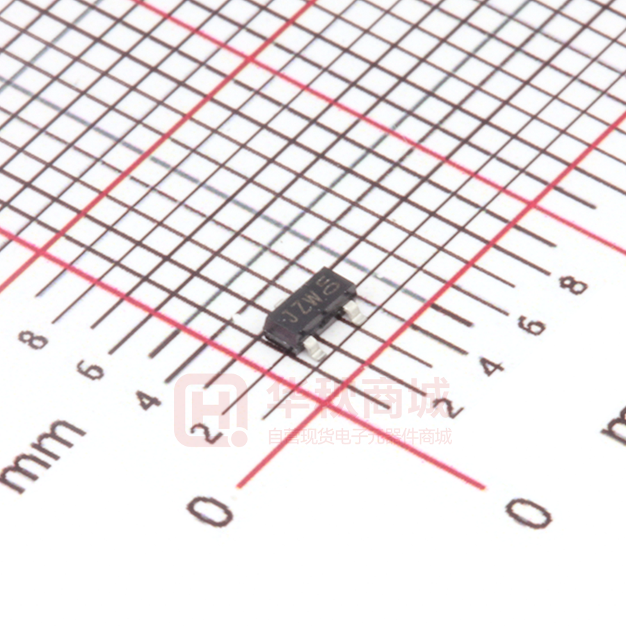

    开关二极管(小信号) VR=75V IF=160mA Trr=3us P=250mW SOT23
BAW156,215 数据手册
BAW156 Low-leakage double diode 2 October 2020 Product data sheet 1. General description Epitaxial, medium-speed switching, double diode in a small SOT23 plastic SMD package. The diodes are in common anode configuration. 2. Features and benefits • • • • • • • Plastic SMD package Low leakage current: typ. 3 pA Switching time: typ. 0.8 µs Continuous reverse voltage: max. 75 V Repetitive peak reverse voltage: max. 85 V Repetitive peak forward current: max. 500 mA. AEC-Q101 qualified 3. Applications • Low-leakage current applications in surface mounted circuits. 4. Quick reference data Table 1. Quick reference data Symbol Parameter Conditions Min Typ Max Unit Per diode VR reverse voltage Tj = 25 °C - - 75 V IR reverse current VR = 75 V; pulsed; Tj = 25 °C - 0.003 5 nA 5. Pinning information Table 2. Pinning information Pin Symbol Description 1 K1 cathode (diode 1) 2 K2 cathode (diode 2) 3 CA common anode Simplified outline Graphic symbol 3 1 CA 2 SOT23 K1 K2 aaa-032327 BAW156 Nexperia Low-leakage double diode 6. Ordering information Table 3. Ordering information Type number Package BAW156 Name Description Version SOT23 plastic, surface-mounted package; 3 terminals; 1.9 mm pitch; 2.9 SOT23 mm x 1.3 mm x 1 mm body 7. Marking Table 4. Marking codes Type number Marking code[1] BAW156 JZ% [1] % = placeholder for manufacturing site code 8. Limiting values Table 5. Limiting values In accordance with the Absolute Maximum Rating System (IEC 60134). Symbol Parameter Conditions Min Max Unit VR reverse voltage Tj = 25 °C - 75 V VRRM repetitive peak reverse voltage - 85 V IF forward current Per diode Tamb = 25 °C; single diode loaded [1] - 160 mA Tamb = 25 °C; double diode loaded [1] - 140 mA IFRM repetitive peak forward current Tj = 25 °C - 500 mA IFSM non-repetitive peak forward current tp = 1 µs; square wave; Tj(init) = 25 °C - 4 A tp = 1 ms; square wave; Tj(init) = 25 °C - 1 A tp = 1 s; square wave; Tj(init) = 25 °C - 0.5 A - 250 mW Ptot total power dissipation Tj junction temperature - 150 °C Tamb ambient temperature -55 150 °C Tstg storage temperature -65 150 °C [1] Tamb ≤ 25 °C [1] Device mounted on an FR4 Printed-Circuit Board (PCB), single-sided copper, tin-plated and standard footprint. BAW156 Product data sheet All information provided in this document is subject to legal disclaimers. 2 October 2020 © Nexperia B.V. 2020. All rights reserved 2 / 10 BAW156 Nexperia Low-leakage double diode 9. Thermal characteristics Table 6. Thermal characteristics Symbol Parameter Conditions Min Typ Max Unit Rth(j-a) thermal resistance from in free air junction to ambient [1] - - 500 K/W Rth(j-sp) thermal resistance from junction to solder point [2] - - 360 K/W Conditions Min Typ Max Unit IF = 1 mA; Tj = 25 °C - - 0.9 V IF = 10 mA; Tj = 25 °C - - 1 V IF = 50 mA; Tj = 25 °C - - 1.1 V IF = 150 mA; Tj = 25 °C - - 1.25 V VR = 75 V; pulsed; Tj = 25 °C - 0.003 5 nA VR = 75 V; pulsed; Tj = 150 °C - 3 80 nA [1] [2] Device mounted on an FR4 PCB, single-sided copper, tin-plated and standard footprint. Soldering point of cathode tab. 10. Characteristics Table 7. Characteristics Symbol Parameter Per diode VF forward voltage IR reverse current Cd diode capacitance VR = 0 V; f = 1 MHz; Tj = 25 °C - 3 - pF trr reverse recovery time IF = 10 mA; IR = 10 mA; IR(meas) = 1 mA; RL = 100 Ω; Tj = 25 °C; measured at IR = 1 mA - 0.8 3 µs mlb756 300 mlb752 300 IF (mA) IF (mA) 200 200 single diode loaded 100 (1) (2) (3) 100 double diode loaded 0 0 100 Tamb (°C) 0 200 Device mounted on an FR4 printed-circuit board. Fig. 1. Maximum permissible continuous forward current as a function of ambient temperature. BAW156 Product data sheet 0 0.4 0.8 1.2 VF (V) 1.6 (1) Tamb = 150 °C; typical values (2) Tamb = 25 °C; typical values (3) Tamb = 25 °C; maximum values Fig. 2. Forward current as a function of forward voltage; per diode All information provided in this document is subject to legal disclaimers. 2 October 2020 © Nexperia B.V. 2020. All rights reserved 3 / 10 BAW156 Nexperia Low-leakage double diode mbg704 102 mlb754 102 IR (nA) IFSM (A) 10 (1) 10 1 10- 1 1 (2) 10- 2 10-1 1 10 102 103 tp (µs) 10- 3 104 Non-repetitive peak forward current as a function of pulse duration; typical values 50 100 150 Tj (°C) 200 VR = 75 V (1) Maximum values (2) Typical values Based on square wave currents. Tj(init) = 25 °C Fig. 3. 0 Fig. 4. Reverse current as a function of junction temperature mbg525 4 Cd (pF) 3 2 1 0 0 5 10 15 VR (V) 20 f = 1 MHz; Tamb = 25 °C Fig. 5. Diode capacitance as a function of reverse voltage; typical values BAW156 Product data sheet All information provided in this document is subject to legal disclaimers. 2 October 2020 © Nexperia B.V. 2020. All rights reserved 4 / 10 BAW156 Nexperia Low-leakage double diode 11. Test information tr D.U.T. RS = 50 Ω V = VR + IF × RS IF tp 10 % t + IF SAMPLING OSCILLOSCOPE trr t Ri = 50 Ω mga881 VR (1) 90 % input signal output signal (1) IR = 1 mA Fig. 6. Reverse recovery time test circuit and waveforms Quality information This product has been qualified in accordance with the Automotive Electronics Council (AEC) standard Q101 - Stress test qualification for discrete semiconductors, and is suitable for use in automotive applications. BAW156 Product data sheet All information provided in this document is subject to legal disclaimers. 2 October 2020 © Nexperia B.V. 2020. All rights reserved 5 / 10 BAW156 Nexperia Low-leakage double diode 12. Package outline Plastic surface-mounted package; 3 leads SOT23 B D A E X HE v A 3 Q A A1 1 c 2 e1 bp w B Lp e detail X 0 1 2 mm scale Dimensions (mm are the original dimensions) Unit mm max nom min A A1 1.1 0.1 0.9 bp c D E 0.48 0.15 3.0 1.4 0.38 0.09 2.8 1.2 e e1 1.9 0.95 HE Lp Q 2.5 0.45 0.55 2.1 0.15 0.45 v w 0.2 0.1 sot023_po Outline version References IEC SOT23 Fig. 7. JEDEC JEITA European projection Issue date 14-06-19 14-09-22 TO-236AB Package outline SOT23 BAW156 Product data sheet All information provided in this document is subject to legal disclaimers. 2 October 2020 © Nexperia B.V. 2020. All rights reserved 6 / 10 BAW156 Nexperia Low-leakage double diode 13. Soldering 3.3 2.9 1.9 solder lands 3 solder resist 2 1.7 solder paste occupied area 0.6 (3×) 0.7 (3×) Dimensions in mm 0.5 (3×) 0.6 (3×) 1 Fig. 8. sot023_fr Reflow soldering footprint for SOT23 2.2 1.2 (2×) 1.4 (2×) solder lands 4.6 solder resist 2.6 occupied area Dimensions in mm 1.4 preferred transport direction during soldering 2.8 4.5 Fig. 9. sot023_fw Wave soldering footprint for SOT23 BAW156 Product data sheet All information provided in this document is subject to legal disclaimers. 2 October 2020 © Nexperia B.V. 2020. All rights reserved 7 / 10 BAW156 Nexperia Low-leakage double diode 14. Revision history Table 8. Revision history Data sheet ID Release date Data sheet status Change notice Supersedes BAW156 v.3 20201002 Product data sheet - BAW156 v.2 Modifications: • • • AEC-Q101 qualified attributes inserted in sections "Features and benefits", "Test information"and "Legal information". The format of this data sheet has been redesigned to comply with the identity guidelines of Nexperia. Legal texts have been adapted to the new company name where appropriate. BAW156 v.2 19990511 Product data sheet - BAW156 v.1 BAW156 v.1 19960313 Product data sheet - - BAW156 Product data sheet All information provided in this document is subject to legal disclaimers. 2 October 2020 © Nexperia B.V. 2020. All rights reserved 8 / 10 BAW156 Nexperia Low-leakage double diode 15. Legal information injury, death or severe property or environmental damage. Nexperia and its suppliers accept no liability for inclusion and/or use of Nexperia products in such equipment or applications and therefore such inclusion and/or use is at the customer’s own risk. Data sheet status Quick reference data — The Quick reference data is an extract of the product data given in the Limiting values and Characteristics sections of this document, and as such is not complete, exhaustive or legally binding. Document status [1][2] Product status [3] Definition Objective [short] data sheet Development This document contains data from the objective specification for product development. Preliminary [short] data sheet Qualification This document contains data from the preliminary specification. Product [short] data sheet Production This document contains the product specification. [1] [2] [3] Please consult the most recently issued document before initiating or completing a design. The term 'short data sheet' is explained in section "Definitions". The product status of device(s) described in this document may have changed since this document was published and may differ in case of multiple devices. The latest product status information is available on the internet at https://www.nexperia.com. Definitions Draft — The document is a draft version only. The content is still under internal review and subject to formal approval, which may result in modifications or additions. Nexperia does not give any representations or warranties as to the accuracy or completeness of information included herein and shall have no liability for the consequences of use of such information. Short data sheet — A short data sheet is an extract from a full data sheet with the same product type number(s) and title. A short data sheet is intended for quick reference only and should not be relied upon to contain detailed and full information. For detailed and full information see the relevant full data sheet, which is available on request via the local Nexperia sales office. In case of any inconsistency or conflict with the short data sheet, the full data sheet shall prevail. Product specification — The information and data provided in a Product data sheet shall define the specification of the product as agreed between Nexperia and its customer, unless Nexperia and customer have explicitly agreed otherwise in writing. In no event however, shall an agreement be valid in which the Nexperia product is deemed to offer functions and qualities beyond those described in the Product data sheet. Disclaimers Limited warranty and liability — Information in this document is believed to be accurate and reliable. However, Nexperia does not give any representations or warranties, expressed or implied, as to the accuracy or completeness of such information and shall have no liability for the consequences of use of such information. Nexperia takes no responsibility for the content in this document if provided by an information source outside of Nexperia. In no event shall Nexperia be liable for any indirect, incidental, punitive, special or consequential damages (including - without limitation - lost profits, lost savings, business interruption, costs related to the removal or replacement of any products or rework charges) whether or not such damages are based on tort (including negligence), warranty, breach of contract or any other legal theory. Notwithstanding any damages that customer might incur for any reason whatsoever, Nexperia’s aggregate and cumulative liability towards customer for the products described herein shall be limited in accordance with the Terms and conditions of commercial sale of Nexperia. Right to make changes — Nexperia reserves the right to make changes to information published in this document, including without limitation specifications and product descriptions, at any time and without notice. This document supersedes and replaces all information supplied prior to the publication hereof. Suitability for use — Nexperia products are not designed, authorized or warranted to be suitable for use in life support, life-critical or safety-critical systems or equipment, nor in applications where failure or malfunction of an Nexperia product can reasonably be expected to result in personal BAW156 Product data sheet Applications — Applications that are described herein for any of these products are for illustrative purposes only. Nexperia makes no representation or warranty that such applications will be suitable for the specified use without further testing or modification. Customers are responsible for the design and operation of their applications and products using Nexperia products, and Nexperia accepts no liability for any assistance with applications or customer product design. It is customer’s sole responsibility to determine whether the Nexperia product is suitable and fit for the customer’s applications and products planned, as well as for the planned application and use of customer’s third party customer(s). Customers should provide appropriate design and operating safeguards to minimize the risks associated with their applications and products. Nexperia does not accept any liability related to any default, damage, costs or problem which is based on any weakness or default in the customer’s applications or products, or the application or use by customer’s third party customer(s). Customer is responsible for doing all necessary testing for the customer’s applications and products using Nexperia products in order to avoid a default of the applications and the products or of the application or use by customer’s third party customer(s). Nexperia does not accept any liability in this respect. Limiting values — Stress above one or more limiting values (as defined in the Absolute Maximum Ratings System of IEC 60134) will cause permanent damage to the device. Limiting values are stress ratings only and (proper) operation of the device at these or any other conditions above those given in the Recommended operating conditions section (if present) or the Characteristics sections of this document is not warranted. Constant or repeated exposure to limiting values will permanently and irreversibly affect the quality and reliability of the device. Terms and conditions of commercial sale — Nexperia products are sold subject to the general terms and conditions of commercial sale, as published at http://www.nexperia.com/profile/terms, unless otherwise agreed in a valid written individual agreement. In case an individual agreement is concluded only the terms and conditions of the respective agreement shall apply. Nexperia hereby expressly objects to applying the customer’s general terms and conditions with regard to the purchase of Nexperia products by customer. No offer to sell or license — Nothing in this document may be interpreted or construed as an offer to sell products that is open for acceptance or the grant, conveyance or implication of any license under any copyrights, patents or other industrial or intellectual property rights. Export control — This document as well as the item(s) described herein may be subject to export control regulations. Export might require a prior authorization from competent authorities. Non-automotive qualified products — Unless this data sheet expressly states that this specific Nexperia product is automotive qualified, the product is not suitable for automotive use. It is neither qualified nor tested in accordance with automotive testing or application requirements. Nexperia accepts no liability for inclusion and/or use of non-automotive qualified products in automotive equipment or applications. In the event that customer uses the product for design-in and use in automotive applications to automotive specifications and standards, customer (a) shall use the product without Nexperia’s warranty of the product for such automotive applications, use and specifications, and (b) whenever customer uses the product for automotive applications beyond Nexperia’s specifications such use shall be solely at customer’s own risk, and (c) customer fully indemnifies Nexperia for any liability, damages or failed product claims resulting from customer design and use of the product for automotive applications beyond Nexperia’s standard warranty and Nexperia’s product specifications. Translations — A non-English (translated) version of a document is for reference only. The English version shall prevail in case of any discrepancy between the translated and English versions. Trademarks Notice: All referenced brands, product names, service names and trademarks are the property of their respective owners. All information provided in this document is subject to legal disclaimers. 2 October 2020 © Nexperia B.V. 2020. All rights reserved 9 / 10 BAW156 Nexperia Low-leakage double diode Contents 1. General description...................................................... 1 2. Features and benefits.................................................. 1 3. Applications.................................................................. 1 4. Quick reference data....................................................1 5. Pinning information......................................................1 6. Ordering information....................................................2 7. Marking.......................................................................... 2 8. Limiting values............................................................. 2 9. Thermal characteristics............................................... 3 10. Characteristics............................................................ 3 11. Test information.......................................................... 5 12. Package outline.......................................................... 6 13. Soldering..................................................................... 7 14. Revision history..........................................................8 15. Legal information........................................................9 © Nexperia B.V. 2020. All rights reserved For more information, please visit: http://www.nexperia.com For sales office addresses, please send an email to: salesaddresses@nexperia.com Date of release: 2 October 2020 BAW156 Product data sheet All information provided in this document is subject to legal disclaimers. 2 October 2020 © Nexperia B.V. 2020. All rights reserved 10 / 10
