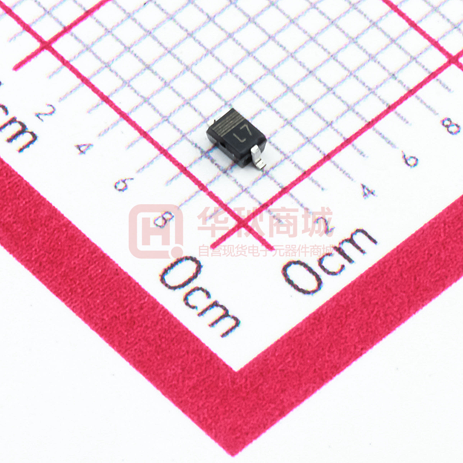

BZX384 series Voltage regulator diodes Rev. 3 — 11 October 2016 Product data sheet 1. Product profile 1.1 General description Low-power voltage regulator diodes in a small SOD323 (SC-76) Surface-Mounted Device (SMD) plastic package. The diodes are available in the normalized E24 2 % (BZX384-B) and approximately 5 % (BZX384-C) tolerance range. The series includes 37 breakdown voltages with nominal working voltages from 2.4 V to 75 V. 1.2 Features and benefits  Total power dissipation:  300 mW  Two tolerance series: 2 % and approximately 5 %  AEC-Q101 qualified  Working voltage range: nominal 2.4 V to 75 V (E24 range)  Non-repetitive peak reverse power dissipation:  40 W 1.3 Applications  General regulation functions 1.4 Quick reference data Table 1. Quick reference data Symbol Parameter Conditions VF forward voltage IF = 10 mA [1] Ptot total power dissipation Tamb  25 °C [2] Min Typ Max Unit - - 0.9 V - - 300 mW [1] Pulse test: tp  100 s;   0.02 [2] Device mounted on a FR4 Printed-Circuit Board (PCB), single-sided copper, tin-plated and standard footprint. BZX384 series Nexperia Voltage regulator diodes 2. Pinning information Table 2. Pinning Pin Symbol Description 1 K cathode 2 A anode Simplified outline Graphic symbol [1] 1 2 2 1 006aaa152 [1] The marking bar indicates the cathode. 3. Ordering information Table 3. Ordering information Type number Package BZX384 series[1] [1] Name Description Version SC-76 plastic surface-mounted package; 2 leads SOD323 The series includes 37 breakdown voltages with nominal working voltages from 2.4 V to 75 V and 2 % and 5 % tolerances. 4. Marking Table 4. Marking codes Type number Marking code Type number Marking code Type number Marking code Type number Marking code BZX384-B2V4 K1 BZX384-B15 M2 BZX384-C2V4 T3 BZX384-C15 DD BZX384-B2V7 K2 BZX384-B16 M3 BZX384-C2V7 T4 BZX384-C16 DE BZX384-B3V0 K3 BZX384-B18 M4 BZX384-C3V0 T5 BZX384-C18 DF BZX384-B3V3 K4 BZX384-B20 M5 BZX384-C3V3 T6 BZX384-C20 DG BZX384-B3V6 K5 BZX384-B22 M6 BZX384-C3V6 T7 BZX384-C22 DH BZX384-B3V9 K6 BZX384-B24 M7 BZX384-C3V9 T8 BZX384-C24 DJ BZX384-B4V3 K7 BZX384-B27 M8 BZX384-C4V3 T9 BZX384-C27 DK BZX384-B4V7 K8 BZX384-B30 M9 BZX384-C4V7 T0 BZX384-C30 DL BZX384-B5V1 K9 BZX384-B33 N0 BZX384-C5V1 D5 BZX384-C33 DM BZX384-B5V6 L1 BZX384-B36 N1 BZX384-C5V6 D6 BZX384-C36 DN BZX384-B6V2 L2 BZX384-B39 N2 BZX384-C6V2 T1 BZX384-C39 DP BZX384-B6V8 L3 BZX384-B43 N3 BZX384-C6V8 D7 BZX384-C43 DR BZX384-B7V5 L4 BZX384-B47 N4 BZX384-C7V5 D8 BZX384-C47 DS BZX384-B8V2 L5 BZX384-B51 N5 BZX384-C8V2 D9 BZX384-C51 DT BZX384-B9V1 L6 BZX384-B56 N6 BZX384-C9V1 D0 BZX384-C56 DU BZX384-B10 L7 BZX384-B62 N7 BZX384-C10 T2 BZX384-C62 DV BZX384-B11 L8 BZX384-B68 N8 BZX384-C11 DA BZX384-C68 DW BZX384-B12 L9 BZX384-B75 N9 BZX384-C12 DB BZX384-C75 DX BZX384-B13 M1 - - BZX384-C13 DC - - BZX384_SERIES Product data sheet All information provided in this document is subject to legal disclaimers. Rev. 3 — 11 October 2016 © Nexperia B.V. 2017. All rights reserved 2 of 13 BZX384 series Nexperia Voltage regulator diodes 5. Limiting values Table 5. Limiting values In accordance with the Absolute Maximum Rating System (IEC 60134). Symbol Parameter Conditions IF forward current Min Max Unit mA - 250 - see Table 8 and 9 IZSM non-repetitive peak reverse current [1] PZSM non-repetitive peak reverse power dissipation [1] - 40 W Ptot total power dissipation [2] - 300 mW Tj junction temperature 65 +150 C Tamb ambient temperature 65 +150 C Tstg storage temperature 65 +150 C Tamb  25 C [1] tp = 100 s; square wave; Tj = 25 C before surge [2] Device mounted on a FR4 PCB, single-sided copper, tin-plated and standard footprint. 6. Thermal characteristics Table 6. Thermal characteristics Symbol Parameter Conditions Rth(j-a) thermal resistance from junction to ambient in free air Rth(j-sp) thermal resistance from junction to solder point Min Typ Max Unit [1] - - 415 K/W [2] - - 110 K/W [1] Device mounted on a FR4 PCB, single-sided copper, tin-plated and standard footprint. [2] Soldering point of cathode tab. 7. Characteristics Table 7. Characteristics Tj = 25 C unless otherwise specified. Symbol VF [1] BZX384_SERIES Product data sheet Parameter Conditions forward voltage Min Typ Max Unit IF = 10 mA [1] - - 0.9 V IF = 100 mA [1] - - 1.1 V Pulse test: tp  100 s;   0.02 All information provided in this document is subject to legal disclaimers. Rev. 3 — 11 October 2016 © Nexperia B.V. 2017. All rights reserved 3 of 13 BZX384 series Nexperia Voltage regulator diodes Table 8. Characteristics per type; BZX384-B2V4 to BZX384-C24 Tj = 25 C unless otherwise specified. BZX384 Sel Working -xxx voltage VZ (V) 2V4 2V7 3V0 3V3 3V6 3V9 4V3 4V7 5V1 5V6 6V2 6V8 7V5 8V2 9V1 10 11 12 Differential resistance rdif () Reverse current IR (A) Temperature coefficient SZ (mV/K) Diode Non-repetitive capacitance peak reverse Cd (pF)[1] current IZSM (A)[2] IZ = 5 mA IZ = 1 mA IZ = 5 mA Min Max Typ Max Typ Max Max VR (V) Min Typ Max Max Max B 2.35 2.45 275 600 70 100 50 1 3.5 1.6 0 450 6.0 C 2.2 2.6 B 2.65 2.75 300 600 75 100 20 1 3.5 2.0 0 450 6.0 C 2.5 2.9 B 2.94 3.06 325 600 80 95 10 1 3.5 2.1 0 450 6.0 C 2.8 3.2 B 3.23 3.37 350 600 85 95 5 1 3.5 2.4 0 450 6.0 C 3.1 3.5 B 3.53 3.67 375 600 85 90 5 1 3.5 2.4 0 450 6.0 C 3.4 3.8 B 3.82 3.98 400 600 85 90 3 1 3.5 2.5 0 450 6.0 C 3.7 4.1 B 4.21 4.39 410 600 80 90 3 1 3.5 2.5 0 450 6.0 C 4.0 4.6 B 4.61 4.79 425 500 50 80 3 2 3.5 1.4 0.2 300 6.0 C 4.4 5.0 B 5.0 5.2 400 480 40 60 2 2 2.7 0.8 1.2 300 6.0 C 4.8 5.4 B 5.49 5.71 80 400 15 40 1 2 2.0 1.2 2.5 300 6.0 C 5.2 6.0 B 6.08 6.32 40 150 6 10 3 4 0.4 2.3 3.7 200 6.0 C 5.8 6.6 B 6.66 6.94 30 80 6 15 2 4 1.2 3.0 4.5 200 6.0 C 6.4 7.2 B 7.35 7.65 30 80 6 15 1 5 2.5 4.0 5.3 150 4.0 C 7.0 7.9 B 8.04 8.36 40 80 6 15 0.7 5 3.2 4.6 6.2 150 4.0 C 7.7 8.7 40 100 6 15 0.5 6 3.8 5.5 7.0 150 3.0 50 150 8 20 0.2 7 4.5 6.4 8.0 90 3.0 50 150 10 20 0.1 8 5.4 7.4 9.0 85 2.5 50 150 10 25 0.1 8 6.0 8.4 10.0 85 2.5 B 8.92 9.28 C 8.5 9.6 B 9.8 10.2 C 9.4 10.6 B 10.8 11.2 C 10.4 11.6 B 11.8 12.2 C 11.4 12.7 BZX384_SERIES Product data sheet IZ = 5 mA All information provided in this document is subject to legal disclaimers. Rev. 3 — 11 October 2016 © Nexperia B.V. 2017. All rights reserved 4 of 13 BZX384 series Nexperia Voltage regulator diodes Table 8. Characteristics per type; BZX384-B2V4 to BZX384-C24 …continued Tj = 25 C unless otherwise specified. BZX384 Sel Working -xxx voltage VZ (V) 13 15 16 18 20 22 24 Differential resistance rdif () Reverse current IR (A) Temperature coefficient SZ (mV/K) Diode Non-repetitive capacitance peak reverse Cd (pF)[1] current IZSM (A)[2] IZ = 5 mA IZ = 1 mA IZ = 5 mA Min Max Typ Max Typ Max Max VR (V) Min Typ Max Max Max B 12.7 13.3 50 170 10 30 0.1 7.0 9.4 11.0 80 2.5 C 12.4 14.1 50 200 10 30 0.05 10.5 9.2 11.4 13.0 75 2.0 50 200 10 40 0.05 11.2 10.4 12.4 14.0 75 1.5 50 225 10 45 0.05 12.6 12.4 14.4 16.0 70 1.5 60 225 15 55 0.05 14 14.4 16.4 18.0 60 1.5 60 250 20 55 0.05 15.4 16.4 18.4 20.0 60 1.25 60 250 25 70 0.05 16.8 18.4 20.4 22.0 55 1.25 B 14.7 15.3 C 13.8 15.6 B 15.7 16.3 C 15.3 17.1 B 17.6 18.4 C 16.8 19.1 B 19.6 20.4 C 18.8 21.2 B 21.6 22.4 C 20.8 23.3 B 23.5 24.5 C 22.8 25.6 [1] f = 1 MHz; VR = 0 V [2] tp = 100 s; square wave; Tj = 25 C before surge IZ = 5 mA 8 Table 9. Characteristics per type; BZX384-B27 to BZX384-C75 Tj = 25 C unless otherwise specified. BZX384 Sel Working -xxx voltage VZ (V) 27 30 33 36 39 43 Differential resistance rdif () Reverse current IR (A) Temperature coefficient SZ (mV/K) Diode Non-repetitive capacitance peak reverse Cd (pF)[1] current IZSM (A)[2] IZ = 2 mA IZ = 0.5 mA IZ = 2 mA Min Max Typ Max Typ Max Max VR (V) Min Typ Max Max Max B 26.5 27.5 65 300 25 80 0.05 18.9 21.4 23.4 25.3 50 1.0 C 25.1 28.9 B 29.4 30.6 70 300 30 80 0.05 21 24.4 26.6 29.4 50 1.0 C 28.0 32.0 B 32.3 33.7 75 325 35 80 0.05 23.1 27.4 29.7 33.4 45 0.9 C 31.0 35.0 B 35.3 36.7 80 350 35 90 0.05 25.2 30.4 33.0 37.4 45 0.8 C 34.0 38.0 B 38.2 39.8 80 350 40 130 0.05 27.3 33.4 36.4 41.2 45 0.7 C 37.0 41.0 B 42.1 43.9 85 375 45 150 0.05 30.1 37.6 41.2 46.6 40 0.6 C 40.0 46.0 BZX384_SERIES Product data sheet IZ = 2 mA All information provided in this document is subject to legal disclaimers. Rev. 3 — 11 October 2016 © Nexperia B.V. 2017. All rights reserved 5 of 13 BZX384 series Nexperia Voltage regulator diodes Table 9. Characteristics per type; BZX384-B27 to BZX384-C75 …continued Tj = 25 C unless otherwise specified. BZX384 Sel Working -xxx voltage VZ (V) 47 51 56 62 68 75 Differential resistance rdif () Reverse current IR (A) Temperature coefficient SZ (mV/K) Diode Non-repetitive capacitance peak reverse Cd (pF)[1] current IZSM (A)[2] IZ = 2 mA IZ = 0.5 mA IZ = 2 mA Min Max Typ Max Typ Max Max VR (V) Min Typ Max Max Max B 46.1 47.9 85 375 50 170 0.05 32.9 42.0 46.1 51.8 40 0.5 C 44.0 50.0 B 50.0 52.0 90 400 60 180 0.05 35.7 46.6 51.0 57.2 40 0.4 C 48.0 54.0 B 54.9 57.1 100 425 70 200 0.05 39.2 52.2 57.0 63.8 40 0.3 C 52.0 60.0 120 450 80 215 0.05 43.4 58.8 64.4 71.6 35 0.3 150 475 90 240 0.05 47.6 65.6 71.7 79.8 35 0.25 170 500 95 255 0.05 52.5 73.4 80.2 88.6 35 0.20 B 60.8 63.2 C 58.0 66.0 B 66.6 69.4 C 64.0 72.0 B 73.5 76.5 C 70.0 79.0 [1] f = 1 MHz; VR = 0 V [2] tp = 100 s; square wave; Tj = 25 C before surge IZ = 2 mA mbg801 103 PZSM (W) mbg781 300 IF (mA) 102 200 (1) 10 100 (2) 1 10−1 1 tp (ms) 0 0.6 10 0.8 1 VF (V) (1) Tj = 25 C (before surge) Tj = 25 C (2) Tj = 150 C (before surge) Fig 1. Non-repetitive peak reverse power dissipation as a function of pulse duration; maximum values BZX384_SERIES Product data sheet Fig 2. Forward current as a function of forward voltage; typical values All information provided in this document is subject to legal disclaimers. Rev. 3 — 11 October 2016 © Nexperia B.V. 2017. All rights reserved 6 of 13 BZX384 series Nexperia Voltage regulator diodes mbg783 0 mbg782 10 12 SZ (mV/K) SZ (mV/K) 4V3 11 10 −1 9V1 5 3V9 8V2 7V5 6V8 3V6 −2 6V2 5V6 5V1 0 3V3 4V7 3V0 2V4 2V7 −3 Fig 3. IR (A) 0 20 40 IZ (mA) −5 60 0 4 8 12 16 BZX384-B/C2V4 to BZX384-B/C4V3 BZX384-B/C4V7 to BZX384-B/C12 Tj = 25 C to 150 C Tj = 25 C to 150 C Temperature coefficient as a function of working current; typical values Fig 4. aaa-006665 10-1 2V4 10-2 2V7 10-3 3V0 3V3 3V6 3V9 4V3 4V7 5V1 IR (A) IZ (mA) 20 Temperature coefficient as a function of working current; typical values aaa-006666 10-1 7V5 10-2 10 12 15 18 22 8V2 10-3 9V1 11 13 16 20 24 10-4 10-4 10-5 10-5 10-6 5V6 6V2 6V8 10-6 10-7 10-7 10-8 10-9 10-8 0 2 4 6 8 0 5 10 15 20 VR (V) VR (V) BZX384-B/C7V5 to BZX384-B/C24 BZX384-B/C2V4 to BZX384-B/C6V8 Tamb = 25 C Fig 5. Tamb = 25 C Reverse current as a function of reverse voltage; typical values BZX384_SERIES Product data sheet 25 Fig 6. Reverse current as a function of reverse voltage; typical values All information provided in this document is subject to legal disclaimers. Rev. 3 — 11 October 2016 © Nexperia B.V. 2017. All rights reserved 7 of 13 BZX384 series Nexperia Voltage regulator diodes IR (A) aaa-006667 10-1 43 30 36 10-2 27 33 39 51 47 62 75 68 56 10-3 10-4 10-5 10-6 10-7 10-8 10-9 20 40 60 80 VR (V) BZX384-B/C27 to BZX384-B/C75 Tamb = 25 C Fig 7. Reverse current as a function of reverse voltage; typical values 8. Test information 8.1 Quality information This product has been qualified in accordance with the Automotive Electronics Council (AEC) standard Q101 - Stress test qualification for discrete semiconductors, and is suitable for use in automotive applications. 9. Package outline 1.35 1.15 1.1 0.8 0.45 0.15 1 2.7 2.3 1.8 1.6 2 0.40 0.25 Dimensions in mm Fig 8. BZX384_SERIES Product data sheet 0.25 0.10 03-12-17 Package outline SOD323 (SC-76) All information provided in this document is subject to legal disclaimers. Rev. 3 — 11 October 2016 © Nexperia B.V. 2017. All rights reserved 8 of 13 BZX384 series Nexperia Voltage regulator diodes 10. Soldering 3.05 2.1 solder lands solder resist 0.5 (2×) 1.65 0.95 0.6 (2×) solder paste occupied area 2.2 Dimensions in mm 0.5 (2×) 0.6 (2×) Fig 9. sod323_fr Reflow soldering footprint SOD323 (SC-76) 5 2.9 1.5 (2×) solder lands solder resist occupied area 2.75 1.2 (2×) Dimensions in mm preferred transport direction during soldering sod323_fw Fig 10. Wave soldering footprint SOD323 (SC-76) BZX384_SERIES Product data sheet All information provided in this document is subject to legal disclaimers. Rev. 3 — 11 October 2016 © Nexperia B.V. 2017. All rights reserved 9 of 13 BZX384 series Nexperia Voltage regulator diodes 11. Revision history Table 10. Revision history Document ID Release date Data sheet status Change notice Supersedes BZX384_SER v.3 20161011 Product data sheet - BZX384_SER v.2 Modifications: • The format of this data sheet has been redesigned to comply with the new identity guidelines of NXP Semiconductors . • • • • • • • • Legal texts have been adapted to the new company name where appropriate. Section 1 “Product profile”: enhanced. Table 5: Tamb added. Figure 5 to Figure 7: added. Section 8 “Test information”: added. Figure 9: replaced by minimized package outline. Section 10 “Soldering”: added. Section 12 “Legal information”: updated. BZX384_SER v.2 20040322 Product data sheet - BZX384_SER v.1 BZX384_SER v.1 20030401 Product specification - - BZX384_SERIES Product data sheet All information provided in this document is subject to legal disclaimers. Rev. 3 — 11 October 2016 © Nexperia B.V. 2017. All rights reserved 10 of 13 BZX384 series Nexperia Voltage regulator diodes 12. Legal information 12.1 Data sheet status Document status[1][2] Product status[3] Definition Objective [short] data sheet Development This document contains data from the objective specification for product development. Preliminary [short] data sheet Qualification This document contains data from the preliminary specification. Product [short] data sheet Production This document contains the product specification. [1] Please consult the most recently issued document before initiating or completing a design. [2] The term ‘short data sheet’ is explained in section “Definitions”. [3] The product status of device(s) described in this document may have changed since this document was published and may differ in case of multiple devices. The latest product status information is available on the Internet at URL http://www.nexperia.com. 12.2 Definitions Draft — The document is a draft version only. The content is still under internal review and subject to formal approval, which may result in modifications or additions. Nexperia does not give any representations or warranties as to the accuracy or completeness of information included herein and shall have no liability for the consequences of use of such information. Short data sheet — A short data sheet is an extract from a full data sheet with the same product type number(s) and title. A short data sheet is intended for quick reference only and should not be relied upon to contain detailed and full information. For detailed and full information see the relevant full data sheet, which is available on request via the local Nexperia sales office. In case of any inconsistency or conflict with the short data sheet, the full data sheet shall prevail. Product specification — The information and data provided in a Product data sheet shall define the specification of the product as agreed between Nexperia and its customer, unless Nexperia and customer have explicitly agreed otherwise in writing. In no event however, shall an agreement be valid in which the Nexperia product is deemed to offer functions and qualities beyond those described in the Product data sheet. 12.3 Disclaimers Limited warranty and liability — Information in this document is believed to be accurate and reliable. However, Nexperia does not give any representations or warranties, expressed or implied, as to the accuracy or completeness of such information and shall have no liability for the consequences of use of such information. Nexperia takes no responsibility for the content in this document if provided by an information source outside of Nexperia. In no event shall Nexperia be liable for any indirect, incidental, punitive, special or consequential damages (including - without limitation - lost profits, lost savings, business interruption, costs related to the removal or replacement of any products or rework charges) whether or not such damages are based on tort (including negligence), warranty, breach of contract or any other legal theory. Notwithstanding any damages that customer might incur for any reason whatsoever, Nexperia’s aggregate and cumulative liability towards customer for the products described herein shall be limited in accordance with the Terms and conditions of commercial sale of Nexperia. Right to make changes — Nexperia reserves the right to make changes to information published in this document, including without limitation specifications and product descriptions, at any time and without notice. This document supersedes and replaces all information supplied prior to the publication hereof. BZX384_SERIES Product data sheet Suitability for use in automotive applications — This Nexperia product has been qualified for use in automotive applications. Unless otherwise agreed in writing, the product is not designed, authorized or warranted to be suitable for use in life support, life-critical or safety-critical systems or equipment, nor in applications where failure or malfunction of a Nexperia product can reasonably be expected to result in personal injury, death or severe property or environmental damage. Nexperia and its suppliers accept no liability for inclusion and/or use of Nexperia products in such equipment or applications and therefore such inclusion and/or use is at the customer's own risk. Applications — Applications that are described herein for any of these products are for illustrative purposes only. Nexperia makes no representation or warranty that such applications will be suitable for the specified use without further testing or modification. Customers are responsible for the design and operation of their applications and products using Nexperia products, and Nexperia accepts no liability for any assistance with applications or customer product design. It is customer’s sole responsibility to determine whether the Nexperia product is suitable and fit for the customer’s applications and products planned, as well as for the planned application and use of customer’s third party customer(s). Customers should provide appropriate design and operating safeguards to minimize the risks associated with their applications and products. Nexperia does not accept any liability related to any default, damage, costs or problem which is based on any weakness or default in the customer’s applications or products, or the application or use by customer’s third party customer(s). Customer is responsible for doing all necessary testing for the customer’s applications and products using Nexperia products in order to avoid a default of the applications and the products or of the application or use by customer’s third party customer(s). Nexperia does not accept any liability in this respect. Limiting values — Stress above one or more limiting values (as defined in the Absolute Maximum Ratings System of IEC 60134) will cause permanent damage to the device. Limiting values are stress ratings only and (proper) operation of the device at these or any other conditions above those given in the Recommended operating conditions section (if present) or the Characteristics sections of this document is not warranted. Constant or repeated exposure to limiting values will permanently and irreversibly affect the quality and reliability of the device. Terms and conditions of commercial sale — Nexperia products are sold subject to the general terms and conditions of commercial sale, as published at http://www.nexperia.com/profile/terms, unless otherwise agreed in a valid written individual agreement. In case an individual agreement is concluded only the terms and conditions of the respective agreement shall apply. Nexperia hereby expressly objects to applying the customer’s general terms and conditions with regard to the purchase of Nexperia products by customer. All information provided in this document is subject to legal disclaimers. Rev. 3 — 11 October 2016 © Nexperia B.V. 2017. All rights reserved 11 of 13 BZX384 series Nexperia Voltage regulator diodes No offer to sell or license — Nothing in this document may be interpreted or construed as an offer to sell products that is open for acceptance or the grant, conveyance or implication of any license under any copyrights, patents or other industrial or intellectual property rights. Translations — A non-English (translated) version of a document is for reference only. The English version shall prevail in case of any discrepancy between the translated and English versions. Export control — This document as well as the item(s) described herein may be subject to export control regulations. Export might require a prior authorization from competent authorities. 12.4 Trademarks Quick reference data — The Quick reference data is an extract of the product data given in the Limiting values and Characteristics sections of this document, and as such is not complete, exhaustive or legally binding. Notice: All referenced brands, product names, service names and trademarks are the property of their respective owners. 13. Contact information For more information, please visit: http://www.nexperia.com For sales office addresses, please send an email to: salesaddresses@nexperia.com BZX384_SERIES Product data sheet All information provided in this document is subject to legal disclaimers. Rev. 3 — 11 October 2016 © Nexperia B.V. 2017. All rights reserved 12 of 13 Nexperia BZX384 series Voltage regulator diodes 14. Contents 1 1.1 1.2 1.3 1.4 2 3 4 5 6 7 8 8.1 9 10 11 12 12.1 12.2 12.3 12.4 13 14 © Product profile . . . . . . . . . . . . . . . . . . . . . . . . . . 1 General description . . . . . . . . . . . . . . . . . . . . . 1 Features and benefits . . . . . . . . . . . . . . . . . . . . 1 Applications . . . . . . . . . . . . . . . . . . . . . . . . . . . 1 Quick reference data . . . . . . . . . . . . . . . . . . . . 1 Pinning information . . . . . . . . . . . . . . . . . . . . . . 2 Ordering information . . . . . . . . . . . . . . . . . . . . . 2 Marking . . . . . . . . . . . . . . . . . . . . . . . . . . . . . . . . 2 Limiting values. . . . . . . . . . . . . . . . . . . . . . . . . . 3 Thermal characteristics . . . . . . . . . . . . . . . . . . 3 Characteristics . . . . . . . . . . . . . . . . . . . . . . . . . . 3 Test information . . . . . . . . . . . . . . . . . . . . . . . . . 8 Quality information . . . . . . . . . . . . . . . . . . . . . . 8 Package outline . . . . . . . . . . . . . . . . . . . . . . . . . 8 Soldering . . . . . . . . . . . . . . . . . . . . . . . . . . . . . . 9 Revision history . . . . . . . . . . . . . . . . . . . . . . . . 10 Legal information. . . . . . . . . . . . . . . . . . . . . . . 11 Data sheet status . . . . . . . . . . . . . . . . . . . . . . 11 Definitions . . . . . . . . . . . . . . . . . . . . . . . . . . . . 11 Disclaimers . . . . . . . . . . . . . . . . . . . . . . . . . . . 11 Trademarks. . . . . . . . . . . . . . . . . . . . . . . . . . . 12 Contact information. . . . . . . . . . . . . . . . . . . . . 12 Contents . . . . . . . . . . . . . . . . . . . . . . . . . . . . . . 13 Nexperia B.V. 2017. All rights reserved For more information, please visit: http://www.nexperia.com For sales office addresses, please send an email to: salesaddresses@nexperia.com Date of release: 11 October 2016

物料型号:BZX384系列
器件简介: - 这是一款低功耗电压调节二极管,采用小型SOD323 (SC-76)表面贴装设备(SMD)塑料封装。 - 包含37种击穿电压,标称工作电压从2.4V至75V,分为E24 ±2% (BZX384-B)和大约±5% (BZX384-C)的容差范围。
引脚分配: - 引脚1标为K,代表阴极。 - 引脚2标为A,代表阳极。
参数特性: - 总功耗:≤300 mW - 工作电压范围:标称2.4V至75V (E24范围) - 两种容差系列:±2%和大约±5% - 非重复峰值反向功耗:≤40W - 符合AEC-Q101标准
功能详解: - 一般调节功能。
应用信息: - 用于一般调节功能。
封装信息: - SOD323 (SC-76)塑料表面贴装封装,2个引脚。
订购信息: - 型号编号、封装类型、版本等详细信息。
标记代码: - 提供了不同型号的标记代码,例如BZX384-B2V4的标记代码为K1。
限制值: - 符合IEC 60134绝对最大额定值系统,包括正向电流、非重复峰值反向电流、非重复峰值反向功耗等。
热特性: - 包括结到环境的热阻、结到焊接点的热阻等。
特性: - 包括正向电压、正向电流等参数。
测试信息: - 产品已根据汽车电子委员会(AEC)标准Q101进行合格测试,适用于汽车应用。
封装轮廓和焊接信息: - 提供了SOD323 (SC-76)的封装轮廓图和焊接信息。
修订历史: - 记录了数据表的修订历史。
法律信息: - 包括数据表状态、定义、免责声明等。
