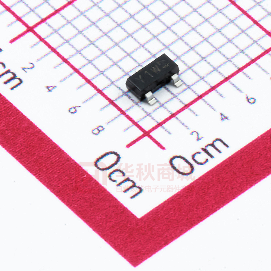

BZX84 series Voltage regulator diodes Rev. 6 — 6 March 2014 Product data sheet 1. Product profile 1.1 General description Low-power voltage regulator diodes in a small SOT23 (TO-236AB) Surface-Mounted Device (SMD) plastic package. The diodes are available in the normalized E24 1 % (BZX84-A), 2 % (BZX84-B) and approximately 5 % (BZX84-C) tolerance range. The series includes 37 breakdown voltages with nominal working voltages from 2.4 V to 75 V. 1.2 Features and benefits  Total power dissipation:  250 mW  Working voltage range: nominal 2.4 V to 75 V (E24 range)  Three tolerance series: 1 %, 2 % and  Non-repetitive peak reverse power approximately 5 % dissipation:  40 W  AEC-Q101 qualified 1.3 Applications  General regulation functions 1.4 Quick reference data Table 1. Quick reference data Symbol Parameter Conditions VF forward voltage IF = 10 mA [1] Ptot total power dissipation Tamb  25 °C [2] Min Typ Max Unit - - 0.9 V - - 250 mW [1] Pulse test: tp  100 s;   0.02 [2] Device mounted on a FR4 Printed-Circuit Board (PCB), single-sided copper, tin-plated and standard footprint. BZX84 series Nexperia Voltage regulator diodes 2. Pinning information Table 2. Pinning Pin Symbol Description 1 A anode 2 n.c. not connected 3 K cathode Simplified outline Graphic symbol K 3 n.c. A 1 2 aaa-006592 3. Ordering information Table 3. Ordering information Type number Package Name BZX84 [1] series[1] Description Version TO-236AB plastic surface-mounted package; 3 leads SOT23 The series includes 37 breakdown voltages with nominal working voltages from 2.4 V to 75 V and 1 %, 2 % and 5 % tolerances. 4. Marking Table 4. BZX84_SER Product data sheet Marking codes Type number Marking code[1] Type number Marking code[1] BZX84-A2V4 *50 BZX84-A18 KF* BZX84-A2V7 *51 BZX84-A20 *C2 BZX84-A3V0 *52 BZX84-A22 KG* BZX84-A3V3 *53 BZX84-A24 KH* BZX84-A3V6 *C1 BZX84-A27 *75 BZX84-A3V9 *55 BZX84-A30 KJ* BZX84-A4V3 *56 BZX84-A33 KK* BZX84-A4V7 *57 BZX84-A36 *C3 BZX84-A5V1 *58 BZX84-A39 *C4 BZX84-A5V6 *59 BZX84-A43 *C5 BZX84-A6V2 *60 BZX84-A51 *C6 BZX84-A6V8 *61 BZX84-A75 *86 BZX84-A7V5 *62 BZX84-B2V4 *Z0 BZX84-A8V2 *63 BZX84-B2V7 *Z1 BZX84-A9V1 *64 BZX84-B3V0 *S1 BZX84-A10 *65 BZX84-B3V3 *S2 BZX84-A11 *04 BZX84-B3V6 *S3 BZX84-A12 *67 BZX84-B3V9 *S4 BZX84-A13 *C0 BZX84-B4V3 *S7 BZX84-A15 *69 BZX84-B4V7 *S8 BZX84-A16 KE* BZX84-B5V1 *R1 All information provided in this document is subject to legal disclaimers. Rev. 6 — 6 March 2014 © Nexperia B.V. 2017. All rights reserved 2 of 16 BZX84 series Nexperia Voltage regulator diodes Table 4. Type number Marking code[1] Type number Marking code[1] BZX84-B5V6 *R2 BZX84-C3V9 *B3 BZX84-B6V2 *R5 BZX84-C4V3 *B6 BZX84-B6V8 *R6 BZX84-C4V7 Z1* BZX84-B7V5 *R8 BZX84-C5V1 Z2* BZX84-B8V2 *R9 BZX84-C5V6 Z3* BZX84-B9V1 *T1 BZX84-C6V2 Z4* BZX84-B10 *66 BZX84-C6V8 Z5* BZX84-B11 *Z6 BZX84-C7V5 Z6* BZX84-B12 *Z7 BZX84-C8V2 Z7* BZX84-B13 *Z8 BZX84-C9V1 Z8* BZX84-B15 *Z9 BZX84-C10 Z9* BZX84-B16 *70 BZX84-C11 Y1* BZX84-B18 *71 BZX84-C12 Y2* BZX84-B20 *72 BZX84-C13 Y3* BZX84-B22 *73 BZX84-C15 Y4* BZX84-B24 *74 BZX84-C16 Y5* BZX84-B27 *Z5 BZX84-C18 Y6* BZX84-B30 *Z4 BZX84-C20 Y7* BZX84-B33 *Y1 BZX84-C22 Y8* BZX84-B36 *Y2 BZX84-C24 Y9* BZX84-B39 *S0 BZX84-C27 *T2 BZX84-B43 *S5 BZX84-C30 *T5 BZX84-B47 *S6 BZX84-C33 *T6 BZX84-B51 *S9 BZX84-C36 *T7 BZX84-B56 *R0 BZX84-C39 *T8 BZX84-B62 *R3 BZX84-C43 *B4 BZX84-B68 *R4 BZX84-C47 *B5 BZX84-B75 *R7 BZX84-C51 *B7 BZX84-C2V4 *T3 BZX84-C56 *B8 BZX84-C2V7 *T4 BZX84-C62 *B9 BZX84-C3V0 *T9 BZX84-C68 *B0 BZX84-C3V3 *B1 BZX84-C75 *A1 BZX84-C3V6 *B2 - - [1] BZX84_SER Product data sheet Marking codes …continued * = placeholder for manufacturing site code All information provided in this document is subject to legal disclaimers. Rev. 6 — 6 March 2014 © Nexperia B.V. 2017. All rights reserved 3 of 16 BZX84 series Nexperia Voltage regulator diodes 5. Limiting values Table 5. Limiting values In accordance with the Absolute Maximum Rating System (IEC 60134). Symbol Parameter Conditions IF forward current Min Max Unit - 200 mA [1] - 40 W [2] - 250 mW PZSM non-repetitive peak reverse power dissipation Ptot total power dissipation Tamb ambient temperature - 150 C Tstg storage temperature 55 +150 C Tj junction temperature 65 +150 C Tamb  25 C [1] tp = 100 s; square wave; Tj = 25 C before surge [2] Device mounted on a FR4 PCB, single-sided copper, tin-plated and standard footprint. 6. Thermal characteristics Table 6. Symbol Thermal characteristics Parameter Conditions Rth(j-a) thermal resistance from junction to ambient Rth(j-sp) thermal resistance from junction to solder point in free air Min Typ Max Unit [1] - - 500 K/W [2] - - 330 K/W [1] Device mounted on a FR4 PCB, single-sided copper, tin-plated and standard footprint. [2] Soldering point of cathode tab. 7. Characteristics Table 7. Characteristics Tj = 25 C unless otherwise specified. Symbol VF [1] BZX84_SER Product data sheet Parameter Conditions forward voltage IF = 10 mA [1] Min Typ Max Unit - - 0.9 V Pulse test: tp  100 s;   0.02 All information provided in this document is subject to legal disclaimers. Rev. 6 — 6 March 2014 © Nexperia B.V. 2017. All rights reserved 4 of 16 BZX84 series Nexperia Voltage regulator diodes Table 8. Characteristics per type; BZX84-A2V4 to BZX84-C24 Tj = 25 C unless otherwise specified. BZX84- Sel Working xxx voltage VZ (V) 2V4 2V7 3V0 3V3 3V6 3V9 4V3 4V7 5V1 5V6 6V2 6V8 Differential resistance rdif () Reverse current IR (A) Temperature coefficient SZ (mV/K) Diode Non-repetitive capacitance peak reverse Cd (pF)[1] current IZSM (A)[2] IZ = 5 mA IZ = 1 mA IZ = 5 mA Min Max Typ Max Typ Max Max VR (V) Min Typ Max Max Max 275 600 70 100 50 1 3.5 1.6 0 450 6.0 300 600 75 100 20 1 3.5 2.0 0 450 6.0 325 600 80 95 10 1 3.5 2.1 0 450 6.0 350 600 85 95 5 1 3.5 2.4 0 450 6.0 375 600 85 90 5 1 3.5 2.4 0 450 6.0 400 600 85 90 3 1 3.5 2.5 0 450 6.0 410 600 80 90 3 1 3.5 2.5 0 450 6.0 425 500 50 80 3 2 3.5 1.4 0.2 300 6.0 400 480 40 60 2 2 2.7 0.8 1.2 300 6.0 80 400 15 40 1 2 2.0 1.2 2.5 300 6.0 40 150 6 10 3 4 0.4 2.3 3.7 200 6.0 30 80 6 15 2 4 1.2 3.0 4.5 200 6.0 A 2.37 2.43 B 2.35 2.45 C 2.2 2.6 A 2.67 2.73 B 2.65 2.75 C 2.5 2.9 A 2.97 3.03 B 2.94 3.06 C 2.8 3.2 A 3.26 3.34 B 3.23 3.37 C 3.1 3.5 A 3.56 3.64 B 3.53 3.67 C 3.4 3.8 A 3.86 3.94 B 3.82 3.98 C 3.7 4.1 A 4.25 4.35 B 4.21 4.39 C 4.0 4.6 A 4.65 4.75 B 4.61 4.79 C 4.4 5.0 A 5.04 5.16 B 5.0 5.2 C 4.8 5.4 A 5.54 5.66 B 5.49 5.71 C 5.2 6.0 A 6.13 6.27 B 6.08 6.32 C 5.8 6.6 A 6.73 6.87 B 6.66 6.94 C 6.4 7.2 BZX84_SER Product data sheet IZ = 5 mA All information provided in this document is subject to legal disclaimers. Rev. 6 — 6 March 2014 © Nexperia B.V. 2017. All rights reserved 5 of 16 BZX84 series Nexperia Voltage regulator diodes Table 8. Characteristics per type; BZX84-A2V4 to BZX84-C24 …continued Tj = 25 C unless otherwise specified. BZX84- Sel Working xxx voltage VZ (V) 7V5 8V2 9V1 10 11 12 13 15 16 18 20 22 Differential resistance rdif () Reverse current IR (A) Temperature coefficient SZ (mV/K) Diode Non-repetitive capacitance peak reverse Cd (pF)[1] current IZSM (A)[2] IZ = 5 mA IZ = 1 mA IZ = 5 mA Min Max Typ Max Typ Max Max VR (V) Min Typ Max Max Max A 7.42 7.58 30 80 6 15 1 5 2.5 4.0 5.3 150 4.0 B 7.35 7.65 C 7.0 7.9 A 8.11 8.29 40 80 6 15 0.7 5 3.2 4.6 6.2 150 4.0 B 8.04 8.36 C 7.7 8.7 40 100 6 15 0.5 6 3.8 5.5 7.0 150 3.0 50 150 8 20 0.2 7 4.5 6.4 8.0 90 3.0 150 10 20 0.1 8 5.4 7.4 9.0 85 2.5 150 10 25 0.1 8 6.0 8.4 10.0 85 2.5 170 10 30 0.1 8 7.0 9.4 11.0 80 2.5 200 10 30 0.05 10.5 9.2 11.4 13.0 75 2.0 200 10 40 0.05 11.2 10.4 12.4 14.0 75 1.5 225 10 45 0.05 12.6 12.4 14.4 16.0 70 1.5 60 225 15 55 0.05 14 14.4 16.4 18.0 60 1.5 250 20 55 0.05 15.4 16.4 18.4 20.0 60 1.25 A 9 9.2 B 8.92 9.28 C 8.5 9.6 A 9.9 10.1 B 9.8 10.2 C 9.4 10.6 A 10.8 11.11 50 B 10.8 11.2 11.6 C 10.4 A 11.88 12.12 50 B 11.8 12.2 C 11.4 12.7 A 12.87 13.13 50 B 12.7 13.3 C 12.4 14.1 A 14.85 15.15 50 B 14.7 15.3 C 13.8 15.6 A 15.84 16.16 50 B 15.7 16.3 C 15.3 17.1 A 17.82 18.18 50 B 17.6 18.4 C 16.8 19.1 A 19.8 20.2 B 19.6 20.4 C 18.8 21.2 A 21.78 22.22 60 B 21.6 22.4 C 20.8 23.3 BZX84_SER Product data sheet IZ = 5 mA All information provided in this document is subject to legal disclaimers. Rev. 6 — 6 March 2014 © Nexperia B.V. 2017. All rights reserved 6 of 16 BZX84 series Nexperia Voltage regulator diodes Table 8. Characteristics per type; BZX84-A2V4 to BZX84-C24 …continued Tj = 25 C unless otherwise specified. BZX84- Sel Working xxx voltage VZ (V) 24 Differential resistance rdif () Reverse current IR (A) Temperature coefficient SZ (mV/K) Diode Non-repetitive capacitance peak reverse Cd (pF)[1] current IZSM (A)[2] IZ = 5 mA IZ = 1 mA IZ = 5 mA Min Typ Max Typ Max Max VR (V) Min Typ Max Max Max 250 25 70 0.05 16.8 20.4 22.0 55 1.25 Max A 23.76 24.24 60 B 23.5 24.5 C 22.8 25.6 [1] f = 1 MHz; VR = 0 V [2] tp = 100 s; square wave; Tj = 25 C before surge IZ = 5 mA 18.4 Table 9. Characteristics per type; BZX84-A27 to BZX84-C75 Tj = 25 C unless otherwise specified. BZX84- Sel Working xxx voltage VZ (V) 27 30 33 36 39 43 47 51 Differential resistance rdif () IZ = 2 mA IZ = 0.5 mA IZ = 2 mA Min Typ Max Max VR (V) Min Typ Max Max Max 300 25 80 0.05 18.9 21.4 23.4 25.3 50 1.0 300 30 80 0.05 21 24.4 26.6 29.4 50 1.0 325 35 80 0.05 23.1 27.4 29.7 33.4 45 0.9 350 35 90 0.05 25.2 30.4 33.0 37.4 45 0.8 350 40 130 0.05 27.3 33.4 36.4 41.2 45 0.7 375 45 150 0.05 30.1 37.6 41.2 46.6 40 0.6 85 375 50 170 0.05 32.9 42.0 46.1 51.8 40 0.5 400 60 180 0.05 35.7 46.6 51.0 57.2 40 0.4 26.73 27.27 65 27.5 C 25.1 28.9 A 29.7 30.30 70 B 29.4 30.6 C 28.0 32.0 A 32.67 33.33 75 B 32.3 33.7 C 31.0 35.0 A 35.64 36.36 80 B 35.3 36.7 C 34.0 38.0 A 38.61 39.39 80 B 38.2 39.8 C 37.0 41.0 A 42.57 43.43 85 42.1 43.9 46.0 B 46.1 47.9 C 44.0 50.0 A 50.49 51.51 90 B 50.0 52.0 C 48.0 54.0 BZX84_SER Product data sheet IZ = 2 mA Max 26.5 40.0 Diode Non-repetitive capacitance peak reverse Cd (pF)[1] current IZSM (A)[2] Typ A C Temperature coefficient SZ (mV/K) Max B B Reverse current IR (A) All information provided in this document is subject to legal disclaimers. Rev. 6 — 6 March 2014 © Nexperia B.V. 2017. All rights reserved 7 of 16 BZX84 series Nexperia Voltage regulator diodes Table 9. Characteristics per type; BZX84-A27 to BZX84-C75 …continued Tj = 25 C unless otherwise specified. BZX84- Sel Working xxx voltage VZ (V) 56 62 68 75 Differential resistance rdif () Reverse current IR (A) Temperature coefficient SZ (mV/K) Diode Non-repetitive capacitance peak reverse Cd (pF)[1] current IZSM (A)[2] IZ = 2 mA IZ = 0.5 mA IZ = 2 mA Min Max Typ Max Typ Max Max VR (V) Min Typ Max Max Max B 54.9 57.1 100 425 70 200 0.05 39.2 52.2 57.0 63.8 40 0.3 C 52.0 60.0 B 60.8 63.2 120 450 80 215 0.05 43.4 58.8 64.4 71.6 35 0.3 C 58.0 66.0 B 66.6 69.4 150 475 90 240 0.05 47.6 65.6 71.7 79.8 35 0.25 C 64.0 72.0 A 74.25 75.75 170 500 95 255 0.05 52.5 73.4 80.2 88.6 35 0.20 B 73.5 76.5 C 70.0 79.0 [1] f = 1 MHz; VR = 0 V [2] tp = 100 s; square wave; Tj = 25 C before surge BZX84_SER Product data sheet IZ = 2 mA All information provided in this document is subject to legal disclaimers. Rev. 6 — 6 March 2014 © Nexperia B.V. 2017. All rights reserved 8 of 16 BZX84 series Nexperia Voltage regulator diodes mbg801 103 mbg781 300 PZSM (W) IF (mA) 102 200 (1) 10 100 (2) 1 10−1 1 0 0.6 10 tp (ms) 0.8 1 VF (V) (1) Tj = 25 C (before surge) Tj = 25 C (2) Tj = 150 C (before surge) Fig 1. Non-repetitive peak reverse power dissipation as a function of pulse duration; maximum values Fig 2. mbg783 0 Forward current as a function of forward voltage; typical values mbg782 10 12 SZ (mV/K) SZ (mV/K) 4V3 11 10 −1 9V1 5 3V9 8V2 7V5 6V8 3V6 −2 6V2 5V6 5V1 0 3V3 4V7 3V0 2V4 2V7 −3 Fig 3. 0 20 40 IZ (mA) −5 60 0 4 8 12 16 BZX84-A/B/C2V4 to BZX84-A/B/C4V3 BZX84-A/B/C4V7 to BZX84-A/B/C12 Tj = 25 C to 150 C Tj = 25 C to 150 C Temperature coefficient as a function of working current; typical values BZX84_SER Product data sheet Fig 4. IZ (mA) 20 Temperature coefficient as a function of working current; typical values All information provided in this document is subject to legal disclaimers. Rev. 6 — 6 March 2014 © Nexperia B.V. 2017. All rights reserved 9 of 16 BZX84 series Nexperia Voltage regulator diodes IR (A) aaa-006665 10-1 2V4 10-2 2V7 10-3 3V0 3V3 3V6 3V9 4V3 4V7 5V1 IR (A) aaa-006666 10-1 7V5 10-2 10 12 15 18 22 8V2 10-3 9V1 11 13 16 20 24 10-4 10-4 10-5 10-5 10-6 6V2 5V6 6V8 10-6 10-7 10-7 10-8 10-9 10-8 0 2 4 6 8 0 5 10 15 20 VR (V) VR (V) Fig 5. BZX84-A/B/C2V4 to BZX84-A/B/C6V8 BZX84-A/B/C7V5 to BZX84-A/B/C24 Tamb = 25 C Tamb = 25 C Reverse current as a function of reverse voltage; typical values IR (A) Fig 6. 25 Reverse current as a function of reverse voltage; typical values aaa-006667 10-1 43 30 36 10-2 27 33 39 51 47 62 75 68 56 10-3 10-4 10-5 10-6 10-7 10-8 10-9 20 40 60 80 VR (V) BZX84-A/B/C27 to BZX84-A/B/C75 Tamb = 25 C Fig 7. Reverse current as a function of reverse voltage; typical values 8. Test information 8.1 Quality information This product has been qualified in accordance with the Automotive Electronics Council (AEC) standard Q101 - Stress test qualification for discrete semiconductors, and is suitable for use in automotive applications. BZX84_SER Product data sheet All information provided in this document is subject to legal disclaimers. Rev. 6 — 6 March 2014 © Nexperia B.V. 2017. All rights reserved 10 of 16 BZX84 series Nexperia Voltage regulator diodes 9. Package outline 3.0 2.8 1.1 0.9 3 0.45 0.15 2.5 1.4 2.1 1.2 1 2 1.9 0.48 0.38 Dimensions in mm Fig 8. 0.15 0.09 04-11-04 Package outline SOT23 (TO-236AB) 10. Packing information Table 10. Packing methods The indicated -xxx are the last three digits of the 12NC ordering code.[1] Type number BZX84 BZX84_SER Product data sheet series[2] Package SOT23 (TO-236AB) Description 4 mm pitch, 8 mm tape and reel Packing quantity 3000 10000 -215 -235 [1] For further information and the availability of packing methods, see Section 14. [2] The series includes 37 breakdown voltages with nominal working voltages from 2.4 V to 75 V and 1 %, 2 % and 5 % tolerances. All information provided in this document is subject to legal disclaimers. Rev. 6 — 6 March 2014 © Nexperia B.V. 2017. All rights reserved 11 of 16 BZX84 series Nexperia Voltage regulator diodes 11. Soldering 3.3 2.9 1.9 solder lands solder resist 3 2 1.7 solder paste occupied area 0.6 (3×) 0.7 (3×) Dimensions in mm 0.5 (3×) 0.6 (3×) 1 Fig 9. sot023_fr Reflow soldering footprint SOT23 (TO-236AB) 2.2 1.2 (2×) 1.4 (2×) solder lands 4.6 solder resist 2.6 occupied area Dimensions in mm 1.4 preferred transport direction during soldering 2.8 4.5 sot023_fw Fig 10. Wave soldering footprint SOT23 (TO-236AB) BZX84_SER Product data sheet All information provided in this document is subject to legal disclaimers. Rev. 6 — 6 March 2014 © Nexperia B.V. 2017. All rights reserved 12 of 16 BZX84 series Nexperia Voltage regulator diodes 12. Revision history Table 11. Revision history Document ID Release date Data sheet status Change notice Supersedes BZX84_SER v.6 20140306 Product data sheet - BZX84_SER v.5 Modifications: • Descriptive title of the document corrected BZX84_SER v.5 20130918 Product data sheet - BZX84_SER v.4 BZX84_SER v.4 20130322 Product data sheet - BZX84_SERIES v.3 BZX84_SERIES v.3 20030410 Product data sheet - BZX84 v.2 BZX84 v.2 19990518 Product specification - BZX84 v.1 BZX84 v.1 19960426 Product specification - - BZX84_SER Product data sheet All information provided in this document is subject to legal disclaimers. Rev. 6 — 6 March 2014 © Nexperia B.V. 2017. All rights reserved 13 of 16 BZX84 series Nexperia Voltage regulator diodes 13. Legal information 13.1 Data sheet status Document status[1][2] Product status[3] Definition Objective [short] data sheet Development This document contains data from the objective specification for product development. Preliminary [short] data sheet Qualification This document contains data from the preliminary specification. Product [short] data sheet Production This document contains the product specification. [1] Please consult the most recently issued document before initiating or completing a design. [2] The term ‘short data sheet’ is explained in section “Definitions”. [3] The product status of device(s) described in this document may have changed since this document was published and may differ in case of multiple devices. The latest product status information is available on the Internet at URL http://www.nexperia.com. 13.2 Definitions Draft — The document is a draft version only. The content is still under internal review and subject to formal approval, which may result in modifications or additions. Nexperia does not give any representations or warranties as to the accuracy or completeness of information included herein and shall have no liability for the consequences of use of such information. Short data sheet — A short data sheet is an extract from a full data sheet with the same product type number(s) and title. A short data sheet is intended for quick reference only and should not be relied upon to contain detailed and full information. For detailed and full information see the relevant full data sheet, which is available on request via the local Nexperia sales office. In case of any inconsistency or conflict with the short data sheet, the full data sheet shall prevail. Product specification — The information and data provided in a Product data sheet shall define the specification of the product as agreed between Nexperia and its customer, unless Nexperia and customer have explicitly agreed otherwise in writing. In no event however, shall an agreement be valid in which the Nexperia product is deemed to offer functions and qualities beyond those described in the Product data sheet. 13.3 Disclaimers Limited warranty and liability — Information in this document is believed to be accurate and reliable. However, Nexperia does not give any representations or warranties, expressed or implied, as to the accuracy or completeness of such information and shall have no liability for the consequences of use of such information. Nexperia takes no responsibility for the content in this document if provided by an information source outside of Nexperia. In no event shall Nexperia be liable for any indirect, incidental, punitive, special or consequential damages (including - without limitation - lost profits, lost savings, business interruption, costs related to the removal or replacement of any products or rework charges) whether or not such damages are based on tort (including negligence), warranty, breach of contract or any other legal theory. Notwithstanding any damages that customer might incur for any reason whatsoever, Nexperia’s aggregate and cumulative liability towards customer for the products described herein shall be limited in accordance with the Terms and conditions of commercial sale of Nexperia. Right to make changes — Nexperia reserves the right to make changes to information published in this document, including without limitation specifications and product descriptions, at any time and without notice. This document supersedes and replaces all information supplied prior to the publication hereof. BZX84_SER Product data sheet Suitability for use in automotive applications — This Nexperia product has been qualified for use in automotive applications. Unless otherwise agreed in writing, the product is not designed, authorized or warranted to be suitable for use in life support, life-critical or safety-critical systems or equipment, nor in applications where failure or malfunction of a Nexperia product can reasonably be expected to result in personal injury, death or severe property or environmental damage. Nexperia and its suppliers accept no liability for inclusion and/or use of Nexperia products in such equipment or applications and therefore such inclusion and/or use is at the customer's own risk. Applications — Applications that are described herein for any of these products are for illustrative purposes only. Nexperia makes no representation or warranty that such applications will be suitable for the specified use without further testing or modification. Customers are responsible for the design and operation of their applications and products using Nexperia products, and Nexperia accepts no liability for any assistance with applications or customer product design. It is customer’s sole responsibility to determine whether the Nexperia product is suitable and fit for the customer’s applications and products planned, as well as for the planned application and use of customer’s third party customer(s). Customers should provide appropriate design and operating safeguards to minimize the risks associated with their applications and products. Nexperia does not accept any liability related to any default, damage, costs or problem which is based on any weakness or default in the customer’s applications or products, or the application or use by customer’s third party customer(s). Customer is responsible for doing all necessary testing for the customer’s applications and products using Nexperia products in order to avoid a default of the applications and the products or of the application or use by customer’s third party customer(s). Nexperia does not accept any liability in this respect. Limiting values — Stress above one or more limiting values (as defined in the Absolute Maximum Ratings System of IEC 60134) will cause permanent damage to the device. Limiting values are stress ratings only and (proper) operation of the device at these or any other conditions above those given in the Recommended operating conditions section (if present) or the Characteristics sections of this document is not warranted. Constant or repeated exposure to limiting values will permanently and irreversibly affect the quality and reliability of the device. Terms and conditions of commercial sale — Nexperia products are sold subject to the general terms and conditions of commercial sale, as published at http://www.nexperia.com/profile/terms, unless otherwise agreed in a valid written individual agreement. In case an individual agreement is concluded only the terms and conditions of the respective agreement shall apply. Nexperia hereby expressly objects to applying the customer’s general terms and conditions with regard to the purchase of Nexperia products by customer. All information provided in this document is subject to legal disclaimers. Rev. 6 — 6 March 2014 © Nexperia B.V. 2017. All rights reserved 14 of 16 BZX84 series Nexperia Voltage regulator diodes No offer to sell or license — Nothing in this document may be interpreted or construed as an offer to sell products that is open for acceptance or the grant, conveyance or implication of any license under any copyrights, patents or other industrial or intellectual property rights. Translations — A non-English (translated) version of a document is for reference only. The English version shall prevail in case of any discrepancy between the translated and English versions. Export control — This document as well as the item(s) described herein may be subject to export control regulations. Export might require a prior authorization from competent authorities. 13.4 Trademarks Quick reference data — The Quick reference data is an extract of the product data given in the Limiting values and Characteristics sections of this document, and as such is not complete, exhaustive or legally binding. Notice: All referenced brands, product names, service names and trademarks are the property of their respective owners. 14. Contact information For more information, please visit: http://www.nexperia.com For sales office addresses, please send an email to: salesaddresses@nexperia.com BZX84_SER Product data sheet All information provided in this document is subject to legal disclaimers. Rev. 6 — 6 March 2014 © Nexperia B.V. 2017. All rights reserved 15 of 16 Nexperia BZX84 series Voltage regulator diodes 15. Contents 1 1.1 1.2 1.3 1.4 2 3 4 5 6 7 8 8.1 9 10 11 12 13 13.1 13.2 13.3 13.4 14 15 © Product profile . . . . . . . . . . . . . . . . . . . . . . . . . . 1 General description . . . . . . . . . . . . . . . . . . . . . 1 Features and benefits . . . . . . . . . . . . . . . . . . . . 1 Applications . . . . . . . . . . . . . . . . . . . . . . . . . . . 1 Quick reference data . . . . . . . . . . . . . . . . . . . . 1 Pinning information . . . . . . . . . . . . . . . . . . . . . . 2 Ordering information . . . . . . . . . . . . . . . . . . . . . 2 Marking . . . . . . . . . . . . . . . . . . . . . . . . . . . . . . . . 2 Limiting values. . . . . . . . . . . . . . . . . . . . . . . . . . 4 Thermal characteristics . . . . . . . . . . . . . . . . . . 4 Characteristics . . . . . . . . . . . . . . . . . . . . . . . . . . 4 Test information . . . . . . . . . . . . . . . . . . . . . . . . 10 Quality information . . . . . . . . . . . . . . . . . . . . . 10 Package outline . . . . . . . . . . . . . . . . . . . . . . . . 11 Packing information . . . . . . . . . . . . . . . . . . . . 11 Soldering . . . . . . . . . . . . . . . . . . . . . . . . . . . . . 12 Revision history . . . . . . . . . . . . . . . . . . . . . . . . 13 Legal information. . . . . . . . . . . . . . . . . . . . . . . 14 Data sheet status . . . . . . . . . . . . . . . . . . . . . . 14 Definitions . . . . . . . . . . . . . . . . . . . . . . . . . . . . 14 Disclaimers . . . . . . . . . . . . . . . . . . . . . . . . . . . 14 Trademarks. . . . . . . . . . . . . . . . . . . . . . . . . . . 15 Contact information. . . . . . . . . . . . . . . . . . . . . 15 Contents . . . . . . . . . . . . . . . . . . . . . . . . . . . . . . 16 Nexperia B.V. 2017. All rights reserved For more information, please visit: http://www.nexperia.com For sales office addresses, please send an email to: salesaddresses@nexperia.com Date of release: 06 March 2014
BZX84-C11,215
物料型号:BZX84系列电压调节二极管
器件简介: - 低功耗电压调节二极管,采用小型SOT23 (TO-236AB)表面贴装设备(SMD)塑料封装。 - 包括37种击穿电压,标称工作电压从2.4V至75V。 - 提供E24系列的±1% (BZX84-A)、±2% (BZX84-B)和大约±5% (BZX84-C)的容差范围。
引脚分配: - 引脚1:A(阳极) - 引脚2:n.c.(不连接) - 引脚3:K(阴极)
参数特性: - 总功耗:≤250 mW - 工作电压范围:标称2.4V至75V (E24系列) - 非重复峰值反向功耗:≤40 W - 符合AEC-Q101标准
功能详解: - 一般调节功能
应用信息: - 适用于一般调节功能
封装信息: - TO-236AB塑料表面贴装封装,3引脚 - 包装方式:4 mm间距,8 mm胶带和卷轴
其他信息: - 文档还包含了限制值、热特性、特性表、测试信息、质量信息、封装轮廓、包装信息、焊接信息、修订历史、法律信息等。
