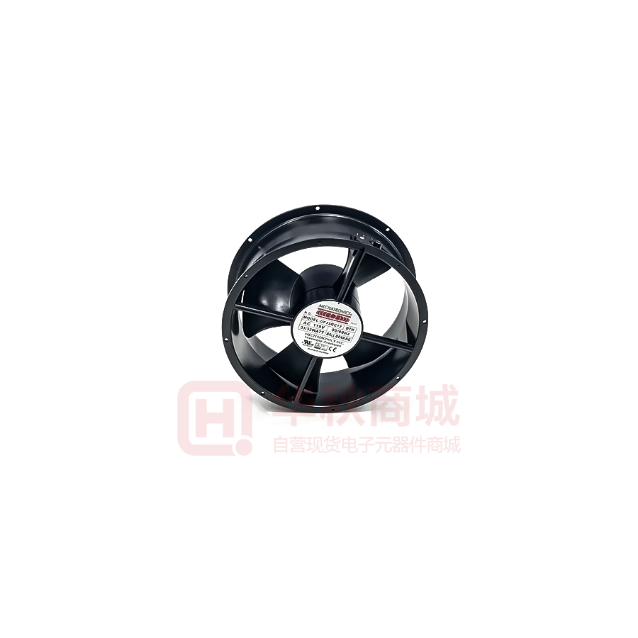

    FAN_D254X89MM
    轴流风机 254X89MM 115VAC
UF25GC12-BTHR 数据手册
3.5 ±0.02 (89 ±0.5) ø0.18 ±0.01 (ø4.6 ±0.2) ø8.6 6 (ø220) 0.9 0.10 (2.5) ø9.6 9 (ø246) STATIC PRESSURE - IN. OF WATER AC AXIAL FANS UF25GC series ø10.0 ±0.03 (ø254 +1.0 – 0.5 ) 0.8 0.7 1 2 0.6 3 0.5 0.4 0.3 0.2 0.1 0 100 200 300 400 500 600 700 800 900 AIR FLOW (CFM) (254 dia. x 89 mm) 0.12 (3) 10.0 dia. x 3.5 inches Construction: aluminum die cast frame; UL94V-0 PBT impeller Model No. TERMINAL TYPE Rated Freq. Input Rated Locked Speed Air Volume Max. Static Sound Weight Pressure (H2 0) Noise Voltage Power Cur. Cur. Curve M³/Min. CFM MM INCH dbA V HZ W A A RPM kg Bearing option: ball bearing Motor: permanent split capacitor UF25GC12-_ _H 115 60 33 0.29 0.51 1,650 15.5 550 10 0.40 55 1.90 1 Air Flow: exhaust over struts UF25GC23-_ _H 230 60 33 0.14 0.25 1,650 15.5 550 10 0.40 55 1.90 1 Connection: terminal or 22 AWG lead wires UF25GCA12-_ _H 115 60 75 0.66 0.70 2,600 19.3 680 9.4 0.37 62 1.90 2 Protection: thermal UF25GCA23-_ _H 230 60 75 0.35 0.36 2,600 19.3 680 9.4 0.37 62 1.90 2 UF25GCB12-_ _H 115 60 96 0.88 1.16 3200 23.0 812 20.7 0.82 65 2.30 3 Option: dual voltage 115/230VAC UF25GCB23-_ _H 230 60 98 0.45 0.60 3200 23.0 812 20.7 0.82 65 2.30 3 w w w.mechatronic s.com 12.30.19 t=0.5 0.31 (8) Operating voltage: 115 or 230 VAC LEAD WIRE TYPE E - mail: S ales @ M echatronic s.com Fa x : 425 -2 2 2- 515 5 Tel: 425 -2 2 2- 5 9 0 0 800-453-4569 Cooling Simplified
