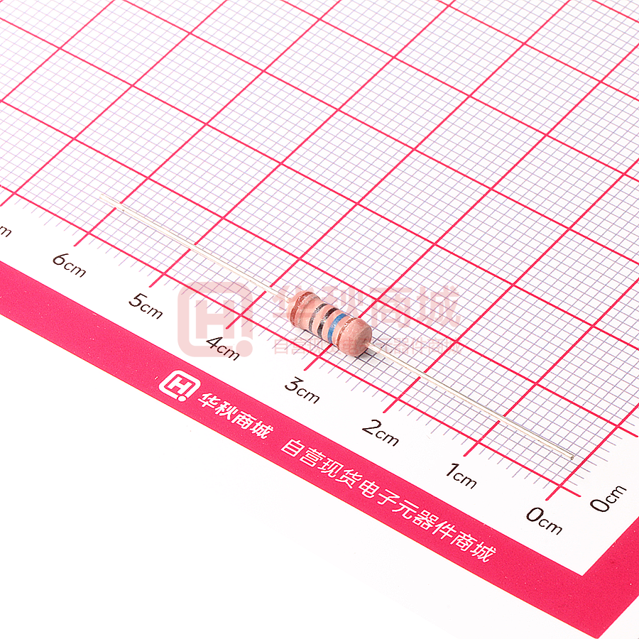

    金属膜电阻 AXIAL_D3.9X9MM_TM 160Ω ±1% 2W
FMP200FRF52-160R 数据手册
Through-hole resistors High Power & Flame-Proof Type Metal Film Resistors Ultra Miniature Style [ FMP Series ] FEATURES Power Rating 1/2W, 1W, 2W, 3W Resistance Tolerance ±1%, ±5% T.C.R. ±100ppm/°C Flameproof Multi-layer Coating Meets UL-94V-0 Flameproof Feature Meets Overload Test UL-1412 INTRODUCTION DERATING CURVE The FMP Series Metal Film High Power Resistors are manufactured using a vacuum sputtering system to deposit multiple layers of mixed metal alloys and passivative materials onto a carefully treated high grade ceramic substrate. After a helical groove has been cut in the resistive layer, tinned connecting leads of electrolytic copper are welded to the end-caps. The resistors are coated with layers of pink color lacquer. For resistors operated in ambient temperatures above 70°C, power rating must be derated in accordance with the curve below. 70 Rated Load (%) 155 °C 100 80 60 40 20 20 40 60 80 Ambient Temperature (°C) 100 120 140 160 DIMENSIONS Unit: mm ød H L øD STYLE DIMENSION Ultra Miniature L øD H ød FMP-50 3.4±0.3 1.9±0.2 28±2.0 0.45±0.05 FMP100 6.3±0.5 2.4±0.2 28±2.0 0.55±0.05 FMP200 9.0±0.5 3.9±0.3 26±2.0 0.55±0.05 FMP3WS 11.5±1.0 4.5±0.5 35±2.0 0.8±0.05 FMP300 15.5±1.0 5.0±0.5 33±2.0 0.8±0.05 15 Note: ELECTRICAL CHARACTERISTICS STYLE FMP-50 FMP100 FMP200 FMP3WS FMP300 Power Rating at 70°C 1/2W 1W 2W 3W Maximum Working Voltage 200V 350V 500V 750V Maximum Overload Voltage 400V 600V 700V 1,000V Voltage Proof on Insulation 300V 500V Resistance Range 1Ω - 4M7Ω & for E24 & E96 series value Operating Temp. Range -55°C to +155°C Temperature Coefficient ±100ppm/°C , ±50ppm/°C (FMP-50 & FMP100 types, R ≥ 10RΩ) Note: Special value is available on request ENVIRONMENTAL CHARACTERISTICS PERFORMANCE TEST TEST METHOD APPRAISE Short Time Overload IEC 60115-1 4.13 2.5 times RCWV for 5 sec. (Not more than maximum Overload Voltage) ±1.0%+0.05Ω Voltage Proof on Insulation IEC 60115-1 4.7 In V-Block for 60 sec., test voltage as above table No Breakdown Temperature Coefficient IEC 60115-1 4.8 Between -55°C to +155°C By type Insulation Resistance IEC 60115-1 4.6 in V-block for 60 Sec. >1,000MΩ Solderability IEC 60115-1 4.17 245±5°C for 3±0.5 Sec. 95% Min. coverage Solvent Resistance of Marking IEC 60115-1 4.30 IPA for 5±0.5 Min. with ultrasonic No deterioration of coatings and markings Robustness of Terminations IEC 60115-1 4.16 Direct load for 10 Sec. in the direction of the terminal leads ≥2.5kg (24.5N) Periodic-pulse Overload IEC 60115-1 4.39 4 times RCWV 10,000 cycles (1 Sec. on, 25 Sec. off) ±1.0%+0.05Ω Damp Heat Steady State IEC 60115-1 4.24 40±2°C, 90-95% RH for 56 days, loaded with 0.1 times RCWV ±2.0%+0.05Ω Endurance at 70°C IEC 60115-1 4.25 70±2°C at RCWV (or Umax., Whichever less) for 1,000 Hr. (1.5Hr.on, 0.5Hr. Off) ±2.0%+0.05Ω Temperature Cycling IEC 60115-1 4.19 -55°C  Room Temp.  +155°C  Room Temp. (5 cycles) ±1.0%+0.05Ω Resistance to Soldering Heat IEC 60115-1 4.18 260±3°C for 10±1 Sec., immersed to a point 3±0.5mm from the body ±0.25%+0.05Ω Accidental Overload Test IEC 60115-1 4.26 4 times RCWV for 1 Min. No evidence of flaming or arcing Note: RCWV(Rated Continuous Working Voltage) = Power Rating x Resistance Value or Max. working voltage listed above, whichever less. Revision: 2020
FMP200FRF52-160R
1. 物料型号:文档中提到的是FMP系列金属膜高功率电阻器。 2. 器件简介:这些电阻器使用真空溅射系统制造,将混合金属合金和钝化材料的多层沉积在经过仔细处理的高等级陶瓷基板上。电阻层切割螺旋槽后,将镀锡的连接引线焊接到端盖。电阻器涂有粉红色清漆层。 3. 引脚分配:文档中没有明确提供引脚分配信息,但提到了连接引线是镀锡的电解铜。 4. 参数特性: - 功率等级:1/2W、1W、2W、3W。 - 电阻公差:±1%、±5%。 - 温度系数:±100ppm/°C。 - 阻燃特性:符合UL-94V-0标准。 5. 功能详解:文档中提供了电阻器的降额曲线,说明了在70°C以上的环境温度下,功率等级需要根据曲线进行降额。 6. 应用信息:文档中没有直接提供应用信息,但根据电阻器的特性,它们可能适用于需要高功率和阻燃特性的场合。 7. 封装信息:提供了FMP系列不同型号的尺寸信息,包括外径(D)、高度(H)、引脚直径(od)。
