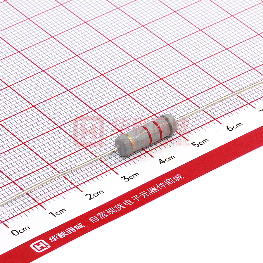

    插件电阻 AXIAL_D5X15.5MM_TM 8.2KΩ ±5% 2W ±300ppm/℃
RSF200JB-73-8K2 数据手册
Through-hole resistors Metal Oxide Film Resistors Flame-Proof Type Normal & Miniature Style [ RSF Series ] FEATURES Power Rating 1/4W, 1/2W, 1W, 2W, 3W, 5W Resistance Tolerance ±2%, ±5% T.C.R. ±300ppm/°C Flameproof Multi-layer Coating Meets UL-94V-0 Flameproof Feature Meets Overload Test UL-1412 INTRODUCTION The RSF Series Metal Oxide Film Flame-Proof Resistors offer excellent performance in applications where stability and uniformity of characteristics are desired. The normal style & ‘RSF-WV’ style of RSF series are coated with layers of gray flame-proof lacquer, and the miniature style are coated with layers of pink colors flame-proof lacquer. DERATING CURVE For resistors operated in ambient temperatures above 70°C, power rating must be derated in accordance with the curve below. 70 Rated Load (%) 155 235°C 100 80 60 40 20 50 100 150 200 250 Ambient Temperature (°C) DIMENSIONS Unit: mm STYLE ød H L øD Note: RSF1WS (for MB Type) ød = 0.8±0.05mm DIMENSION Normal Miniature L øD H ød RSF-25 RSF50S 6.3±0.5 2.4±0.2 28±2.0 0.55±0.05 RSF-50 RSF1WS 9.0±0.5 3.3±0.3 26±2.0 0.55±0.05 RSF100 RSF2WS 11.5±1.0 4.5±0.5 35±2.0 0.8±0.05 RSF200 RSF3WS 15.5±1.0 5.0±0.5 33±2.0 0.8±0.05 RSF3WM RSF5SS 17.5±1.0 6.5±1.0 32±2.0 0.8±0.05 RSF300 RSF5WS 24.5±1.0 8.5±1.0 38±2.0 0.8±0.05 RSF500 - 24.5±1.0 8.5±1.0 38±2.0 0.8±0.05 19 ELECTRICAL CHARACTERISTICS Normal STYLE STYLE RSF-25 RSF-50 RSF100 RSF200 RSF3WM RSF300 RSF500 Power Rating at 70°C 1/4W 1/2W 1W 2W 3W Maximum Working Voltage 200V 250V 350V 450V 500V 750V Maximum Overload Voltage 300V 400V 600V 700V 800V 1,000V Voltage Proof on Insulation 250V 350V 500V Resistance Range 1Ω - 1MΩ & for E24 series value Operating Temp. Range -55°C to +155°C Temperature Coefficient ±300ppm/°C 5W MINIATURE STYLE STYLE RSF50S RSF1WS Power Rating at 70°C 1/2W Maximum Working Voltage 250V Maximum Overload Voltage 400V Voltage Proof on Insulation 350V Resistance Range 1Ω - 1MΩ & for E24 series value Operating Temp. Range -55°C to +155°C Temperature Coefficient ±300ppm/°C 300V RSF2WS RSF3WS RSF5SS RSF5WS 2W 3W 5W 5W 350V 350V 500V 700V 800V 900V 600V 400V 500V Note: Special value is available on request ENVIRONMENTAL CHARACTERISTICS PERFORMANCE TEST TEST METHOD APPRAISE Short Time Overload IEC 60115-1 4.13 2.5 times RCWV for 5 sec. (Not more than maximum Overload Voltage) ±1.0%+0.05Ω for normal style ±2.0%+0.05Ω for miniature style Voltage Proof on Insulation IEC 60115-1 4.7 In V-Block for 60 sec., test voltage as above table No Breakdown Temperature Coefficient IEC 60115-1 4.8 Between -55°C to +155°C By type Insulation Resistance IEC 60115-1 4.6 in V-block for 60 Sec. >1,000MΩ Solderability IEC 60115-1 4.17 245±5°C for 3±0.5 Sec. 95% Min. coverage Solvent Resistance of Marking IEC 60115-1 4.30 IPA for 5±0.5 Min. with ultrasonic No deterioration of coatings and markings Robustness of Terminations IEC 60115-1 4.16 Direct load for 10 Sec. in the direction of the terminal leads ≥2.5kg (24.5N) Periodic-pulse Overload IEC 60115-1 4.39 4 times RCWV 10,000 cycles (1 Sec. on, 25 Sec. off) ±2.0%+0.05Ω Damp Heat Steady State IEC 60115-1 4.24 40±2°C, 90-95% RH for 56 days, loaded with 0.1 times RCWV ±5.0%+0.05Ω Endurance at 70°C IEC 60115-1 4.25 70±2°C at RCWV (or Umax., Whichever less) for 1,000 Hr. (1.5Hr.on, 0.5Hr. Off) ±5.0%+0.05Ω Temperature Cycling IEC 60115-1 4.19 -55°C  Room Temp.  +155°C  Room Temp. (5 cycles) ±1.0%+0.05Ω Resistance to Soldering Heat IEC 60115-1 4.18 260±3°C for 10±1 Sec., immersed to a point 3±0.5mm from the body ±1.0%+0.05Ω Accidental Overload Test IEC 60115-1 4.26 4 times RCWV for 1 Min. No evidence of flaming or arcing Note: Rated Continuous Working Voltage (RCWV) =  Power Rating x Resistance Value or Max. working voltage listed above, whichever less. Revision: 2020

物料型号:RSF系列
器件简介:RSF系列电阻器在需要特性稳定性和一致性的应用中表现出色。正常尺寸和RSF-WV风格涂有灰色阻燃漆,小型尺寸涂有粉红色阻燃漆。
引脚分配:文档未明确提供引脚分配信息。
参数特性: - 功率等级:1/4W, 1/2W, 1W, 2W, 3W, 5W - 电阻公差:±2%, ±5% - 温度系数:±300ppm/°C - 阻燃多层涂层符合:UL-94V-0 - 阻燃特性符合过载测试:UL-1412
功能详解:文档提供了电阻器的降额曲线、尺寸信息、电气特性、环境特性测试等详细信息。
应用信息:适用于需要特性稳定性和一致性的应用。
封装信息:提供了不同风格的尺寸信息,包括外径、高度、引脚直径等。
