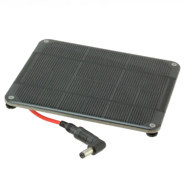

Page 1 of 2   Solar Panel - 2W PRT-13 781 ROH S   images are CC BY-NC-SA 3.0 Description: Have a project that needs some good power? Do you like free power provided by our friend, Mr. Sun? Check out this high quality, high output, fully enclosed solar panel with a nice solid aluminum/plastic frame. The panel is capable of 2 watts in the open sun with a peak power output around 6V at 378mA. The termination is equipped with a 3.5mm x 1.1mm barrel plug and 5.5mm x 2.1mm adapter on a 22cm (8in) cable making the panel able to mate directly with many of our development boards. Each panel also features monocrystalline high efficiency cells at 19% with a waterproof urethane coating with hard-board backing. With robust sealing for out door applications this solar panel is incredibly durable and reliable! Page 2 of 2 Dimensions: 135mm x 112mm x 5mm (5.3in x 4.4in x 0.2in) Includes: • 1x Solar Panel - 2W • 1x Barrel Plug Adapter - 3.5mm to 5.5mm Features: • • • • • • • • Monocrystalline cells - 19% efficient Open Circuit Voltage: 7.0V Peak Voltage: 6.0V Peak Current: 378mA Peak Power: 2.27 Watts Four screws on back corners of panel allow multiple mounting options Waterproof Urethane Coating UV Resistant https://www.sparkfun.com/products/13781 4/13/2016

器件简介:太阳能板,2瓦特输出功率,采用高质量的全封闭设计,带有铝/塑料框架。在充足阳光下,其峰值功率输出约为6V,378mA。该太阳能板使用了19%效率的单晶高效电池,具有防水聚氨酯涂层和硬板背衬,非常适合户外应用,非常耐用可靠。
引脚分配:文档中没有明确提供引脚分配的详细信息,但提到了端子配置有3.5mm x 1.1mm的插头和5.5mm x 2.1mm的适配器,这些适配器位于22厘米(8英寸)的电缆上。
参数特性:单晶电池,19%效率,开路电压7.0V,峰值电压6.0V,峰值电流378mA,峰值功率2.27瓦特。
功能详解:太阳能板可以在充足阳光下产生2瓦特的电力,适合需要清洁能源的项目。
应用信息:适用于需要太阳能供电的项目,特别是户外应用。
封装信息:尺寸为135mm x 112mm x 5mm(5.3in x 4.4in x 0.2in),包括1个太阳能板-2W和1个3.5mm到5.5mm的插头适配器。
