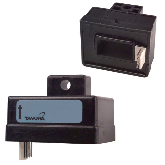

L03S050D15 数据手册
Hall Effect Current Sensors L03S***D15 Series Features: • • • • Advantage: Open Loop type Panel mounting Molex connector Insulated plastic case according to UL94V0 Excellent accuracy and linearity Low temperature drift Wide frequency bandwidth No insertion loss High Immunity To External Interference Current overload capability • • • • • • Specifications Parameters TA=25ºC, VCC=±15V, RL=10kΩ Symbol L03S050D15 L03S100D15 L03S200D15 L03S300D15 L03S400D15 L03S500D15 L03S600D15 If 50AT 100AT 200AT Maximum Current Ifmax ±150AT ±300AT ±600AT Output Voltage VOUT Offset Voltage VOE Rated current 300AT 400AT 4V±40mV @ If ≤±40mV @ If = 0A ≤±30mV @ If = 0A X ±1% @ If Output Linearity1 εL ≤±1% @ If VCC ±15V±5% Consumption Current IC < 12mA Response Time2 tr < 5µs (@ di/dt=50A / µs) Output Temperature CharacTCVOUT teristic1 Offset Temperature CharacTCVOE teristic Hysteresis error 600AT >±700AT Accuracy1 Power Supply 500AT ≤±2mV/ºC < ± 2mV/ºC < ± 1.0 mV/ºC ±30mV (@ 0A ⇔ If) VOH ±20mV (@ 0A ⇔ If) ±10mV (@ 0A ⇔ If) Withstand Voltage Vd AC2500V for 1minute (sensing current 0.5mA), inside of through hole ⇔ terminal Insulation Resistance RIS > 500MΩ (500V DC), inside of through hole ⇔ terminal Frequency Bandwidth3 f DC .. 50kHz Operating Temperature TA -20ºC~+80ºC Storage Temperature TS -20ºC~+85ºC 1 Without offset — 2 Time between 10% input current full scale and 90% of sensor output full scale — 3 Small signal only to avoid excessive heating of magnetic core Electrical Performances Frequency Characteristic (L03S600D15) Saturation Characteristic (L03S600D15) 2,0 O utput Voltage (V) 6,0 Attenuation (dB) 0,0 - 2,0 - 4,0 - 6,0 - 8,0 4,0 2,0 0,0 -2,0 -4,0 -6,0 - 10,0 0,1 1 10 If frequency (kHz) @ If=6.0Arms L03SXXXD15revC, March 2009 100 -1200 -1000 -800 - 600 -400 -200 0 200 400 Input current (A) Tamura reserve the right to modify its products in order to improve them without prior notice 600 800 1000 1200 Hall Effect Current Sensors L03S***D15 Series Mechanical dimensions in mm Ø4.5 D15 Ø2.5 Lot No. Note 1: Unless otherwise specified, tolerances shall be ±0.5 20 L03S Recommended retainer holes 40.5 MAX Terminal number: 1. +15V 2. -15V 3. VOUT 4. 0V Connector 29.5 MAX 5045-04A (MOLEX) Terminal number 19.5 MAX 20 39 MAX 4321 30.5 MAX Ø4.5 3 15 10.5 4.5 20.5 Ø2 18.5 MAX Electrical connection diagram +VCC -VCC 1 2 3 4 GND VOUT RL = 10kΩ +If -If Package & Weight Information L03SXXXD15revC, March 2009 Weight Pcs/box Pcs/carton Pcs/pallet 46g 50 200 2400 Tamura reserve the right to modify its products in order to improve them without prior notice
