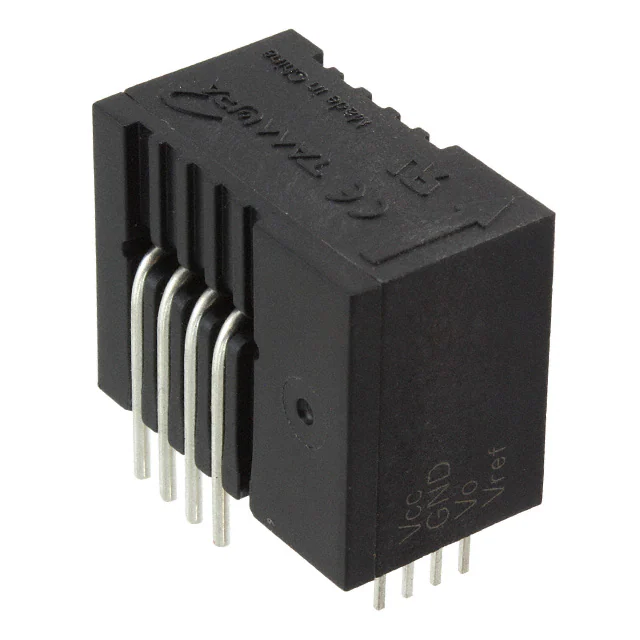

Issued by Module Components Div, TAMURA CORPORATION Current Sensor : F03P***S05L Features:       Backward compatible to F02PS***05 series Anti-Surge current (4kAT, 8/20uS, single) Mounting area reduced ; pin compatible. Longitudinal dimension reduced Super precision & High Stability (low temperature, drift) Unipolar power voltage ; +5V Multi-range models Comparison of the main features of F******S05L series Series Features F01P***S05L No reference access F02P***S05L No reference access. Ref In/Out F03P***S05L No reference access. Ref In/Out. Higher creep age and clearance distance. *** = Rated Current Symbol Specification F03P***S05L Maximum Peak Current 4kAT (2kAx2. Number of primary tunes is two tunes) Rated Current If (***= rated current symbol) 6A(006) / 15A(015) / 25A(025) 50A(050) Maximum Current ±20A(If=6A) / ±51A(If=15A) / ±85A(If=25A) / ±150A(If=50A) Existence of reference access Yes Number of primary busbar 4 pcs Clearance distance ; Primary ↔Secondary 8.2 mm Standards UL508 (file#E243511) , EN501758, EN61010-1 , EN60950-1 Ambient Operating Temperature -40°C ~ +105°C Mounting Area The mounting area has been reduced more than the F03P series. However , F03P***S05L series are 100% compatible with original footprint mounting. F03PxxxS05LrevA Dec 2013 1 Issued by Module Components Div, TAMURA CORPORATION Current Sensor : F03P***S05L Absolute Maximum Rating Symbol Unit Value Vcc V 7 Primary Conductor Temperature - °C 110 ESD (HBM: Human Body Model) - kV 4 C=100pF , R=1.5kΩ Maximum Peak Current - kAT 4 Current Waveform :  Front time 8ųs  Time to half value 20ųs  Single Supply Voltage Notes Isolation Characteristics Symbol Unit Value Insulation Voltage Vd - AC4300V for 1 min. (Sensing Current 0.5mA) Primary↔Secondary Insulation Resistance Ris - ≥500mΩ (@DC500V) Primary↔Secondary Clearance distance dCi - 8.2mm (TYP) Primary↔Secondary Creep age distance dCp - 8.2mm (TYP) Primary↔Secondary - - UL94 V-0 CTI V 600 - - 300V , CAT Ⅲ , PD2 Reinforced Isolation Non uniform field according to EN61010 - - 600V , CAT Ⅲ , PD2 Simple isolation Non uniform field according to EN50178 1000V , CAT Ⅲ , PD2 Simple isolation Non uniform field according to EN50178 , Case material Comparative Tracking Index (CTI) Application Example Notes Environmental and Mechanical Characteristics Symbol Unit Value min typ max Ambient Operating Temperature Ta °C - 40 + 105 Ambient Storage Temperature Ts °C - 40 +105 - g Mass F03PxxxS05LrevA Dec 2013 12 2 Issued by Module Components Div, TAMURA CORPORATION Current Sensor : F03P***S05L Specification (*1) = Offset voltage value is after removal of core hysteresis Symbol Unit Value min Rated Current F03P006S05L F03P015S05L F03P025S05L If 15 A 25 50 F03P006S05L F03P015S05L F03P025S05L Ipmax A F03P050S05L Supply Voltage Vcc V Number of primary turns Np T Number of secondary turns - 20 20 - 51 51 - 85 85 - 150 150 4.75 Ns 1737 T 1764 F03P050S05L 1600 F03P006S05L 25 F03P015S05L F03P025S05L 5.25 1816 F03P015S05L Consumption current (at If) 5.00 1,2,3,4 F03P006S05L F03P025S05L max 6 F03P050S05L Maximum Current (@ Vcc : +5V , Ta : +105°C) typ Notes Icc 30 mA Icc=15+Ip(mA) / Ns 35 F03P050S05L 55 Internal Reference Voltage (@Ip=0A) Vref1 V 2.495 External Reference Voltage Vref2 V 0 4 Vo V 0.375 4.625 Vo V Output Voltage Output Voltage (Ip=0A) Electrical Offset Voltage (*1 ) F03P006S05L - 2.210 2.210 - 1.35 1.35 F03P050S05L - 0.725 0.725 F03P006S05L - 51 51 - 53 53 - 54 54 - 58 58 F03P015S05L F03P025S05L F03P050S05L Voe Ioe mV mA Ref OUT mode Ref IN mode Vref1, Vref 2 5.300 F03P025S05L F03PxxxS05LrevA Dec 2013 2.505 - 5.300 F03P015S05L Electrical Offset Current referred to primary 2.500 3 Issued by Module Components Div, TAMURA CORPORATION Current Sensor : F03P***S05L Specification Symbol Unit Value min Temperature coefficient of Internal reference voltage Temperature coefficient of Output voltage (@ Ip=0A) Sensitivity (Theoretical value) Notes typ max TCVref1 ppm/K ±5.0 ±50 TCVo ppm/K ±6.0 ±14 F03P015S05L ±2.3 ±6 F03P025S05L ±1.4 ±4 F03P050S05L ±0.7 ±3 F03P006S05L 104.2 F03P006S05L F03P015S05L F03P025S05L 41.67 Gth mV/A 625mV/If 25 F03P050S05L Sensitivity Error 12.5 ᵋG % TCG ppm/K ᵋL % - 0.1 0.1 Magnetic offset current referred to primary (@ 10xIf) Iom A - 0.1 0.1 Output current noise referred to primary (@ 100Hz~100kHz) Ino ųA/ (Hz)1/2 20 - mV 40 160 F03P015S05L 15 60 F03P025S05L 10 40 F03P050S05L 5 20 Temperature coefficient of Sensitivity (@Ta=-40°C~+105°C) Output Linearity Peak to peak output ripple at oscillator frequency (If typ=450kHz) Reaction time (@ 10% of If) F03P006S05L F03P006S05L 0.7 ±40 RL=1kΩ RL=1kΩ RL=1kΩ, di/dt=18A/ųs 0.3 RL=1kΩ, di/dt=44A/ųs 0.3 RL=1kΩ, di/dt=68A/ųs F03P050S05L 0.3 RL=1kΩ, di/dt=100/ųs F03P006S05L 0.3 RL=1kΩ, di/dt=18A/ųs 0.3 RL=1kΩ, di/dt=44A/ųs 0.3 RL=1kΩ, di/dt=68A/ųs 0.3 RL=1kΩ, di/dt=100/ųs F03P025S05L tra ųs F03P015S05L F03P025S05L F03P050S05L F03PxxxS05LrevA Dec 2013 - 0.7 0.3 F03P015S05L Response time (@90% of If) ppm/K of 2.5V ( -40°C~+105°C) tr ųs 4 Issued by Module Components Div, TAMURA CORPORATION Current Sensor : F03P***S05L Specification Symbol Unit Value min typ Notes max Response time 2 (@ 10% of If to 90% of Vo) Frequency bandwidth (± 1dB) Frequency bandwidth (± 3dB) Output Voltage Accuracy (Overall) tr ųs 0.6 BW kHz 200 RL=1kΩ BW kHz 300 RL=1kΩ F03P006S05L F03P015S05L RL=1kΩ 1.7 XG % 1.2 F03P025S05L 1.0 F03P050S05L 0.9 XG=(100xVoe/625)+ԐG+ԐL Standards EN 50178 ; EN 61010-1 ; EN 60950-1 ; UL 508 (file no. E243511) Characteristic Curve (TYP) F03PxxxS05LrevA Dec 2013 5 Issued by Module Components Div, TAMURA CORPORATION Current Sensor : F03P***S05L Maximum Continuous DC primary current According to which the following conditions are true the maximum continuous DC primary current plot shows the boundary of the area. 1. Ip < Ipmax 2. Junction temperature Tj < 125ºC 3. Primacy conductor temperature < 110°C 4. Resistor power dissipation < 0.5 x rated power Frequency Derating Figure 7 : Maximum RMS AC primary current / maximum DC primary current vs frequency F03PxxxS05LrevA Dec 2013 6 Issued by Module Components Div, TAMURA CORPORATION Current Sensor : F03P***S05L Reference voltage Ref pin has two modes Ref IN and Ref OUT. The 2.5V internal precision reference is used by the transducer as the reference point for bipolar measurement. An external reference voltage is connected to the Ref pin; this voltage is specified in the range 0 to 4V. Its voltage is used as the reference voltage at the time of measurement. - Typical Source Current (Vref 2– 2.5) / 680 The maximum value will be 2.2mA typ when Vref2=4V - Typical Sink Current (Vref 2 - 2.5) / 680 The maximum value will be 3.68mA typ. When Vref2=0V The following graphs show how the measuring range of each transducer version depends on external reference voltage value If do not prefer to use the Ref pin, please disconnect. F03PxxxS05LrevA Dec 2013 7 Issued by Module Components Div, TAMURA CORPORATION Current Sensor : F03P***S05L Connection Dimensions (mm) Recommended Hole Diameter (mm) F03PxxxS05LrevA Dec 2013 8
