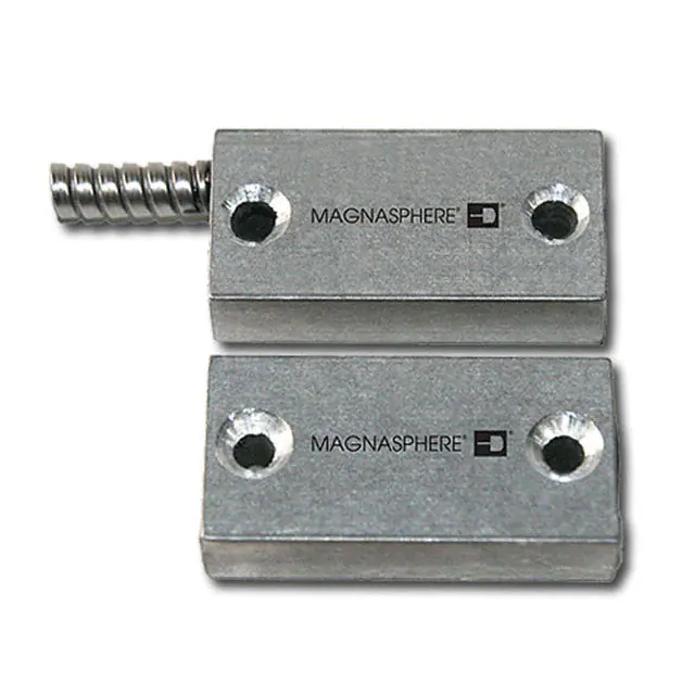

MAGNASPHERE introduces the MSS-300 Series, Recessed and Surface-Mount Contacts that offer two or three separate contact outputs – Ideal for installations where a single contact is desired for use with multiple independent systems (e.g. IDS and ACS) and Home Automation applications NEW MAGNASPHERE MSS-300 Technology In response to a request from the U.S. Department of State, MAGNASPHERE has introduced both a 1” concealed and a Surface Mount version of multiple switch contacts for non-high security installations. Each style offers individual contacts made with Magnasphere BMS switch technology in two and three contact configurations and both Open and Closed Loop variations, depending on installation requirements. The MSS-300 Series provides a single switch solution for monitoring multiple systems (Intrusion Detection and Access Control) and for Home Automation applications. Older style security contacts have been made with a decades-old technology call the Reed switch, which have three inherent weaknesses when used as security contacts. They are (1) Easily defeated with magnets (2) Prone to permanent contact weld failure (lightning, power surges) and (3) Fragile (made mostly of glass, they are subject to damage even when packaged as security contacts). The unique Magnasphere switch used in these devices renders the MSS-300 series products virtually unbreakable and highly resistant to permanent contact welding and outsider magnetic defeat. © MAGNASPHERE CORP. Multiple (2 or 3) individual contact outputs Available in closed and open loop configurations Available in 1" diameter recessed, and surface-mount, armored cable versions Compatible with all control panels American-made with patented MAGNASPHERE switch technology Resists permanent contact welding (power surges, stun guns, lightning) Highest level of security for every installation UL 634 listed www.MAGNASPHERE.com CONSTRUCTION AND TECHNICAL SPECIFICATIONS MSS-3XXC (Concealed / Recessed Contacts) MODEL MSS–3XXC Concealed Mount Concealed / Recessed Security Sensor # of Open Loops MSS 3 X X C Triple Loop Capacity # of Closed Loops Retaining Barbs Magnet Module Model MSS-330C Switch Module RED Open Loop RED BLK Open Loop BLK WHT Open Loop Max Current: 0.25 A Resistive Max Power: 0.25 W Resistive Max Voltage: 30 VDC Intended for connection to UL Listed compatible control panels for U.S. applications and a ULC Listed compatible control panel for Canadian applications Model MSS-303C WHT RED Contact States Shown with Magnet in Place Closed Loop RED BLK Closed Loop BLK WHT Closed Loop WHT MAGNASPHERE® Corp. provides superior performing magnetic contact sensor technology for the residential, commercial, and federal government security markets. The MSS series leading-edge technology aims to set new industry standards for security sensors while providing an affordable and more effective alternative to reed-based security contacts. To learn more about the MAGNASPHERE® MSS series visit www.MAGNASPHERE.com or call 262-347-0711. © MAGNASPHERE CORP. www.MAGNASPHERE.com CONSTRUCTION AND TECHNICAL SPECIFICATIONS MSS-3XXS (Surface-Mount Contacts) MODEL MSS–3XXS Surface-Mount Surface-Mounted Security Sensor # of Closed Loops 3 MSS 24” (60 cm) Armored X X S Triple Loop Capacity 4x #8 Flat Head Screw Model MSS-303S Switch Module # of Open Loops Magnet Module Max Power: 0.25 W Resistive Max Voltage: 30 VDC Intended for connection to UL Listed compatible control panels for U.S. applications and a ULC Listed compatible control panel for Canadian applications Open Loop BLK WHT Open Loop WHT RED Open Loop RED Model MSS-330S Max Current: 0.25 A Resistive BLK BLK Contact States Shown with Magnet in Place Closed Loop BLK WHT Closed Loop WHT RED Closed Loop RED MAGNASPHERE® Corp. provides superior performing magnetic contact sensor technology for the residential, commercial, and federal government security markets. The MSS series leading-edge technology aims to set new industry standards for security sensors while providing an affordable and more effective alternative to reed-based security contacts. To learn more about the MAGNASPHERE® MSS series visit www.MAGNASPHERE.com or call 262-347-0711. © MAGNASPHERE CORP. www.MAGNASPHERE.com Open Loop RED BLK Open Loop BLK WHT Model MSS-311C Model MSS-330C RED RED Open Loop RED BLK Closed Loop BLK Open Loop Contact States Shown with Magnet in Place Open Loop Model MSS-310C RED RED RED BLK Open Loop BLK WHT Closed Loop WHT RED BLK Closed Loop BLK Closed Loop WHT RED Open Loop BLK Open Loop BLK RED Model MSS-302C RED RED Closed Loop RED BLK Closed Loop BLK Open Loop RED BLK Closed Loop BLK WHT WHT Closed Loop Model MSS-301C Model MSS-320C Model MSS-312C Closed Loop RED WHT © MAGNASPHERE CORP. Open Loop RED Model MSS-303C MSS-3XXC Wiring Schematics Model MSS-321C WHT RED Closed Loop RED www.MAGNASPHERE.com Open Loop BLK WHT Open Loop WHT RED Model MSS-311S Model MSS-303S BLK BLK Closed Loop BLK WHT Open Loop WHT Open Loop Contact States Shown with Magnet in Place Closed Loop Model MSS-301S BLK BLK BLK WHT Open Loop WHT RED Open Loop RED BLK WHT Closed Loop WHT Closed Loop RED BLK Open Loop WHT Open Loop WHT BLK Model MSS-320S BLK BLK Closed Loop BLK WHT Closed Loop WHT Closed Loop BLK WHT Closed Loop WHT RED RED Open Loop Model MSS-310S Model MSS-302S Model MSS-321S Closed Loop BLK RED © MAGNASPHERE CORP. Open Loop BLK Model MSS-330S MSS-3XXS Wiring Schematics Model MSS-312S RED BLK Closed Loop BLK www.MAGNASPHERE.com

参数特性: - 最大电流:0.25A(电阻性) - 最大功率:0.25W(电阻性) - 最大电压:30V直流
功能详解:MSS-300系列使用MAGNASPHERE BMS开关技术,提供单一开关解决方案,用于监控多个系统,并具有以下特点: - 抗磁干扰 - 抗永久性接触焊接(电源浪涌、电击枪、闪电) - 高度耐用
应用信息:适用于住宅、商业和联邦政府安全市场,旨在为安全传感器设定新的行业标准,同时提供比基于reed的安全性接触更有效、更经济的替代方案。
封装信息:提供1英寸直径的嵌入式、表面安装、装甲电缆版本。
兼容性:与所有控制面板兼容。
制造信息:美国制造,拥有专利的MAGNASPHERE开关技术。
安全认证:UL 634列出。
