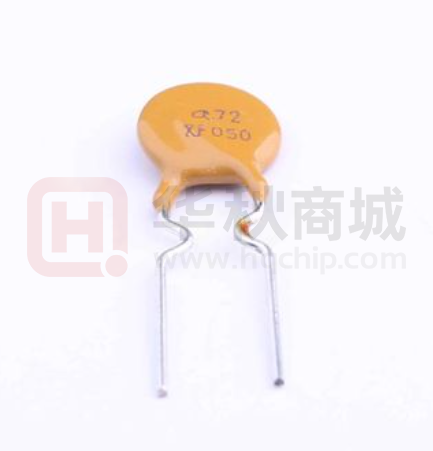

    JDTFUSE(集电通)
    FUSE_D7.9X3.1MM_TM
    PTC自恢复保险丝 72V 40A Ih=500mA It=1A FUSE_D7.9X3.1MM_TM
A72-050 数据手册
PRODUCT DATASHEET A72 Series PTC Devices A72 Series PTC Devices Description The JDTFUSE A72 Series is designed to provide overcurrent protection to 72Vdc maximum voltage with a maximum 40A short circuit rating. Features ● 72Vdc max voltage w/max 40A short circuit rating ● RoHS compliant, Lead-Free and HalogenFree* ● Resettable feature ● Ideal for a broad range of general electronics using a low voltage power supply Agency Approvals Agency Applications File Number E472196 pending Regulation ● Load protection on wide range of low voltage power supplies ● Computers ● Computers peripherals ● General electronics Standard 2002/95/EC EN14582 JDT FUSE Industrial Corp. www.jdtfuse.com Page 1/6 A72 Series PTC Devices Performance Specification Model V max (V dc) I max (A) I hold I trip Maximum Time To Trip Pd @25°C (A) @25°C (A) Typ. (W) Resistance Current (A) Time (Sec) R i min R1max (Ω) (Ω) A72-020 72 40 0.20 0.40 0.41 1.00 2.2 1.25 4.40 A72-025 72 40 0.25 0.50 0.45 1.25 2.5 0.65 3.00 A72-030 72 40 0.30 0.72 0.49 1.50 3.0 0.45 2.10 A72-040 72 40 0.40 0.80 0.56 2.00 3.8 0.40 1.29 A72-050 72 40 0.50 1.00 0.77 2.50 4.0 0.35 1.17 A72-065 72 40 0.65 1.30 0.88 3.25 5.3 0.25 0.72 A72-075 72 40 0.75 1.50 0.92 3.75 6.3 0.25 0.62 A72-090 72 40 0.90 1.80 0.99 4.50 7.2 0.20 0.49 A72-110 72 40 1.10 2.20 1.50 5.50 8.2 0.15 0.40 A72-135 72 40 1.35 2.70 1.70 6.75 9.6 0.12 0.32 A72-160 72 40 1.60 3.20 1.90 8.00 11.4 0.09 0.24 A72-185 72 40 1.85 3.70 2.10 9.25 12.6 0.08 0.21 A72-250 72 40 2.50 5.00 2.50 12.50 15.6 0.04 0.13 A72-300 72 40 3.00 6.00 2.80 15.00 19.8 0.03 0.10 A72-375 72 40 3.75 7.50 3.20 18.75 24.0 0.02 0.08 A72-500 72 40 5.00 10.0 3.20 18.75 24.0 0.02 0.08 I hold = Hold Current. Maximum current device will not trip in 25°C still air. I trip = Trip Current. Minimum current at which the device will always trip in 25°C still air. V max = Maximum operating voltage device can withstand without damage at rated current (Imax). I max = Maximum fault current device can withstand without damage at rated voltage (V max). Pd = Power dissipation when device is in the tripped state in 25°C still air environment at rated voltage. Ri min/max = Minimum/Maximum device resistance prior to tripping at 25°C. R1max = Maximum device resistance is measured one hour post reflow. CAUTION : Operation beyond the specified ratings may result in damage and possible arcing and flame. Environmental Specifications Conditions Test Passive aging Humidity aging Thermal shock       Resistance to solvent   Vibration   Resistance change   +85°C, 1000 hrs. ±5% typical   +85°C, 85% R.H. , 168 hours ±5% typical   +85°C to -40°C, 20 times ±33% typical   MIL-STD-202,Method 215 No change MIL-STD-202,Method 201 No change   Ambient operating conditions : - 40 °C to +85 °C Maximum surface temperature of the device in the tripped state is 125 °C JDT FUSE Industrial Corp. www.jdtfuse.com Page 2/6 A72 Series PTC Devices Thermal Derating Curve Derating Curves for A72 Series 180 Percentage of Rated Current 160 140 120 100 80 60 40 20 -40 -30 -20 -10 0 10 20 30 40 50 60 70 80 Temperature (°C ) Average Time-Current Curve 0.200A 1000 0.250A 0.300A TIME IN SECOND 100 0.400A 0.500A 0.650A 10 0.750A 0.900A 1.10A 1 1.35A 1.60A 1.85A 0.1 2.50A 3.00A 0.01 0.1 1 10 100 3.75A 5.00A CURRENT IN AMPERES JDT FUSE Industrial Corp. www.jdtfuse.com Page 3/6 A72 Series PTC Devices Ihold Versus Temperature Maximum ambient operating temperature (Tmao) vs. hold current (Ihold) Model - 40°C - 20°C 0°C 25°C 40°C 50°C 60°C 70°C 85°C A72-020 0.31 0.27 0.24 0.20 0.16 0.14 0.13 0.11 0.08 A72-025 0.39 0.34 0.30 0.25 0.20 0.18 0.16 0.14 0.10 A72-030 0.47 0.41 0.36 0.30 0.24 0.22 0.19 0.16 0.12 A72-040 0.62 0.54 0.48 0.40 0.32 0.29 0.25 0.22 0.16 A72-050 0.78 0.68 0.60 0.50 0.41 0.36 0.32 0.27 0.20 A72-065 1.01 0.88 0.77 0.65 0.53 0.47 0.41 0.35 0.26 A72-075 1.16 1.02 0.89 0.75 0.61 0.54 0.47 0.41 0.30 A72-090 1.40 1.22 1.07 0.90 0.73 0.65 0.57 0.49 0.36 A72-110 1.71 1.50 1.31 1.10 0.89 0.79 0.69 0.59 0.44 A72-135 2.09 1.84 1.61 1.35 1.09 0.97 0.85 0.73 0.54 A72-160 2.48 2.18 1.90 1.60 1.30 1.15 1.01 0.86 0.64 A72-185 2.87 2.52 2.20 1.85 1.50 1.33 1.17 1.00 0.74 A72-250 3.88 3.40 2.98 2.50 2.03 1.80 1.58 1.35 1.00 A72-300 4.65 4.08 3.57 3.00 2.43 2.16 1.89 1.62 1.20 A72-375 5.81 5.10 4.46 3.75 3.04 2.70 2.36 2.03 1.50 A72-500 6.59 5.78 5.15 4.50 3.64 3.00 2.65 2.42 1.60 Soldering Parameters Temperature (°C ) TP 260 Pre-Heating 1 Minute Min. Soldering 5Sea.MAX Gradual Cooling 100 Profile Feature Average Ramp-Up Rate Pb-Free Assembly 3℃/second mac. (Ts max to T p) Preheat 25 Time Recommended reflow methods: IR, vapor phase oven, hot air oven, N2 environment for lead-free Recommended maximum paste thickness is 0.25mm Devices can be cleaned using standard industry methods and solvents. Note 1:All temperature refer to topside of the package, measured on the package body surface. Note 2: If reflow temperatures exceed the recommended profile, devices may not meet the performance requirements. JDT FUSE Industrial Corp. www.jdtfuse.com -Temperature Min(Ts min) 150℃ -Temperature Max(Ts max) 200℃ -Time(Ts min to Ts max) 60~180 seconds Time maintained above: -Temperature(TL) 217℃ -Time(tL) 60~150 seconds Peak Temperature(Tp) 260℃ Ramp-Down Rate 6℃/second max. Time 25℃ to Peak Temperature 8 minutes max Storage Condition 0℃~35℃,≤70%RH Page 4/6 A72 Series PTC Devices Physical Dimensions(mm.) A A A E E B B D B XF135 F = Trademark = Radial type 72 Vrms = 1.35A hold current D D C a72 C C A B C D E F Max. Max. Typ. Min. Max. Max. Lead Style A72-020 7.4/0.29 12.7/0.48 5.1/0.20 7.6/0.3 3.1/0.12 1.0/0.04 Kink A72-025 7.4/0.29 12.7/0.50 5.1/0.20 7.6/0.3 3.1/0.12 1.0/0.04 Kink A72-030 7.4/0.29 13.0/0.51 5.1/0.20 7.6/0.3 3.1/0.12 1.0/0.04 Kink A72-040 7.6/0.30 13.5/0.53 5.1/0.20 7.6/0.3 3.1/0.12 1.2/0.05 Kink A72-050 6.45/0.31 10.8/0.54 5.1/0.20 8.4/0.3 2.4/0.12 1.2/0.05 Kink A72-065 9.7/0.38 14.5/0.57 5.1/0.20 7.6/0.3 3.1/0.12 1.5/0.06 Kink A72-075 10.4/0.41 15.2/0.60 5.1/0.20 7.6/0.3 3.1/0.12 1.5/0.06 Kink A72-090 11.7/0.46 15.8/0.62 5.1/0.20 7.6/0.3 3.1/0.12 1.5/0.06 Kink A72-110 13.0/0.51 18.0/0.71 5.1/0.20 7.6/0.3 3.1/0.12 1.2/0.05 Straight A72-135 14.5/0.57 19.6/0.77 5.1/0.20 7.6/0.3 3.1/0.12 1.2/0.05 Straight A72-160 16.3/0.64 21.3/0.84 5.1/0.20 7.6/0.3 3.1/0.12 1.5/0.06 Straight A72-185 17.8/0.70 22.9/0.90 5.1/0.20 7.6/0.3 3.1/0.12 1.5/0.06 Straight A72-250 21.3/0.84 26.4/1.04 10.2/0.40 7.6/0.3 3.1/0.12 1.7/0.07 Straight A72-300 24.9/0.98 30.0/1.18 10.2/0.40 7.6/0.3 3.1/0.12 2.0/0.08 Straight A72-375 28.5/1.12 33.5/1.32 10.2/0.40 7.6/0.3 3.1/0.12 2.0/0.08 Straight A72-500 28.5/1.12 33.5/1.32 10.2/0.40 7.6/0.3 3.1/0.12 2.0/0.08 Straight Model PHYSICAL SPECIFICATIONS : Materials : Leads A72-017 ~ 040: Tin-plJted copper-clJd steel, 0.205mm2 (24JWG), Φ0.51mm(0.020 in). A72-050 ~ 090: Tin-plJted copper , 0.205mm2 (24JWG), Φ0.51mm(0.020 in). A72-110 ~ 500: Tin-plJted copper , 0.52mm2 (20JWG), Φ0.81mm(0.032 in). Lead Solderability : MIL-STD-202, Method 208E JDT FUSE Industrial Corp. www.jdtfuse.com Page 5/6 A72 Series PTC Devices Packaging Quantity Order information Packing A72 185 K or S R or U Model Reel QTY Bag QTY Radial type Hold K= Kink leads R= Tape & A72-020 ~ A72-090 3000 500 Current   Reel (A) S=Straight U= Bulk A72-110 ~ A72-185 1500 500 leads packaged A72-250 ~ A72-500 - 500 72 V Tape & Reel packaging per EIA468-B standard. Cross Reference Cross Reference Model Tyco / PolySwitch® Bourns / POLY-FUSE® Polytronics / EVERFUSE® A72-020 RXEF020 MF-R020 RLD72P020XF A72-025 RXEF025 MF-R025 RLD72P025XF A72-030 RXEF030 MF-R030 RLD72P030XF A72-040 RXEF040 MF-R040 RLD72P040XF A72-050 RXEF050 MF-R050 RLD72P050XF A72-065 RXEF065 MF-R065 RLD72P065XF A72-075 RXEF075 MF-R075 RLD72P075XF A72-090 RXEF090 MF-R090 RLD72P090XF A72-110 RXEF110 MF-RX110 RLD72P110XF A72-135 RXEF135 MF-RX135 RLD72P135XF A72-160 RXEF160 MF-RX160 RLD72P160XF A72-185 RXEF185 MF-RX185 RLD72P185XF A72-250 RXEF250 MF-RX250 RLD72P250XF A72-300 RXEF300 MF-RX300 RLD72P300XF A72-375 RXEF375 MF-RX375 RLD72P375XF A72-500 RXEF500 MF-RX500 RLD72P500XF “PolySwitch” is a registered trademark of Tyco Electronics. “POLY-FUSE” is a registered trademark of Littelfuse,Inc. “EVERFUSE” is a registered trademark of Polytronics Technology Corp. JDT FUSE Industrial Corp. www.jdtfuse.com Page 6/6
