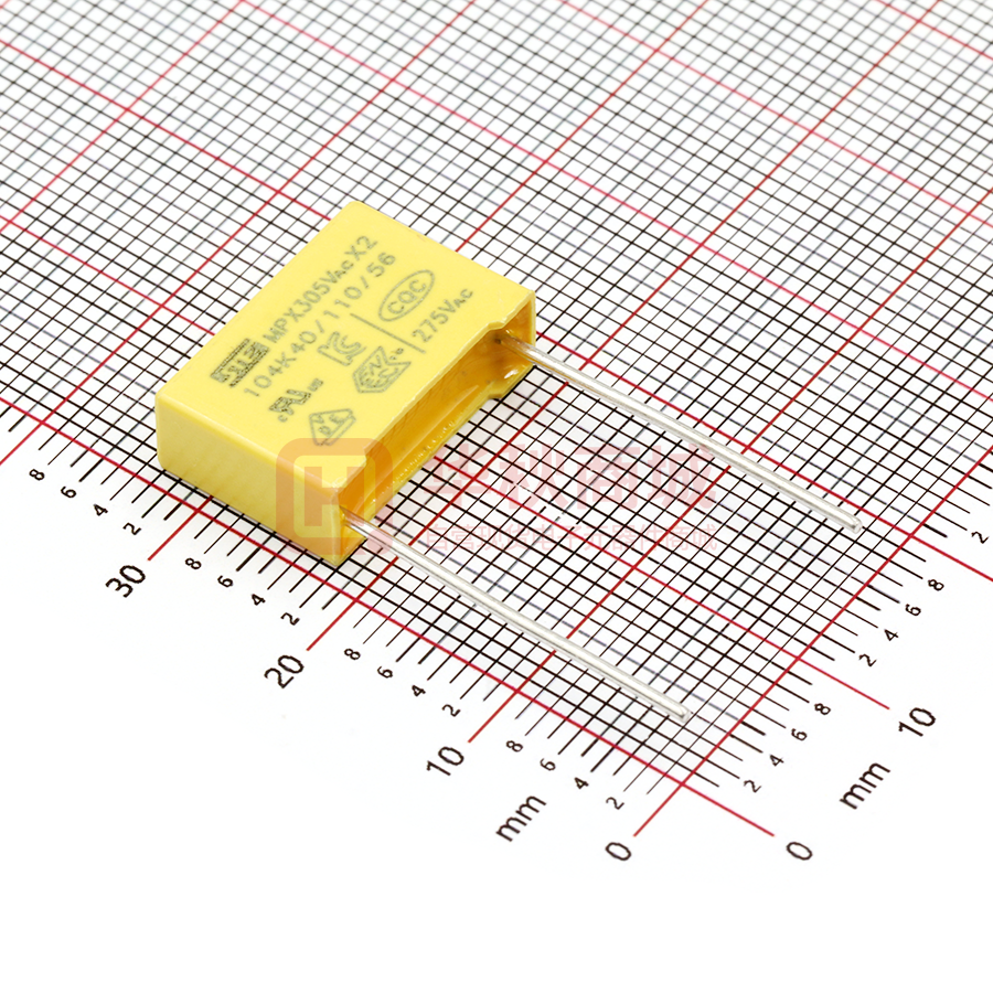

    安规电容 CAP_18X6MM_TM 100nF ±10% 305V
X2Q2104KQ1B0180120060ES0 数据手册
MPX/X2 Metallized Polypropylene Film Interference Suppresion Capacitors (Class X2) MPX/X2 Metallized Polypropylene Film Interference Suppresion Capacitors (Class X2) Data Sheet Feature ■Wide capacitance range from 0.001uF to 2.2uF. ■Operating Temperature: -40℃~110℃. ■Storage Temperature: 15℃~35℃. ■Withstanding over-voltage stressing. ■Excellent active and passive flame resistant abilities (UL94V-0). Applications ■Widely used in across-the-line,interference suprression circuit.ect. Applicable Standard Approval Organization Safety Standards Certificate No. USA Canada UL/CUL UL60384 E208107 Germany VDE EN60384-14 40034679 EU ENEC EN60384-14 40034679 SU03031-12001 Korea KTL K60384 SU03031-12002 SU03031-12003 SU03031-12004 China CQC GB/T 6346.14-2015 CQC08001024360 IEC IEC-CB IEC60384-14 CN11932 Email: info@songtian.cn Website: http://www.songtian-ste.com Revision: 2018-04-29 1 MPX/X2 Metallized Polypropylene Film Interference Suppresion Capacitors (Class X2) Part Number Code X2 P2 Songtian X2 104 K Capacitance 103:10nF 104:100nF 105:1.0μF 225:2.2μF Voltage P2:275VAC Q2:305VAC Q3:310VAC Q 1 B0 Pitch N:10.0mm Q:15.0mm T:22.5mm V:27.5mm 180 060 Width 060:6.0mm 180:18.0mm E Thickness 060:6.0mm 120:12.0mm S 0 Inner Management Client Catagoryt S:Yellow E:Grey Height 060:6.0mm 120:12.0mm Foot Type 1:Long Straight 2:Inside Kink Lead 5:Straight Lead Taping 6:Inner Crimped Tapping Tolerence K:±10% 120 Environmental Standard E:RoHS F:RoHS+Halogen-Free Lead Length 30~39:3.0~3.9mm 40~49:4.0~4.9mm 50~59:5.0~5.9mm 60~69:6.0~6.9mm 70~79:7.0~7.9mm 80~89:8.0~8.9mm 90~99:9.0~9.9mm Lead Length A0~A9:11.0~19.0mm B0~B9:20.0~29.0mm C0~C9:30.0~39.0mm Specifications Climatic Category Rated Voltage Dissipation Factor(tanδ) 40/110/56 275VAC、305VAC、310VAC ≤0.1% Between terminals to case: Withstand Voltage 2UR+1500VAC Minimum of 2000VAC Between terminals:4.3UR(DC)/5S CR≤0.33μF,IR≥15000MΩ Insulation Resistance (I.R.) CR>0.33μF,IR≥6000S Note:T[s]=I.R.[MΩ]*CN [μF] Revision: 2018-04-29 2 20℃、100V、60S Email: info@songtian.cn Website: http://www.songtian-ste.com MPX/X2 Metallized Polypropylene Film Interference Suppresion Capacitors (Class X2) Dimensions (mm) and Approval Capacitance (uF) 0.001 0.0022 0.0033 0.0039 0.0047 0.01 0.022 0.033 Revision: 2018-04-29 Size (mm) Rated Voltage W±0.5 H±0.5 T±0.5 P±1.0 d±0.05 275VAC 13 . 0 11 . 0 5. 0 10 . 0 0.6 305VAC 13 . 0 11 . 0 5. 0 10 . 0 0.6 310VAC 13 . 0 11 . 0 5. 0 10 . 0 0.6 275VAC 13.0 11.0 5.0 10.0 0.6 305VAC 13.0 11.0 5.0 10.0 0.6 310VAC 13.0 11.0 5.0 10.0 0.6 275VAC 13.0 11.0 5.0 10.0 0.6 305VAC 13.0 11.0 5.0 10.0 0.6 310VAC 13.0 11.0 5.0 10.0 0.6 275VAC 13.0 11.0 5.0 10.0 0.6 305VAC 13.0 11.0 5.0 10.0 0.6 310VAC 13.0 11.0 5.0 10.0 0.6 275VAC 13.0 11.0 5.0 10.0 0.6 305VAC 13.0 11.0 5.0 10.0 0.6 310VAC 13.0 11.0 5.0 10.0 0.6 275VAC 13.0 11.0 5.0 10.0 0.6 305VAC 13.0 11.0 5.0 10.0 0.6 310VAC 13.0 11.0 5.0 10.0 0.6 275VAC 13.0 11.0 5.0 10.0 0.6 305VAC 13.0 11.0 5.0 10.0 0.6 310VAC 13.0 11.0 5.0 10.0 0.6 275VAC 13.0 11.0 5.0 10.0 0.6 305VAC 13.0 11.0 5.0 10.0 0.6 310VAC 13.0 11.0 5.0 10.0 0.6 3 Email: info@songtian.cn Website: http://www.songtian-ste.com MPX/X2 Metallized Polypropylene Film Interference Suppresion Capacitors (Class X2) Capacitance (uF) Size (mm) Rated Voltage W±0.5 H±0.5 T±0.5 P±1.0 d±0.05 275VAC 13 . 0 11 . 0 5. 0 10 . 0 0.6 305VAC 13 . 0 11 . 0 5. 0 10 . 0 0.6 310VAC 13 . 0 11 . 0 5. 0 10 . 0 0.6 275VAC 13 . 0 12 . 0 6. 0 10 . 0 0.6 305VAC 13 . 0 12 . 0 6. 0 10 . 0 0.6 310VAC 13 . 0 12 . 0 6. 0 10 . 0 0.6 275VAC 13 . 0 12 . 0 6. 0 10 . 0 0.6 305VAC 13 . 0 12 . 0 6. 0 10 . 0 0.6 310VAC 13 . 0 12 . 0 6. 0 10 . 0 0.6 275VAC 13 . 0 12 . 0 6. 0 10 . 0 0.6 305VAC 13 . 0 12 . 0 6. 0 10 . 0 0.6 310VAC 13 . 0 12 . 0 6. 0 10 . 0 0.6 0.15 275VAC 13 . 0 12 . 0 6. 0 10 . 0 0.6 0.22 275VAC 13.0 15.0 8.0 10 . 0 0.6 275VAC 18.0 11.0 5.0 15 . 0 0.8 305VAC 18.0 11.0 5.0 15 . 0 0.8 310VAC 18.0 11.0 5.0 15 . 0 0.8 275VAC 18.0 11.0 5.0 15 . 0 0.8 305VAC 18.0 11.0 5.0 15 . 0 0.8 310VAC 18.0 11.0 5.0 15 . 0 0.8 275VAC 18.0 11.0 5.0 15 . 0 0.8 305VAC 18.0 11.0 5.0 15 . 0 0.8 310VAC 18.0 11.0 5.0 15 . 0 0.8 275VAC 18.0 12.0 6.0 15 . 0 0.8 305VAC 18.0 12.0 6.0 15 . 0 0.8 310VAC 18.0 12.0 6.0 15 . 0 0.8 275VAC 18.0 12.0 6.0 15 . 0 0.8 305VAC 18.0 12.0 6.0 15 . 0 0.8 310VAC 18.0 12.0 6.0 15 . 0 0.8 275VAC 18.0 12.0 6.0 15 . 0 0.8 305VAC 18.0 12.0 6.0 15 . 0 0.8 310VAC 18.0 12.0 6.0 15 . 0 0.8 275VAC 18.0 14.5 8.5 15 . 0 0.8 305VAC 18.0 14.5 8.5 15 . 0 0.8 310VAC 18.0 14.5 8.5 15 . 0 0.8 0.047 0.068 0.082 0.1 0.033 0.047 0.068 0.082 0.1 0.15 0.22 Revision: 2018-04-29 4 Email: info@songtian.cn Website: http://www.songtian-ste.com MPX/X2 Metallized Polypropylene Film Interference Suppresion Capacitors (Class X2) Capacitance (uF) 0.33 0.47 0.56 0.68 0.22 0.27 0.33 0.47 0.56 0.68 0.82 1.0 Revision: 2018-04-29 Size (mm) Rated Voltage W±0.5 H±0.5 T±0.5 P±1.0 d±0.05 275VAC 18.0 14.5 8.5 15 . 0 0.8 305VAC 18.0 16.0 10.0 15 . 0 0.8 310VAC 18.0 16.0 10.0 15 . 0 0.8 275VAC 18.0 16.0 10.0 15 . 0 0.8 305VAC 18.0 16.0 10.0 15 . 0 0.8 310VAC 18.0 16.0 10.0 15 . 0 0.8 275VAC 18.0 16.0 10.0 15 . 0 0.8 305VAC 18.0 16.0 10.0 15 . 0 0.8 310VAC 18.0 16.0 10.0 15 . 0 0.8 275VAC 18.0 19.0 11.0 15 . 0 0.8 305VAC 18.0 19.0 11.0 15 . 0 0.8 310VAC 18.0 19.0 11.0 15 . 0 0.8 275VAC 26.5 16.5 7.0 22 . 5 0.8 305VAC 26.5 16.5 7.0 22 . 5 0.8 310VAC 26.5 16.5 7.0 22 . 5 0.8 275VAC 26.5 16.5 7.0 22 . 5 0.8 305VAC 26.5 16.5 7.0 22 . 5 0.8 310VAC 26.5 16.5 7.0 22 . 5 0.8 275VAC 26.5 17.0 8.5 22 . 5 0.8 305VAC 26.5 17.0 8.5 22 . 5 0.8 310VAC 26.5 17.0 8.5 22 . 5 0.8 275VAC 26.5 19.0 10.0 22 . 5 0.8 305VAC 26.5 19.0 10.0 22 . 5 0.8 310VAC 26.5 19.0 10.0 22 . 5 0.8 275VAC 26.5 19.0 10.0 22 . 5 0.8 305VAC 26.5 19.0 10.0 22 . 5 0.8 310VAC 26.5 19.0 10.0 22 . 5 0.8 275VAC 26.5 17.0 8.5 22 . 5 0.8 305VAC 26.5 17.0 8.5 22 . 5 0.8 310VAC 26.5 17.0 8.5 22 . 5 0.8 275VAC 26.5 19.0 10.0 22 . 5 0.8 305VAC 26.5 19.0 10.0 22 . 5 0.8 310VAC 26.5 19.0 10.0 22 . 5 0.8 275VAC 26.5 17.0 8.5 22 . 5 0.8 305VAC 26.5 20.0 11.0 22 . 5 0.8 310VAC 26.5 20.0 11.0 22 . 5 0.8 5 Email: info@songtian.cn Website: http://www.songtian-ste.com MPX/X2 Metallized Polypropylene Film Interference Suppresion Capacitors (Class X2) Capacitance (uF) 1.2 1.5 0.68 0.82 1.0 1.2 1.5 2.0 2.2 Revision: 2018-04-29 Size (mm) Rated Voltage W±0.5 H±0.5 T±0.5 P±1.0 d±0.05 275VAC 26.5 19.0 10.0 22 . 5 0.8 305VAC 26.5 22.0 12.5 22 . 5 0.8 310VAC 26.5 22.0 12.5 22 . 5 0.8 275VAC 26.5 20.0 11.0 22 . 5 0.8 305VAC 26.5 22.0 12.5 22 . 5 0.8 310VAC 26.5 22.0 12.5 22 . 5 0.8 275VAC 32.0 20.0 11.0 27 . 5 0.8 305VAC 32.0 20.0 11.0 27 . 5 0.8 310VAC 32.0 20.0 11.0 27 . 5 0.8 275VAC 32.0 20.0 11.0 27 . 5 0.8 305VAC 32.0 20.0 11.0 27 . 5 0.8 310VAC 32.0 20.0 11.0 27 . 5 0.8 275VAC 32.0 20.0 11.0 27 . 5 0.8 305VAC 32.0 20.0 11.0 27 . 5 0.8 310VAC 32.0 20.0 11.0 27 . 5 0.8 275VAC 32.0 20.0 11.0 27 . 5 0.8 305VAC 32.0 20.0 11.0 27 . 5 0.8 310VAC 32.0 20.0 11.0 27 . 5 0.8 275VAC 32.0 22.0 13.0 27 . 5 0.8 305VAC 32.0 22.0 13.0 27 . 5 0.8 310VAC 32.0 22.0 13.0 27 . 5 0.8 275VAC 32.0 22.0 13.0 27 . 5 0.8 305VAC 32.0 25.0 14.0 27 . 5 0.8 310VAC 32.0 25.0 14.0 27 . 5 0.8 275VAC 32.0 22.0 13.0 27 . 5 0.8 305VAC 32.0 25.0 14.0 27 . 5 0.8 310VAC 32.0 25.0 14.0 27 . 5 0.8 6 Email: info@songtian.cn Website: http://www.songtian-ste.com MPX/X2 Metallized Polypropylene Film Interference Suppresion Capacitors (Class X2) Lead Configuration Lead Length L (mm) Coating Lead Length H1(mm) Long Straight ①[2.5≤L<6.0]+/-0.5; ②[6.0≤L≤10]+/-1.0 / Inner Crimped ①[2.5≤L<6.0]+/-0.5; ②[6.0≤L≤10]+/-1.0 Pitch P>10mm:H1<6.0mm Pitch P≤10mm:H1<5.0mm Lead Style Revision: 2018-04-29 Drawing 7 Email: info@songtian.cn Website: http://www.songtian-ste.com MPX/X2 Metallized Polypropylene Film Interference Suppresion Capacitors (Class X2) Taping And Dimensions (mm) Fig.1 Fig.2 Fig.2 Fig.3 Fig.3 P=5.0 P=7.5 P=10 P=15 P=20/22.5 P3 12.7 12.7 12.7 25.4 30.0 ±1.0 P2 6.35 / / / / ±1.3 P0 12.7 12.7 12.7 12.7 15.0 ±0.3 P1 3.85 / / / / ±0.7 F 5.0 7.5 10.0 15.0 20.0/22.5 ±1.0 H 20.0 20.0 20.0 20.0 20.0 ±1.0 H0 16.5 16.5 16.5 16.5 16.5 ±0.5 Δh 0 0 0 0 0 ±2.0 W 18.0 18.0 18.0 18.0 18.0 +1.0/-0.5 W0 12.0 12.0 12.0 12.0 12.0 ±1.0 W1 9.0 9.0 9.0 9.0 9.0 ±0.5 W2 3.0 3.0 3.0 3.0 3.0 Max D0 4.0 4.0 4.0 4.0 4.0 ±0.3 d 0.5 0.6 0.6 0.8 0.8 ±0.05 t 1.0 1.1 1.1 1.4 1.4 ±0.2 t0 0.38 0.38 0.38 0.47 0.47 ±0.04 Symbol Revision: 2018-04-29 8 Email: info@songtian.cn Tolerance Website: http://www.songtian-ste.com
