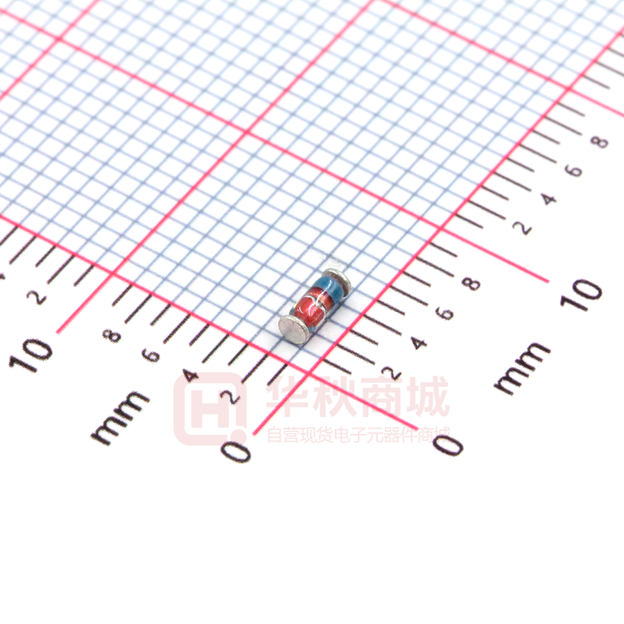

    密封玻璃齐纳电压整流器 100nA@1V 25Ω Single 5.2V~6V 500mW SOD-80
BZV55C5V6 数据手册
BZV55C SERIES 500mW.Hermetically Sealed Glass Zener Voltage Rectifiers MINI-MELF Features — — — — — — — — — Zener voltage range 2.0 to 75 volts LL-34(Mini-MELF) package Surface device type mounting Hermetically sealed glass Compression Bonded Construction All external surfaces are corrosion resistant and terminals are readily solderable RoHS compliant Matte Tin(Sn) lead finish Blue color band indicates negative polarity Dimension in millimeters Maximum Ratings and Electrical Characteristics Rating at 25 oC ambient temperature unless otherwise specified. Type Number Power Dissipation Operating and Storage Temperature Range Notes: Value Units 500 -65 to + 200 mW o C These ratings are limiting values above which the serviceability of the diode may be impaired ht t p : // Revision:20170701-P1 Symbol Ptot TJ, TSTG www.lgesemi .c o m mail:lge@lgesemi.com BZV55C SERIES 500mW.Hermetically Sealed Glass Zener Voltage Rectifiers TKVZ - Temperature Coefficient of VZ (10-4/K) Ptot - Total Power Dissipation (mW) RATINGS AND CHARACTERISTIC CURVES (BZV55C SERIES) 600 500 400 300 200 100 0 0 40 80 120 160 200 Tamb - Ambient Temperature (°C) Figure 1. Total Power Dissipation vs. Ambient Temperature 15 10 5 IZ = 5 mA 0 -5 0 CD - Diode Capacitance (pF) Tj = 25 °C 100 IZ = 5 mA 10 150 VR = 2 V Tj = 25 °C 100 50 0 0 5 10 15 0 25 20 5 Figure 2. Typical Change of Working Voltage under Operating Conditions at Tamb=25°C 15 20 25 Figure 5. Diode Capacitance vs. Z-Voltage 100 1.3 1.2 IF - Forward Current (mA) VZtn = VZt/VZ (25 °C) TKVZ = 10 x 10-4/K -4 8 x 10 /K 6 x 10-4/K 1.1 4 x 10-4/K 2 x 10-4/K 1.0 0 - 2 x 10-4/K - 4 x 10-4/K 0.9 0.8 - 60 10 VZ - Z-Voltage (V) VZ - Z-Voltage (V) VZtn - Relative Voltage Change 50 200 1 10 Tj = 25 °C 1 0.1 0.01 0.001 0 60 120 180 0 240 ht t p : // 0.2 0.4 0.6 0.8 1.0 VF - Forward Voltage (V) Tj - Junction Temperature (°C) Figure 3. Typical Change of Working Voltage vs. Junction Temperature Revision:20170701-P1 20 40 30 VZ - Z-Voltage (V) Figure 4. Temperature Coefficient of Vz vs. Z-Voltage 1000 VZ - Voltage Change (mV) 10 Figure 6. Forward Current vs. Forward Voltage www.lgesemi .c o m mail:lge@lgesemi.com BZV55C SERIES 500mW.Hermetically Sealed Glass Zener Voltage Rectifiers RATINGS AND CHARACTERISTIC CURVES (BZV55C SERIES) rZ - Differential Z-Resistance (Ω) 100 IZ - Z-Current (mA) 80 Ptot = 500 mW Tamb = 25 °C 60 40 20 0 0 4 6 12 8 1000 IZ = 1 mA 100 5 mA 10 10 mA Tj = 25 °C 1 0 20 5 VZ - Z-Voltage (V) 10 15 20 25 VZ - Z-Voltage (V) Figure 7. Z-Current vs. Z-Voltage Figure 9. Differential Z-Resistance vs. Z-Voltage IZ - Z-Current (mA) 50 Ptot = 500 mW Tamb = 25 °C 40 30 20 10 0 15 20 25 35 30 VZ - Z-Voltage (V) Zthp - Thermal Resistance for Pulse Cond. (KW) Figure 8. Z-Current vs. Z-Voltage 1000 tP/T = 0.5 100 tP/T = 0.2 Single Pulse 10 RthJA = 300 K/W T = Tjmax - Tamb tP/T = 0.01 tP/T = 0.1 tP/T = 0.02 tP/T = 0.05 1 10-1 iZM = (- VZ + (VZ2 + 4rzj x T/Zthp) 1/2)/(2rzj) 100 101 102 tP - Pulse Length (ms) Figure 10. Thermal Response ht t p : // Revision:20170701-P1 www.lgesemi .c o m mail:lge@lgesemi.com BZV55C SERIES 500mW.Hermetically Sealed Glass Zener Voltage Rectifiers ELECTRICAL CHARACTERISTICS (TA=25OC VZ @ IZT (Volts) unless otherwise noted) VZ Min (V) VZ Max (V) IZT mA ZZT @ IZT Ohms Max IZK mA ZZK @ IZK Ohms IR @ VR uA Max VR V BZV55C2V0 1.88 2.11 5 100 1.0 600 50 1.0 BZV55C2V2 2.08 2.33 5 100 1.0 600 50 1.0 BZV55C2V4 2.28 2.56 5 85 1.0 600 50 1.0 BZV55C2V7 2.51 2.89 5 85 1.0 600 10 1.0 BZV55C3V0 2.8 3.2 5 85 1.0 600 4 1.0 BZV55C3V3 3.1 3.5 5 85 1.0 600 2 1.0 BZV55C3V6 3.4 3.8 5 85 1.0 600 2 1.0 BZV55C3V9 3.7 4.1 5 85 1.0 600 2 1.0 BZV55C4V3 4.0 4.6 5 75 1.0 600 1 1.0 BZV55C4V7 4.4 5.0 5 60 1.0 600 0.5 1.0 BZV55C5V1 4.8 5.4 5 35 1.0 550 0.1 1.0 BZV55C5V6 5.2 6.0 5 25 1.0 450 0.1 1.0 BZV55C6V2 5.8 6.6 5 10 1.0 200 0.1 2.0 BZV55C6V8 6.4 7.2 5 8 1.0 150 0.1 3.0 BZV55C7V5 7.0 7.9 5 7 1.0 50 0.1 5.0 BZV55C8V2 7.7 8.7 5 7 1.0 50 0.1 6.2 BZV55C9V1 8.5 9.6 5 10 1.0 50 0.1 6.8 BZV55C10 9.4 10.6 5 15 1.0 70 0.1 7.5 BZV55C11 10.4 11.6 5 20 1.0 70 0.1 8.2 BZV55C12 11.4 12.7 5 20 1.0 90 0.1 9.1 BZV55C13 12.4 14.1 5 26 1.0 110 0.1 10 BZV55C15 13.8 15.6 5 30 1.0 110 0.1 11 BZV55C16 15.3 17.1 5 40 1.0 170 0.1 12 BZV55C18 16.8 19.1 5 50 1.0 170 0.1 13 BZV55C20 18.8 21.1 5 55 1.0 220 0.1 15 BZV55C22 20.8 23.3 5 55 1.0 220 0.1 16 BZV55C24 22.8 25.6 5 80 1.0 220 0.1 18 BZV55C27 25.1 28.9 2 80 1.0 220 0.1 20 BZV55C30 28 32 2 80 1.0 220 0.1 22 BZV55C33 31 35 2 80 1.0 220 0.1 24 BZV55C36 34 38 2 80 1.0 220 0.1 27 BZV55C39 37 41 2 90 0.5 500 0.1 28 BZV55C43 40 46 2 90 0.5 600 0.1 32 BZV55C47 44 50 2 110 0.5 700 0.1 35 BZV55C51 48 54 2 125 0.5 700 0.1 38 BZV55C56 52 60 2 135 0.5 1000 0.1 42 BZV55C62 58 66 2.5 150 0.5 1000 0.1 47 BZV55C68 64 72 2.5 160 0.5 1000 0.1 51 BZV55C75 70 80 2.5 170 0.5 1000 0.1 56 Type Number VF Forward Voltage = 1.0v Maximum @ IF=100mA for all types. Notes: 1. The type numbers listed have zener voltage min/max limits as shown. 2. The zener impedance is derived from the 60-cycle ac voltage, which results when an ac current having an rams value equal to 10% of the dc zener current (IZT or IZK) is superimposed to IZT or IZK. Version: B07 ht t p : // Revision:20170701-P1 www.lgesemi .c o m mail:lge@lgesemi.com
