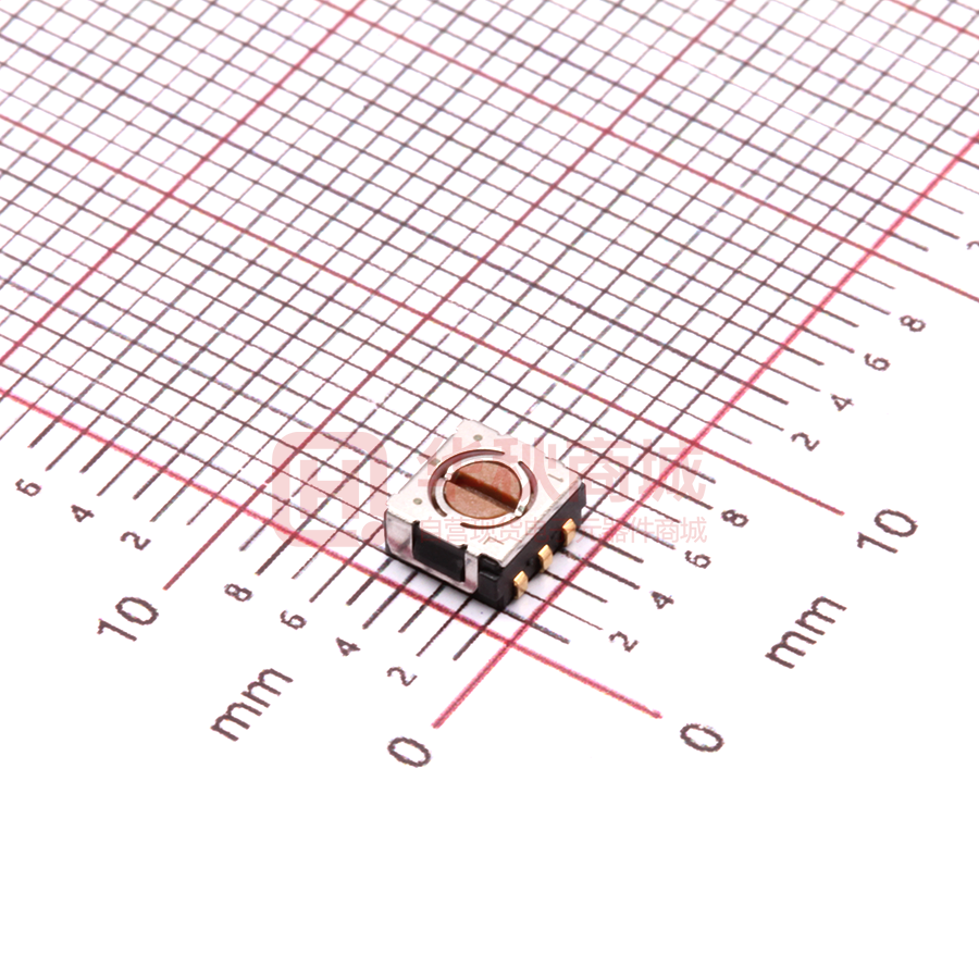

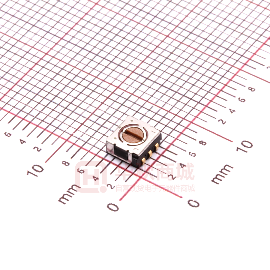

ROTARY SELECTOR SWITCHES (SMD) CS-4 INTERNAL STRUCTURE RoHS compliant ① ③ ② ④ ⑤ ⑥ ⑦ Part name ■ FEATURES ● RoHS compliant ● Optimum for high density board mounting applications ● Compatible with most automatic pick & place machinery (J-hook and Gull wing types only) ● Compatible with reflow and wave soldering ● Protection against dust and washable after soldering ● Excellent reliability due to precious metal contact ● Resin materials are UL Recognized 94V-0 or 94V-1 equivalent Material ① Rotor Polyphenylenesulphide ② Cover Stainless steel (SUS 304) ③ “O” ring ④ Fixed contact ⑤ Terminal pin ⑥ Housing ⑦ Slider contact Silicone rubber Copper alloy, Gold-plated Epoxy ※ LCP(LC polymer) Multi metal alloy ※:1 pole 4 contacts only ■ PART NUMBER DESIGNATION CS-4 - 1 3 N T A Series name Shape of terminal A:J-hook B:Gull wing C:Through hole pins No. of poles Form of packaging 1:1 pole 2:2 poles No. of contacts 2:2 contacts 3:3 contacts 4:4 contacts T:Taping (Reel) Blank:Bulk in plastic bag Contact timing N:Non-shorting (1 pole 3, 4 contacts only) Y:Non-shorting with neutral detent (1pole 2 contacts, 2 poles 2 contacts) X:Non-shorting without neutral detent (1 pole 2 contacts only) ※ Please refer to the LIST OF PART NUMBERS when placing orders. CS-4 ROTARY SELECTOR SWITCHES (SMD) CS-4 回路図 1p 2c CS-4 回路図 1p 2c CS-4 回路図 1p 2c CS-4 回路図 1p 2c CS-4■回路図 1p 2c DIAGRAMS SCHEMATICS CS-4 回路図 1p CS-4 回路図 1p 2c 2c ● 1 pole 2 contacts C CC C CS-4-12YA 11 11 1  〃 YTA 1 1 C C 22 2 2 OFF OFF OFF OFF OFF OFF OFF ON ON C C CC C CS-4-12XA C C 1 11 1 1  〃 XB  〃 XTB CC CC C C C 2 22 2 2 2 2 1 1  〃 XC C CC C C ON ON ON C ON C ON ON ON 1 11 1 1 1 1 ON ON 1 NC C 1 C C C ON 1 4 3 2 4 3 2 NC4 C3 12 CS-4-14NA  〃 NTA 3 2  〃 NB 12 CC ON ON C ON 2 ON CC 23 C  〃 NTB 2 22 1 1 2 2 C C 3 ON ON C ON 3 3 3 Schematic 11 CC 1 C ON ON 1 C ON ON CC C C C 2 C 2 C ON 2 C ON 2 ON ON C C C ON C ON 1 2 3 1 1 223 3 1 2 3 3 3 3 3 $4ճ࿏ਤQD $4ճ࿏ਤQD ON $4ճ࿏ਤQD ON ● 2 poles 2 contacts Series Switching specifications 1 11 2 22 2 2 2 2 C C CC 2 2 22 C CC C C CC C CS-4-22YA Schematic C C 33  〃 NTB 22 22  〃 YTB 1 1 2 12 3 23 4 34 1 Schematic 1 111 ON ON 1 11 1 ON CC 11 CC 11 C CC C OFF OFF OFF  〃 YB 1 1 ON C 4 ON 11  〃 NB  〃 YTA C NC CC Switching specifications 1 NC C 1 specifications Switching Series  〃 NTA C CC CC C C 1 11 11 1 1 2 C 22 CC C ON 2 C ON ON 22 C ON C ON 2 ● 1 pole 4 contacts CS-4-13NA 22 2 22 2 2 11 1 11 1 1 CC 22 C 2 C ON ON 22 C ON ON 22 C ON  〃 YC Series C C ON ON 2 2  〃 YTB Schematic CC ON 11 C ON 1 ON ON C ON 1 C 1  〃 YB  〃 XTA ● 1 pole 3 contacts C Switching specifications CC 11 Series CS-4 1p 3c 3c CS-4 回路図 1p CS-4 回路図 1p 3c CS-4 回路図 1p 3c 22 22 11 11 CC C 2222 CC C 22 2 ON ON ON 1 11 1 CC CC 22 22 42 3 4 ON C CC 4 34 ON C ON ON 4 ON ■ LIST OF PART NUMBERS C Circuit type 1 2 1 1 2 4 ON of packaging Form Taping Plastic bag pole contacts Taping Without neutral detent Plastic bag Taping pole 3 contacts Plastic bag Taping pole 4 contacts Plastic bag Taping poles 2 contacts Plastic bag With neutral detent : Not manufactured ※ Verify the above part numbers when placing orders. Taping version can be supplied only in reel unit. A J-hook CS-4-12YTA CS-4-12YA CS-4-12XTA CS-4-12XA CS-4-13NTA CS-4-13NA CS-4-14NTA CS-4-14NA CS-4-22YTA CS-4-22YA B Gull wing CS-4-12YTB CS-4-12YB CS-4-12XTB CS-4-12XB CS-4-13NTB CS-4-13NB CS-4-14NTB CS-4-14NB CS-4-22YTB CS-4-22YB C Through hole pin CS-4-12YC CS-4-12XC Pieces in package 500 pcs. /reel 50 pcs./pack 500 pcs./reel 50 pcs./pack 500 pcs./reel 50 pcs./pack 500 pcs./reel 50 pcs./pack 500 pcs./reel 50 pcs./pack CS-4 ROTARY SELECTOR SWITCHES (SMD) ■ STANDARD SPECIFICATIONS Circuit type 1 pole 2 contacts 2 poles 2 contacts 1 pole 3 contacts 1 pole 4 contacts ■ ELECTRICAL CHARACTERISTICS 0.5 VA Contact rating Maximum current 100 mA Operating temperature range − 25 ~ 70 °C Minimum current 1μA Storage temperature range − 40 ~ 70 °C Maximum voltage 16 V Minimum voltage 20 mV Sealing Washable by “O” ring ※ Please refer to page 150, 151 Net weight Approx. 0.08 g (CS-4-12, CS-4-13) Approx. 0.1 g (CS-4-14, CS-4-22) Non-shorting Contact timing 100 mΩ maximum Contact resistance 100 MΩ (DC500 V) minimum Insulation resistance ■ MECHANICAL CHARACTERISTICS No. of positions 2, 3, 4 Adjustment torque 10 mN·m {102 gf·cm} maximum Stopper strength 25 mN·m {255 gf·cm} minimum Stepping angle Solderability 45° 90° (CS-4-12X only) 245 ± 3 °C, 2 ~ 3 s AC500 V, 60 s Dielectric strength ■ ENVIRONMENTAL CHARACTERISTICS (Amplitude) 1.5 mm(or (Acceleration) 98 m/s2, 10-500-10 Hz, 3 directions for 2 h each 490 m/s2, 11 ms 6 directions for 3 times each 200 cycles minimum DC16 V, 30 mA Vibration Shock Load life Soldering heat Flow : 260 ± 3 °C as the temperature in a pot of molten solder, immer­sion from head of ter­minal to backside of board, 5 ~ 6 s, two times maximum Reflow : Peak temperature 255 °C (Please refer to the profile below.) Manual soldering:350 ± 10 °C, 3 ~ 4 s 40 °C, Relative humidity 90 ~ 95 %, 48 h Humidity (Steady state) High temperature exposure 70 °C, 16 h Low temperature exposure − 40 °C, 16 h Thermal shock − 40 (0.5 h) ~ 70 °C (0.5 h), 5 cycles 〈Reflow profile for soldering heat evaluation〉 5 N {0.51 kgf}, 10 s Substrate bending Width 90 mm, bend 3 mm, 5 s, 1 time Pull-off strength 5 N {0.51 kgf}, 10 s { } : Reference only (C) 250 Peak : 250 200 Pre Heating Zone +5 0 C Over 230 C Temperature Shear (Adhesion) 150 100 50 180 C 150 C 90 30 s 30 10 s Heating time Soldering Zone Reflow : two times maximum CS-4 ROTARY SELECTOR SWITCHES (SMD) 2YA CS-4-12YB ■ OUTLINE DIMENSIONS Unless otherwise specified, tolerance: ± 0.3 (Unit: mm) ● CS-4-12YA ● CS-4-12YB 0.6 × ¥ 2.3 L × 0.5 D 1.2 Production date code Production date code 3 CS-4-12XA 2 – 0.8 t = 0.15 2 5 2.3 6.2 1 2.35 2 5 ● CS-4-12YC 0.6 W × 2.3 L × 0.5 D 3 – 0.6 t = 0.15 1 2.54 41 0.35 min. 5.08 6.2 2.3 2 – 0.8 t = 0.15 1 2 2.3 5 2.35 ● CS-4-13NA 41 2.54 ● CS-4-13NB 0.6 × ¥ 2.3 L × 0.5 D 2.3 1.3 ● CS-4-14NA 1.2 6.2 2.3 4.5 3 0 – 0.5 4.5 5.2 3 – 0.5 t = 0.15 1.3 2 3 5 Production date code 0.35 min. C C 0.35 min. 0.6 W × 2.3 L × 0.5 D 1.2 Production date code 1 2 3 5 1.3 3 – 0.5 t = 0.15 1.3 ● CS-4-14NB 0.6 W × 2.3 L × 0.5 D 3 – 45° Step angle Production date code 4.5 3 5.2 4.5 0 – 0.5 Production date code 3 – 45° Step angle 4 3 2 135° Moving range 2.3 1.3 1.3 6 – 0.5 t = 0.15 6.2 NC C 1 0.35 min. 0.6 W × 2.3 L × 0.5 D 6 – 0.5 t = 0.15 4 3 2 5 3 – 0.6 t = 0.15 Production date code C 0.35 min. 5 NC C 1 2.35 0.6 W × 2.3 L × 0.5 D 1.2 CS-4-13NB 外形図 2 1 2.3 4.5 Production date code 4.5 1 2 – 0.8 t = 0.15 2 5 ● CS-4-12XC 0.6 W × 2.3 L × 0.5 D C 3 5.08 4.5 2.3 5 ● CS-4-12XB 形図 4.5 CS-4-12XC 2 1.2 Production date code C 5.2 – 00.5 Production date code C 1 2 – 0.8 t = 0.15 2.35 ● CS-4-12XA 0.6 W ×2.3 L × 0.5 D S-4-12XB 2.3 5 135° Moving range 2.3 0.35 min. 1 4.5 5.2 4.5 0 – 0.5 C 1.2 0.35 min. C -12YC 0.35 min. 0.6 W × 2.3 L × 0.5 D 1.3 1.3 CS-4 ROTARY SELECTOR SWITCHES (SMD) CS-4-22YB 外形図 ■ OUTLINE DIMENSIONS Unless otherwise specified, tolerance: ± 0.3 (Unit: mm) 0.6 W × 2.3 L × 0.5 D 0.6 W × 2.3 L × 0.5 D 1 1 C 2 2.3 3 4.5 5 1.3 1.3 製造年月記号 Production date code 2 C 1 5 2.3 ■ RECOMMENDED P.C.B. PAD OUTLINE DIMENSIONS 2 ● CS-4-12YB ● CS-4-12XB 4 2 0 2 2 0 1.6 1.6 2.35 1.3 1.5 0.6 1.3 0 1.3 1.5 5 0.6 1.5 1.3 1.3 ● CS-4-14NB ● CS-4-22YB 3 0.6 1.5 0 0 1.5 1.3 ● CS-4-14NA ● CS-4-22YA 2 ● CS-4-13NB 1.5 1.5 0.6 1.5 0 2.35 3 2 ● CS-4-13NA 1.6 5 1.6 1.3 (Unit: mm) 2 2 1.3 2 ● CS-4-12YA ● CS-4-12XA 6 – 0.5 t = 0.15 6.2 2 C ੡଄೥݄‫߸ه‬ Production date code 4.5 2 5.2– 00.5 1 C 6 – 0.5 t = 0.15 0.35 min. ● CS-4-22YB ● CS-4-22YA 0.35 min. ֎‫ܗ‬ਤ 1.3 1.3 Note) The zero point is the center of mounting. CS-4 ROTARY SELECTOR SWITCHES (SMD) $4͸Μͩ৚݅ ■ SOLDERING CONDITIONS When dip-soldering CS-4-13NA, NB or CS-4-22YA, YB, solder bridges may occur between terminals depending upon soldering conditions. In order to prevent such bridges,vertical flow direction is recommended as shown in the below figure. For dip-soldering,preheating should be done after apply-ing flux. Handle carefully in case of parallel flow direction in which solder bridges occur more often because solder flow moves toward the vertical direction against the terminals. In addition, other soldering conditions such as soldering temperature, preheating temperature, specific gravity of flux, and belt speed affect the occurrence of bridges. Depending on flux to be applied, markings may, though at rare case, disappear or fade out at soldering. Please make sure before its use. Flow direction CS-4-13NA, NB CS-4-22YA, YB P.C.B. P.C.B. Vertical Solder bath Parallel Solder bath CS-4 ROTARY SELECTOR SWITCHES (SMD) $4Ϧʔϧ ■ PACKAGING SPECIFICATIONS ● Taping version is packaged in 500 pcs. per reel. Orders will be accepted for units of 500 pcs., i.e., 500, 1000, 1500 pcs., etc. ● Taping version is boxed with 4 reels (2000 pcs.). Maximum number of consecutive missing pieces=2 Leader length and reel dimension are shown in the dia-grams below: ● Reel dimensions ● Embossed tape dimensions (Unit: mm) (Conforms to JIS C 0806-3) (In accordance with EIAJ ET-7200A) 13 Filled Empty φ 21±0.8 End 2±0.5 φ 60 +10 Empty Head 40 mm min. φ 13±0.2 20 pitches min. Leader 400 mm min. Direction of feed Taping (J) CS-4TA/TB 0 φ 180 –1.5 ● CS-4- □□□ TA/CS-4- □□□ TB 15.4±1 (Conforms to JIS C 0806) (Unit: mm) 80.1 40.1 20.05 1.750.1 φ 1.5+0.1 0 +1 0 0.30.1 (CS-4A) 12 5.50.05 Installation example 2.7 Direction of feed ● The smallest unit of bulk pack in a plastic bag is 10 pcs. per pack. Orders will be accepted for unit of minimum 10 pcs., i.e., 10, 20, 30 pcs. , etc. ● Boxing of bulk in a plastic bag is performed with 50 pcs. (standard 500 pcs.) per box.
