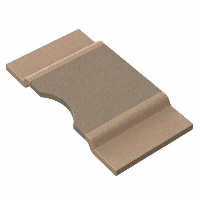

    贴片电阻 - 2mΩ ±5% 3W ±75ppm/℃
PU3921JKM130R002L 数据手册
DATA SHEET SHUNT RESISTOR AUTOMOTIVE GRADE PU series 5%, 1% sizes 2512/ 3921/ 5931 Product specification – August 02, 2021 V.8 RoHS compliant & Halogen free Product specification Chip Resistor Surface Mount SERIES PU 2 9 2512/ 3921/ 5931 SCOPE ORDERING INFORMATION - GLOBAL PART NUMBER This specification describes shunt resistor PU series made by welding technology. Global part numbers are identified by the series, size, tolerance, packing type, temperature coefficient, taping reel and resistance value. GLOBAL PART NUMBER PU XXXX X X X XX XXXX L APPLICATIONS  Power  Telecom base station  Automotive (Headlight/ Window control/ Engine control unit/ Steering control…)  Alternative energy (1) (2) (3) (4) (5) (6) (7) (1) SIZE 2512/ 3921/ 5931 (2) TOLERANCE F = ± 1% J = ± 5% (3) PACKAGING TYPE K = Embossed taping reel FEATURES  AEC-Q200 qualified (4) TEMPERATURE COEFFICIENT OF RESISTANCE M = ± 75 ppm/°C  Total lead free without RoHS exemption N = ± 175 ppm/°C  Resistance value down to 0.0001Ω and high power up to 15W H = ± 225 ppm/°C  Welding metal plate construction G = ± 200 ppm/°C I = ± 300 ppm/°C O = ± 325 ppm/°C (5) TAPING REEL 13 = 13 inch Dia. reel, standard power, 4W for 2512, 3W for 3921 and 5W for 5931 P5 = 5W , 13 inch Dia. reel YAGEO will eliminate the resistance value marking on the PU5931 on Feb 6th, 2022 and the samples without marking will be available on Aug 16th, 2021. The Product Change Notification number is EBR-0176-21071601. P6 = 6W , 13 inch Dia. Reel P7 = 7W , 13 inch Dia. reel P9 = 9W , 13 inch Dia. reel T3 = 3W , High temperature 13 inch Dia. reel T5 = 5W , High temperature 13 inch Dia. reel PA = 10W, 13 inch Dia. Reel PB = 15W, 13 inch Dia. Reel PC = 12W, 13 inch Dia. Reel (6) RESISTANCE VALUE 0.1 mΩ to 5 mΩ There are 3~5 digits indicated the resistance value. Letter R/ U is decimal point. Detailed coding rules of resistance are shown in the table of “Resistance rule of global part number”. (7) DEFAULT CODE Letter L is the system default code for ordering only. (Note) Resistance rule of global part number Resistance code rule Example 0RXXX 0UX 0R001 = 1 mΩ 0U2 = 0.0002 Ω ORDERING EXAMPLE The ordering code of a PU3921, value 0.0005Ω with ±1% tolerance, 3W and high temperature(275°C) supplied in 13-inch tape reel is : PU3921FKNT30U5L NOTE 1. All our RSMD products are RoHS compliant. "LFP" of the internal 2D reel label mentions "Lead-Free Process" www.yageo.com Aug. 02, 2021 V.8 3 Product specification Chip Resistor Surface Mount PU SERIES 9 2512/ 3921/ 5931 MARKING PU2512 No marking Fig. 1 Value = 0.2mΩ PU3921/ 5931 - 0.1~0.7mΩ 4 digits The "m" is used as a decimal point ; the other 3 digits are significant and the unit is milliohm 0.1mΩ to 0.7mΩ Fig. 2 Value = 0.2mΩ PU3921/ 5931 - 1~5mΩ 4 digits The "R" is used as a decimal point ; the other 3 digits are significant 1mΩ to 5mΩ Fig. 3 Value = 1mΩ NOTE: There will be a short period of time that both types of PU5931, with marking and without marking, exist simultaneously in the market. The exterior of PU5931 without marking is shown in Fig. 1 OUTLINES AND DIMENSION Fig. 4-1 Chip resistor outlines Table 1-1 For outlines, please refer to Fig. 3-1 TYPE L (mm) W (mm) H (mm) I1 (mm) PU2512 6.35± 0.25 3.18± 0.25 0.35± 0.15 1.14± 0.25 PU3921 10.0± 0.25 5.20± 0.25 0.50± 0.13 2.00± 0.25 PU5931 15.0± 0.25 7.75± 0.25 0.50± 0.13 4.00± 0.25 Resistance Value PU2512 T (mm) PU3921 Thickness 0.1mΩ ----- 0.2mΩ 0.25mΩ 0.3 mΩ 0.4mΩ 0.5 mΩ 0.7 mΩ --- --- 0.95± 0.13 0.75± 0.13 0.84± 0.13 --- 1 mΩ 2 mΩ 3 mΩ 4 mΩ 5 mΩ 0.43± 0.13 0.66± 0.13 0.44± 0.13 0.33± 0.13 0.31± 0.13 1.35± 0.13 1.05± 0.10 1.35± 0.13 1.05 ± 0.13 0.86± 0.13 0.60± 0.10 0.43± 0.13 0.72± 0.13 0.48± 0.13 0.36± 0.13 0.25± 0.13 PU5931 1.42± 0.13 1.33± 0.13 --- 1.00± 0.13 -- 0.60± 0.13 --- 0.33± 0.13 0.49± 0.13 0.33± 0.13 0.25± 0.13 --- www.yageo.com Aug. 02, 2021 V.8 Product specification Chip Resistor Surface Mount PU SERIES 4 9 2512/ 3921/ 5931 ELECTRICAL CHARACTERISTICS Fig. 4 Chip resistor outlines Fig. 4-2 Solder pad dimensions Note: Series resistors are suitable for IR reflow soldering Table 1-2 For outlines, please refer to Fig. 4-2 TYPE A (mm) B (mm) C (mm) PU2512 1.80± 0.15 3.40± 0.15 3.40± 0.13 PU3921 2.75± 0.25 6.20± 0.25 5.60± 0.13 PU5931 5.20± 0.25 8.75± 0.25 5.60± 0.13 Table 2 SIZE POWER OPERATING RATING(4) TEMP. RANGE 4W(13) PU2512 PU3921 5W(P5) TOLERANCE(2) TEMPERATURE COZEFFICIENT OF RESISTANCE(3) 3/ 4/ 5mΩ -65°C to 170°C 1/ 2mΩ 0.3/ 0.4/ 0.5mΩ: ± 200ppm/°C (G) 1mΩ: ± 175ppm/°C (N) 2~5mΩ: ± 75ppm/°C (M) ± 1% (F) ± 5% ( J ) 6W(P6) 0.3/ 0.4/ 0.5mΩ 3W(13) 0.2/ 0.25/ 0.3/ 0.4/ 0.5/ 0.7mΩ 1/ 2/ 3/ 4/ 5mΩ 0.2/ 0.25/ 0.3/ 0.4/ 0.5/ 0.7mΩ: ± 175ppm/°C (N) 1~5mΩ: ± 75ppm/°C (M) 5W(P5) 0.2/ 0.25/ 0.3/ 0.4/ 0.5/ 0.7mΩ 1/ 2/ 3/ 4/ 5mΩ 0.2mΩ: ± 325ppm/°C (O) 0.2/ 0.25/ 0.3/ 0.4/ 0.5/ 0.7mΩ: ± 175ppm/°C (N) 1~5mΩ: ± 75ppm/°C (M) 9W(P9) -65°C to 170°C 10W(PA) 12W(PC) 3W(T3) -65°C to 275°C 5W(13) 7W(P7) PU5931 RESISTANCE RANGE -65°C to 170°C 10W(PA) ± 1% (F) ± 5% ( J ) 0.2/ 0.3/ 0.5mΩ 0.2mΩ: ± 225ppm/°C (H) 0.3/ 0.5mΩ: ± 175ppm/°C (N) 0.5/1/ 2/ 3/ 4mΩ 0.5mΩ: ± 175pm/°C (N) 1~4mΩ: ± 75ppm/°C (M) 0.2/ 0.3/ 0.5/ 1/ 2/ 3/ 4mΩ 0.2mΩ: ± 225ppm/°C (H) 0.3/ 0.5mΩ: ± 175ppm/°C (N) 1~4mΩ: ± 75ppm/°C (M) 0.2/ 0.3/ 0.5/ 1/ 2/ 3/ 4mΩ 0.2/ 0.3/ 0.5mΩ 15W(PB) 5W(T5) 0.2/ 0.25/ 0.3/ 0.4/ 0.5/ 0.7/ 1mΩ ± 1% (F) ± 5% ( J ) 0.1mΩ -65°C to 275°C 0.3/ 0.5/ 1/ 2/ 3/ 4mΩ 0.1mΩ: ± 300ppm/°C ( I ) 0.2mΩ: ± 225ppm/°C (H) 0.3/ 0.5mΩ: ± 175ppm/°C (N) 1~4mΩ: ± 75ppm/°C (M) 0.3/ 0.5mΩ: ± 175ppm/°C (N) 1~4mΩ: ± 75ppm/°C (M) Note: 1. Please contact with sales offices, distributors and representatives in your region before ordering. 2. Global part number (code7) 3. Global part number (code 9) 4. Global part number (code 10-11) www.yageo.com Aug. 02, 2021 V.8 Product specification Chip Resistor Surface Mount PU SERIES 5 9 2512/ 3921/ 5931 FUNCTIONAL DESCRIPTION OPERATING TEMPERATURE RANGE High Temperature Range Type: -65°C to +275°C (Fig. 5-1) Normal Temperature Range Type: -65°C to +170°C (Fig. 5-2) POWER RATING Standard rated power at 70°C: PU2512 = 4W PU3921 = 3W PU5931 = 5W Fig. 5-1 Maximum dissipation (P max ) in percentage of rated power as a function of the operating ambient temperature (T amb ) For detail power value, please refer to Table 2. RATED VOLTAGE V= (PxR ) Where MRA633-3 Power rating ratio (%) The DC or AC (rms) continuous working voltage corresponding to the rated power is determined by the following formula: 100 80 60 40 20 V = Continuous rated DC or AC (rms) working voltage (V) 0 65 -25 25 75 125 170 175 225 275 Ambient Temperature (C) P = Rated power (W) R = Resistance value (Ω) 70 Fig. 5-2 Maximum dissipation (P max ) in percentage of rated power as a function of the operating ambient temperature (T amb ) www.yageo.com Aug. 02, 2021 V.8 Product specification Chip Resistor Surface Mount SERIES PU 6 9 2512/ 3921/ 5931 PACKING STYLE AND PACKAGING QUANTITY Table 3 Packing style and packaging quantity PACKING STYLE REEL DIMENSION 2512 3921 5931 Embossed taping reel (K) 13" (330 mm) 4,000 3,000 1,500 EMBOSSED TAPE Fig. 5 Embossed Tape Table 4 Dimensions of embossed tape for relevant chip resistors size D0 D1 MIN. E P0 P1 P2 0.3/ 0.4 /0.5 /2mΩ 3.58± 0.1 6.7± 0.1 1.5± 0.1 1.5 1.75± 0.1 5.5± 0.1 1.52 4± 0.1 8± 0.1 2± 0.1 0.1 1.92 0.3 12.3 3.58± 0.1 6.7± 0.1 1.5± 0.1 1.5 1.75± 0.1 5.5± 0.1 1.14 4± 0.1 8± 0.1 2± 0.1 0.1 1.54 0.3 12.3 5.59± 0.1 10.41± 0.1 1.5± 0.1 1.5 1.75± 0.1 7.5± 0.1 2.13 4± 0.1 8± 0.1 2± 0.1 0.1 2.64 0.41 16.3 5.59± 0.1 10.41± 0.1 1.5± 0.1 1.5 1.75± 0.1 7.5± 0.1 1.14 4± 0.1 8± 0.1 2± 0.1 0.1 1.65 0.41 16.3 ≦0.3mΩ 8.3± 0.1 15.62± 0.1 1.5± 0.1 1.5 1.75± 0.1 11.5± 0.1 2.39 4± 0.1 12± 0.1 2± 0.1 0.1 2.9 0.41 24.3 ≧0.5mΩ 8.3± 0.1 15.62± 0.1 1.5± 0.1 1.5 1.75± 0.1 11.5± 0.1 1.22 4± 0.1 12± 0.1 2± 0.1 0.1 1.73 0.41 DIMENSION A0 B0 F K0 MAX. T1 T2 T W MAX. MAX. MAX. MAX. PU2512 1 /3 /4 /5mΩ PU3921 0.2/ 0.25/ 0.3/ 0.4 0.5 / 0.7/ 2mΩ 1 /3 /4 /5mΩ PU5931 24.3 Unit : mm www.yageo.com Aug. 02, 2021 V.8 Product specification Chip Resistor Surface Mount PU SERIES 7 9 2512/ 3921/ 5931 REEL SPECIFICATION Fig. 6 Table 5 Dimensions of reel specification for relevant chip resistors size; see Fig. 6 PRODUCT SIZE CODE REEL SIZE SYMBOL A N C D W1 W2 max. 2512 13" (Φ 330mm) 330+0 /-3 100± 0.5 13.5± 0.5 21± 0.8 13± 0.3 17.5 3921 13" (Φ 330mm) 330+0 /-3 100± 0.5 13.5± 0.5 21± 0.8 16.4+2.0/-0 22.4 5931 13" (Φ 330mm) 330+0 /-3 100± 0.5 13.5± 0.5 21± 0.8 24.4+2.0/-0 30.4 Unit : mm www.yageo.com Aug. 02, 2021 V.8 Product specification Chip Resistor Surface Mount PU SERIES 8 9 2512/ 3921/ 5931 TESTS AND REQUIREMENTS Table 6 Test condition, procedure and requirements TEST Short Time Overload TEST METHOD PROCEDURE REQUIREMENTS IEC60115-1 4.13 5 times of rated power for 5 seconds at room temperature ± (1%+0.0005 Ω) No visible damage High Temperature Exposure AEC-Q200 Test 3 MIL-STD-202 method 108A 1,000 hours at maximum operating temperature depending on specification, unpowered, Normal Temperature Range Type:170± 3°C High Temperature Range Type: 275± 5°C ± (1%+0.0005 Ω) IEC 60115-1 4.25.3 Moisture Resistance AEC-Q200 Test 6 MIL-STD-202 method 106F Each temperature / humidity cycle is defined at 8 hours (method 106F), 3 cycles / 24 hours for 10d with 25 °C / 65 °C 95% R.H, without steps 7a & 7b, unpowered Parts mounted on test-boards, without condensation on parts Measurement at 24± 2 hours after test conclusion ± (1%+0.0005 Ω) Biased Humidity AEC-Q200 Test 7 MIL-STD-202 method 103 1,000 hours; 85 °C / 85% RH 10% of operating power Measurement at 24± 4 hours after test conclusion. ± (1%+0.0005 Ω) Life/ Operational Life/ Endurance AEC-Q200 Test 8 MIL-STD-202 method 108A IEC 60115-1 4.25.1 1,000 hours at 70± 5 °C applied RCWV 1.5 hours on, 0.5 hour off, still air required ± (1%+0.0005 Ω) - Resistance to Soldering Heat AEC-Q200 Test 15 MIL-STD-202 method 210F IEC 60115-1 4.18 Condition B, no pre-heat of samples Lead free solder, 260 °C, 10 seconds immersion time Procedure 2 for SMD: devices fluxed and cleaned with isopropanol ± (0.5%+0.0005 Ω) No visible damage Thermal Shock AEC-Q200 Test 16 MIL-STD-202 method 107 -55/+150 °C Number of cycles is 300. Maximum transfer time is 20 seconds. Dwell time is 15 minutes. Air – Air ± (1%+0.0005 Ω) No visible damage Board Flex / Bending AEC-Q200 Test 21 AEC-Q200-005 Chips mounted on a 90mm glass epoxy resin PCB (FR4) Bending: 2 mm Holding time: minimum 60 seconds ± (1%+0.0005 Ω) www.yageo.com Aug. 02, 2021 V.8 Product specification Chip Resistor Surface Mount PU SERIES 2512/ 3921/ 5931 9 9 REVISION HISTORY REVISION TYPE Version 8 DATE CHANGE NOTIFICATION Aug. 02, 2021 - POWER TEMPERATURE COEFFICIENT RESISTANCE RANGE - Notify our clients that YAGEO will eliminate resistance value marking on TOLERANCE OF RESISTANCE 1/10W, Version 70603 Apr. 15, 2021 1/5W, - 3/10W, 2/5W, 1/2W 1/4W, 1/3W, 1/2W Version 60805 Apr. 03, 2019 1/8W, 1206 Jun. 28, 2018 Version 5 Version 4 - 1/4W, 1/2W 1/2W, 1W - are constructed Nov.The 23, 2017 resistors 4527 the PU5931 5 mΩ ≦ R < 100 mΩ - Extend resistor value for 2512 and power rating for 3921 4 mΩ ≦ R < 100 mΩ - Extend resistor value for 3921 3 mΩ ≦ R < 100 mΩ - Update packing quantity for PU2512 - Added in PU2512 using outstanding TCR level Version 3 Maymaterial, 24, 2017 which makes Yageo PF resistors excellent for current Version 2 Jan. 16, 2017 sensing application in battery Version 1 Jun. charger 15, 2016 circuit - & DC-DC converter. Version 0 Mar.The 16, 2016 composition of the resistive material is adjusted to give the PF 2010 approximate required resistance and is covered with a protective coating, which printed with the resistance value. Finally, the three external terminations (Ni / matte Tin) are added, as shown in Fig. 4. 2512 DESCRIPTION - Added in thickness for 3921 0.4mΩ - Extend resistor value - Extend resistor value New datasheet for shunt resistor PU series ±- 1% ± 2% 5 mΩ ≦ R < 100 mΩ ±75 ppm/°C ± 5% 1W, 2W 1 mΩ ≦ R < 100 mΩ 3W 1 mΩ ≦ R ≦ 50 mΩ 2W, 3W, 5W 6 mΩ ≦ R < 1Ω NOTE: 1. PLEASE CONTACT WITH SALES OFFICES, DISTRIBUTORS AND REPRESENTATIVES IN YOUR REGION BEFORE ORDERING “ Yageo reserves all the rights for revising the content of this datasheet without further notification, as long as the products itself are unchanged. Any product change will be announced by PCN.” www.yageo.com Aug. 02, 2021 V.8
