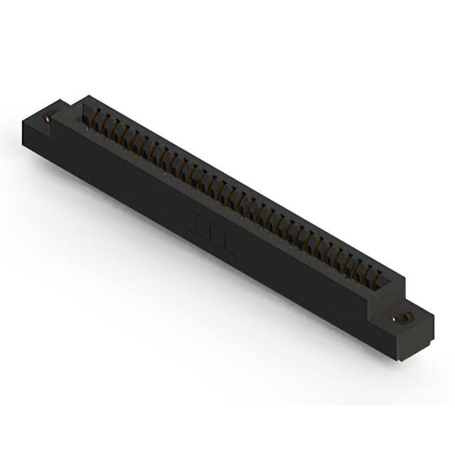

341/391 SERIES Card Edge Connectors 0.100” (3.96mm) Pitch • • • • • • • • • 0.156” (3.96mm) contact spacing x 0.200” (5.08mm) row spacing Accepts 0.062” (1.57mm) nominal thickness P.C. board Low profile insulator body, 0.473” (12.01mm) Contact termination 0.045” (1.14mm) square wire wrap Single or dual row configurations Large variety of mounting options Pre-assembled card guides available Accepts between contact and in-contact polarizing keys RoHS Compliant Insulator Material UL 94V-0 Thermoplastic Polyester Contact Material Copper Alloy Contact Plating Gold Plating on mating area and Tin Plating on tails with Nickel underplating all over Current Rating 3 amps Contact Resistance 10 milliohms maximum Dielectric Withstanding Voltage 1200 V AC rms at sea level between adjacent contacts Insulation Resistance 5000 megaohms minimum Operating Temperature -40°C to +105°C Insertion Force 16 oz (4.45 N) maximum per contact pair when tested with .070” (1.78mm) thick gauge Withdrawal Force 1 oz (0.28 N) minimum per contact pair when tested with .054” (1.37mm) thick gauge Series: Insulator Color: 341 Green Series 391 Black Total Number of Contacts Total Number of Contacts: Contact Rows: Contact Code 005, 006, . . . . 060 Single Row Contact Rows 010, 012, . . . . 120 Dual Row Mounting Options Contact Code: Tail Description: Tail Size: Tail Length “G”: 500 Wire Hole .050 x .013 (1.27 x 0.33) .220 (5.59) 520 P.C. Tail .025 x .013 (0.64 x 0.33) .125 (3.18) 521 P.C. Tail .025 x .013 (0.64 x 0.33) .260 (6.60) 522 P.C. Tail .025 x .013 (0.64 x 0.33) .375 (9.53) 524 P.C. Tail .025 x .013 (0.64 x 0.33) .100 (2.54) 555 Extender Board Bend (Code 500 Contacts) 556 Extender Board Bend (Code 521 Contacts) Contact Rows: Description: 1 Single Row 2 Dual Row Mounting Options: Description: 341-062-520-202 Example Part Number: Mounting Options: Description: 01 No Mounting Lug 01 No Mounting Lug 02 Ø.128" (Ø3.25mm) Mounting Holes 02 Ø.128” (Ø3.25mm) Mounting Holes 03 Ø.116" (Ø2.95mm) I.D. Floating Eyelets 03 Ø.116" (Ø2.95mm) I.D. Floating Eyelets 04 Ø.156" (Ø3.96mm) Mounting Holes 07 M3-0.5 Metric Threaded Inserts 08 #4-40 Unified Threaded Inserts 04 Ø.156" (Ø3.96mm) Mounting Holes 07 M3-0.5 Metric Threaded Inserts 08 #4-40 Unified Threaded Inserts 58 .468" (11.89mm) Offset Card Guides Ordering Code Notes: 1) All connector sizes up to 60 contacts single row / 120 contacts dual row are available upon request. 2) The 500 contact code is only available in the 341 series. Green Diallyl Phthalate insulator material will be supplied. 3) For details of the extender board bends refer to next pages. 4) For details of the mounting options refer to page 3. 336 SERIES 341/391 SERIES Card Edge Connectors 0.100” (3.96mm) Pitch NUMBER OF CONTACTS "A" "B" "C" "D" "D" Single Double Inch mm Inch mm Inch mm Inch mm Inch mm 5 10 1.375 (34.93) 1.075 (27.31) 0.775 (19.69) 0.600 (15.24) 0.400 (10.16) 6 12 1.475 (37.47) 1.175 (29.85) 0.875 (22.23) 0.700 (17.78) 0.500 (12.7) 10 20 1.875 (47.63) 1.575 (40.01) 1.275 (32.39) 1.100 (27.94) 0.900 (22.86) 15 30 2.375 (60.33) 2.075 (52.71) 1.775 (45.09) 1.600 (40.64) 1.400 (35.56) 18 36 2.675 (67.95) 2.375 (60.33) 2.075 (52.71) 1.900 (48.26) 1.700 (43.18) 22 44 3.075 (78.11) 2.775 (70.49) 2.475 (62.87) 2.300 (58.42) 2.100 (53.34) 25 50 3.375 (85.73) 3.075 (78.11) 2.775 (70.49) 2.600 (66.04) 2.400 (60.96) 28 56 3.675 (93.35) 3.375 (85.73) 3.075 (78.11) 2.900 (73.66) 2.700 (68.58) 30 60 3.875 (98.43) 3.575 (90.81) 3.275 (83.19) 3.100 (78.74) 2.900 (73.66) 36 72 4.475 (113.67) 4.175 (106.05) 3.875 (98.43) 3.700 (93.98) 3.500 (88.9) 40 80 4.875 (123.83) 4.575 (116.21) 4.275 (108.59) 4.100 (104.14) 3.900 (99.06) 43 86 5.175 (131.45) 4.875 (123.83) 4.575 (116.21) 4.400 (111.76) 4.200 (106.68) 50 100 5.875 (149.23) 5.575 (141.61) 5.275 (133.99) 5.100 (129.54) 4.900 (124.46) 60 120 6.875 (174.63) 6.575 (167.01) 6.275 (159.39) 6.100 (154.94) 5.900 (149.86) www.edac.net customerservice@edac.net 341/391 SERIES Card Edge Connectors 0.100” (3.96mm) Pitch NO MOUNTING LUGS CONNECTOR "B" DIMENSION CONNECTOR "C" DIMENSION DIA THROUGH HOLES MOUNTING OPTION CODES x02 and xO4 MOUNTING OPTION CODE x01 .250 (6.35) DIA A .010 (0.25) RADIAL FLOAT .328(8.33) .116 (2.95) I.D. FLOATING EYELETS .005 (0.51) VERTICAL FLOAT CONNECTOR "B" DIMENSION CONNECTOR "B" DIMENSION MOUNTING OPTION CODE x03 CODE x07 M3-0.5 METRIC CODE x08 #4-40 UNC THREADED INSERTS MOUNTING OPTION CODES x07 & xO8 CODE X02 AND X04- THROUGH MTG. HOLES "A" DIA. CODE X02 CODE X04 0.128(3.25) 0.156(3.96) CODE X07 AND X08- THREADED INSERTS CODE X07 INSERT M3-0.5(METRIC) .120 (3.05) A .045 (1.14) TO .060 (1.52) BETWEEN TAILS .125 (3.18) TO .210 (5.33) OUTSIDE TAILS CONTACT CODE 555 BEND USES WIRE HOLE CONTACTS CODE X08 #4-40 UNC .165 (4.19) A .045 (1.14) TO .060 (1.52) BETWEEN TAILS .125 (3.18) TO .210 (5.33) OUTSIDE TAILS CONTACT CODE 560 .095 (2.41) A .045 (1.14) TO .060 (1.52) BETWEEN TAILS .125 (3.18) TO .185 (4.70) OUTSIDE TAILS CONTACT CODE 556 www.edac.net customerservice@edac.net
391-078-522-203
物料型号:341/391系列
器件简介:这是一系列卡边缘连接器,具有0.100英寸(3.96mm)的间距,接受0.062英寸(1.57mm)名义厚度的PCB板。绝缘体材料为UL 94V-0热塑性聚酯,接触材料为铜合金,接触镀层为金镀在配合区域和锡镀在尾部,整体上有镍底层。
引脚分配:提供单排或双排配置,有多种接触数量选项,从5到120不等。
参数特性: - 电流额定值:3安培 - 接触电阻:最大10毫欧姆 - 介电强度:在相邻接触之间1200V AC rms - 绝缘电阻:最小5000兆欧姆 - 工作温度:-40°C至+105°C - 插入力:每个接触对最大16盎司(4.45牛顿) - 拔出力:每个接触对最小1盎司(0.28牛顿)
功能详解:这些连接器设计用于电子设备中,提供稳定的电气连接,并且有多种安装选项和预装的卡导轨。
应用信息:适用于需要卡边缘连接的电子应用,如计算机、通信设备等。
封装信息:低轮廓绝缘体体,尺寸为0.473英寸(12.01mm)。接触终止为0.045英寸(1.14mm)的方形线圈缠绕。
