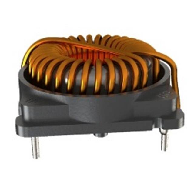

    FIXED IND 150UH 6A 43 MOHM TH
L301314A-151LHF 数据手册
L301314A Series 1. Features of L301314A Series : • • • • • • • • Alloy powder core is used to realize lower core loss. No thermal aging concerns. Low leakage magnetic flux. Elimination for impulse (EMI) noise. Ideally used as Power Factor Correction choke. Also can be used as boost inductor in power supplies. Inductance Range: 69.63uH to 300 uH , custom values are welcomed. Foot Print 29.0×26.0mm max. , 16.5mm max. Height. • Operating Temperature Range: -55°C to + 130°C; RoHs & HF compliance. 2. Electrical Characteristics of L301314A Series: OCL (PIN1-2) 1 DCR Isat 2 L@Isat Irms 3 L@Irms Dim. A Dim. D (uH) (mΩ) (A) (uH) (A) (uH) (mm) (mm) ± 15% Max. @25℃ @25℃ @25℃ @25℃ @25℃ Max. Max. L301314A-690LHF 69.63 18.50 3.80 47.29 9.50 19.40 29.00 16.50 L301314A-101LHF 100.00 26.00 3.20 68.54 8.00 28.33 29.00 16.50 L301314A-151LHF 150.00 43.00 2.60 102.26 6.00 47.29 28.00 16.00 L301314A-201LHF 200.00 75.00 2.20 137.68 4.50 74.73 28.00 15.50 L301314A-251LHF 250.00 112.00 2.00 169.05 3.60 104.82 27.00 14.50 L301314A-301LHF 300.00 170.00 1.80 205.34 2.90 143.64 27.00 14.50 ITG Part Number A 3. Mechanical Dimension of L301314A Series (Unit:mm): A B C Max. ± 0.30 ±0.50 See table 25.70 3.20 above D E1 E2 F B Max. ±0.50 ±0.50 ±0.10 See table 20.32 20.32 Φ1.00 above 20.32 Top View 2 4 3 1 20.32 D F C 3 1 Suggested PCB Layout Front View 1 3 E2 The diameter of hole of Base:14.0¡ À 0.5mm 2 SCHEMATIC DIAGRAM Notes: ψ1.40 Marking 4 E1 Bottom View 1. Open Circuit Inductance (OCL) and L@Irms and L@Isat are measured at 100KHz,0.25V@ 25ºC. 2. Isat: DC current that causes inductance to drop by approximately 35% from OCL (Ta=25℃). 3. Irms: DC current that causes an approximate temperature rise (△T) of 40℃ (Ta=25ºC). ● ● New York 1 914 347 2474 ● Taipei 886 2 2698 8669 ● Kaohsiung 886 7 350 2275 Japan 81 568 85 2830 ● Shenzhen 86 755 8418 6263 ● Shanghai 86 21 5424 5141 ● Hong Kong 852 9688 9767 ● sales@ITG-Electronics.com ● www.ITG-Electronics.com Revision A.0: August 1, 2019 *Due to continuous product improvement, all specifications are subject to change without prior notice. Kindly contact an ITG field application engineer or a sales representative prior to purchase. L301314A Series 4. Inductance vs. Current vs. Temperature Rise Characteristics of L301314A Series : 50 57.6 40 84.0 40 43.2 30 63.0 30 28.8 20 42.0 20 14.4 10 21.0 10 0 0.0 0.0 1.5 3.0 4.5 6.0 7.5 9.0 10.5 DC Bias (A) 4.5 6.0 7.5 9.0 50 124.0 40 164.0 40 93.0 30 123.0 30 62.0 20 31.0 L(uH) 205.0 82.0 20 10 41.0 10 0 0.0 0.0 1.0 2.0 3.0 4.0 5.0 6.0 7.0 0 0.0 0.8 1.6 2.4 3.2 4.0 4.8 5.6 DC Bias (A) DC Bias (A) L301314A-251LHF L301314A-301LHF 315.0 50 208.0 40 252.0 40 156.0 30 189.0 30 104.0 20 52.0 0.0 0.5 1.0 1.5 2.0 2.5 3.0 3.5 4.0 4.5 DC Bias (A) L(uH) 50 △T(℃) 260.0 0.0 △T(℃) L301314A-201LHF 50 △T(℃) L(uH) 3.0 155.0 0.0 L(uH) 1.5 DC Bias (A) L301314A-151LHF ● 0 0.0 126.0 20 10 63.0 10 0 0.0 △T(℃) 0.0 L(uH) 105.0 △T(℃) L301314A-101LHF 50 △T(℃) L(uH) L301314A-690LHF 72.0 0 0.0 0.5 1.0 1.5 2.0 2.5 3.0 3.5 4.0 4.5 DC Bias (A) ● New York 1 914 347 2474 ● Taipei 886 2 2698 8669 ● Kaohsiung 886 7 350 2275 Japan 81 568 85 2830 ● Shenzhen 86 755 8418 6263 ● Shanghai 86 21 5424 5141 ● Hong Kong 852 9688 9767 ● sales@ITG-Electronics.com ● www.ITG-Electronics.com Revision A.0: August 1, 2019 *Due to continuous product improvement, all specifications are subject to change without prior notice. Kindly contact an ITG field application engineer or a sales representative prior to purchase.
