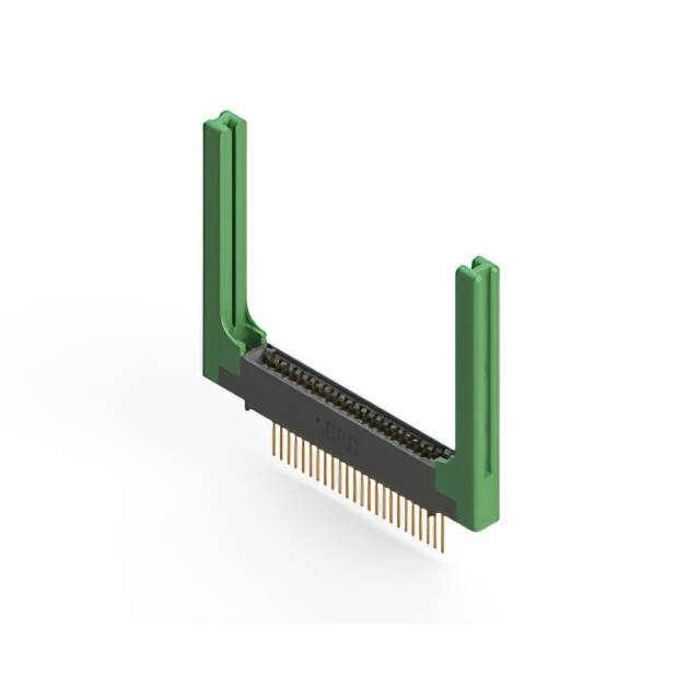

Contact Dimensions: 542-Wire Wrap .025 Sq.(0.64 Sq.) - Tail LG=.645(16.38) .100 (2.54) Contact Spacing x .200 (5.08) Row Spacing 2x ISSUE NUMBER THIS IS A C.A.D. GENERATED DRAWING DO NOT MAKE MANUAL REVISIONS TO MASTER. ORIGINAL 1 .156 3.96 .330 8.38 CARD SLOT .160 4.06 POINT OF CONTACT 2.500 63.5 2.660 67.56 2.975 75.57 .600 15.24 .250 6.35 .150 [3.81] A A 3.235 82.17 SECTION A-A 345/395 SERIES CARD EDGE CONNECTOR PART NUMBER: 395-024-542-458 • • • INSULATOR MATERIAL: THERMOPLASTIC PBT BLACK, UL 94V-0 CONTACT MATERIAL; COPPER TIN ALLOY CONTACT PLATING: GOLD ON THE MATING AREA, TIN PLATING ON THE CONTACT TAILS, NICKEL UNDERPLATE EDAC INC TORONTO, ONTARIO CANADA YOUR CONNECTION TO QUALITY & SERVICE THESE DRAWINGS AND SPECIFICATIONS ARE THE PROPERTY OF EDAC INC.,AND SHALL NOT BE REPRODUCED,OR COPIED OR USED AS THE BASIS FOR THE MANUFACTURE OR SALE OF APPARATUS WITHOUT WRITTEN PERMISSION. ACAD REFERENCE NO. 345-ENG-MASTER DRAWN: R.STA.MONICA DATE:MAY.16/2017 CHECKED: DATE: SCALE: 1:1 DRAWING NUMBER 345-ENG-MASTER SHEET 1 OF 2 ISSUE 1 Contact Description: 559-90 Degree Bend (Code 541 Contacts) .107 2.72 ORIGINAL .157 4 .125(3.18) to .210(5.33) Outside Tails .125(3.18) to .210(5.33) Outside Tails .045(1.14) to .060(1.52) Between Tails .045(1.14) to .060(1.52) Between Tails Contact Code 555 Contact Code 556 .060 .152 3.86 .060 .150 .200 .285 7.24 .635 16.13 1 .082 2.08 .232 5.89 .235 5.97 ISSUE NUMBER THIS IS A C.A.D. GENERATED DRAWING DO NOT MAKE MANUAL REVISIONS TO MASTER. .362 9.19 .125(3.18) to .210(5.33) Outside Tails .635 16.13 .045(1.14) to .060(1.52) Between Tails Contact Code 558 • • • INSULATOR MATERIAL: THERMOPLASTIC POLYESTER, UL 94V-0 DAP MATERIAL AVAILABLE UPON REQUEST CONTACT MATERIAL; COPPER ALLOY CONTACT PLATING: GOLD ON THE MATING AREA, TIN PLATING ON THE CONTACT TAILS, NICKEL UNDERPLATE Contact Code 559 Contact Code 560 345/395 SERIES CARD EDGE CONNECTOR CONTACT CODE 555,556,558,559,560 DIMENSIONS EDAC INC TORONTO, ONTARIO CANADA YOUR CONNECTION TO QUALITY & SERVICE THESE DRAWINGS AND SPECIFICATIONS ARE THE PROPERTY OF EDAC INC.,AND SHALL NOT BE REPRODUCED,OR COPIED OR USED AS THE BASIS FOR THE MANUFACTURE OR SALE OF APPARATUS WITHOUT WRITTEN PERMISSION. ACAD REFERENCE NO. DRAWN: R.STA.MONICA DATE: CHECKED: SCALE: 345-ENG-MASTER DATE:MAY.16/2017 1:1 DRAWING NUMBER 345-ENG-MASTER SHEET 2 OF 2 ISSUE 1

1. 物料型号:345-024-542-458,这是EDAC公司生产的卡边缘连接器的型号。
2. 器件简介:文档描述了卡边缘连接器的接触描述,包括90度弯曲的接触(代码541接触)。
3. 引脚分配:文档中提到了引脚间距为.100英寸(2.54毫米),行间距为.200英寸(5.08毫米)。
4. 参数特性: - 绝缘体材料:热塑性PBT黑色,符合UL 94V-0标准。 - 接触材料:铜锡合金。 - 接触镀层:接触区域为金镀层,接触尾部为锡镀层,底部为镍镀层。
5. 功能详解:文档中详细描述了接触的尺寸和形状,例如接触的外尾部尺寸为.125英寸(3.18毫米)到.210英寸(5.33毫米),尾部间距为.045英寸(1.14毫米)到.060英寸(1.52毫米)。
6. 应用信息:文档中提到了EDAC公司提供的高质量和服务,以及这些图纸和规格是EDAC公司的财产,未经书面许可不得复制或用作制造或销售设备的依据。
7. 封装信息:文档中没有明确提到封装信息,但提到了绝缘体材料和接触材料的详细信息。
