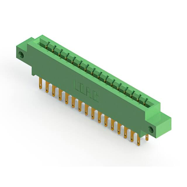

    插件,P=3.96mm
    3.96MM P数:32P
333-032-500-812 数据手册
333 SERIES Card Edge Connectors 0.156” (3.96mm) Pitch Features: • • • • • • • • • 0.156” (3.96mm) contact spacing x 0.200” (5.08mm) row spacing Accepts 0.062” (1.57mm) nominal thickness P.C. board High profile insulator body, 0.600” (15.24mm) Card slot depth of 0.388” (9.86mm) Contact termination options include P.C. tail, wire hole, wire wrap, 90 degree and extender board bends Single or dual row configurations Large variety of mounting options, flush or offset lugs Accepts between contact and in-contact polarizing keys RoHS Compliant Specifications: Insulator Material UL 94V-0 Thermoplastic Polyester, Green Color Contact Material Copper Alloy Contact Plating Gold Plating on mating area and Tin Plating on tails with Nickel underplating all over Current Rating 3 amps Contact Resistance 10 milliohms maximum Dielectric Withstanding Voltage 1800 V AC rms at sea level between adjacent contacts Insulation Resistance 5000 megaohms minimum Operating Temperature -40°C to +105°C Insertion Force 16 oz (4.45 N) maximum per contact pair when tested with .070” (1.78mm) thick gauge Withdrawal Force 1 oz (0.28 N) minimum per contact pair when tested with .054” (1.37mm) thick gauge Example Part Number: 333-044-520-204 Series Total Number of Contacts Contact Code Contact Rows and Insulator Style Mounting Options Series: Contact Code 333 Tail Description Tail Size Tail Length “G” 500 Wire Hole .050 x .025 (1.27 x 0.64) .260 (6.60) 520 P.C. Tail .030 x .018 (0.76 x 0.46) .175 (4.45) Total Number of Contacts: Contact Rows: 006, 007, . . . . 043 Single Row 521 P.C. Tail .025 Square (0.64 Square) .150 (3.81) 012, 014, . . . . 086 Dual Row 523 P.C. Tail .025 Square (0.64 Square) .390 (9.91) Contact Rows: Description: Insulator Style: 524 P.C. Tail .018 Square (0.46 Square) .175 (4.45) 1 Single Row Flush Mounting Lugs 540 Wire Wrap .025 Square (0.64 Square) .560 (14.22) 2 Dual Row Flush Mounting Lugs 541 Wire Wrap .025 Square (0.64 Square) .750 (19.05) 6 Single Row .170 (4.32) Offset Lugs 542 Wire Wrap .025 Square (0.64 Square) .645 (16.38) 8 Dual Row .170 (4.32) Offset Lugs .750 (19.05) Mounting Options: Description: 01 No Mounting Lug 556 EXTENDER BOARD BEND (Code 520 Contacts) 02 Ø.128” (Ø3.25mm) Mounting Holes 558 90 DEGREE BEND (Code 541 Contacts) 03 Ø.116” (Ø2.95mm) I.D. Floating Eyelets 559 90 DEGREE BEND (Code 541 Contacts) 04 Ø.156” (Ø3.96mm) Mounting Holes 560 EXTENDER BOARD BEND (Code 523 Contacts) 07 M3-0.5 Metric Threaded Inserts 08 #4-40 Unified Threaded Inserts 12 Ø.128” (Ø3.25mm) Side Mounting Holes www.edac.net 544 Wire Wrap .050 x .025 (1.27 x 0.64) 555 EXTENDER BOARD BEND (Code 500 Contacts) Ordering Code Notes: 1) All connector sizes up to 43 contacts single row / 86 contacts dual row are available upon request. 2) When the 500 contact code is ordered, Green Diallyl Phthalate insulator material will be supplied. 3) For details of the extender board and 90 degree bends refer to next page. 4 For lugless connectors, code 01 mounting, specify contact row code 1 or 2. 5) For details of the mounting options refer to next pages. customerservice@edac.net 333 SERIES Card Edge Connectors 0.156” (3.96mm) Pitch NUMBER OF CONTACTS Single "A" "B" "C" "D" "E" Double Inch mm Inch mm Inch mm Inch mm Inch mm 6 12 1.784 45.31 1.534 38.96 1.261 32.03 1.100 27.94 0.780 19.81 10 20 2.408 61.16 2.158 54.81 1.885 47.88 1.724 43.79 1.404 35.66 15 30 3.148 79.96 2.898 73.61 2.625 66.68 2.464 62.59 2.144 54.46 18 36 3.656 92.86 3.406 86.51 3.133 79.58 2.972 75.49 2.652 67.36 22 44 4.280 108.71 4.030 102.36 3.757 95.43 3.596 91.34 3.276 83.21 28 56 5.216 132.49 4.966 126.14 4.693 119.20 4.532 115.11 4.212 106.98 36 72 6.464 164.19 6.214 157.84 5.941 150.90 5.780 146.81 5.460 138.68 37 74 6.620 168.15 6.370 161.80 6.097 154.86 5.936 150.77 5.616 142.65 43 86 7.556 191.92 7.306 185.57 7.033 178.64 6.872 174.55 6.552 166.42 www.edac.net customerservice@edac.net 333 SERIES Card Edge Connectors 0.156” (3.96mm) Pitch Mounting Options: 0.12 [2.95] I.D. Floating Eyelets 0.25 [6.35] Dia. .144 (3.66) Dia. Through Hole Code x01 Code x02 0.010 [0.25] Radial Float Code x03 0.01 [0.13] Vertical Float 0.33 [8.33] 0.11 [2.79] .156 (3.96) Dia. Through Hole M5-0.5 Metric Insert #4-40 UNC Threaded Insert 1.71 [43.48] 0.25 [6.35] Code x04 www.edac.net Code x07 Code x08 Code x78 customerservice@edac.net

物料型号:333-044-520-204
器件简介:333系列卡边连接器,具有0.156英寸(3.96mm)的接触间距和0.200英寸(5.08mm)的行间距,适用于0.062英寸(1.57mm)的PCB板,提供高轮廓绝缘体,0.600英寸(15.24mm)的卡槽深度,多种接触终止选项,单排或双排配置,多种安装选项,符合RoHS标准。
引脚分配:提供了不同数量的接触点,从6到43个接触点的单排或86个接触点的双排,以及不同的安装选项。
参数特性: - 绝缘体材料:UL 94V-0热塑性聚酯,绿色 - 接触材料:铜合金 - 接触镀层:接触区域金镀层,尾部锡镀层,整体镍底层 - 电流额定值:3安培 - 接触电阻:最大10毫欧姆 - 介电强度:在相邻接触点之间1800V AC rms - 绝缘电阻:最小5000兆欧姆 - 工作温度:-40°C至+105°C - 插入力:每个接触对最大16盎司(4.45牛顿) - 拔出力:每个接触对最小1盎司(0.28牛顿)
功能详解:提供了详细的接触代码描述,尾部尺寸,尾部长度等信息,以及如何根据需要订购连接器。
应用信息:适用于需要卡边连接器的各种电子应用。
封装信息:提供了详细的安装选项,包括浮动螺母、螺纹插入等,以及推荐的子板安装模式。
