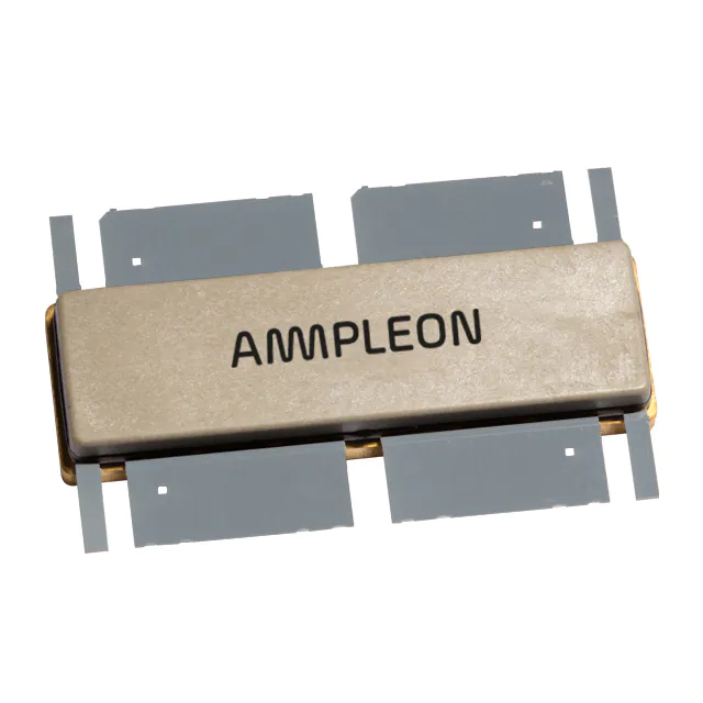

BLC8G27LS-240AV Power LDMOS transistor Rev. 5 — 2 December 2016 Product data sheet 1. Product profile 1.1 General description 240 W LDMOS packaged asymmetric Doherty power transistor for base station applications at frequencies from 2500 MHz to 2700 MHz. Table 1. Typical performance Typical RF performance at Tcase = 25 C in an asymmetrical Doherty demo board. VDS = 28 V; IDq = 500 mA (main); VGS(amp)peak = 0.5 V, unless otherwise specified. Test signal 1-carrier W-CDMA [1] f VDS PL(AV) Gp D ACPR (MHz) (V) (W) (dB) (%) (dBc) 2500 to 2690 28 56 14.5 43 35 [1] Test signal: 3GPP test model 1; 64 DPCH; PAR = 7.2 dB at 0.01% probability on CCDF per carrier. 1.2 Features and benefits           Excellent ruggedness High-efficiency Low thermal resistance providing excellent thermal stability Designed for broadband operation (2500 MHz to 2700 MHz) Asymmetric design to achieve optimum efficiency across the band Lower output capacitance for improved performance in Doherty applications Designed for low memory effects providing excellent digital pre-distortion capability Internally matched for ease of use Integrated ESD protection Compliant to Directive 2002/95/EC, regarding Restriction of Hazardous Substances (RoHS) 1.3 Applications  RF power amplifiers for base stations and multi carrier applications in the 2500 MHz to 2700 MHz frequency range BLC8G27LS-240AV Power LDMOS transistor 2. Pinning information Table 2. Pinning Pin Description 1 drain2 (peak) 2 drain1 (main) 3 gate1 (main) 4 gate2 (peak) Simplified outline 6 9 2 2 1 6 7 3 [1] 5 source 6 video decoupling (main) 7 n.c. 7 3 4 5 8 4 8 9 1 8 n.c. 9 video decoupling (peak) [1] Graphic symbol aaa-009150 Connected to flange. 3. Ordering information Table 3. Ordering information Type number Package BLC8G27LS-240AV Name Description Version - plastic earless flanged cavity package; 8 leads SOT1252-1 4. Limiting values Table 4. Limiting values In accordance with the Absolute Maximum Rating System (IEC 60134). Symbol Parameter VDS Min Max Unit drain-source voltage - 65 V VGS(amp)main main amplifier gate-source voltage 0.5 +13 V VGS(amp)peak peak amplifier gate-source voltage 0.5 +13 V Tstg storage temperature 65 +150 C Tj junction temperature - 225 C [1] Conditions [1] Continuous use at maximum temperature will affect the reliability, for details refer to the online MTF calculator. 5. Thermal characteristics Table 5. Thermal characteristics Symbol Parameter Rth(j-c) BLC8G27LS-240AV Product data sheet thermal resistance from junction to case Conditions Typ Unit VDS = 28 V; IDq = 500 mA (main); VGS(amp)peak = 0.5 V; Tcase = 80 C; PL = 56 W 0.3 K/W All information provided in this document is subject to legal disclaimers. Rev. 5 — 2 December 2016 © Ampleon Netherlands B.V. 2016. All rights reserved. 2 of 15 BLC8G27LS-240AV Power LDMOS transistor 6. Characteristics Table 6. DC characteristics Tj = 25 C unless otherwise specified. Symbol Parameter Conditions Min Typ Max Unit 65 - - V Main device V(BR)DSS drain-source breakdown voltage VGS = 0 V; ID = 1.8 mA VGS(th) gate-source threshold voltage VDS = 10 V; ID = 180 mA 1.5 1.9 2.3 V VGSq gate-source quiescent voltage VDS = 28 V; ID = 540 mA 1.6 2.1 2.4 V IDSS drain leakage current VGS = 0 V; VDS = 28 V - - 2.8 A IDSX drain cut-off current VGS = VGS(th) + 3.75 V; VDS = 10 V - 30 - A IGSS gate leakage current VGS = 11 V; VDS = 0 V - - 280 nA gfs forward transconductance VDS = 10 V; ID = 180 mA - 1.63 - S RDS(on) drain-source on-state resistance VGS = VGS(th) + 3.75 V; ID = 6.3 A - 83 m 135 Peak device 65 - - V VGS(th) V(BR)DSS drain-source breakdown voltage VGS = 0 V; ID = 2.2 mA gate-source threshold voltage VDS = 10 V; ID = 220 mA 1.5 1.9 2.3 V VGSq gate-source quiescent voltage VDS = 28 V; ID = 660 mA 1.6 2.1 2.4 V IDSS drain leakage current VGS = 0 V; VDS = 28 V - - 2.8 A IDSX drain cut-off current VGS = VGS(th) + 3.75 V; VDS = 10 V - 40 - A IGSS gate leakage current VGS = 11 V; VDS = 0 V - - 28 nA gfs forward transconductance VDS = 10 V; ID = 220 mA - 1.94 - S RDS(on) drain-source on-state resistance VGS = VGS(th) + 3.75 V; ID = 7.7 A - 68 m 112 Table 7. RF characteristics Test signal: 1-carrier W-CDMA; PAR = 7.2 dB at 0.01 % probability on the CCDF; 3GPP test model 1; 1 to 64 DPCH; f1 = 2500 MHz; f2 = 2690 MHz; RF performance at VDS = 28 V; IDq = 500 mA (main); VGS(amp)peak = 0.5 V; Tcase = 25 C; unless otherwise specified; in an asymmetrical Doherty production test circuit in 2500 MHz to 2690 MHz. BLC8G27LS-240AV Product data sheet Symbol Parameter Conditions Min Typ Max Unit Gp power gain PL(AV) = 56 W 12.8 14 - dB RLin input return loss PL(AV) = 56 W - 10 6 dB D drain efficiency PL(AV) = 56 W 32 37 - % ACPR adjacent channel power ratio PL(AV) = 56 W - 25 20 dBc All information provided in this document is subject to legal disclaimers. Rev. 5 — 2 December 2016 © Ampleon Netherlands B.V. 2016. All rights reserved. 3 of 15 BLC8G27LS-240AV Power LDMOS transistor 7. Test information 7.1 Ruggedness in class-AB operation The BLC8G27LS-240AV is capable of withstanding a load mismatch corresponding to VSWR = 10 : 1 through all phases under the following conditions: VDS = 28 V; IDq = 500 mA (main); VGS(amp)peak = VGS - 1 V (VGS: IDq at 750 mA); PL = 200 W (CW); f = 2500 MHz. 7.2 Impedance information Table 8. Typical impedance of main device Measured load-pull data of main device; IDq = 1000 mA; VDS = 28 V. Typical values unless otherwise specified. f ZS[1] ZL[1] PL[2] D[2] Gp[2] (MHz) () () (W) (%) (dB) Maximum power load 2500 2.7  j4.1 1.0  j4.5 197 53.5 13.1 2600 2.7  j5.2 1.0  j4.5 196 53.5 14.1 2700 2.9  j4.3 1.0  j4.5 186 54.3 15.7 Maximum drain efficiency load 2500 2.7  j4.1 1.7  j3.9 159 62.6 15.2 2600 2.7  j5.2 1.5  j3.7 144 61.2 16.5 2700 2.9  j4.3 1.4  j4.1 149 58.5 17.2 [1] ZS and ZL defined in Figure 1. [2] at 3 dB gain compression. Table 9. Typical impedance of peak device Measured load-pull data of peak device; IDq = 1230 mA; VDS = 28 V. Typical values unless otherwise specified. f ZS[1] ZL[1] PL[2] D[2] Gp[2] (MHz) () () (W) (%) (dB) 256 53.3 13.7 Maximum power load 2500 2.5  j5.6 2.1  j4.9 2600 3.9  j5.1 2.1 j4.9 254 53.8 14.4 2700 3.4  j4.2 2.6  j5.1 240 53.3 15.9 187 62.1 16.0 Maximum drain efficiency load BLC8G27LS-240AV Product data sheet 2500 2.5  j5.6 2.0  j2.9 2600 3.9  j5.1 1.8 j3.1 177 60.4 16.9 2700 3.4  j4.2 1.8  j3.5 174 59.5 18.1 [1] ZS and ZL defined in Figure 1. [2] at 3 dB gain compression. All information provided in this document is subject to legal disclaimers. Rev. 5 — 2 December 2016 © Ampleon Netherlands B.V. 2016. All rights reserved. 4 of 15 BLC8G27LS-240AV Power LDMOS transistor drain ZL gate ZS 001aaf059 Fig 1. Definition of transistor impedance 7.3 VBW in Doherty operation The BLC8G27LS-240AV shows 110 MHz (typical) video band-width in Doherty demo board in 2600 MHz at VDS = 28 V; IDq = 500 mA and VGS(amp)peak = 0.5 V. 7.4 Test circuit 50 mm 50 mm C1 C21 C2 C8 C9 C10 C12 C11 R2 C13 C3 C14 80 mm C4 C15 R3 C5 R1 C16 C18 C6 C19 C20 C17 C22 C7 aaa-015170 Printed-Circuit Board (PCB): Rogers RO4350B with a thickness of 0.508 mm. See Table 10 for a list of components. Fig 2. BLC8G27LS-240AV Product data sheet Component layout All information provided in this document is subject to legal disclaimers. Rev. 5 — 2 December 2016 © Ampleon Netherlands B.V. 2016. All rights reserved. 5 of 15 BLC8G27LS-240AV Power LDMOS transistor Table 10. List of components For test circuit see Figure 2. Component Description Value Remarks C1, C7 multilayer ceramic chip capacitor 0.1 F, 50 V Murata C2, C3, C4, C5, C6, C8, C9, C13, C14, C15, C19, C20 multilayer ceramic chip capacitor 22 pF ATC 600F Murata C10, C11, C12, C16, C17, C18 multilayer ceramic chip capacitor 4.7 F, 50 V C21, C22 electrolytic capacitor 2200 F, 63 V R1 resistor 50  R2, R3 chip resistor 9.1  SMD 0805 7.5 Graphical data 7.5.1 CW aaa-015171 18 80 Gp (dB) ηD (%) (1) (2) (3) 16 60 ηD 14 40 (1) (2) (3) 12 20 Gp 10 0 50 100 150 200 250 300 PL (W) 0 350 VDS = 28 V; IDq = 500 mA (main); VGS(amp)peak = 0.5 V. (1) f = 2500 MHz (2) f = 2600 MHz (3) f = 2690 MHz Fig 3. BLC8G27LS-240AV Product data sheet Power gain and drain efficiency as function of output power; typical values All information provided in this document is subject to legal disclaimers. Rev. 5 — 2 December 2016 © Ampleon Netherlands B.V. 2016. All rights reserved. 6 of 15 BLC8G27LS-240AV Power LDMOS transistor 7.5.2 CW pulsed aaa-015172 18 80 Gp (dB) ηD (%) (1) (2) (3) 16 60 ηD 14 40 (1) (2) (3) 12 20 Gp 10 0 50 100 150 200 250 300 350 PL (W) 0 400 VDS = 28 V; IDq = 500 mA (main); VGS(amp)peak = 0.5 V; tp = 100 s;  = 10 % (1) f = 2500 MHz (2) f = 2600 MHz (3) f = 2690 MHz Fig 4. Power gain and drain efficiency as function of output power; typical values 7.5.3 1-Carrier W-CDMA aaa-015173 17 50 ηD Gp (dB) (1) (2) (3) 15 (1) (2) (3) 13 ηD (%) 40 Gp aaa-015174 -20 ACPR5M (dBc) -25 (1) (2) -30 30 (3) -35 11 20 -40 9 10 7 0 20 40 60 80 100 120 PL (W) -45 0 140 -50 0 VDS = 28 V; IDq = 500 mA (main); VGS(amp)peak = 0.5 V. 20 40 (1) f = 2500 MHz (2) f = 2600 MHz (2) f = 2600 MHz (3) f = 2690 MHz Product data sheet 100 120 PL (W) 140 (3) f = 2690 MHz Power gain and drain efficiency as function of output power; typical values BLC8G27LS-240AV 80 VDS = 28 V; IDq = 500 mA (main); VGS(amp)peak = 0.5 V. (1) f = 2500 MHz Fig 5. 60 Fig 6. Adjacent channel power ratio (5 MHz) as a function of output power; typical values All information provided in this document is subject to legal disclaimers. Rev. 5 — 2 December 2016 © Ampleon Netherlands B.V. 2016. All rights reserved. 7 of 15 BLC8G27LS-240AV Power LDMOS transistor aaa-015175 10 PAR (dBc) 8 6 (1) (2) (3) 4 2 0 0 20 40 60 80 100 120 PL (W) 140 VDS = 28 V; IDq = 500 mA (main); VGS(amp)peak = 0.5 V. (1) f = 2500 MHz (2) f = 2600 MHz (3) f = 2690 MHz Fig 7. Peak-to-average ratio as a function of output power; typical values 7.5.4 2-Carrier W-CDMA aaa-015176 17 Gp (dB) (1) (2) (3) 16 60 ηD (%) ηD 15 aaa-015177 -20 ACPR5M (dBc) 50 (1) -24 (2) 40 -28 14 (3) 30 (1) (2) (3) 13 Gp -32 20 12 -36 10 11 0 20 40 60 80 100 120 PL (W) 0 140 -40 0 VDS = 28 V; IDq = 500 mA (main); VGS(amp)peak = 0.5 V. 20 40 (1) f = 2500 MHz (2) f = 2600 MHz (2) f = 2600 MHz (3) f = 2690 MHz (3) f = 2690 MHz Power gain and drain efficiency as function of output power; typical values BLC8G27LS-240AV Product data sheet 80 100 120 PL (W) 140 VDS = 28 V; IDq = 500 mA (main); VGS(amp)peak = 0.5 V. (1) f = 2500 MHz Fig 8. 60 Fig 9. Adjacent channel power ratio (5 MHz) as a function of output power; typical values All information provided in this document is subject to legal disclaimers. Rev. 5 — 2 December 2016 © Ampleon Netherlands B.V. 2016. All rights reserved. 8 of 15 BLC8G27LS-240AV Power LDMOS transistor 7.5.5 2-Tone VBW aaa-015178 -10 IMD (dBc) (1) (2) IMD3 -30 (1) (2) IMD5 -50 IMD7 (1) (2) -70 -90 1 10 102 Carrier Spacing (MHz) 103 VDS = 28 V; IDq = 500 mA (main); VGS(amp)peak = 0.5 V. (1) IMD low (2) IMD high Fig 10. VBW capability in Doherty demo board BLC8G27LS-240AV Product data sheet All information provided in this document is subject to legal disclaimers. Rev. 5 — 2 December 2016 © Ampleon Netherlands B.V. 2016. All rights reserved. 9 of 15 BLC8G27LS-240AV Power LDMOS transistor 8. Package outline Air cavity plastic earless flanged package; 8 leads SOT1252-1 D F A 5 w1 D1 v A U1 6 H B c B 2 1 y 9 U2 E1 E A 7 3 4 8 Q e w2 b1 b B e1 0 5 10 mm y scale 0.10 Dimensions Unit mm A max 4.65 nom min 4.18 b b1 c 1.37 11.78 0.20 D D1 31.44 31.34 E E1 9.60 9.50 e F H Q(1) 1.83 19.71 2.33 32.33 10.23 1.63 19.51 2.13 32.13 10.03 e1 U1 v w1 w2 0.50 0.50 0.50 13.72 29.46 1.17 11.58 0.10 31.04 31.14 9.20 9.30 Note 1. Dimension Q is measured 0.1 mm away from the flange. 2. Ringframe and/or ringframe glue shall not overhang at the side of the flange. Outline version U2 References IEC JEDEC JEITA sot1252-1_po European projection Issue date 15-06-09 16-10-04 SOT1252-1 Fig 11. Package outline SOT1252-1 BLC8G27LS-240AV Product data sheet All information provided in this document is subject to legal disclaimers. Rev. 5 — 2 December 2016 © Ampleon Netherlands B.V. 2016. All rights reserved. 10 of 15 BLC8G27LS-240AV Power LDMOS transistor 9. Handling information CAUTION This device is sensitive to ElectroStatic Discharge (ESD). Observe precautions for handling electrostatic sensitive devices. Such precautions are described in the ANSI/ESD S20.20, IEC/ST 61340-5, JESD625-A or equivalent standards. Table 11. ESD sensitivity ESD model Class Charged Device Model (CDM); According to ANSI/ESDA/JEDEC standard JS-002 C2A [1] Human Body Model (HBM); According to ANSI/ESDA/JEDEC standard JS-001 2 [2] [1] CDM classification C2A is granted to any part that passes after exposure to an ESD pulse of 500 V, but fails after exposure to an ESD pulse of 750 V. [2] HBM classification 2 is granted to any part that passes after exposure to an ESD pulse of 2000 V, but fails after exposure to an ESD pulse of 4000 V. 10. Abbreviations Table 12. BLC8G27LS-240AV Product data sheet Abbreviations Acronym Description 3GPP 3rd Generation Partnership Project CCDF Complementary Cumulative Distribution Function CW Continuous Wave DPCH Dedicated Physical CHannel ESD ElectroStatic Discharge LDMOS Laterally Diffused Metal-Oxide Semiconductor MTF Median Time to Failure PAR Peak-to-Average Ratio SMD Surface Mounted Device VBW Video Bandwidth VSWR Voltage Standing Wave Ratio W-CDMA Wideband Code Division Multiple Access All information provided in this document is subject to legal disclaimers. Rev. 5 — 2 December 2016 © Ampleon Netherlands B.V. 2016. All rights reserved. 11 of 15 BLC8G27LS-240AV Power LDMOS transistor 11. Revision history Table 13. Revision history Document ID Release date Data sheet status Change notice Supersedes BLC8G27LS-240AV v.5 20161202 Product data sheet - BLC8G27LS-240AV v.4 Modifications: • • Figure 11 on page 10: updated package outline drawing SOT1252-1 Section 9 on page 11: updated Handling information BLC8G27LS-240AV v.4 20150901 Product data sheet - BLC8G27LS-240AV v.3 BLC8G27LS-240AV v.3 20150728 Product data sheet - BLC8G27LS-240AV v.2 BLC8G27LS-240AV v.2 20150603 Product data sheet - BLC8G27LS-240AV v.1 BLC8G27LS-240AV v.1 20131104 Objective data sheet - - BLC8G27LS-240AV Product data sheet All information provided in this document is subject to legal disclaimers. Rev. 5 — 2 December 2016 © Ampleon Netherlands B.V. 2016. All rights reserved. 12 of 15 BLC8G27LS-240AV Power LDMOS transistor 12. Legal information 12.1 Data sheet status Document status[1][2] Product status[3] Definition Objective [short] data sheet Development This document contains data from the objective specification for product development. Preliminary [short] data sheet Qualification This document contains data from the preliminary specification. Product [short] data sheet Production This document contains the product specification. [1] Please consult the most recently issued document before initiating or completing a design. [2] The term ‘short data sheet’ is explained in section “Definitions”. [3] The product status of device(s) described in this document may have changed since this document was published and may differ in case of multiple devices. The latest product status information is available on the Internet at URL http://www.ampleon.com. 12.2 Definitions Draft — The document is a draft version only. The content is still under internal review and subject to formal approval, which may result in modifications or additions. Ampleon does not give any representations or warranties as to the accuracy or completeness of information included herein and shall have no liability for the consequences of use of such information. Short data sheet — A short data sheet is an extract from a full data sheet with the same product type number(s) and title. A short data sheet is intended for quick reference only and should not be relied upon to contain detailed and full information. For detailed and full information see the relevant full data sheet, which is available on request via the local Ampleon sales office. In case of any inconsistency or conflict with the short data sheet, the full data sheet shall prevail. Product specification — The information and data provided in a Product data sheet shall define the specification of the product as agreed between Ampleon and its customer, unless Ampleon and customer have explicitly agreed otherwise in writing. In no event however, shall an agreement be valid in which the Ampleon product is deemed to offer functions and qualities beyond those described in the Product data sheet. 12.3 Disclaimers Limited warranty and liability — Information in this document is believed to be accurate and reliable. However, Ampleon does not give any representations or warranties, expressed or implied, as to the accuracy or completeness of such information and shall have no liability for the consequences of use of such information. Ampleon takes no responsibility for the content in this document if provided by an information source outside of Ampleon. In no event shall Ampleon be liable for any indirect, incidental, punitive, special or consequential damages (including - without limitation - lost profits, lost savings, business interruption, costs related to the removal or replacement of any products or rework charges) whether or not such damages are based on tort (including negligence), warranty, breach of contract or any other legal theory. Notwithstanding any damages that customer might incur for any reason whatsoever, Ampleon’s aggregate and cumulative liability towards customer for the products described herein shall be limited in accordance with the Terms and conditions of commercial sale of Ampleon. Right to make changes — Ampleon reserves the right to make changes to information published in this document, including without limitation specifications and product descriptions, at any time and without notice. This document supersedes and replaces all information supplied prior to the publication hereof. Suitability for use — Ampleon products are not designed, authorized or warranted to be suitable for use in life support, life-critical or safety-critical systems or equipment, nor in applications where failure or malfunction of an BLC8G27LS-240AV Product data sheet Ampleon product can reasonably be expected to result in personal injury, death or severe property or environmental damage. Ampleon and its suppliers accept no liability for inclusion and/or use of Ampleon products in such equipment or applications and therefore such inclusion and/or use is at the customer’s own risk. Applications — Applications that are described herein for any of these products are for illustrative purposes only. Ampleon makes no representation or warranty that such applications will be suitable for the specified use without further testing or modification. Customers are responsible for the design and operation of their applications and products using Ampleon products, and Ampleon accepts no liability for any assistance with applications or customer product design. It is customer’s sole responsibility to determine whether the Ampleon product is suitable and fit for the customer’s applications and products planned, as well as for the planned application and use of customer’s third party customer(s). Customers should provide appropriate design and operating safeguards to minimize the risks associated with their applications and products. Ampleon does not accept any liability related to any default, damage, costs or problem which is based on any weakness or default in the customer’s applications or products, or the application or use by customer’s third party customer(s). Customer is responsible for doing all necessary testing for the customer’s applications and products using Ampleon products in order to avoid a default of the applications and the products or of the application or use by customer’s third party customer(s). Ampleon does not accept any liability in this respect. Limiting values — Stress above one or more limiting values (as defined in the Absolute Maximum Ratings System of IEC 60134) will cause permanent damage to the device. Limiting values are stress ratings only and (proper) operation of the device at these or any other conditions above those given in the Recommended operating conditions section (if present) or the Characteristics sections of this document is not warranted. Constant or repeated exposure to limiting values will permanently and irreversibly affect the quality and reliability of the device. Terms and conditions of commercial sale — Ampleon products are sold subject to the general terms and conditions of commercial sale, as published at http://www.ampleon.com/terms, unless otherwise agreed in a valid written individual agreement. In case an individual agreement is concluded only the terms and conditions of the respective agreement shall apply. Ampleon hereby expressly objects to applying the customer’s general terms and conditions with regard to the purchase of Ampleon products by customer. No offer to sell or license — Nothing in this document may be interpreted or construed as an offer to sell products that is open for acceptance or the grant, conveyance or implication of any license under any copyrights, patents or other industrial or intellectual property rights. Export control — This document as well as the item(s) described herein may be subject to export control regulations. Export might require a prior authorization from competent authorities. All information provided in this document is subject to legal disclaimers. Rev. 5 — 2 December 2016 © Ampleon Netherlands B.V. 2016. All rights reserved. 13 of 15 BLC8G27LS-240AV Power LDMOS transistor Non-automotive qualified products — Unless this data sheet expressly states that this specific Ampleon product is automotive qualified, the product is not suitable for automotive use. It is neither qualified nor tested in accordance with automotive testing or application requirements. Ampleon accepts no liability for inclusion and/or use of non-automotive qualified products in automotive equipment or applications. In the event that customer uses the product for design-in and use in automotive applications to automotive specifications and standards, customer (a) shall use the product without Ampleon’s warranty of the product for such automotive applications, use and specifications, and (b) whenever customer uses the product for automotive applications beyond Ampleon’s specifications such use shall be solely at customer’s own risk, and (c) customer fully indemnifies Ampleon for any liability, damages or failed product claims resulting from customer design and use of the product for automotive applications beyond Ampleon’s standard warranty and Ampleon’s product specifications. Translations — A non-English (translated) version of a document is for reference only. The English version shall prevail in case of any discrepancy between the translated and English versions. 12.4 Trademarks Notice: All referenced brands, product names, service names and trademarks are the property of their respective owners. Any reference or use of any ‘NXP’ trademark in this document or in or on the surface of Ampleon products does not result in any claim, liability or entitlement vis-à-vis the owner of this trademark. Ampleon is no longer part of the NXP group of companies and any reference to or use of the ‘NXP’ trademarks will be replaced by reference to or use of Ampleon’s own trademarks. 13. Contact information For more information, please visit: http://www.ampleon.com For sales office addresses, please visit: http://www.ampleon.com/sales BLC8G27LS-240AV Product data sheet All information provided in this document is subject to legal disclaimers. Rev. 5 — 2 December 2016 © Ampleon Netherlands B.V. 2016. All rights reserved. 14 of 15 BLC8G27LS-240AV Power LDMOS transistor 14. Contents 1 1.1 1.2 1.3 2 3 4 5 6 7 7.1 7.2 7.3 7.4 7.5 7.5.1 7.5.2 7.5.3 7.5.4 7.5.5 8 9 10 11 12 12.1 12.2 12.3 12.4 13 14 Product profile . . . . . . . . . . . . . . . . . . . . . . . . . . 1 General description . . . . . . . . . . . . . . . . . . . . . 1 Features and benefits . . . . . . . . . . . . . . . . . . . . 1 Applications . . . . . . . . . . . . . . . . . . . . . . . . . . . 1 Pinning information . . . . . . . . . . . . . . . . . . . . . . 2 Ordering information . . . . . . . . . . . . . . . . . . . . . 2 Limiting values. . . . . . . . . . . . . . . . . . . . . . . . . . 2 Thermal characteristics . . . . . . . . . . . . . . . . . . 2 Characteristics . . . . . . . . . . . . . . . . . . . . . . . . . . 3 Test information . . . . . . . . . . . . . . . . . . . . . . . . . 4 Ruggedness in class-AB operation . . . . . . . . . 4 Impedance information . . . . . . . . . . . . . . . . . . . 4 VBW in Doherty operation . . . . . . . . . . . . . . . . 5 Test circuit. . . . . . . . . . . . . . . . . . . . . . . . . . . . . 5 Graphical data . . . . . . . . . . . . . . . . . . . . . . . . . 6 CW . . . . . . . . . . . . . . . . . . . . . . . . . . . . . . . . . . 6 CW pulsed . . . . . . . . . . . . . . . . . . . . . . . . . . . . 7 1-Carrier W-CDMA . . . . . . . . . . . . . . . . . . . . . . 7 2-Carrier W-CDMA . . . . . . . . . . . . . . . . . . . . . . 8 2-Tone VBW . . . . . . . . . . . . . . . . . . . . . . . . . . . 9 Package outline . . . . . . . . . . . . . . . . . . . . . . . . 10 Handling information. . . . . . . . . . . . . . . . . . . . 11 Abbreviations . . . . . . . . . . . . . . . . . . . . . . . . . . 11 Revision history . . . . . . . . . . . . . . . . . . . . . . . . 12 Legal information. . . . . . . . . . . . . . . . . . . . . . . 13 Data sheet status . . . . . . . . . . . . . . . . . . . . . . 13 Definitions . . . . . . . . . . . . . . . . . . . . . . . . . . . . 13 Disclaimers . . . . . . . . . . . . . . . . . . . . . . . . . . . 13 Trademarks. . . . . . . . . . . . . . . . . . . . . . . . . . . 14 Contact information. . . . . . . . . . . . . . . . . . . . . 14 Contents . . . . . . . . . . . . . . . . . . . . . . . . . . . . . . 15 Please be aware that important notices concerning this document and the product(s) described herein, have been included in section ‘Legal information’. © Ampleon Netherlands B.V. 2016. All rights reserved. For more information, please visit: http://www.ampleon.com For sales office addresses, please visit: http://www.ampleon.com/sales Date of release: 2 December 2016 Document identifier: BLC8G27LS-240AV
