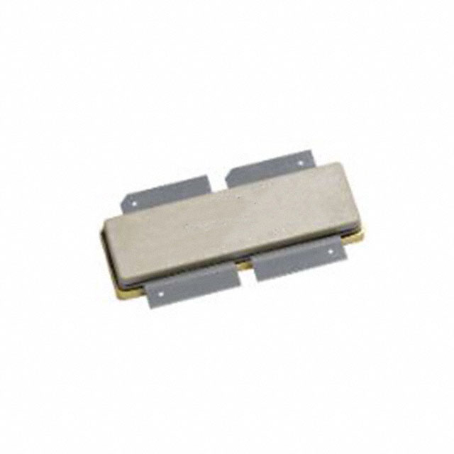

BLC2425M8LS300P Power LDMOS transistor Rev. 3 — 17 June 2016 Poduct data sheet 1. Product profile 1.1 General description 300 W LDMOS power transistor for Industrial, Scientific and Medical (ISM) applications at frequencies from 2400 MHz to 2500 MHz. The BLC2425M8LS300P is designed for high-power CW applications and is assembled in a high performance plastic package. Table 1. Typical performance RF performance at VDS = 32 V; IDq = 20 mA; Tcase = 25 C in a class-AB application circuit. f VDS PL(AV) Gp D (MHz) (V) (W) (dB) (%) CW 2450 32 300 17.0 58.0 CW pulsed [1] 2450 32 300 17.5 61.0 Test signal [1] tp = 100 s;  = 10 % 1.2 Features and benefits         High efficiency Easy power control Excellent ruggedness Excellent thermal stability Integrated ESD protection Designed for broadband operation (2400 MHz to 2500 MHz) Internally matched Compliant to Directive 2002/95/EC, regarding Restriction of Hazardous Substances (RoHS) 1.3 Applications  RF power amplifiers for CW applications in the 2400 MHz to 2500 MHz frequency range such as ISM applications and heating BLC2425M8LS300P Power LDMOS transistor 2. Pinning information Table 2. Pinning Pin Description 1 drain1 2 drain2 3 gate1 4 gate2 flange Simplified outline 1 2 3 4 Graphic symbol 1 3 5 4 source 2 sym117 3. Ordering information Table 3. Ordering information Type number Package BLC2425M8LS300P Name Description Version - SOT1250-1 air cavity plastic earless flanged package; 4 leads 4. Limiting values Table 4. Limiting values In accordance with the Absolute Maximum Rating System (IEC 60134). Symbol Parameter Min Max Unit VDS drain-source voltage - 65 V VGS gate-source voltage 0.5 +13 V Tstg storage temperature 65 +150 C - 225 C [1] junction temperature Tj [1] Conditions Continuous use at maximum temperature will affect the reliability, for details refer to the online MTF calculator. 5. Thermal characteristics Table 5. Symbol Thermal characteristics Parameter Rth(j-case) thermal resistance from junction to case BLC2425M8LS300P Poduct data sheet Conditions Typ Unit Tcase = 80 C; PL = 300 W 0.2 K/W All information provided in this document is subject to legal disclaimers. Rev. 3 — 17 June 2016 © Ampleon Netherlands B.V. 2016. All rights reserved. 2 of 12 BLC2425M8LS300P Power LDMOS transistor 6. Characteristics Table 6. DC characteristics Tj = 25 C, per section; unless otherwise specified. Symbol Parameter Conditions Min Typ Max Unit V(BR)DSS drain-source breakdown voltage VGS = 0 V; ID = 2.2 mA 65 - - V VGS(th) gate-source threshold voltage VDS = 10 V; ID = 220 mA 1.5 1.9 2.3 V IDSS drain leakage current VGS = 0 V; VDS = 28 V - - 2.8 A IDSX drain cut-off current VGS = VGS(th) + 3.75 V; VDS = 10 V - 39 - A IGSS gate leakage current VGS = 11 V; VDS = 0 V - - 280 nA gfs forward transconductance VDS = 10 V; ID = 11 A - 16 - S RDS(on) drain-source on-state resistance VGS = VGS(th) + 3.75 V; ID = 7.7 A - 0.08 -  Table 7. RF characteristics Test signal: CW at 2450 MHz; RF performance at VDS = 32 V; IDq = 20 mA; Tcase = 25 C; unless otherwise specified; in a class-AB production test circuit. Symbol Parameter Conditions Min Typ Max Gp power gain PL = 300 W 16.3 17.5 - dB RLin input return loss PL = 300 W - 14 dB D drain efficiency PL = 300 W 49 54.5 - 7 Unit % 7. Test information 7.1 Ruggedness in class-AB operation The BLC2425M8LS300P is capable of withstanding a load mismatch corresponding to VSWR = 10 : 1 through all phases under the following conditions: VDS = 32 V; IDq = 20 mA; PL = 300 W (CW); f = 2450 MHz. 7.2 Impedance information Table 8. Typical impedance Measured load-pull data half device. Typical values unless otherwise specified. IDq = 20 mA; VDS = 32 V. f ZS [1] ZL [1] (MHz) () () 2400 1.2  5.9j 3.7  2.8j 2450 1.3  5.0j 3.2  2.5j 2500 3.3  7.0j 3.1  2.3j [1] BLC2425M8LS300P Poduct data sheet ZS and ZL defined in Figure 1. All information provided in this document is subject to legal disclaimers. Rev. 3 — 17 June 2016 © Ampleon Netherlands B.V. 2016. All rights reserved. 3 of 12 BLC2425M8LS300P Power LDMOS transistor drain 1 gate 1 ZS ZL gate 2 drain 2 Fig 1. 001aak544 Definition of transistor impedance 7.3 Test circuit 40 mm 40 mm C12 C4 C5 C2 C20 C16 R3 C17 C11 C9 R1 C1 60 mm C18 C19 C8 C10 C6 C7 C3 R2 C13 C15 C14 C21 aaa-016352 Printed-Circuit Board (PCB): Rogers RT/Duroid 6035HTC; thickness = 0.762 mm; thickness copper plating = 35 m. See Table 9 for a list of components. Fig 2. Component layout for production test circuit Table 9. List of components See Figure 2 for component layout. BLC2425M8LS300P Poduct data sheet Component Description Value Remarks C1, C2, C3, C12, C13 multilayer ceramic chip capacitor 36 pF ATC 800B C4, C6, C15, C17 multilayer ceramic chip capacitor 10 F, 50 V C5, C7, C14, C16 multilayer ceramic chip capacitor 470 nF, 50 V C8, C9 multilayer ceramic chip capacitor 1.4 pF ATC 100B C10, C11 multilayer ceramic chip capacitor 1.8 pF ATC 100B C18, C19 multilayer ceramic chip capacitor 24 pF ATC 800R All information provided in this document is subject to legal disclaimers. Rev. 3 — 17 June 2016 © Ampleon Netherlands B.V. 2016. All rights reserved. 4 of 12 BLC2425M8LS300P Power LDMOS transistor Table 9. List of components …continued See Figure 2 for component layout. Component Description Value Remarks C20, C21 electrolytic capacitor 470 F, 63 V R1 resistor 9.1  SMD 0805 R2, R3 resistor 5.1  SMD 0805 7.4 Graphical data aaa-016346 20 70 Gp (dB) 19 ηD 18 aaa-016347 35 ηD (%) Gp (dB) ηD (1) (2) (3) 16 30 50 25 40 20 30 15 30 20 10 20 50 52 54 10 5 (1) (1) (2) (2) (3) (3) 56 PL (dBm) 58 0 VDS = 32 V; IDq = 20 mA. 100 (1) f = 2400 MHz (2) f = 2450 MHz (2) f = 2450 MHz (3) f = 2500 MHz (3) f = 2500 MHz Power gain and drain efficiency as function of output power; typical values BLC2425M8LS300P Poduct data sheet 200 300 400 PL (dBm) 10 500 VDS = 32 V; IDq = 20 mA. (1) f = 2400 MHz Fig 3. 40 Gp 14 48 60 50 Gp 15 46 ηD (%) 60 (1) (2) (3) 17 70 Fig 4. Power gain and drain efficiency as function of output power; typical values All information provided in this document is subject to legal disclaimers. Rev. 3 — 17 June 2016 © Ampleon Netherlands B.V. 2016. All rights reserved. 5 of 12 BLC2425M8LS300P Power LDMOS transistor aaa-016348 57 PL (dBm) 55 aaa-016349 65 ηD (%) 61 53 57 51 53 (3) (2) (1) 49 49 47 45 25 30 35 40 Pi (dBm) 45 2300 45 VDS = 32 V; IDq = 20 mA. 2350 2400 2450 2500 2550 f (MHz) 2600 VDS = 32 V; IDq = 20 mA. (1) f = 2400 MHz (2) f = 2450 MHz (3) f = 2500 MHz Fig 5. Output power as a function of input power; typical values Fig 6. aaa-016350 22 aaa-016351 19 Gp (dB) RLin (dB) 20 17 18 15 16 13 14 11 12 9 10 2300 2350 2400 2450 2500 2550 f (MHz) 7 2300 2600 VDS = 32 V; IDq = 20 mA. Fig 7. Drain efficiency as a function of frequency; typical values Poduct data sheet 2400 2450 2500 2550 f (MHz) 2600 VDS = 32 V; IDq = 20 mA. Power gain as a function of frequency; typical values BLC2425M8LS300P 2350 Fig 8. Input return loss as a function of frequency; typical values All information provided in this document is subject to legal disclaimers. Rev. 3 — 17 June 2016 © Ampleon Netherlands B.V. 2016. All rights reserved. 6 of 12 BLC2425M8LS300P Power LDMOS transistor aaa-018747 500 PL (W) 450 400 350 300 250 2300 2350 2400 2450 2500 2550 f (MHz) 2600 VDS = 32 V; IDq = 20 mA. Fig 9. Output power as a function of frequency; typical values BLC2425M8LS300P Poduct data sheet All information provided in this document is subject to legal disclaimers. Rev. 3 — 17 June 2016 © Ampleon Netherlands B.V. 2016. All rights reserved. 7 of 12 BLC2425M8LS300P Power LDMOS transistor 8. Package outline Plastic earless flanged cavity package; 4 leads SOT1250-1 D F A 5 w1 D1 v B A U1 B c H1 1 H y 2 U2 E1 A 3 E 4 w2 b1 B Q e 0 5 10 mm scale Dimensions (mm dimensions are derived from the original inch dimension) Unit mm A max 4.65 nom min 4.18 b1 c 11.79 0.18 D D1 31.44 31.34 E E1 9.60 9.50 e F H H1 Q(1) U1 U2 1.83 16.71 25.50 2.33 32.33 10.23 1.63 16.51 25.30 2.13 32.13 10.03 w1 w2 y 0.50 0.50 0.50 0.10 13.72 11.58 0.13 31.04 31.14 9.20 9.30 Note 1. Dimension Q is measured 0.1 mm away from the flange. 2. Ringframe and/or ringframe glue shall not overhang at the side of the flange. Outline version v References IEC JEDEC JEITA sot1250-1_po European projection Issue date 13-09-03 16-05-20 SOT1250-1 Fig 10. Package outline SOT1250-1 BLC2425M8LS300P Poduct data sheet All information provided in this document is subject to legal disclaimers. Rev. 3 — 17 June 2016 © Ampleon Netherlands B.V. 2016. All rights reserved. 8 of 12 BLC2425M8LS300P Power LDMOS transistor 9. Handling information CAUTION This device is sensitive to ElectroStatic Discharge (ESD). Observe precautions for handling electrostatic sensitive devices. Such precautions are described in the ANSI/ESD S20.20, IEC/ST 61340-5, JESD625-A or equivalent standards. 10. Abbreviations Table 10. Abbreviations Acronym Description CW Continuous Wave ESD ElectroStatic Discharge LDMOS Laterally Diffused Metal-Oxide Semiconductor MTF Median Time to Failure SMD Surface Mounted Device VSWR Voltage Standing-Wave Ratio 11. Revision history Table 11. Revision history Document ID Release date Data sheet status Change notice Supersedes BLC2425M8LS300P v.3 20160617 Product data sheet - BLC2425M8LS300P#2 Modifications • • Table 7 on page 3: table updated Figure 10 on page 8: figure updated BLC2425M8LS300P#2 20150901 Objective data sheet - BLC2425M8LS300P v.1 BLC2425M8LS300P v.1 20150703 Objective data sheet - - BLC2425M8LS300P Poduct data sheet All information provided in this document is subject to legal disclaimers. Rev. 3 — 17 June 2016 © Ampleon Netherlands B.V. 2016. All rights reserved. 9 of 12 BLC2425M8LS300P Power LDMOS transistor 12. Legal information 12.1 Data sheet status Document status[1][2] Product status[3] Definition Objective [short] data sheet Development This document contains data from the objective specification for product development. Preliminary [short] data sheet Qualification This document contains data from the preliminary specification. Product [short] data sheet Production This document contains the product specification. [1] Please consult the most recently issued document before initiating or completing a design. [2] The term ‘short data sheet’ is explained in section “Definitions”. [3] The product status of device(s) described in this document may have changed since this document was published and may differ in case of multiple devices. The latest product status information is available on the Internet at URL http://www.ampleon.com. 12.2 Definitions Draft — The document is a draft version only. The content is still under internal review and subject to formal approval, which may result in modifications or additions. Ampleon does not give any representations or warranties as to the accuracy or completeness of information included herein and shall have no liability for the consequences of use of such information. Short data sheet — A short data sheet is an extract from a full data sheet with the same product type number(s) and title. A short data sheet is intended for quick reference only and should not be relied upon to contain detailed and full information. For detailed and full information see the relevant full data sheet, which is available on request via the local Ampleon sales office. In case of any inconsistency or conflict with the short data sheet, the full data sheet shall prevail. Product specification — The information and data provided in a Product data sheet shall define the specification of the product as agreed between Ampleon and its customer, unless Ampleon and customer have explicitly agreed otherwise in writing. In no event however, shall an agreement be valid in which the Ampleon product is deemed to offer functions and qualities beyond those described in the Product data sheet. 12.3 Disclaimers Limited warranty and liability — Information in this document is believed to be accurate and reliable. However, Ampleon does not give any representations or warranties, expressed or implied, as to the accuracy or completeness of such information and shall have no liability for the consequences of use of such information. Ampleon takes no responsibility for the content in this document if provided by an information source outside of Ampleon. In no event shall Ampleon be liable for any indirect, incidental, punitive, special or consequential damages (including - without limitation - lost profits, lost savings, business interruption, costs related to the removal or replacement of any products or rework charges) whether or not such damages are based on tort (including negligence), warranty, breach of contract or any other legal theory. Notwithstanding any damages that customer might incur for any reason whatsoever, Ampleon’s aggregate and cumulative liability towards customer for the products described herein shall be limited in accordance with the Terms and conditions of commercial sale of Ampleon. Right to make changes — Ampleon reserves the right to make changes to information published in this document, including without limitation specifications and product descriptions, at any time and without notice. This document supersedes and replaces all information supplied prior to the publication hereof. Suitability for use — Ampleon products are not designed, authorized or warranted to be suitable for use in life support, life-critical or safety-critical systems or equipment, nor in applications where failure or malfunction of an BLC2425M8LS300P Poduct data sheet Ampleon product can reasonably be expected to result in personal injury, death or severe property or environmental damage. Ampleon and its suppliers accept no liability for inclusion and/or use of Ampleon products in such equipment or applications and therefore such inclusion and/or use is at the customer’s own risk. Applications — Applications that are described herein for any of these products are for illustrative purposes only. Ampleon makes no representation or warranty that such applications will be suitable for the specified use without further testing or modification. Customers are responsible for the design and operation of their applications and products using Ampleon products, and Ampleon accepts no liability for any assistance with applications or customer product design. It is customer’s sole responsibility to determine whether the Ampleon product is suitable and fit for the customer’s applications and products planned, as well as for the planned application and use of customer’s third party customer(s). Customers should provide appropriate design and operating safeguards to minimize the risks associated with their applications and products. Ampleon does not accept any liability related to any default, damage, costs or problem which is based on any weakness or default in the customer’s applications or products, or the application or use by customer’s third party customer(s). Customer is responsible for doing all necessary testing for the customer’s applications and products using Ampleon products in order to avoid a default of the applications and the products or of the application or use by customer’s third party customer(s). Ampleon does not accept any liability in this respect. Limiting values — Stress above one or more limiting values (as defined in the Absolute Maximum Ratings System of IEC 60134) will cause permanent damage to the device. Limiting values are stress ratings only and (proper) operation of the device at these or any other conditions above those given in the Recommended operating conditions section (if present) or the Characteristics sections of this document is not warranted. Constant or repeated exposure to limiting values will permanently and irreversibly affect the quality and reliability of the device. Terms and conditions of commercial sale — Ampleon products are sold subject to the general terms and conditions of commercial sale, as published at http://www.ampleon.com/terms, unless otherwise agreed in a valid written individual agreement. In case an individual agreement is concluded only the terms and conditions of the respective agreement shall apply. Ampleon hereby expressly objects to applying the customer’s general terms and conditions with regard to the purchase of Ampleon products by customer. No offer to sell or license — Nothing in this document may be interpreted or construed as an offer to sell products that is open for acceptance or the grant, conveyance or implication of any license under any copyrights, patents or other industrial or intellectual property rights. Export control — This document as well as the item(s) described herein may be subject to export control regulations. Export might require a prior authorization from competent authorities. All information provided in this document is subject to legal disclaimers. Rev. 3 — 17 June 2016 © Ampleon Netherlands B.V. 2016. All rights reserved. 10 of 12 BLC2425M8LS300P Power LDMOS transistor Non-automotive qualified products — Unless this data sheet expressly states that this specific Ampleon product is automotive qualified, the product is not suitable for automotive use. It is neither qualified nor tested in accordance with automotive testing or application requirements. Ampleon accepts no liability for inclusion and/or use of non-automotive qualified products in automotive equipment or applications. In the event that customer uses the product for design-in and use in automotive applications to automotive specifications and standards, customer (a) shall use the product without Ampleon’s warranty of the product for such automotive applications, use and specifications, and (b) whenever customer uses the product for automotive applications beyond Ampleon’s specifications such use shall be solely at customer’s own risk, and (c) customer fully indemnifies Ampleon for any liability, damages or failed product claims resulting from customer design and use of the product for automotive applications beyond Ampleon’s standard warranty and Ampleon’s product specifications. Translations — A non-English (translated) version of a document is for reference only. The English version shall prevail in case of any discrepancy between the translated and English versions. 12.4 Trademarks Notice: All referenced brands, product names, service names and trademarks are the property of their respective owners. Any reference or use of any ‘NXP’ trademark in this document or in or on the surface of Ampleon products does not result in any claim, liability or entitlement vis-à-vis the owner of this trademark. Ampleon is no longer part of the NXP group of companies and any reference to or use of the ‘NXP’ trademarks will be replaced by reference to or use of Ampleon’s own trademarks. 13. Contact information For more information, please visit: http://www.ampleon.com For sales office addresses, please visit: http://www.ampleon.com/sales BLC2425M8LS300P Poduct data sheet All information provided in this document is subject to legal disclaimers. Rev. 3 — 17 June 2016 © Ampleon Netherlands B.V. 2016. All rights reserved. 11 of 12 BLC2425M8LS300P Power LDMOS transistor 14. Contents 1 1.1 1.2 1.3 2 3 4 5 6 7 7.1 7.2 7.3 7.4 8 9 10 11 12 12.1 12.2 12.3 12.4 13 14 Product profile . . . . . . . . . . . . . . . . . . . . . . . . . . 1 General description . . . . . . . . . . . . . . . . . . . . . 1 Features and benefits . . . . . . . . . . . . . . . . . . . . 1 Applications . . . . . . . . . . . . . . . . . . . . . . . . . . . 1 Pinning information . . . . . . . . . . . . . . . . . . . . . . 2 Ordering information . . . . . . . . . . . . . . . . . . . . . 2 Limiting values. . . . . . . . . . . . . . . . . . . . . . . . . . 2 Thermal characteristics . . . . . . . . . . . . . . . . . . 2 Characteristics . . . . . . . . . . . . . . . . . . . . . . . . . . 3 Test information . . . . . . . . . . . . . . . . . . . . . . . . . 3 Ruggedness in class-AB operation . . . . . . . . . 3 Impedance information . . . . . . . . . . . . . . . . . . . 3 Test circuit. . . . . . . . . . . . . . . . . . . . . . . . . . . . . 4 Graphical data . . . . . . . . . . . . . . . . . . . . . . . . . 5 Package outline . . . . . . . . . . . . . . . . . . . . . . . . . 8 Handling information. . . . . . . . . . . . . . . . . . . . . 9 Abbreviations . . . . . . . . . . . . . . . . . . . . . . . . . . . 9 Revision history . . . . . . . . . . . . . . . . . . . . . . . . . 9 Legal information. . . . . . . . . . . . . . . . . . . . . . . 10 Data sheet status . . . . . . . . . . . . . . . . . . . . . . 10 Definitions . . . . . . . . . . . . . . . . . . . . . . . . . . . . 10 Disclaimers . . . . . . . . . . . . . . . . . . . . . . . . . . . 10 Trademarks. . . . . . . . . . . . . . . . . . . . . . . . . . . 11 Contact information. . . . . . . . . . . . . . . . . . . . . 11 Contents . . . . . . . . . . . . . . . . . . . . . . . . . . . . . . 12 Please be aware that important notices concerning this document and the product(s) described herein, have been included in section ‘Legal information’. © Ampleon Netherlands B.V. 2016. All rights reserved. For more information, please visit: http://www.ampleon.com For sales office addresses, please visit: http://www.ampleon.com/sales Date of release: 17 June 2016 Document identifier: BLC2425M8LS300P
