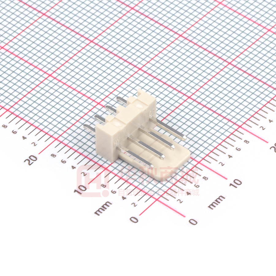

    插件,P=2.54mm
    线对板针座 1x4P 直插 间距:2.54mm
