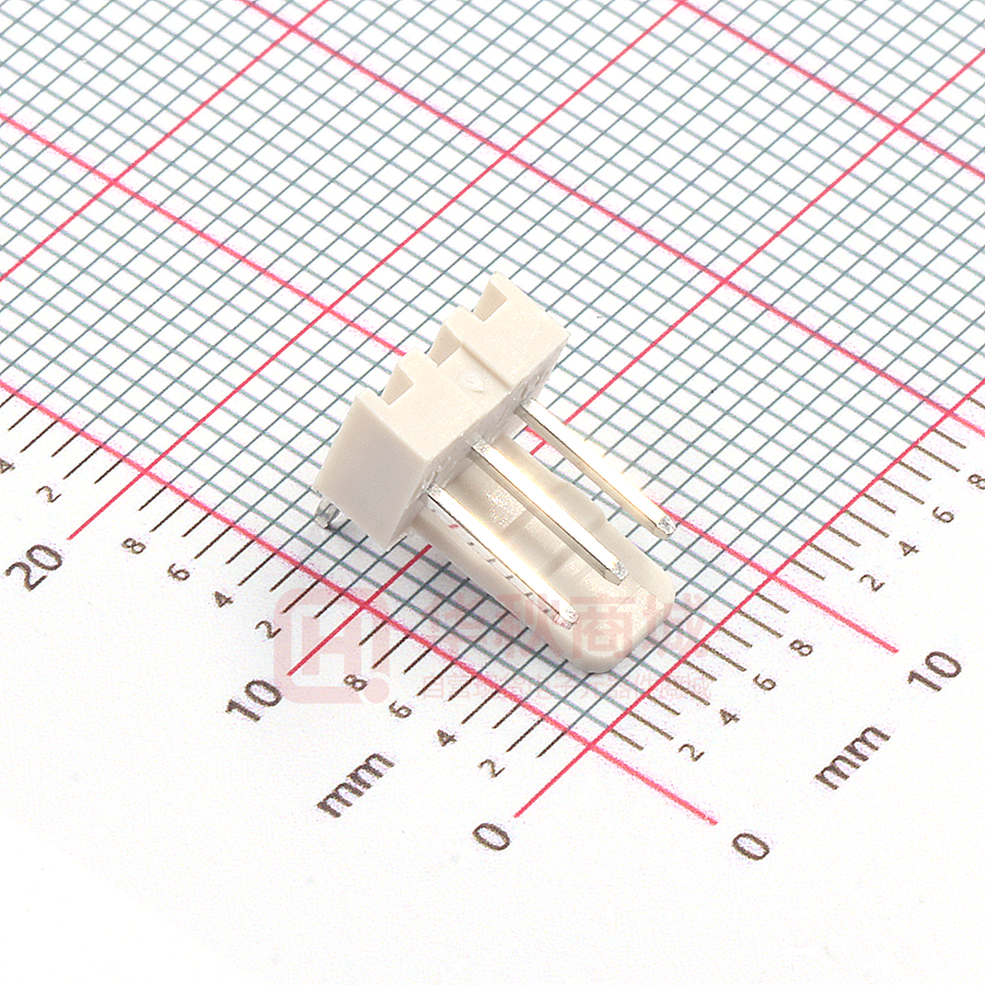

    弯插,P=2.54mm
    线对板针座 1x4P 弯插 间距:2.54mm
