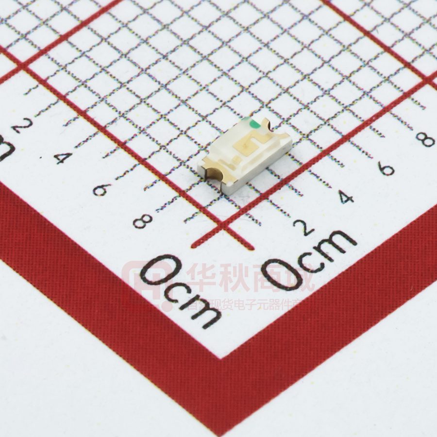

片式发光二极管
NCD1206G1
Chip Light Emitting Diode
技术数据表 Technical Data Sheet
本产品主要作为信号指示及照明的电子元件广泛应用于各类使用表面贴装结构的电子产品中,如家用电器的
开关指示灯、手机键盘灯、汽车仪表盘指示灯等。
This product is generally used as indicator and luminance for surface mounted electronic equipment, such as
household appliance, communication equipment, and dashboard.
特性: 管芯材料: InGaN
Material:
Features:
发光颜色:绿色
Emitting Color: Green
封装材料:环氧树脂
Encapsulation: Epoxy Resin
