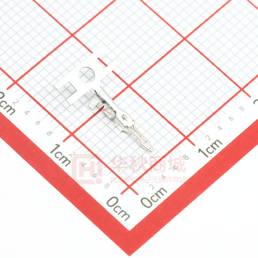

SCN CONNECTOR 2.5mm pitch/Board-in Crimp style connectors JS T Specifications ––––––––––––––––––– This 2.5mm pitch multi-circuit board-in connector meets the needs for high-density mounting on printed circuit boards efficiently and economically. The connector can be used for VCRs, car stereo systems, audio products, and many other consumer-oriented electronic products. • Housing lances • Secure mounting on printed circuit boards • Two types of contacts • Current rating: 3A AC, DC (AWG #22) • Voltage rating: 250V AC, DC • Temperature range: -25˚C to +85˚C (including temperature rise in applying electrical current) • Insulation resistance: 1,000M Ω min. • Withstanding voltage: 800V AC/minute • Applicable wire: AWG #28 to #22 • Applicable PC board thickness: 1.2mm, 1.6mm * Compliant with RoHS. * Refer to "General Instruction and Notice when using Terminals and Connectors" at the end of this catalog. * Contact JST for details. Standards –––––––––––––––––––––– 0 Recognized E60389 1 Certified LR20812 3.9 10.1 6.5 2 min 2.5 min 2.5 ± 0.05 2 1.6 (Note 2) 2.25 Note: 1. The above figure is the figure viewed from soldering side. 2. Applicable PC board thickness: Type A 1.6mm Type B 1.6mm and 1.2mm. 3. Tolerances are non-cumulative: ±0.05mm Type A: 1.0±0.05mm dia. Type B: 2 to 6 circuits/1.0±0.05mm dia. 7 circuits and more/Hole dimensions differ from the above values. Contact JST for details. 4. Hole dimensions differ according to the kind of PC board and piercing method. The dimensions above should serve as a guideline. Contact JST for details. 1 SCN CONNECTOR Contact 1.1 Type A 2 Model No. Type SCN-001T-P1.0 SCN-001T-1.0K A B Applicable wire mm2 AWG # 0.08∼0.33 9.8 Insulation O.D. Material Q’ty / reel (mm) Phosphor bronze 28∼22 0.9∼1.7 Brass 11,000 Finish Tin-plated (reflow treatment) RoHS compliance Note: 1. Contact JST if you require shielded wires, thin wires or other special wires. 2. Contact JST for brass products. Type B 1.15 Contact 1.8 Crimping machine Crimp applicator SCN-001T-P1.0 AP-K2N SCN-001T-1.0K 9.5 Applicator Dies Crimp applicator with dies MKS-L MK/SCN-001-10 APLMK SCN001-10 *MKS-SC SC/SCN-001-10 APLSC SCN001-10 Note: *Strip-crimp applicator Housing Circuits 2 3 3.9 4 6 1 14 15 16 5 7 8 6.5 9 10 11 12 13 2.5 14 A B 3.7 15 16 Model No. A 2P-SCN 3P-SCN 4P-SCN 5P-SCN 6P-SCN 7P-SCN 8P-SCN 9P-SCN 10P-SCN 11P-SCN 12P-SCN 13P-SCN 14P-SCN 15P-SCN 16P-SCN Dimensions (mm) B 2.5 6.5 1,000 5.0 9.0 1,000 7.5 11.5 1,000 10.0 14.0 1,000 12.5 16.5 1,000 15.0 19.0 1,000 17.5 21.5 1,000 20.0 24.0 1,000 22.5 26.5 1,000 25.0 29.0 1,000 27.5 31.5 1,000 30.0 34.0 1,000 32.5 36.5 1,000 35.0 39.0 1,000 37.5 41.5 1,000 Material PA 66, UL94V-0, ivory RoHS compliance As the color identification, the following alphabet shall be put in the underlined part. For availability, delivery and minimum order quantity, contact JST. ex. 2 2P-SCN-oo(blank)…ivory K…black R…red Y…yellow Q'ty / bag
