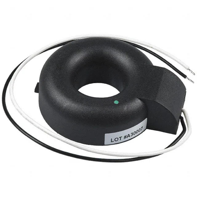

High Ratio Wire Lead Transformers CR Magnetics CR8400 Series of Wire Lead Current Transformers are available in a wide range of sizes and materials to meet any AC current sensing needs. Our General Purpose designs are made from the highest quality silicon steel cores available, and meet most of the common AC current measurement needs. Our Revenue Grade (-N) are made from a nickel alloy core which provides the most linear response over temperature and current level. A line of Ground Fault (-G) are for measuring low AC currents including electrical shields. Nanocrystalline (-A) is the most versatile providing accuracy, high saturation point and a linear response in high frequency applications. The High Frequency (-F) products are designed for high frequency applications such as high frequency power supplies and motor drives. GENERAL PURPOSE CURRENT TRANSFORMERS Ir Vmax RMS Te (typ.) DCR Ω Frequency CR8401-1000 10 2.2 1009 49 20 Hz- 1 KHz CR8410-1000 20 3.1 1012 41 20 Hz- 1 KHz CR8420-1000 50 5.2 1018 22 20 Hz- 1 KHz CR8420-2000 75 9.0 1983 90 20 Hz- 1 KHz CR8448-1000 30 6.3 990 26 20 Hz- 1 KHz CR8448-2000 50 13.7 2046 106 20 Hz- 1 KHz CR8449-1000 50 11.6 1016 35 20 Hz- 1 KHz CR8449-2000 75 23 2046 150 20 Hz- 1 KHz CR8450-1000 100 16.5 1021 21 20 Hz- 1 KHz CR8450-2000 200 32 2037 73 20 Hz- 1 KHz REVENUE GRADE CURRENT TRANSFORMERS Vmax RMS Te (typ.) DCR Ω Frequency 40 6.6 2510 134 20 Hz- 1 KHz 50 10.0 2490 187 20 Hz- 1 KHz CR8450-2500-N 75 12.0 2512 143 20 Hz- 1 KHz CR8459-2000-N 200 11.5 2011 74 20 Hz- 1 KHz Part Number Ir CR8448-2500-N CR8449-2500-N GROUND FAULT CURRENT TRANSFORMERS Part Number Ir Vmax RMS Te (typ.) DCR Ω Frequency CR8401-1000-G 4 0.6 1005 49 20 Hz- 1 KHz CR8410-1000-G 7 0.8 1007 38 20 Hz- 1 KHz CR8420-1000-G 20 1.4 1011 44 20 Hz- 1 KHz NANOCRYSTALLINE CURRENT TRANSFORMERS Part Number Ir Vmax RMS Te (typ.) DCR Ω Frequency CR8401-1000-A 4 2.2 1034 43 50 Hz- 50 KHz CR8410-1000-A 7 2.5 1015 39 50 Hz- 50 KHz CR8420-1000-A 20 1.3 1023 43 50 Hz- 50 KHz CR8420-2000-A 75 7.0 2010 89 50 Hz- 50 KHz CR8448-1000-A 20 6.0 1000 25 50 Hz- 50 KHz CR8448-2000-A 50 13.0 2000 103 50 Hz- 50 KHz CR8448-2500-A 50 16.0 2524 131 50 Hz- 50 KHz CR8449-1000-A 75 11.0 1002 35 50 Hz- 50 KHz CR8449-2000-A 75 16.0 2013 144 50 Hz- 50 KHz CR8449-2500-A 75 27.0 2501 182 50 Hz- 50 KHz CR8450-1000-A 100 15.0 1003 21 50 Hz- 50 KHz CR8450-2000-A 100 26.0 2000 72 50 Hz- 50 KHz CR8450-2500-A 100 28.0 2501 134 50 Hz- 50 KHz CR8459-2000-A 100 27.0 2001 73 50 Hz- 50 KHz HIGH FREQUENCY CURRENT TRANSFORMERS Part Number Ir Vmax RMS Te (typ.) DCR Ω Frequency CR8448-2000-F 50 3.9 2015 90 20 Hz - 200 KHz CR8449-2000-F 75 7.4 2017 109 20 Hz- 200 KHz CR8450-2000-F 100 8.5 2020 63 20 Hz- 200 KHz Applications Motor Load Measurement Power Meters High Frequency Current Sensing Ground Fault Sensing Features High Ratio Custom Lead Lengths Available Specifications Maximum Continuous Primary Current 4 X Ir Insulation Voltage 3500 Vac/1min Storage Temp. -45°C thru +85 °C Operating Temp. General Purpose & Nickel -40°C thru +85 °C Operating Temp. High Frequency -40°C thru +65 °C Regulatory Agencies I DCR VL = Vmax - R I x DCR Te V= For best linearity, choose R such that V < 0.8 VL VL Ir = Maximum AC Input Current to be linearly sensed Vmax = Maximum VAC (Saturation) CT will develop Te = Effective turns ratio including losses (+/- 10%) (All Specifications tested at 60 Hz) PACKAGE DIMENSIONS AND OUTLINE (mm/in) A B C D E min max max max Typ CR8420 6.99 .275 9.0 .35 15.0 .59 17.53 .690 22 .87 30.0 1.18 22.35 .880 27.8 1.09 36.0 1.41 8.26 .325 8.20 .323 9.2 .36 75.08 2.275 73 2.87 100 3.94 CR8448 7.11 .280 23.42 .922 29.46 1.16 11.05 .435 100 3.94 CR8449 9.14 .354 13.08 .515 19 .75 26.0 1.02 36.83 1.45 48 1.89 31.8 1.25 43.18 1.70 60 2.36 17.0 .67 13.97 .55 17.5 .67 100 3.94 88.9 3.50 200 7.88 Part Number Prefix CR8401 CR8410 CR8450 CR8459 The Professional Energy Monitoring Company M N TI ISO 9001:2008 Quality Management System I B D A C See Chart E 3500 Scarlet Oak Blvd. St. Louis MO USA 63122 V: 636-343-8518 F: 636-343-5119 Web: http://www.crmagnetics.com 95 -- E-mail: sales@crmagnetics.com V IxR Te Current Transformers Part Number CR8400 SERIES F

1. 物料型号:文档列出了多种型号的变压器,包括通用型、收入等级型(-N)、接地故障型(-G)、纳米晶型(-A)和高频型(-F)。
2. 器件简介:CR8400系列变压器适用于各种AC电流传感需求,包括电机负载测量、功率表、高频电流传感和接地故障传感。
3. 引脚分配:文档中没有提供具体的引脚分配图,但通常变压器会有初级和次级引脚。
4. 参数特性:包括最大AC输入电流、最大RMS值、典型温度系数(Te)、直流电阻(DCR)和工作频率范围。
5. 功能详解:文档详细描述了不同类型变压器的应用场景和特点,例如纳米晶型变压器适用于高频应用,而收入等级型变压器提供温度和电流水平上的线性响应。
6. 应用信息:适用于电机负载测量、功率表、高频电流传感和接地故障传感。
7. 封装信息:提供了不同型号变压器的封装尺寸和轮廓。
