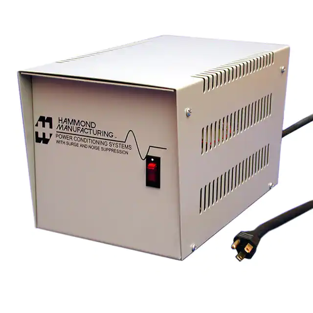

Quality Products. Service Excellence. Constant Voltage - AC Regulator (+/- 120VAC to 120VAC) CV Series Plug-In Note: This product line has been discontinued as a stocked series. Information is for reference only. For alternative solution assistance, please contact Hammond Customer Service - sales@hammfg.com or USA (716) 630-7030, Canada and International (519) 822-2960. Features AC regulating - protects against both brownouts & over voltage conditions. Protects against any power problem other than a blackout. Will operate through a 3 millisecond (minimum) blackout. Long life - ferroresonant design - no moving parts. Ferroresonant design also filters out surges, line harmonics, and RF noise. Input 120VAC (+10 % to -25 %), 60 Hz Output 120VAC (+/- 3 %). Provides circuit isolation. Noise Isolation (RF) of 120 db common mode, 60 db normal mode. Spike attenuation: 250:1 minimum. Sine wave output - total harmonic distortion (THD): 3 % Units also include a 2nd stage of high frequency filtering on the output - a Hammond Mfg. exclusive. Operating temperature range of -40 degrees C to +40 degrees C. Standard 3-wire, grounded plug & receptacle. Front panel lighted power switch. Input (primary) connected to an extra long 15 foot, heavy duty 14/3 SJTW cord for extreme temperature ranges. Integral molded, standard North American plug (NEMA 5-15P). Output (secondary) connected to a rear mounted, standard North American, grounded receptacle (NEMA 5-15R) - quantity depends on power capacity of unit (see table below). Rugged two piece ventilated steel enclosure. Finished in a grey/beige color, textured powder paint with rubber feet installed. NOTE 1: Due to the nature of ferroresonant designs - these units do produce audible noise. We have reduced this through careful design, but these units are NOT usable in an office environment. NOTE 2: These units provide complete isolation from the source voltage. In other words, the "neutral" output wire has no connection to ground, this is a UL requirement for this type of device. Therefore plug-in circuit testers & line "polarity" testing devices will NOT function on the output as it is completely isolated. North American Mark of Safety: C UL & UL listed (File #E211544). Indoor use only. Gallery Accessories International Grounded Adaptor Plugs Capacity Outlet Overall Dimensions Part No. VA Amps (RMS) Qty H CV120300 300 2.5 2 CV120600 600 5 4 CV1201200 1200 10 CV1201800 1800 15 Weight W D Lbs 7.00 7.13 12.30 25.3 9.00 10.13 19.50 48 4 9.00 10.13 19.50 74 6 12.00 12.13 20.50 95 Data subject to change without notice. © 2017. Hammond Manufacturing Ltd. All rights reserved.
