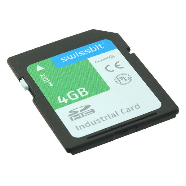

Product Fact Sheet Industrial SDHC Memory Card S-220 Series SPI, SDHC compliant, class 6 & 10 compliant S-220 Series SDHC Memory Card 1 Feature summary               Custom-designed, highly-integrated memory controller o Fully compliant with SD Memory Card specification 2.0 o Four integrated 4KByte Sector Buffers for fast data transfer o SPI Mode support Standard SD Memory Card form factor o 32.0mm x 24.0mm x 2.1mm o Write Protect slider 2.7…3.6V normal operating voltage 2.0…3.6V basic communication (CMD0, 15, 55 ACMD41) voltage Low-power CMOS technology Patented power-off reliability o No data loss of older sectors o Max. 32 sectors data loss (old data kept) if power off during writing before card status is ready Wear Leveling: equal wear leveling of static and dynamic data The wear leveling assures that dynamic data as well as static data is balanced evenly across the memory. With that the maximum write endurance of the device is guaranteed. Write Endurance: Due to intelligent wear leveling an even use of the entire flash is guaranteed, regardless how much “static” (OS) data is stored. Example: If the average file size is 10MByte and the total capacity is 8GByte, 80Mio write cycles can be performed. High reliability o Best available SLC NAND Flash technology o Designed for embedded market o MTBF > 4,000,000 hours o Number of card insertions/removals: >10,000 o Extended Temperature range -25° up to 85°C o Optional industrial Temperature range available -40° up to 85°C Hot swappable High performance o SD burst up to 25MB/s o SD Low speed 0…25MHz clock rate o SD High speed 25…50MHz clock rate o 2 channel flash o Flash burst up to 40MB/s per channel o Swissbit S-220 SDHC memory cards are specified as SD 2.0 compliant. o Compliant with the highest speed “class 6” according SD2.0 2.0 standard & speed “class 10” as defined in SD Specification 3.0. Available densities o 4GByte and 8GBytes (lower densities are in the SDHC S-200 Series) Controlled BOM Life Time Monitoring SD/SPI with standard or vendor commands Swissbit AG Industriestrasse 4 CH-9552 Bronschhofen Switzerland Revision: 1.22 www.swissbit.com industrial@swissbit.com S-220_fact_sheet_SD-LxBN_Rev122 Page 2 of 3 System Performance System Performance Burst Data transfer Rate (max clock 50MHz) Sustained Sequential Read Sustained Sequential Write typ 4/8GB 4/8GB Current Consumption @3.3V Write Read Sleep Mode 19 17 max 25 21 18 typ 80 45 0.3 max 90 60 0.4 Unit MB/s Unit mA Physical Dimensions Physical Dimensions Length Width Thickness Weight (typ.) Value 32.00±0.10 24.00±0.10 2.10±0.15 2 Unit mm g Recommended Temperature Conditions Parameter min typ max Unit Extended Operating Temperature Industrial Operating Temperature Storage Temperature -25 -40 -40 25 25 25 85 85 100 °C °C °C Humidity and ESD Parameter Humidity (non-condensing) ESD according to IEC61000-4-2 Human body model ±4 kV 100 pf/1.5 kOhm Machine model ±0.25 kV 200 pf/0 Ohm Operating Non Operating max 95% Non Contact Pads area: ±8 kV (coupling plane discharge) ±15 kV (air discharge) Human body model according to IEC61000-4-2 Contact Pads: ±4 kV, Human body model according to IEC61000-4-2 Durability Parameter Salt water spray Solar Exposure / Impermeability UV Light Exposure Insertions / Drop test Bending / Torque / Bump Shock / Vibration (peak -to-peak) Minimum moving force of WP slider Operating Non Operating 3% NaCI/35°C; 24h acc. MIL STD Method 1009 1000W/m2 @ 40o°C / IP67 UV: 254nm, 15Ws/cm2 >10,000/ 1.5m free fall 10N / 0.15Nm or ±2.5deg / 25g; 6ms; ±3 x 4000 shocks 1000 g max. / 15G max. 0.4N For more information on SD Memory card Spec 2.0, please visit SD association (www.sdcard.org) Why Swissbit? Swissbit strives to create innovative technologies for future market opportunities utilizing a highly skilled inhouse product research and development team. Swissbit maintains a marketing edge by continuing to manufacture world-class high quality memory products and providing customers with both high value and low cost of ownership achieved through efficient processes and procedures. Swissbit AG Industriestrasse 4 CH-9552 Bronschhofen Switzerland Revision: 1.22 www.swissbit.com industrial@swissbit.com S-220_fact_sheet_SD-LxBN_Rev122 Page 3 of 3
