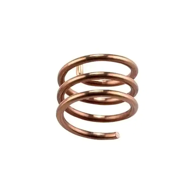

SPECIFICATION Part No. : HA.31.A Description : 915MHz 2dBi Embedded Helical Monopole Antenna Features : Quarter wave-length Monopole Helical Antenna 915MHz ISM Band 2dBi peak gain and 68% efficiency Direct mounted on board design Mechanically sturdy in a compact size Dimensions: 10.7mm, Ø10.2mm RoHS compliant DSP-15-8- SPE-16-8-017/C/WY Page 1 of 24 1. Introduction The HA.31.A is an ISM 915MHz quarter wave-length monopole antenna. This helical coil antenna is perfect for your smart meter, smart security system, remote asset monitoring, and other wireless communication devices. The helical coil antenna has a 2dBi Peak gain and a 68% efficiency at 915MHz on a 126.8 x 80.1mm ground plane with matching components (orthogonally mounted to ground plane, see HAD.B.31 performance). Made of copper alloy, the helical coil is mechanically sturdy, with a wide-bandwidth. It can be easily mounted on the surface of your device main board by soldering. The antenna must be connected to a ground-plane to radiate efficiently. DSP-15-8- SPE-16-8-017/C/WY Page 2 of 24 Taoglas provides HAD.A.31 and HAD.B.31 evaluation boards to show performance when two antennas are parallel mounted or orthogonally mounted to the ground plane. Small embedded antennas can easily detune and/or have reduced efficiency in different device environments. Taoglas provides matching, and other custom tuning, design and support services, subject to MOQ and NRE. Contact a regional Taoglas facility for details. DSP-15-8- SPE-16-8-017/C/WY Page 3 of 24 2. Specification ELECTRICAL Application Bands ISM 915MHz Mounting Direction Frequency (MHz) HAD.A.31 902 915 HAD.B.31 928 Return Loss (dB) 902 915 928
