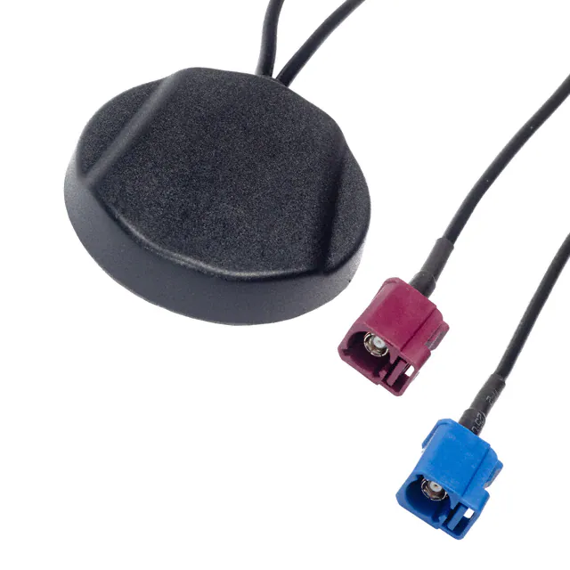

Underside View Top View (this side faces the passenger) (this side faces the sky) Stingray MA203w.AB.009 Specification Part No. MA.203w.AB.009 Product Name Stingray GPS/Penta-band Cellular Adhesive Antenna Feature High gain LNA up to 32dB (GSM/CDMA/PCS/DCS/UMTS/GPRS/EDGE/ HSPA) Height 10.8mm Diameter 55.1mm Waterproof IP67 Version ROHS Compliant SPE-13-8-021/B/SS | page 1 of 11 MA.203W.A.A301621.B301721 1. Introduction This is a combination high performance GPS and Penta-band Cellular (GSM/CDMA/ PCS/DCS/ / UMTS / GPRS / EDGE/ HSPA) antenna to simplify AVL or Fleet management antenna systems worldwide. Its high quality low profile covert housing can be attached onto the glass or even out of sight under the dashboard. This combination of a high gain GPS antenna and a leading edge penta band cellular antenna is ideal for those applications that require durability, small size and covert installation, and reliable reception and transmission crossing through different mobile networks. 1.1 Features GPS High LNA Gain up to 32 dB Antenna Gain 30 ± 2 dB Miniaturized to 55.15x12mm Low Noise 1.5 dB max Cellular Advanced Penta-Band Cellular Antenna (GSM/CDMA/PCS/DCS/UMTS/GPRS/EDGE/HSPA) Other Water Resistant IP 67 Quality textured covert design. Low profile UV resistant ABS housing Comes with high grade 3M double sided tape for quick and easy mounting Optional cables and connectors SPE-13-8-021/B/SS | page 2 of 11 MA.203W.A.A301621.B301721 2. Specification 2.1 Performance Specifications Items GPS Patch Antenna Cellular Antenna Features High performance GPS ceramic patch antenna with cutting edge low noise amplifier CDMA: 824~896MHz DCS: 1710~1880MHz PCS: 1850~1990MHz GSM: 880~960MHz Centre Frequency 1593MHz ± 2MHz(Free Space) As above Gain -3.0dB typ. As patterns Axial Ratio :2.0 dB max Polarization RHCP Bandwidth 10 MHz min VSWR 1.92 Max. Impedance 50Ω 50Ω Cable / Connector Standard 1/2/3/5/10mRG-174 Standard 1/2/3/5/10mRG-174 Cables and Connectors Fully Customizable Cables and Connectors Fully Customizable 10dB Typ Return Loss Size 59.8mm * 16mm Housing UV resistant ABS *Note: Specifications may be subject to change 2.2 LNA GPS Antenna Parameter Specification Frequency (MHz) 1575.42 ± 1.023MHz Gain 28dB Typical Output Impedance 50Ω Output VSWR 1.92 Max DC Power Input 2.7-3.3V Noise Figure 1.5dB Typ. Power Consumption 6mA SPE-13-8-021/B/SS | page 3 of 11 MA.203W.A.A301621.B301721 3. GPS Ceramic Patch Antenna 3.1 Free Space Tr1 S22 Log Mag 10.00dB / Ref 0.000dB [F2] 50.00 >1 1.5930000 GHz -17.330 dB 40.00 30.00 20.00 10.00 0.000 -10.00 1 1 -20.00 -30.00 -40.00 -50.00 1 Start 1.3 GHz IFBW 30 kHz Stop 1.9 GHz C? SPE-13-8-021/B/SS | page 4 of 11 MA.203W.A.A301621.B301721 3. GPS Ceramic Patch Antenna 3.2 With Housing, Glass Mount S22 REVERSE REFLECTION LOG MAGNITUDE CHN2 REF = 0.000 dB TRANSMISSION / REFLECTION 10.000 dB/DIV 1 : -16.548 dB 1 575.420 000 MHz 1 1 300.000 000 MHz S22 REVERSE IMPEDANCE 1 900.000 000 MHz REFLECTION TRANSMISSION / REFLECTION 1 .5 2 .2 49.225 Ω -14.901 j Ω 1 575.420 000 MHz 5 1 0 ∞ -. 2 - 1 : -5 -. 5 -2 SPE-13-8-021/B/SS | page 5 of 11 MA.203W.A.A301621.B301721 4. GSM Radiation Patterns XZ Plane YZ Plane 880 MHz 345 0 15 345 330 315 300 295 75 -20 -10 0 dB 90 105 255 240 60 75 270 -30 0 240 dB 90 120 225 135 150 210 195 165 180 -10 105 150 195 -20 255 135 210 45 295 120 225 30 300 60 -30 15 315 45 270 0 330 30 165 180 960 MHz 345 0 15 345 330 315 300 295 75 -20 -10 0 dB 90 105 255 240 120 225 135 150 210 195 180 165 30 45 300 60 -30 15 315 45 270 0 330 30 60 295 75 270 -30 -20 -10 0 dB 90 105 255 240 120 225 135 150 210 195 180 165 SPE-13-8-021/B/SS | page 6 of 11 MA.203W.A.A301621.B301721 4. GSM Radiation Patterns XZ Plane YZ Plane 1710 MHz 345 0 15 345 330 315 300 295 75 -20 -10 0 dB 90 105 255 240 60 75 270 -30 0 240 dB 90 120 225 135 150 210 195 165 180 -10 105 150 195 -20 255 135 210 45 295 120 225 30 300 60 -30 15 315 45 270 0 330 30 165 180 1880 MHz 345 0 15 345 330 315 300 295 75 -20 -10 0 dB 90 105 255 240 120 225 135 150 210 195 180 165 30 45 300 60 -30 15 315 45 270 0 330 30 60 295 75 270 -30 -20 -10 0 dB 90 105 255 240 120 225 135 150 210 195 180 165 SPE-13-8-021/B/SS | page 7 of 11 MA.203W.A.A301621.B301721 5. GSM Antenna Return Loss 5.1 Free Space Tr1 S22 Log Mag 10.00dB / Ref 0.000dB [F2] 50.00 40.00 30.00 20.00 1 2 3 4 5 6 7 >8 824.00000 MHz 960.00000 MHz 1.7100000 GHz 1.8800000 GHz 1.9300000 GHz 1.9900000 GHz 2.1100000 GHz 2.1700000 GHz -5.0445 dB -3.8019 dB -2.2491 dB -6.5139 dB -10.088 dB -16.920 dB -9.6193 dB -6.4489 dB 10.00 0.000 -10.00 8 1 3 2 1 4 7 5 -20.00 6 -30.00 -40.00 -50.00 Start 100 MHz IFBW 30 kHz Stop 3 GHz Cor ! SPE-13-8-021/B/SS | page 8 of 11 MA.203W.A.A301621.B301721 5. GSM Antenna Return Loss 5.2 With Housing, Glass Mount Tr1 S11 Log Mag 10.00dB / Ref 0.000dB [F2] 50.00 40.00 30.00 >1 2 3 4 5 6 824.00000 MHz 960.00000 MHz 1.7100000 GHz 1.8800000 GHz 1.9300000 GHz 1.9900000 GHz -10.236 dB -2.1987 dB -18.335 dB -8.4259 dB -7.7409 dB -7.7409 dB 20.00 10.00 0.000 1 2 -10.00 -20.00 45 6 1 3 -30.00 -40.00 -50.00 1 Start 100 MHz IFBW 30 kHz Stop 3 GHz Cor! SPE-13-8-021/B/SS | page 9 of 11 MA.203W.A.A301621.B301721 6. Drawings Name Material Finish QTY 1 Housing ABS Black 1 2 Round Label Art Paper White 1 3 Scotch Brand Acrylic Foam Tape 3M 4612 White Liner 1 4 Heat Shrink Tube PE Black 2 5 Cellular Label Coated Paper Blue 1 6 GPS Label Coated Paper Orange 1 Name Spec Finish QTY VV Connector Type FAKRA Code C GEN2 Blue 1 WW Connector Type FAKRA Code D GEN2 Violet 1 XX Cable Length 3000mm ± 30mm Black 1 YY Cable Type RG174 Black 2 SPE-13-8-021/B/SS | page 10 of 11 MA.203W.A.A301621.B301721 5 包裝規格 5.1 每個小 PE 袋放置 1 天線 【1pcs antenna per small PE bag】 5.2 每個箱子放置 80 個小 PE 袋,如下圖所示 【80 small PE bag per box】 5.3 封口時須注意 可壓到天線,裝入需平整 可雜 7. Packaging 【Antenna should be placed flat and neat in the PE bag. Hot seal the PE bag without pressing or damage the antenna】 5.4 清點每袋 可短缺 1pcs antenna per small PE bag each PE bag】 【Confirm the quantity 80 small PE bag perin box MA.203 小 PE PE bag袋 層 108pcs/pad 每層 10PCS 箱子 80 pcs per carton LESS OTHER SPECIFIED TOLERANCES ON: =± X.X=± X.XX= NGLES=± HOLEDIA=± Taoglas makes no warranties based on the CALE: xxxx UNIT:mm accuracy or completeness the Wayne contents RAWN BY:Jason CHECKED of BY: of this document and reserves the to ESIGNED BY: Eason APPROVED BY: right Wayne changes to specifications and TITLE:make MA.203W Antenna Assembly O NO: PSP-13-8-xxxx product descriptions at any time without notice. Taoglas reserves all rights to this document and the information contained herein. DOCUMENT N O. MA.203W.AB.002 Reproduction, use or disclosure to third parties without express permission is strictly prohibited. Copyright © Taoglas PAGE Ltd. REV. (MA.203W.A.A301111.B301111 PAGE 8 ) D 01 | page 11 of 11 OFSPE-13-8-021/B/SS 8 MA.203W.A.A301621.B301721
