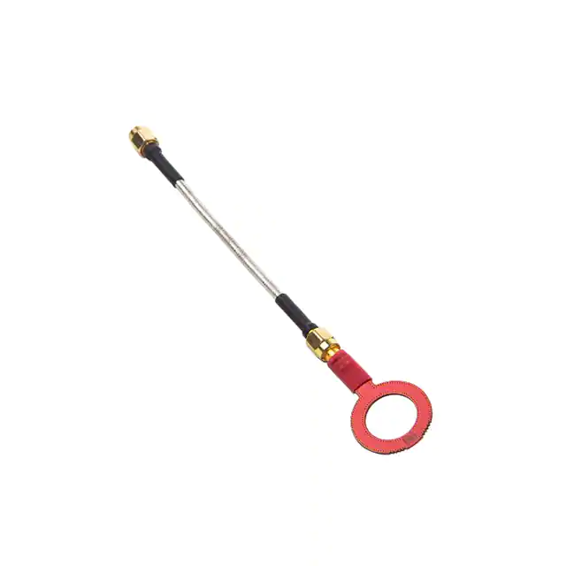

RF Explorer H-Loop Near Field Antenna (RFEAN2 SKU 114990711 Low-cost H-loop near field antenna Easy to use, reliable with high accuracy and resolution Great spatial resolution Circuit sensitivity Capable of pre-EMC compliance tests Description Features Robust calibrated low cost H-loop near field antenna Can work with RF Explorer Spectrum Analyzer, Signal Generator and other RF instruments and devices Easy to use, reliable to find interference sources with high accuracy and resolution Can be used to detect hidden bugs and transmission sources with great spatial resolution Feasible to generate interferences with Signal Generator and confirm RF circuit sensitivity Capable of pre-EMC compliance tests Specification Connector: SMA female High frequency RF SMA Male-Male included Type: H-loop near field Characterized response: 1MHz to 7Ghz RoHS compliant Part List 1 x H-loop near field antenna 1 x Semirigid SMA Male-Male RG402 10cm 6GHz cable Copyright © 2008-2016 Seeed Development Limited All rights reserved
