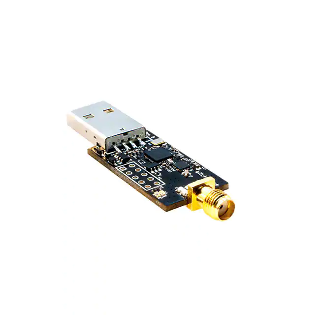

    Crazyradio PA - long range 2.4Ghz USB radio dongle with antenna SKU 114990112 Description Crazyradio PA is a long range open USB radio dongle based on the from Nordic Semiconductor. It features a 20dBm power amplifier, LNA and comes pre-programmed with Crazyflie compatible firmware. The power amplifier boosts the range, giving a range of more than 1km (line of sight) together with the Crazyflie 2.0 and above 2km Crazyradio PA to Crazyradio PA (line of sight). The Crazyradio PA is not only for usage together with the Crazyflie and Crazyflie 2.0. Since it’s an open project with firmware written from scratch and a Python API for usage it’s great building block for systems that require longer range than WiFi and doesn’t have the same requirements for bandwidth. The hardware comes shipped with the latest firmware as well as a bootloader that enables firmware upgrades via USB without any additional hardware needed. The Crazyflie PA is compatible with the first generation of the Crazyflie, but will not give the same range increase as with the Crazyflie 2.0. Features         Radio power amplifier giving 20dBm output power 1km range LOS with Crazyflie 2.0 2x5 2.54mm header for prototyping (not mounted) Hardware support for PPM Same mechanical footprint as the first generation Crazyradio Open source firmware Firmware upgrade via USB Low latency Specifications           Based on nRF24LU1+ chip from Nordic Semiconductor 8051 MCU at up to 16MHz with 32Kb flash and 2Kb SRAM 2.4GHz ISM band radio USB device peripheral 125 radio channels 2Mbps, 1Mbps and 250Kps communication datarate Sends and receives data packets of up to 32 bytes payload Automatically handles addresses and packet ack Hardware SPI and UART Combatible with Enhanced ShockBurst protocol from Nordic Semiconductor Radio Specification      20dBm output power (100mW) Low Noise Amplifier (LNA) RPSMA connector Can be powered with up to 13V via expansion header 2x5 2.54mm expansion header with following signals (not mounted):       Hardware support for PPM input Up to 13V input power GND PPM SPI/UART Standard USBA connector Mechanical Specification  Weight: 6g  Size (WxHxD): 58x16x6.5mm (including connectors) If you have any further question for technical support, please contact support(at)bitcraze.se.                                 https://www.seeedstudio.com/Crazyradio-PA-long-range-2.4Ghz-USB-radio-dongle-with-... 2/28/2017

物料型号:Crazyradio PA
器件简介:Crazyradio PA是一款基于Nordic Semiconductor的nRF24LU1+芯片的长距离开放USB无线电模块。它具备20dBm的功率放大器、低噪声放大器(LNA),并且预装了与Crazyflie兼容的固件。具备超过1km的直线视距范围,当Crazyradio PA与Crazyradio PA之间可达2km。
引脚分配:2x5 2.54mm的针脚排布,用于原型设计(未安装)。
参数特性: - 基于Nordic Semiconductor的nRF24LU1+芯片 - 8051微控制器,最高16MHz,32Kb闪存和2Kb SRAM - 2.4GHz ISM频段无线电 - USB设备外设 - 125个无线电频道 - 数据传输速率2Mbps、1Mbps和250Kbps - 最大32字节有效载荷的数据包发送和接收 - 自动处理地址和数据包确认 - 硬件SPI和UART - 兼容Nordic Semiconductor的Enhanced ShockBurst协议
功能详解: - 具备20dBm的输出功率(100mW) - 低噪声放大器(LNA) - RP-SMA连接器 - 可通过扩展头使用高达13V的电源 - 支持PPM输入 - 标准USB-A连接器
应用信息:Crazyradio PA不仅可以与Crazyflie和Crazyflie 2.0一起使用,由于其开源的固件和从头开始编写的Python API,也是构建需要比WiFi更远距离且带宽要求不高的系统的绝佳构建模块。
封装信息: - 重量:6g - 尺寸(宽x高x深):58x16x6.5mm(含连接器)
