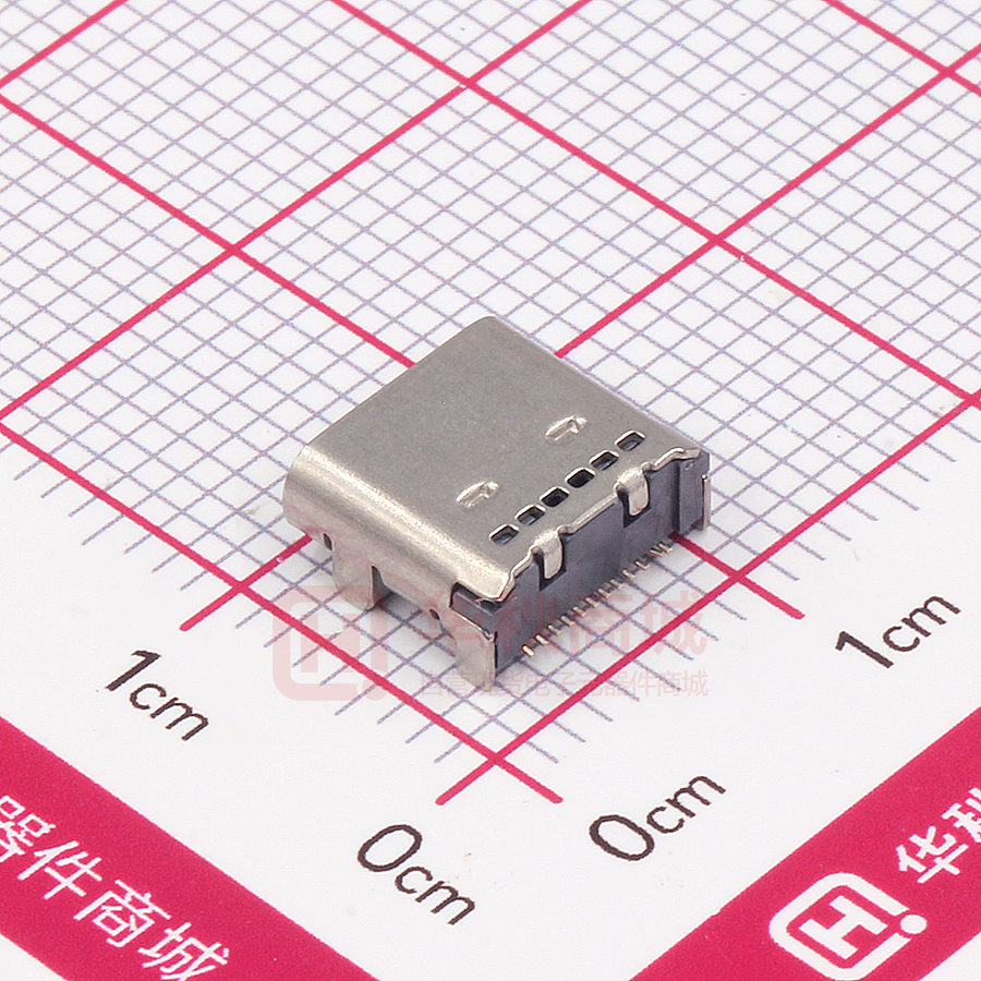

    USB连接器 Type-C 24Pin 卧贴
MC-312D-C 数据手册
www.Sofng.com C Operation:SMT+DIP 3.1 Type-C 连接器 / 24PIN 卧式 ONNECTORS LTEM NO.:MC-312D-C (L7.90mm× L7.90mm×W8.94mm× W8.94mm×H3.20mm CONNECTORS) 表面 SMT+DIP Technical parameter ╲ LEVEL A[better product] ╲ PROJECT Contact Rating Electrical Initial Contact Resistance Properties Insulation Resistance Withstand Voltage B[average product] 侧向導入 LATERAL 5.0A, 12V DC 30mΩ max. 50mΩ max. 100MΩ min.500V DC 精密部品 NICETY Skey/PD:100MΩ min.300V DC 500V AC for 1 minute 350 V AC for 1 minut There No Load 10,000 Cycles 8,000 Cycles Rated Load 8,500 Cycles 6,500 Cycles 可靠 STABILIZE Durable Performance Sterage temp. -35℃~+75℃(Operating Temp: 適合環保 RoHS ) Unit:mm Material declaration No. NAME MATERIAL DESCRIPTION 2.0μm Ni PLATED OVERALL; TERMINAL COPPER ALLOY 接触端子 【G/F】 ①A 0.25μm Au PLATED CONTACT AREA; GOLD FLASH ON SOLDER AREA. ● ②B HOUSING 基座 THERMOPLASTIC UL 94V-0,COLOR:BLACK; ③C SHIELDING PLATE 屏蔽壳 STAINLESS STEE 【G/F】0.25μm Ni PLATED OVERALL; ④D SHELL 外壳 STAINLESS STEE 【G/F】0.25μm Ni PLATED OVERALL; ⑤E GND RING 接地件 STAINLESS STEE STAINLESS STEEL; SOFNG ELECTRONIC TECHNOLOGY Co., LTD CIRCUIT BOARD SIZE (Vertical view) Operating Force Inward 5.0~8.0N.(1N.=100gram-force) Exiting 5.0~8.0N.(1N.=100gram-force) Solder-ability IR Reflow:255℃,5sec. (Max.) Manual:350℃,3sec. DECIMALS ANGLES .X :±0.25 X.° .XX :±0.15 X.X° :±1.0° :±1.5° .XXX :±0.10 .XXX° :±0.5° Pin Definition PIN Signal NAME Description PIN Signal NAME Description A1 GND Ground return B12 GND Ground return A2 SSTXp1 B11 SSRXp1 Positive half of firs SuperSpeed TX Positive half of second SuperSpeed RX differential pair SSTXn1 Negative half of second SuperSpeed RX B10 SSRXn1 differential pair V BUS Bus Power B9 V BUS Bus Power A5 CC1 Configuration Channel B8 SBU2 Sideband Use(SBU) A6 Dp1 B7 Dn2 Positive half of the USB 2.0 Negative half of the USB 2.0 differential pair-Position 1 differential pair-Position 2 Negative half of the USB 2.0 Dn1 Vacuum Packed Bag differential pair A4 A7 1000PCS/reel differential pair Negatice half of first SuperSpeed TX A3 Reel label RoHS label RoHS label Positive half of the USB 2.0 B6 Dp2 differential pair-Position 1 differential pair-Position 2 A8 SBU1 Sideband Use(SBU) B5 CC2 Configuration Channel A9 V BUS Bus Power B4 V BUS Bus Power A10 SSRXn2 B3 SSTXn2 Cardboard box label 本品不屬於危害性廢棄物,須丟棄時可以委託 Negative half of second SuperSpeed RX Negatice half of first SuperSpeed TX differential pair 回收商予以回收再生處理。 differential pair2 Products do not belong to · Positive half of second SuperSpeed RX A11 SSRXp2 Positive half of firs SuperSpeed TX B2 SSTXp2 differential pair A12 GND Ground return differential pair2 B1 GND Ground return 運送時本產品不要直接與水、酸鹼性化學物質 接觸,或放置於含有以上氣體環境中,並且需要 注記 NOTICE 注意會有滑落、側翻的危險發生;運輸過程中 1.碩方公司擁有最終解釋權;The company reserves the right of final interpretation; 不能有碰撞或者擠壓,須保證溫度與濕度適中 2.文件禁止外洩、轉載;Leaked and reproduced prohibited; [常溫 25℃,濕度在 50℃以內],不可導致材料變 3.未經授權修改無效。Modify is invalid. 形或氧化。
