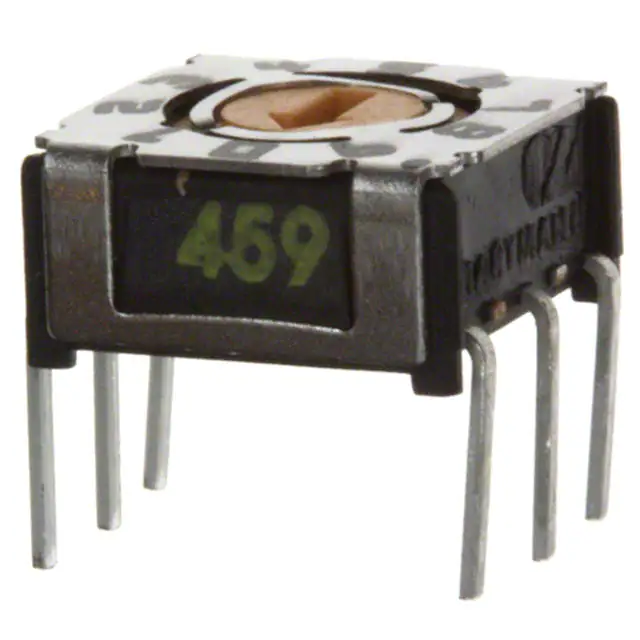

PANEL PCB SWITCHES 3 P36 series Low profile rotary code switches DISTINCTIVE FEATURES 3 actuator types Sub-miniature size Solder and flux sealed, washable ENVIRONMENTAL SPECIFICATIONS • Operating temperature: -50 °C to +125 °C (-58 °F to +257 °F) ELECTRICAL SPECIFICATIONS • Operating voltage : ≤ 42 V • Contact load, static : ≤ 0.4 A • Contact load, dynamic : ≤ 0.1 A • Initial contact resistance : 80 mΩ max. • Insulation resistance : 100 MΩ min. MATERIALS • Base : UL94-V0, high temperature thermoplastic • Cover : stainless steel • Actuator : PA 4.6 nylon • Contacts : gold over nickel plated phosphor bronze • Terminals : tin plated PCB MOUNTING SURFACE MOUNT 8 C 2 5.08 (.200) 1 C 4 Ø0.80 (.031DIA) 1 C 4 7.62 (.300) 8 C 2 5.08 (.200) THROUGH-HOLE 3.00 (.118) 1.00 (.039) -P SW 6 10 2 6- The company reserves the right to change specifications without notice. 1 Low profile rotary code switches SOLDERING • DIN CEI 68-2-20 • Manual soldering : 340 °C (644 °F) max. for 2 seconds max. • Wave soldering : 280 °C (536 °F) max. for 5 seconds max. • Reflow soldering : 260 °C (500 °F) max. for 10 seconds max. PACKAGING P36SMT1.. 1,300 pieces per reel dim.A = 22.4 mm dim B = 16.4 mm 9 01 9 01 9 01 10.00 (.393) 10.00 7.20 (.393) (.283) 7.20 (.283) 456 78 78 12.0012.00 (.472)(.472) 23 23 456 456 456 23 23 0.30 0.30 (.011)(.011) 1.75 (.068) 1.75 (.068) 1.55 1.55 (.061)(.061) 7.50 (.295) 7.50 (.295) 16.00 (.629) 16.00 (.629) 7.80 7.80 (.307)(.307) 9 01 4.00 4.00 (.157)(.157) 2.00 2.00 (.078)(.078) 78 78 4.15 4.15 (.163)(.163) Ø 1.50 mini mini Ø 1.50 (.059DIA min) min) (.059DIA CCR36DB CCR36DB P36SMT3.. P36SMT8.. 600 pieces per reel dim.A = 30.4 mm dim B = 24.4 mm 9 01 9 01 9 01 78 78 9 01 4 56 23 23 4 56 4 56 4 56 23 23 24.00 (.944) 24.00 (.944) (.452) 11.50 (.452) 1.75 (.068) 1.75 (.068) 11.50 0.30 0.30 (.011)(.011) 78 78 8.65 8.65 (.340)(.340) 12.0012.00 (.472)(.472) CCR36DB CCR36DB Reels : To order a SMT product with tape & reel packaging, add “TR” at the end of its part number. Tubes : 50 pieces (through-hole or SMT) per tube. Ø330.00 Maxi (12.992DIA MAX) A Ø100.00 (3.937DIA) PCB SWITCHES P36 series B Ø13.00±0.20 (.511 DIA±.007) 2 Low profile rotary code switches BUILD YOUR PART NUMBER THROUGH HOLE P36 THR SERIES MOUNTING Through-hole ACTUATORS CODES 1 Screwdriver 01 BCD 3 Spindle 02 BCD complement 8 Slotted spindle 03 Hexadecimal 06 Hexadecimal complement TERMINALS (none) Straight V Crimped L254 Right angle, spacing 2.54 (.100) SURFACE MOUNT P36 SMT SERIES MOUNTING Surface mount ACTUATORS CODES 1 Screwdriver 01 BCD 3 Spindle 02 BCD complement 8 Slotted spindle 03 Hexadecimal 06 Hexadecimal complement TERMINALS (none) SMT ABOUT THIS SERIES On the following pages, you will find successively basic part numbers of switches and options in the same order as in above chart. 3 PANEL PCB SWITCHES P36 series 78 3.50 (.137) 9 01 7.40 (.291) 9 01 78 7.40 (.291) 0.45 (.017) 7.40 7.62 (.291) (.300) 23 0.45 (.017) 7.62 (.300) 23 P36THR 3.50 3.65 (.137) (.143) 0.25 (.009) 7.40 (.291) 7.62 (.300) 0.25 (.009) 2.54 (.100) 4 8 C 2 8 C 2 5.08 (.200) 4 Ø0.80 7.62 (.031DIA) 1 C (.300) 2.54 5.08 (.100) (.200) Ø0.80 (.031DIA) 1 C 456 THROUGH-HOLE 3.65 (.143) Low profile rotary code switches 456 CCR36DT1 CCR36DT1 SURFACE MOUNT 3.85 (.151) 3.85 (.151) 0.25 (.009) 0.25 (.009) 78 9 01 7.40 (.291) 9 01 78 7.40 (.291) 7.40 9.50 (.291) (.374) 7.40 (.291) 5.08 (.200) 2.54 (.100) 0.45 (.017) 9.50 (.374) 23 0.45 (.017) P36SMT 2.54 (.100) 5.08 (.200) 0.20 (.008) 1.00 (.039) 3.00 8 (.118) C 2 8 C 2 23 1 C 4 1 0.20 C (.008) 4 456 1.00 (.039) 3.00 (.118) 456 PCB SWITCHES P36 series CCR36DT2 CCR36DT2 4 4.50 (.177) 0.70 (.027) 1.05 (.041) 1.05 (.041) Low profile rotary code switches 2.75 (.108) Ø3.20 (.125 DIA) ACTUATORS PANEL PCB SWITCHES P36 series 0.70 (.027) CCR36A2 CCR36A1 BASIC P/N 0.70 (.027) 0.70 (.027) 4.20 (.165) 1.05 (.041) 1.05 (.041) Actuator colour depending on codes : BCD : Red BCD compl. : Orange Hexadecimal : Grey Hexadec. compl. : White 0.50 (.019) 1.10 (.043) Screwdriver Spindle Slotted spindle 4.50 (.177) 1 3 8 2.75 (.108) 2.00 (.078) Ø3.20 (.125 DIA) CCR36A1 Ø3.20 (.125 DIA) CCR36A2 1 CCR36A3 3 -8 CODES 0.70 (.027) C MARKING 1 2 4 2.00 (.078) POSITION CCR36A2 C POSITION 8 C 1 2 4 1 2 MARKING 4 POSITION Ø3.20 8 DIA) (.125 0 0 1 MARKING C 1 2 4 8 CCR36A3 0 0 1 1 1 2 2 2 2 3 3 3 3 0.50 4 4 4 4 8(.019) 5 5 5 5 MARKING 1.10 (.043) POSITION 1.10 (.043) 4.50 (.177) Ø3.20 (.125 DIA) BCD BCD complement Hexadecimal Hexadecimal complement 4.20 (.165) 01 02 03 06 1.05 (.041) BASIC P/N 0.50 (.019) 0 0 0 6 6 6 6 1 1 1 1 7 7 7 7 2 2 2 2 8 8 8 8 3 3 3 Ø3.20 3 (.125 DIA) 9 9 9 4 4 4 4 10 10 5 5 5 5 11 11 7.62 (.300) 11 6 6 6 6 12 12 12 7 7 7 7 13 13 13 8 8 8 8 14 14 14 9 9 9 9 15 15 15 CCR36A3 10 BASIC P/N Ø0.80 (.031DIA) 1 C 4 SMT 7.62 (.300) 8 C 2 7.62 (.300) 8 C 2 7.62 (.300) 4 8 C 2 7.62 (.300) Right angle Crimped CCR36COS1 CCR36COS2 Ø0.80 (.031DIA) 1 C 7.62 (.300) 14 2.54 (.100) 9.50 (.374) 7.62 (.300) Ø0.80 (.031DIA) 1 C 4 13 15 * Not available CCR36COS1with surface mount mounting 5.08 (.200) (none) Straight or SMT V Crimped * L254 Right angle, spacing 2,54 (.100) * CCR36COS1 06 9.50 (.374) 7.62 (.300) 11 12 03 TERMINALS 10 5.08 (.200) 02 9 9.50 (.374) 2.70 (.106) 2.00 (.078) 5.08 (.200) 01 4.20 (.165) 0 CCR36COS2 CCR36COS3 Ø0.80 .70 06) ) 5 Ø0.80 Mouser Electronics Authorized Distributor Click to View Pricing, Inventory, Delivery & Lifecycle Information: Apem: P36S101 P36S103 P36101 P36103 P36102 P36106 P36S102 P36S106 P36103L254 P36101L254 P36803L254 P36806 P36S101TR P36S103TR P36S106TR P36303
