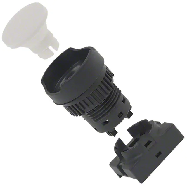

A02 SERIES ILLUMINATED OR NON-ILLUMINATED PUSHBUTTON SWITCHES Panel cut-out Ø22 or 29.5 x 21.5 A pushbutton assembly requires: screen + lamp (if illuminated) + operator + one or two switchblocks To order these elements, select desired model numbers from tables below. Example: IP65 rectangular maintained pushbutton, switch blocks with 2 N.O. contacts, red screen and 12V red LED assembly = A0261B, A0242J1, A0201X and A02503. N.C. N.O. N.O./N.C. 10.00 (.394) 10.00 (.394) 10.00 (.394) 24.00 (.945) 29.00 (1.142) 36.00 (1.417) Ø29.00 (1.142 DIA) 21.00 (.827) 21.00 (.827) 27.00 (1.062) 33.50 (1.319) 64.00 (2.520) 64.00 (2.520) 55.50 (2.185) 29.00x29.00 (1.142 SQ) 33.50 (1.319) 1 Bezel 2 Screen 3 Lamp Colour Part No black red amber yellow green blue clear white black red amber yellow green blue clear white black red amber yellow green blue clear white A0261A A0261B A0261C A0261D A0261E A0261F A0261G A0261J A0262A A0262B A0262C A0262D A0262E A0262F A0262G A0262J A0263A A0263B A0263C A0263D A0263E A0263F A0263G A0263J Lamp Voltage Part No Filament 6.3V A0141A Filament 14V A0141B Filament 28V A0141C Filament 36V A0141D Filament 48V A0141E Filament 60V A0141F Neon 110V A0143G Neon 220V A0143H LED lamp model numbers see Pages 6&7 Special LED Assemblies LED assy 6V A0242H* LED assy 12V A0242J* LED assy 24V A0242K* LED assy 6V A0243H* LED assy 12V A0243J* LED assy 24V A0243K* LED assy 6V A0244H* LED assy 12V A0244J* LED assy 24V A0244K* NB Replace * with colour code for LED assemblies: 1: red 2: green 3: amber 4 Operator Bezel Switch block Description Lamp type Part No Illum, momentary Illum, maintained Illum, momentary Illum, maintained Non-illum, momentary Non-illum, maintained Illum, momentary Illum, maintained Illum, momentary Illum, maintained Non-illum, momentary Non-illum, maintained Illum, momentary Illum, maintained Illum, momentary Illum, maintained Non-illum, momentary Non-illum, maintained Lamp/LED bulb Lamp/LED bulb Special LED assy Special LED assy Lamp/LED bulb Lamp/LED bulb Special LED assy Special LED assy Lamp/LED bulb Lamp/LED bulb Special LED assy Special LED assy A0201Y A0201X A0202Y A0202X A0203Y A0203X A0204Y A0204X A0205Y A0205X A0206Y A0206X A0207Y A0207X A0208Y A0208X A0209Y A0209X White or Blue LED Assembly: contact APEM Components Screen engraving/insertable legends: contact APEM Components Contacts 1 N.O. 1 N.C. 2 N.O. 2 N.C. 1 N.O./1 N.C. Part No A02501 A02502 A02503 A02504 A02505 Second switch block Contacts 1 N.O. 1 N.C. 2 N.O. 2 N.C. 1 N.O./1 N.C. Part No A02506 A02507 A02508 A02509 A02510 To achieve 3 or 4 pole switching, add second switch block from above table. Unsealed switches (IP40): add ‘01’ to end of operator model number Bezel: rectangular square round. ‘Illum’ - illuminated, ‘Non-illum’ - non illuminated www.apem.com 17 A02 SERIES METAL BEZEL PUSHBUTTON SWITCHES AND INDICATORS Panel cut-out Ø22 A pushbutton assembly requires: screen + lamp (if illuminated) + operator + one or two switchblocks An indicator assembly requires : screen + lamp + operator Example: IP65 metal bezel maintained pushbutton, switch block with 2 N.O. contacts, red screen and 12V red LED assembly = A0263B, A0244J1, A0211X and A02503 N.O. N.C. N.O./N.C. 75.00 (2.952) 45.50 (1.791) 11.50 (.452) Ø29.00 (1.142DIA) Ø29.00 (1.142DIA) 34.00 (1.338) 1 Bezel 2 Screen 3 Lamp Colour Part No black red amber yellow green blue clear white A0263A A0263B A0263C A0263D A0263E A0263F A0263G A0263J Lamp Voltage Part No Filament 6.3V A0141A Filament 14V A0141B Filament 28V A0141C Filament 36V A0141D Filament 48V A0141E Filament 60V A0141F Neon 110V A0143G Neon 220V A0143H LED lamp model numbers see Pages 6&7 Special LED Assemblies LED assy 6V A0244H* LED assy 12V A0244J* LED assy 24V A0244K* NB Replace * with colour code for LED assemblies: 1: red 2: green 3: amber White or Blue LED Assembly: contact APEM Components 4 Operator Bezel Switch block Description Lamp type Part No Illum, momentary Illum, maintained Illum, momentary Illum, maintained Non-illum, momentary Non-illum, maintained Illum, indicator Illum, indicator Lamp/LED bulb Lamp/LED bulb Special LED assy Special LED assy Lamp/LED bulb Special LED assy A0210Y A0210X A0211Y A0211X A0212Y A0212X A0277 A0278 Std bezel material : nickel plated brass For optional black finish, add ‘G’ to the end of operator model number. Unsealed switches (IP40): add ‘01’ to end of operator model number Screen engraving/insertable legends: contact APEM Components Bezel: round. ‘Illum’ - illuminated, ‘Non-illum’ - non illuminated 18 21.00 (.826) www.apem.com Contacts 1 N.O. 1 N.C. 2 N.O. 2 N.C. 1 N.O./1 N.C. Part No A02501 A02502 A02503 A02504 A02505 Second switch block Contacts 1 N.O. 1 N.C. 2 N.O. 2 N.C. 1 N.O./1 N.C. Part No A02506 A02507 A02508 A02509 A02510 To achieve 3 or 4 pole switching, add second switch block from above table. A02 SERIES FLUSH MOUNTING PUSHBUTTON SWITCHES AND INDICATORS Panel cut-out Ø30 A pushbutton assembly requires: screen + lamp (if illuminated) + operator + one or two switchblocks An indicator assembly requires : screen + lamp + operator Example: IP65 flush mounting maintained pushbutton, switch block with 2 N.O. contacts, red screen and 12V red LED assembly = A0263B, A0244J1, A0213X and A02503 N.C. N.O./N.C. 1.0 TO 6.0 PANEL THICKNESS N.O. 73.00 (2.874) 46.00 (1.811) 2.00 (.078) Ø35.00 (1.378 DIA) Ø35.00 (1.378 DIA) 34.00 (1.338) 1 Bezel 2 Screen 3 Lamp Colour Part No black red amber yellow green blue clear white A0263A A0263B A0263C A0263D A0263E A0263F A0263G A0263J 21.00 (.826) Lamp Voltage Part No Filament 6.3V A0141A Filament 14V A0141B Filament 28V A0141C Filament 36V A0141D Filament 48V A0141E Filament 60V A0141F Neon 110V A0143G Neon 220V A0143H LED lamp model numbers see Pages 6&7 Special LED Assemblies LED assy 6V A0244H* LED assy 12V A0244J* LED assy 24V A0244K* NB Replace * with colour code for LED assemblies: 1: red 2: green 3: amber White or Blue LED Assembly: contact APEM Components 4 Operator Bezel Switch block Description Lamp type Part No Illum, momentary Illum, maintained Illum, momentary Illum, maintained Non-illum, momentary Non-illum, maintained Illum, indicator Illum, indicator Lamp/LED bulb Lamp/LED bulb Special LED assy Special LED assy Lamp/LED bulb Special LED assy A0214Y A0214X A0213Y A0213X A0215Y A0215X A02791 A02792 Std bezel material : silver anodised aluminium. For optional black anodised aluminium, add ‘G’ to the end of operator model number. Unsealed switches (IP40): add ‘01’ to end of operator model number Screen engraving/insertable legends: contact APEM Components Contacts 1 N.O. 1 N.C. 2 N.O. 2 N.C. 1 N.O./1 N.C. Part No A02501 A02502 A02503 A02504 A02505 Second switch block Contacts 1 N.O. 1 N.C. 2 N.O. 2 N.C. 1 N.O./1 N.C. Part No A02506 A02507 A02508 A02509 A02510 To achieve 3 or 4 pole switching, add second switch block from above table. Bezel: rectangular square round. ‘Illum’ - illuminated, ‘Non-illum’ - non illuminated www.apem.com 19 A02 SERIES INDICATORS Panel cut-out Ø22 or 29.5 x 21.5 10.00 (.394) An indicator assembly requires: screen + lamp, LED bulb or LED assembly + operator To order these elements, select desired model numbers from tables below. Example: rectangular indicator with red screen and 12V red LED assembly = A0261B, A0242J1 and A0272 24.00 (.945) 29.00 (1.142) 36.00 (1.417) 33.50 (1.319) 21.00 (.827) 10.00 (.394) 29.00 (1.142) 29.00x29.00 (1.142 SQ) 37.50 (1.476) Ø29.00 (1.142 DIA) 33.50 (1.319) 1 Bezel 2 Screen 3 Lamp Colour Part No black red amber yellow green blue clear white black red amber yellow green blue clear white black red amber yellow green blue clear white A0261A A0261B A0261C A0261D A0261E A0261F A0261G A0261J A0262A A0262B A0262C A0262D A0262E A0262F A0262G A0262J A0263A A0263B A0263C A0263D A0263E A0263F A0263G A0263J Lamp Voltage Part No Filament 6.3V A0141A Filament 14V A0141B Filament 28V A0141C Filament 36V A0141D Filament 48V A0141E Filament 60V A0141F Neon 110V A0143G Neon 220V A0143H LED lamp model numbers see Pages 6&7 Special LED Assemblies LED assy 6V A0242H* LED assy 12V A0242J* LED assy 24V A0242K* LED assy 6V A0243H* LED assy 12V A0243J* LED assy 24V A0243K* LED assy 6V A0244H* LED assy 12V A0244J* LED assy 24V A0244K* NB Replace * with colour code for LED assemblies: 1: red 2: green 3: amber Operator Bezel Description Lamp type Part No Indicator Indicator Indicator Indicator Indicator Indicator Lamp/LED bulb Special LED assy Lamp/LED bulb Special LED assy Lamp/LED bulb Special LED assy A0271 A0272 A0273 A0274 A0275 A0276 White or Blue LED Assembly: contact APEM Components Screen engraving/insertable legends: contact APEM Components Unsealed indicators (IP40): add ‘01’ to end of operator model number Bezel: rectangular square round 20 21.00 (.827) www.apem.com A02 SERIES ROTARY SWITCHES Panel cut-out Ø22 (.866) A rotary lever assembly requires: operator + one or two switchblocks To order these elements, select desired model numbers from tables below. Example: IP65 square 2 position maintained rotary switch with long lever, switch block with 2 N.O. contacts = A029101 and A02503. N.C. N.O. N.O./N.C. 29.00 (1.142) 20.00 (.787) 22.00 (.866) 29.00x29.00 (1.142 SQ) 21.00 (.827) 27.00 (1.062) 22.00 (.866) 64.00 (2.520) 64.00 (2.520) Ø29.00 (1.142 DIA) 33.50 (1.319) 1 Lever Positions 2 3 2 Clockwise Rotation Bezel Operator Switch block Description Short lever Long lever 2 2 3 3 3 3 2 2 3 3 3 3 A029201 A029202 A029203 A029204 A029205 A029206 A029401 A029402 A029403 A029404 A029405 A029406 pos. pos. pos. pos. pos. pos. pos. pos. pos. pos. pos. pos. maintained momentary maintained momentary mainL, momR momL, mainR maintained momentary maintained momentary mainL, momR momL, mainR A029101 A029102 A029103 A029104 A029105 A029106 A029301 A029302 A029303 A029304 A029305 A029306 To specify flush mounting (30mmØ) option: add ‘FM’ to the end of the part number: Example: A029401FM (round operators only) Contacts 1 N.O. 1 N.C. 2 N.O. 2 N.C. 1 N.O./1 N.C. Part No A02501 A02502 A02503 A02504 A02505 Second switch block Contacts 1 N.O. 1 N.C. 2 N.O. 2 N.C. 1 N.O./1 N.C. Part No A02506 A02507 A02508 A02509 A02510 To achieve 3 or 4 pole switching, add second switch block from above table. 1 Anticlockwise Rotation • Lever Rotation – 2 position switches The model numbers shown are for switches with anticlockwise lever rotation. For clockwise rotation, replace: 01 02 with with 07 08 at the end of the model number Optional Engraving on Lever End To order add ‘WL’ to the end of the part number. Example: A029401WL Bezel: square round www.apem.com 21 A02 SERIES KEYLOCK SWITCHES Panel cut-out Ø22 or 29.5 x 21.5 A keylock assembly requires: operator + one or two switchblocks To order these elements, select desired model numbers from tables below. Example: IP65 square 2 position maintained keyswitch, switch block with 2 N.O. contacts = A028201 and A02503 N.C. N.O. N.O./N.C. 29.00 (1.142) 34.50 (1.358) 29.00x29.00 (1.142 SQ) 64.00 (2.520) 55.50 (2.185) 38.00 (1.496) 24.00 (.945) 36.00 (1.417) Ø29.00 (1.142 DIA) 21.00 (.827) 21.00 (.827) 27.00 (1.062) 33.50 (1.319) 33.50 (1.319) 1 Key Positions 2 C B Clockwise Rotation Bezel Operator Description 2 2 3 3 3 3 2 2 3 3 3 3 2 2 3 3 3 3 pos. pos. pos. pos. pos. pos. pos. pos. pos. pos. pos. pos. pos. pos. pos. pos. pos. pos. maintained momentary maintained momentary mainL, momR momL, mainR maintained momentary maintained momentary mainL, momR momL, mainR maintained momentary maintained momentary mainL, momR momL, mainR Part No. A028101 A028102 A028105 A028106 A028107 A028108 A028201 A028202 A028205 A028206 A028207 A028208 A028301 A028302 A028305 A028306 A028307 A028308 Switch block Key removable in positions A-C A A-B-C A A-B A-C A-C A A-B-C A A-B A-C A-C A A-B-C A A-B A-C To specify flush mounting (30mmØ) option: add ‘FM’ to the end of the part number: Example: A028301FM (round operator only) Contacts 1 N.O. 1 N.C. 2 N.O. 2 N.C. 1 N.O./1 N.C. Part No A02501 A02502 A02503 A02504 A02505 Second switch block Contacts 1 N.O. 1 N.C. 2 N.O. 2 N.C. 1 N.O./1 N.C. Part No A02506 A02507 A02508 A02509 A02510 The model numbers shown are for switches with anticlockwise lever rotation. For clockwise rotation, replace: 01 02 with with 20 19 at the end of the model number • 2 standard keys are supplied • 20 key barrel types available from stock • Non-removable key positions: contact APEM components To achieve 3 or 4 pole switching, add second switch block from above table. www.apem.com Anticlockwise Rotation Key Rotation – 2 position switches Bezel: rectangular square round. ‘pos’ - position, ‘mainL’ - maintained left ‘momR’ - momentary right, etc 22 A A02 SERIES EMERGENCY STOP SWITCHES Panel cut-out Ø22 (.866) • Prominent 40mm (1.575) dia. red mushroom actuator • Highly reliable positive break switch • Push to shut off switch, twist to reset to ON N.C. An emergency stop switch assembly requires:  operator + switch block To order specify with single pole or double pole positive break switch block. Approved to UL1054/EN 60947-5-5 General Specifications Min Mechanical Life : Electrical Specifications 6050 cycles (6 cycles per minute) Current/Voltage rating : 2.5A 380VAC AC-15 Operating Force : 20N Contact Gap : >3mm Operating Temperature : -20°C to +85°C Dielectric test voltage : 2500V Degree of Environmental : IP65 front of panel Electrical Life : >6050 IP40 back of panel : M3 screws-wire 2 x 0.75mm² max Protection (IEC 529) Switch Terminals 29.00 (1.142) 64.00 (2.520) 21.00 (.827) Ø40.00 (1.575 DIA) 21.00 (.827) 1 Bezel Accessories 2 Operator Switch block Description Part No E-Stop operator A02ES No of poles Double pole Single pole Part No A02511 A02512 To order the Emergency Stop Switch in the Plastic Enclosure with a 2 Pole Positive break Switchblock and Emergency Stop label use part number: A02PE2L 90Ø Self Adhesive Label Description Yellow label with text Yellow label Part No A02YL1 A02YL2 Bezel: round. www.apem.com 23 A02 SERIES MUSHROOM HEAD PUSHBUTTON SWITCHES Panel cut-out Ø22 (.866) • Prominent 40mm (1.575) dia. mushroom actuator • Momentary and maintained functions, momentary function versions are unmarked, maintained function versions are twist to release (arrows indicate direction of twist) • Various coloured mushroom actuators are available N.O. N.C. N.O./N.C. 29.00 (1.142) 64.00 (2.520) 21.00 (.827) Ø40.00 (1.575 DIA) 21.00 (.827) 1 2 Bezel Operator Switch block Description Part No Black momentary Red momentary Yellow momentary Green momentary Blue momentary Black maintained Red maintained Yellow maintained Green maintained Blue maintained A02MMA A02MMB A02MMD A02MME A02MMF A02MXA A02MXB A02MXD A02MXE A02MXF For optional reduced (Ø26mm) mushroom head operators: contact APEM Components Contacts 1 N.O. 1 N.C. 2 N.O. 2 N.C. 1 N.O./1 N.C. Part No A02501 A02502 A02503 A02504 A02505 Second switch block Contacts 1 N.O. 1 N.C. 2 N.O. 2 N.C. 1 N.O./1 N.C. Part No A02506 A02507 A02508 A02509 A02510 To achieve 3 or 4 pole switching, add second switch block from above table. Bezel: round. 24 www.apem.com A02 SERIES INDUSTRIAL CONTROLS Installation Modular Construction/panel mounting PUSHBUTTONS & INDICATORS SCREEN LEGEND ROTARY LEVERS SWITCHES KEYLOCK SWITCHES REFLECTOR LOCATING SLOT Ø22.00 (.866 DIA BULB POLARISING DOT PANEL SEAL 13.00 (.511) ADAPTOR BLOCK 21.50 (.846 OPERATOR 0.00/+0.50 .000/+.019) 8.00 max (.314 max) FIXING NUT 0.00/+0.50 .000/+.019) 3.00 (.118) EMERGENCY STOP 29.50 (1.161 0.00/+0.50 .000/+.019 ) SWITCH BLOCK END CAP PANEL CLAMP FIXING SCREW A02 Accessories PANEL MOUNTING ASSEMBLY • Drill/punch hole in panel as shaped above. • Assemble front operator through hole and: a) Round & Square types: tighten nut to a maximum torque of 0,8Nm using tool No. 30-0001. Snap on adaptor block b) Rectangular types: tighten two panel fixing screws in front to a maximum torque of 6cNm. • Wire chosen switch block as required and snap onto front operator. • Snap end cap onto switch block (optional). • Fit bulb if required using tool No. 30-0002. End cap terminal guard offering unique terminal protection. Part No. 14-0005 • Snap screen onto reflector assembly with legend in between if required and snap onto front operator TAKING CARE TO LINE UP THE LOCATING SLOT WITH THE POLARISING DOT, and not to damage the seal. TO REMOVE BULB Remove reflector/screen assembly. Use the bulb extractor 30-0002 to remove the bulb. TO REMOVE SWITCH BLOCK Lever out latches using small screwdriver taking care not to overbend, and pull off the block from the front of operator. 6.35mm Push on tab terminals Specify ‘SP to the end of the switchblock and operator part No. Example: A02503SP Dimensions: First dimensions are in mm while inches are shown in bracketed numbers. Tolerance: The general tolerance for dimensions in this catalogue is +/- 0,3 (.012). Dimensions, specifications and data shown in this catalogue are subject to change without notice. www.apem.com 25

物料型号: - 该文档描述了A02系列的多种按钮开关和指示器,包括不同型号的按钮开关、指示器、紧急停止开关、旋转开关和钥匙开关等。
器件简介: - A02系列提供多种功能的按钮开关,包括照明和非照明版本,以及不同颜色和形状的按钮头。它们适用于工业控制应用,具有多种安装选项和电气规格。
引脚分配: - 文档中列出了不同开关块的引脚分配,例如1N.O(单常开触点)、1N.C(单常闭触点)、2N.O(双常开触点)等,以及对应的型号编号。
参数特性: - 包括操作力、操作温度范围、环境防护等级(例如IP65面板前,IP40面板后)、电气规格(如电流/电压等级、接触间隙、电气寿命等)。
功能详解: - 按钮开关可以是瞬时或维持功能,紧急停止开关具有明显的蘑菇头执行器和高可靠性的正断开开关。旋转开关和钥匙开关提供多种位置选项。
应用信息: - 适用于需要高可靠性和多种功能选择的工业控制面板。
封装信息: - 提供了详细的安装说明,包括面板安装组件的尺寸和公差,以及如何安装和拆卸灯泡和开关块。
