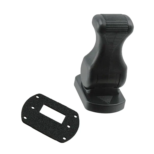

17,75 21,00 APEM 35,50 42,00 BF Series Paddle Control ,50 R 2 2,90 1,45 7,20 O 4,16 +0.1 -0.0 0,75 2,10 1,05 0,80 x45°CHAMFER O 38,00 O 1,60 2, O 3,00 50 SCULPTED ERGONOMIC DESIGN 11,75 2,28 0,46 5,71 HALL EFFECT JOYSTICK AND SWITCH FUNCTIONS O 5V OPERATION - DUAL REDUNDANT OUTPUTS AS STANDARD 99,5 EMC & MAGNETICALLY SHIELDED - ANALOGUE OR PWM OUTPUTS 45° NEXT GENERATION HALL EFFECT TECHNOLOGY O 2,50 +0.002 -0.008 0,8 45° AVAILABLE WITH COLOUR-CODED INSERTS SPRUNG AND DETENT LEVER OPTIONS IP67 SEALED 5,5 O 4,80 M2ThrededHole BF SERIES PADDLE - CONTACTLESS JOYSTICK & SWITCH PRODUCT OVERVIEW GENERAL DESCRIPTION The BF Series Paddle is the very latest generation in high precision contactless controls. It combines the features of a contactless single axis joystick and a switch in one control. Long trouble-free life is assured with the latest hall effect technology, providing a range of analogue, switched or custom PWM output options. The all-new design with its innovative mechanism and ergonomic styling is specifically designed for robustness, strength and performance. As well as all of the features you would expect from the very latest in joystick technology, the innovative design of the BF Series Paddle introduces a number of new functions and product features: EFFECTIVELY ZERO BELOW PANEL DEPTH ERGONOMIC DESIGN COMBINES CONTACTLESS JOYSTICK AND SWITCH FUNCTIONS IN ONE CONTROL TWO HALL EFFECT SWITCHES WITH SELECTABLE SWITCHING POINTS TWO INDEPENDENT ANALOGUE OUTPUTS WITH A RANGE OF GAIN OPTIONS DUAL (REDUNDANT) OUTPUTS AS STANDARD - With either the same or inverted polarity. PWM OUTPUT OPTIONS END STACKABLE MOUNTING AVAILABLE WITH A RANGE OF COLOURED HANDLE INSERTS INNOVATIVE HARD-WEARING MECHANISM LEVER CAN BE SPRUNG TO CENTRE, WITH OR WITHOUT DETENTS, OR CAN BE FRICTIONED WITH DETENTS DETENT LEVER OPTION PROVIDES TACTILE FEEDBACK AND ALLOWS POSITIVE POSITIONING HIDDEN FIXINGS HALL EFFECT SENSING - Latest technology, a reduced part count and an ease of integration. HIGH EMC IMMUNITY - Integral shielding, as standard. MAGNETICALLY SCREENED INDUSTRY STANDARD CONNECTOR www.apem.com Note: The company reserves the right to change specifications without notice. 2 BF SERIES PADDLE - CONTACTLESS JOYSTICK & SWITCH CONFIGURATIONS & OUTPUTS OUTPUT OPTIONS The BF Series Paddle is configured as two “electrical” controls in one mechanical package. The Paddle operates from 5V and provides two proportional outputs. The second output is accurate to the first within +/-2% of the power supply. The power supply for the secondary output is also completely independent. Customers may choose their preference of voltage outputs (gains). The secondary output can be of the same or inverse polarity to the primary wiper. For example, with a secondary inverse output, the first and second outputs can be summed and compared to zero to verify that the joystick is operating correctly. Paddles having two identical outputs of the same polarity may be used to drive two identical dual redundant circuits. There are also two Hall Effect switches that trigger at pre-determined lever positions. The BF Series Paddle may be specified with a variety of PWM output options. For more details on available PWM options please refer to Apem. ADDITIONAL OUTPUT INFORMATION SELECTABLE SWITCHING POINTS The Paddle incorporates two Hall Effect switches. The angle of the lever at the switch trigger point can be selected when ordering. If no switches are specified then the output on pins 2 and 7 will be unused. The outputs are configured as ‘open drain’ type with a 1K5 pull up resistor to 5V. GAIN OPTIONS The voltage output on the wiper, at full scale deflection is determined by the gain. The gain is expressed as a percentage of the voltage supplied. Therefore (assuming a 5V supply) a Paddle specified with +/- 25% gain would yield 1.25V at South, 2.5V at centre and 3.75V at North. A range of gain options are available as standard. All controls are supplied pre-set and no further calibration is needed throughout the lifetime of operation. OUTPUT IMPEDANCE The voltage outputs at centre and at each end of travel are specified across an infinite load, with no current flowing. The output impedance specified in the electrical specification should be taken into account when designing a system. Load resistance of less than 10K Ohms is not recommended. www.apem.com Note: The company reserves the right to change specifications without notice. 3 BF SERIES PADDLE - CONTACTLESS JOYSTICK & SWITCH MECHANICAL & CONNECTION INFORMATION MECHANISM The brand new mechanism design has been developed for strength and long life whilst retaining a superb feel. SPRUNG TO CENTRE The lever springs back to the centre position when released. DETENT POSITIONS The lever ‘clicks’ into a number of preset positions. The internal switches can be configured to trigger at 2 of these points. DETENT POSITIONS WITH SPRUNG TO CENTRE The lever ‘clicks’ into a number of preset positions and springs back to its centre position when released. CONNECTIONS The Paddle is fitted, as standard, with an industry standard 2.54mm pitch 8 way connector. CONNECTIONS Paddles are supplied with an eight way connector as standard. PIN PIN PIN PIN 1: 5V 2: Switch 1(+) 3: 0V 4: Analogue / PWM output 1 PIN PIN PIN PIN 5: Analogue / PWM ouptut 2 6: 0V 7: Switch 2 (-) 8: 5V BF SERIES OUTPUT CHARACTERISTICS 1 PIN 1 40% GAIN DUAL INVERSE OUTPUTS Switches at 12.5 Degrees Switches at 25 Degrees Output 1 4.5V 4 Switch 2 On Switch 1 On 2 2.5 2 1 1 Output 2 0.5 -25 -20 -10 -12.5 0 Switch 1 On 3 3 2.5 Switch 2 On Output 1 4.5V 4 10 12.5 20 25 Output 2 0.5 Degrees Deflection Degrees Deflection -25 -20 -10 0 10 20 25 Equivalent circuit for the switch output 5V The two switch outputs are configured as ‘Open Drain’ with a 1K5 pull-up to the 5V. Both outputs are ‘Active Low’ and can sink up to 10mA each. Voltage output (open circuit) is 0.8V low and 4.0V High. 1k5 100 nF 6k 125 www.apem.com Note: The company reserves the right to change specifications without notice. SWITCH OUTPUT 175 4 BF SERIES PADDLE - CONTACTLESS JOYSTICK & SWITCH PRODUCT SPECIFICATION TECHNICAL SPECIFICATION All parameters shown are based on a standard configuration and are provided for guidance only. Please refer to Apem for assistance on how to achieve the best performance from your chosen configuration. ELECTRICAL Gain (Output Voltage Span): +/-10% x V to +/-50% x V Output at Centre: V/2 +/- (5% x Gain) ENVIRONMENTAL Power Supply: 5V +/-0.5V Transient free Switch Outputs: Open Drain, pulled high within Storage : -40C to +70C control via 1K5 to 5V, and smoothed to 0V with 100nF Operating Temperature: -25C to +70C Sensor Type: Hall Effect Seal Above Panel: IP67 (Gasket fitted as standard) Current Consumption:

1. 物料型号:APEM BF系列Paddle控制器。 2. 器件简介:BF系列Paddle是高精密的非接触式控制器,结合了单轴非接触式操纵杆和开关的功能。它采用最新的霍尔效应技术,提供模拟、开关或自定义PWM输出选项。设计注重坚固性、强度和性能。 3. 引脚分配:Paddle控制器配备了8个引脚,包括5V电源、两个霍尔效应开关、两个模拟/PWM输出和接地。 4. 参数特性:包括增益选项、输出阻抗、电源、开关输出等详细电气特性。 5. 功能详解:介绍了Paddle的多种功能,例如零面板深度、符合人体工程学的设计、两个霍尔效应开关、两个独立的模拟输出、双(冗余)输出、PWM输出选项、可堆叠安装和带有颜色编码的手柄插入选项。 6. 应用信息:提供了关于电源、磁屏蔽、系统设计、安装和校准的应用细节。 7. 封装信息:提供了Paddle的机械和连接信息,包括机械操作角度、材料、重量、环境规格等。
