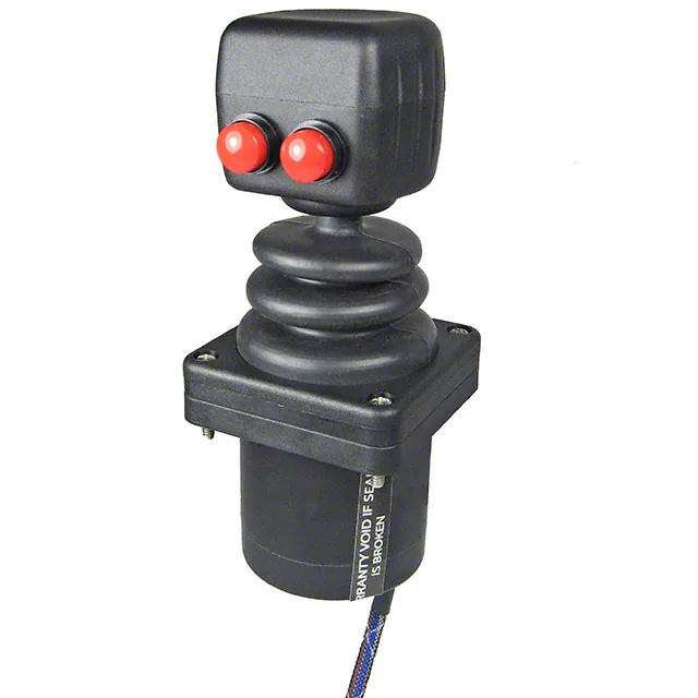

    Joystick, 3 - Axis Analog (Hall Effect) Output
MS-54W00S000 数据手册
2.10in 2.08in (mm) (52.83mm) 2.54in 2.51in (mm) (63.75mm) Top View 2.08in (52.83mm) SPECIFICATIONS Z + ELECTRICAL YX+ Y+ X- SUPPLY VOLTAGE CENTER VOLTAGE SUPPLY CURRENT OUTPUT CURRENT EFFECTIVE OUTPUT OUTPUT TOLERANCE 3.45in (87.63mm) 0.20in (5.08mm) 0.19in (4.83mm) MECHANICAL 6.03in (153.16mm) OPERATING TRAVEL CENTERING BREAKOUT FORCE OPERATING FORCE MAXIMUM FORCE OPERATING TEMP LIFE EXPECTANCY 2.58in 2.58in (65.53mm) (mm) 2.19in 1.88in (55.63mm) (mm) 0.05in (1.27mm) 2.13in 2.13in (54.10mm) (mm) WIRING Side View 2.51in 2.54in (63.75mm) (mm) Bottom View Brass ultraserts 6-32 x 0.25 Screw 6-32 x 7/8 PH PAN s/s 4 places RED BLACK BLUE YELLOW GREEN ORANGE VIOLET WHITE 5.0V DC 2.5V DC 10mA max/axis 2mA max/axis 0V – 5V DC ±2% 40° (20° from center) Single spring, omnidirectional 0.544Nm 0.653Nm 1.306Nm -40°C to +85°C 10 million operations Supply voltage Ground X-Axis Y-Axis Z-Axis Switch 1 Switch 2 Switch common RoHS compliant 2.51in 2.54in (63.75mm) (mm) 2.01in 1.98in (51.05mm) (mm) Note: Actual strain relief position may vary from specifications. CH Products P/N DESCRIPTION MS-54W00S000 REV A Series III – 3 Axes, 2 Buttons, Low Profile PROPRIETARY AND CONFIDENTIAL THE INFORMATION CONTAINED IN THIS DRAWING IS THE SOLE PROPERTY OF CH PRODUCTS. ANY REPRODUCTION IN PART OR AS WHOLE WITHOUT THE WRITTEN PERMISSION OF CH PRODUCTS IS PROHIBITED.
