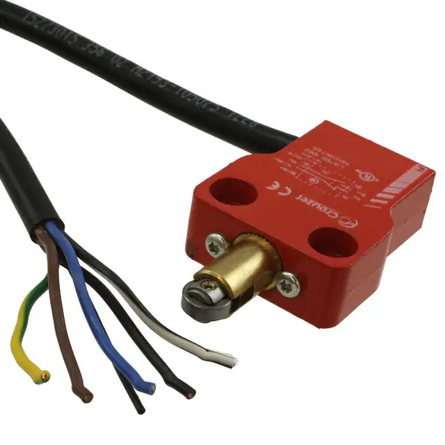

    CROUZET(高诺斯)
    检测开关 DC24V AC250V
83881102 数据手册
02/11/2015 www.crouzet.com 83880 with cable output Metal roller plunger Part number 83881102 IP 66/67 Metal case cUL approval Part numbers 83 881 102 Type Characteristics Type of output Metal roller plunger Standard Cable length 2 m Specifications Conformity to standards Protection against electric shocks Degree of protection IEC 60529 Degree of protection according to NEMA 250 IEC / EN 60947.5.1 Dimensional conformity : NFC 63145 Low voltage directive : 73/23/EEC and 93/68/EEC Electric shock protection : NFC 20030 or IEC 60536 class 1, degree of pollution 3 Type 1, 3, 4, 6, 13 Electrical characteristics Connection Operating temperature (°C) Assigned impulse voltage (Uimp) - V Assigned insulation voltage Ui (V) Thermal current I (A) Low-load switching - Minimum voltage (V) Low-load switching - Minimum current (mA) Assigned working characteristics (EN 60 947.5.1, UL 508) Use category according to IEC 947.5.1 Use category according to UL 508 Electrical protection Approvals -25 →+70 °C 2500 500 10 10 100 A300 = AC15 250 V 6 A Q150 = DC13 24 V 8 A AC15=250 V/6 A DC13=24 V/8 A A300 - Q150 Integral earth wire Short-circuit protection device : IEC/EN 60947.5.1 Fuse 6 AgC UL 508, UL 50 Mechanical characteristics Sequence Snap action Minimum operating force (N) Minimum operating force (Nm) Minimum total travel force (N) Minimum total travel force (Nm) Min. positive opening travel (N) Min. positive opening travel (Nm) Mechanical life (millions of operations) 10 30 28 10 Unless otherwise specified, the characteristics given are applicable to all or part of the product range selected 02/11/2015 www.crouzet.com 1 mm/min →0,5 m/s 1 mm/min →0,3 m/s 200 Vertical approach speed Horizontal approach speed (30° cam) Weight (g) Principles Function Four-terminal double break two-way contact element (form Zb) with positive opening NC contacts. The 2 moving contacts are electrically isolated from one another. No Legend Brown Black Blue Green-yellow Dimensions (mm) Product 83 881 1 83 881 0 Unless otherwise specified, the characteristics given are applicable to all or part of the product range selected 02/11/2015 No www.crouzet.com Legend POP marking Dimensions (mm) Product 83 885 1 83 885 0 No Legend POP marking Product adaptations Contact type Rear output Protective scraper seal Length of cable/connector/stripping Connector output Low level contact Unless otherwise specified, the characteristics given are applicable to all or part of the product range selected
