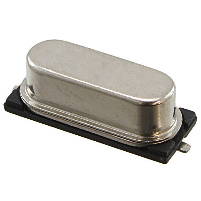

    无源晶振 18pF 40Ω ±30ppm 24.576MHz HC-49S/SMD -20℃~+70℃
CSM1Z-A5B2C3-40-24.576D18 数据手册
CARDINAL COMPONENTS Low Profile Surface Mount Crystals Series CSM1 Cardinal “AT-Strip” surface mount crystals are among the most readily available on the market today. Many popular frequencies are kept in stock at our facility. Part Numbering Example: CSM1 Z - A1 B2 C2 200 - 3.579545 D18 - 3 CSM1 A1* Z B2 C2 200 3.579545 D18 -3 SERIES ADDED FEATURES OPERATING TEMP. STABILITY TOLERANCE RESISTANCE FREQUENCY LOAD CAP. OVERTONE CSM1 BLANK = BULK PACK A0 = -10°C ~ +60°C B1 = ±100 C1 = ±100 SEE CHART D16,18,20,ETC. BLANK: FUND. -3: 3rd OT BELOW DS = SERIES Z = TAPE AND REEL A1 = -10°C ~ +70°C B2 = ± 50 C2 = ± 50 A2 = -40°C ~ +85°C B3 = ± 30 C3 = ± 30 A3 = -55°C ~ +125°C B4 = ± 10 C4 = ± 10 *NOTE: The above ABC combinations cover basic specification options. We tailor our crystal specifications to meet customer requirements. Please contact our sales department if you don’t see exactly what you need. Specifications: CSM1 Frequency Range: 3.579545~36.000 MHz 36.000000~80.000 MHz AT Cut Fundamental AT Cut 3rd Overtone Operating Temperature: -10°C ~ +70°C -40°C ~ +85°C Frequency Stability: ±100 ± 50 ± 30 ± 15 ppm ppm ppm ppm ±100 ± 50 ± 30 ± 10 ppm ppm ppm ppm Frequency Tolerance: (at 25°C) Load Capacitance: Standard Standard Standard Standard 18 pF or series. Please specify your required load. Resistance: Maximum resistance corresponds to frequency. See chart below. Standard: Mode: Fundamental or 3rd Overtone Shunt Capacitance: 7 pF Max Aging: ± 5 ppm/year Drive Level: 1.0 mW Max Optional Features: Note: Tape and Reel (1K per Reel) Not all combinations of the above tolerances, stabilities, and temperature ranges are available. Consult the factory if your requirement is not standard. Resistance Chart: All resistances are maximum values. EQUIVALENT SERIES RESISTANCE (ESR), MODE OF OPERATION (MODE), AND CUT Frequency MHz 3.579545~4.999 5.000~5.999 6.000~7.999 8.000~8.999 9.000~9.999 10.000~14.999 ESR(Ω) 200 Max 150 Max 120 Max 90 Max 80 Max 70 Max Mode/cut Fund./AT Fund./AT Fund./AT Fund./AT Fund./AT Fund./AT Frequency MHz 15.000~15.999 16.000~23.999 24.000~30.000 24.000~48.000 24.576~29.999 30.000~75.000 ESR (Ω) 60 Max 50 Max 40 Max 40 Max 150 Max 100 Max Mode/cut Fund./AT Fund./AT Fund./AT Fund./BT 3rd Overtone/AT 3rd Overtone/AT Cardinal Components, Inc. 1801 Broadway St Charlottesville, VA 22902 USA TEL: (973)785-1333 E-MAIL: sales@cardinalxtal.com WEB: http://www.cardinalxtal.com

物料型号:CSM1系列
器件简介:这些晶体振荡器是市场上最容易获得的产品之一,许多流行频率都有库存。
引脚分配:文档中没有提供具体的引脚分配图,但通常这类晶体振荡器会有四个引脚,两个用于电源,两个用于输出。
参数特性: - 频率范围:3.579545 MHz至36.000 MHz(基频AT切割),36.000000 MHz至80.000 MHz(三次谐波AT切割) - 工作温度:-10°C至+70°C(标准),-40°C至+85°C(扩展) - 频率稳定性:标准为±100ppm,其他选项包括±50ppm、±30ppm、±15ppm - 频率容差:在25°C时,标准为±100ppm,其他选项包括±50ppm、±30ppm、±10ppm - 负载电容:标准为18pF或系列,可以根据需要指定 - 电阻:最大电阻与频率相对应,具体值见图表
功能详解:文档中没有提供详细的功能描述,但晶体振荡器通常用于为电子设备提供稳定的时钟信号。
应用信息:适用于需要稳定频率信号的各种电子设备。
封装信息:文档中提到了“Tape and Reel”封装选项,每卷1K个。
