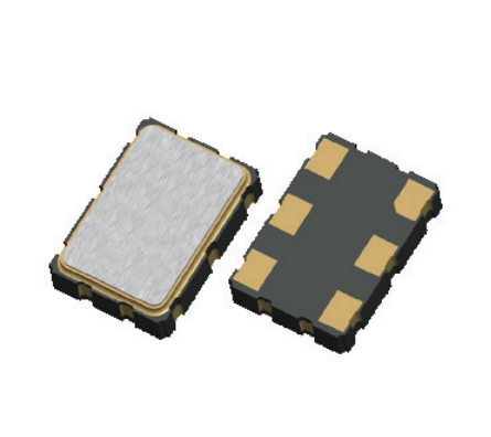

    有源晶振 3.3V - 125MHz SMD3225_6P
8X1250003L1 数据手册
江苏浩都频 率科技有限公司 JIANGSU HD CRYSTAL TECHNOLOGY CO.,LTD Specifications For Product TYPE : Quartz Crystal Oscillator SPEC : LVPECL/LVDS/HCSL P/N : 8X Series VER : A/0 R&D APPR.SIGNATURED ISSUE CHECK DEPT. APPROVAL Jiangsu HD-Crystal technology CO., Ltd Add:NO 3,Dongxu Road,Lingang City,Jiangyin,Jiangsu Procince Specification Revision Record Sheet  Rev. Revise page Revise Contents Date Ref. No. Reviser A/0 N/A Initial released 2022/8/1 N/A 吴佳斌  www. hd- crystal. com 1  Product Descipion 1. Scope: 1.1 This specification applies to the RoHS crystal oscillator with a frequency which will be used in electronic equipment. 2. Construction: 2.1 Oscillators series: LVPECL/LVDS/HCSL Crystal Oscillator 2.2 Package: SMD3.2×2.5 3. Electrical Characteristics LVPECL Parameter 3.3V Min Max Supply Voltage Variation(VDD) Frequencu Range LVDS 2.5V Min Max 3.3V Min Max 2.5V Min Max VDD -5% VDD +5% VDD -5% VDD +5% VDD -5% VDD +5% VDD -5% VDD +5% unit V 10 250 10 250 10 250 10 250 MHz - 70 - 70 - 50 - 50 mA 2.275 - 1.475 - - 1.6 - 1.6 - - 0.88 0.9 - 0.9 - Transition Time: Rise/Fall Time + 1.68 - 1.0 - 1.0 - 1.0 - 1.0 nSec Start Time - 10 - 10 - 10 - 10 mSec Tri-Start(Input to Pin 2 or Pin 1) Enable (High voltage or floating) Disable (Low voltage or GND) 2.31 - 1.75 - 2.31 - 1.75 - - 0.99 - 0.75 - 0.99 - 0.75 RMS Phase Jitter (Integrated 12KHz-20MHz) Fo 80MHz 80MHz Fo 125MHz - 1 - 1 - 1 - 1 0.5 - 0.5 - 0.5 - 0.5 0.3 - 0.3 - 0.3 - 0.3 Supply Current 10MHz Fo 160MHz Output Level Output High Output Low 125MHz Fo 160MHz Phase Noise@ 156.25MHz Aging(@25 °C 1 st year) Storage Temp. Range - 100Hz 1KHz -95 -90 -90 -90 -125 -125 -120 -120 10KHz -140 -140 - ±3 - ±3 -55 125 -55 125 -55  www. hd- crystal. com 2 V pSec dBc/Hz -140 -140 - V ±3 - ±3 ppm 125 -55 125 °C Product Descipion HCSL Parameter 3.3V Supply Voltage Variation(VDD) Frequencu Range Supply Current 25MHz Fo 160MHz unit 2.5V Min Max Min Max VDD -5% VDD +5% VDD -5% VDD +5% V 25 175 25 175 MHz mA - 50 - 50 0.6 - 0.58 - - - Transition Time: Rise/Fall Time + 0.15 0.15 - 0.5 - 0.5 nSec Start Time - 10 - 10 mSec 0.7VDD - 0.7VDD - - 0.3VDD - 0.3VDD - 0.5 - 0.5 - ±3 - ±3 pSec ppm -55 125 -55 125 °C Output Level Output High Output Low Tri-Start(Input to Pin 2 or Pin 1) Enable Disable RMS Phase Jitter (Integrated 12KHz-20MHz) 125MHz Fo 160MHz Aging(@25 °C 1 st year) Storage Temp. Range V V Standard frequencise are frequencies which the crystal has been designed and does not imply a stoc k position. + Transition times are measured between 20% and 80% of V DD .  www. hd- crystal. com 3 Reliability Specification Item Condition Free drop from 75cm height on a hard wooden 1. Drop characteristics board for 3 times. (Board is thickness more than 30 mm.) 2 Mechanical shock Device are shocked to half sine wave (1000g) three mutually perpendicular axes each 3 times Shake frequency 10~55Hz, cyc1~2 minutes, 3. Shake characteristics swing 1.5mm, direction x/y/z, all 30 minutes, test after 1 hours. Humidity 4. 5. 6.  characteristics Low temperature characteristics High temperature characteristics 7. Temperature cycling 8. Refluence examination 9. Others +40±2℃ & 90%~95% R.H. 250 hours Standard Frequency change:≤±5ppm Rr as specification Frequency change:≤±5ppm Rr as specification Frequency change:≤±5ppm Rr as specification Frequency change:≤±5ppm Rr as specification -40±2℃, 250 hours, put in room temperature, Frequency change:≤±5ppm test after 1 hours. Rr as specification +85±2℃, 250 hours, put in room temperature, Frequency change:≤±5ppm test after 1 hours. Rr as specification -40±2℃/30±3 min~+85±2℃/30±3min, Frequency change:≤±5ppm 5 cycles Rr as specification Frequency change:≤±5ppm Rr as specification  www. hd- crystal. com 4  3DFNDJH2XWOLQH'LPHQVLRQV Units:mm 6XJJHVWHG3DG/D\RXW To ensure optimal oscillator performance, place a by-pass capacitor of 0.1uF as close to the part as possible between Vdd and GND pads.   www. hd- crystal. com 5  Packing Specification Qty:3000Pcs   www. hd- crystal. com 6
